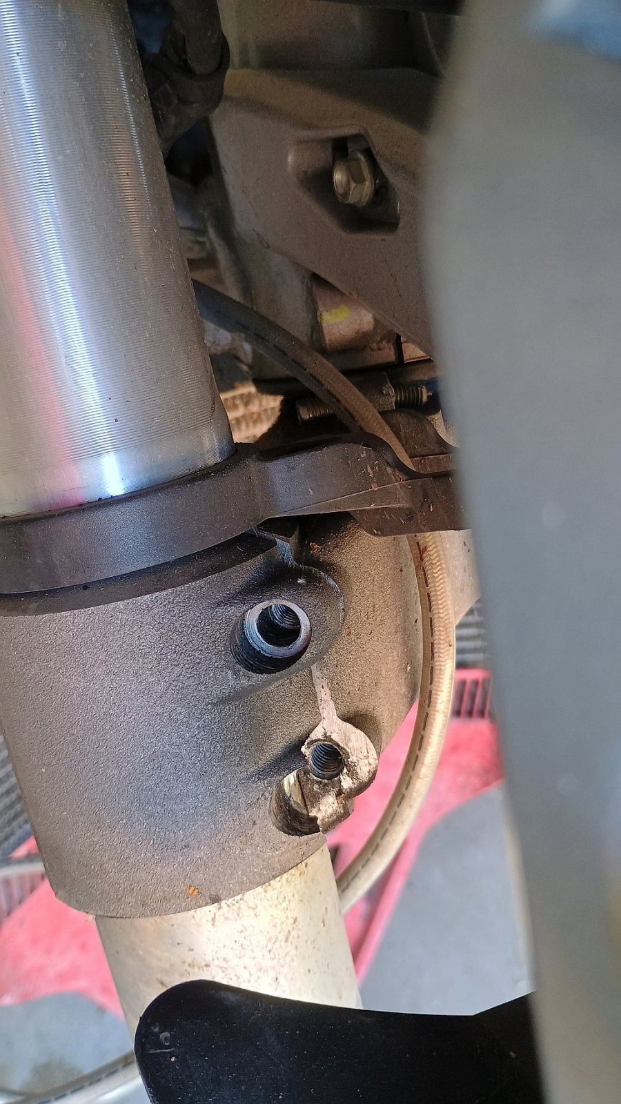

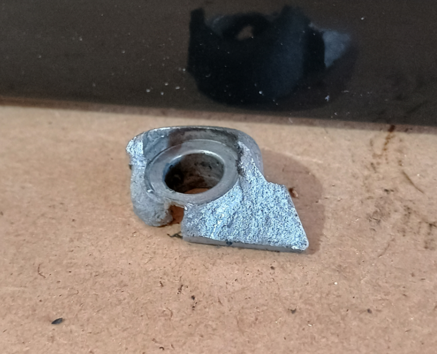

  1. The forks don't just drop out, then. I suppose I'll have to go for the large tubular drift as per the wheel axle. Since maybe the forks can be straightened.
    From the bottom yoke.
    • WTF WTF x 2
  2. Wow:astonished:
    I'm struggling to picture exactly where that's come from on the bottom yoke.
    The only place I can think of is where the Steering stem fit's in, but on mine that's a blind hole(until I drilled it for a paddock stand) and I think Threaded.
    I think we need a picture of the other bit.
  3. One of the fork clamp bolts.
    I was about to ask if we think it can be welded (I bet not!). Having just spent time trying to find a replacement yoke. Shame it's not 58mm, I'd already have bought one.
  4. Judging by the picture it looks like a cheapo cast? So can't be welded. I probably am wrong. All the same much sympathy.

  8. I reckon that's been overtightened by somebody in the past.
  9. I wouldn't even contemplate welding triple clamps. Might work. Might not.

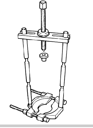

  10. So I just ordered the tool for the steering tube nut. Now I'm failing to perceive the precise nature of the 'Universal puller'
    Quite pleased, however, at figuring out how to extract the image from the manual on the Linux laptop and Bluetooth it to this phone.
    Only to wonder why I'm doing this
    from the phone and not the laptop...
  11. Looks like a trepanning rig:astonished:
  12. 34220342A is the superceded number. It looks like I can get a new one - eventually - from the EU for £400 - £500 quid. Plus, no doubt, the considerable extra Customs slaps on.
    I might even go for it, but waiting for new stock doesn't appeal.
    Christ what a price for a bottom yoke!
  13. When the special tool arrives and I can detach it, I'll take it to an ally welder and see.
  14. I'd jerry rig a homemade puller...you have the image as a guide...Just start welding some steel scrap up! ;)
  15. That's the other puller, for the bearing race. the one i'm waiting for is for the steering head nut. Should be here by the weekend.
