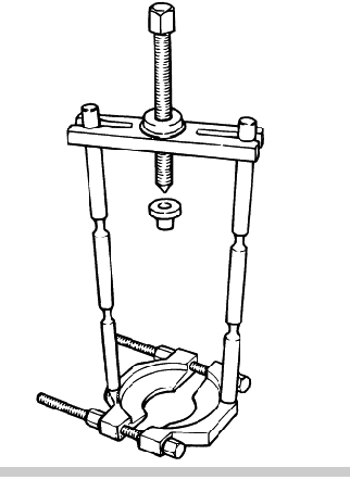

  1. Are you planning to press in new bearings?
    This tool is for doing that.
    If you're just removing the yoke/stem, you don't need it.
