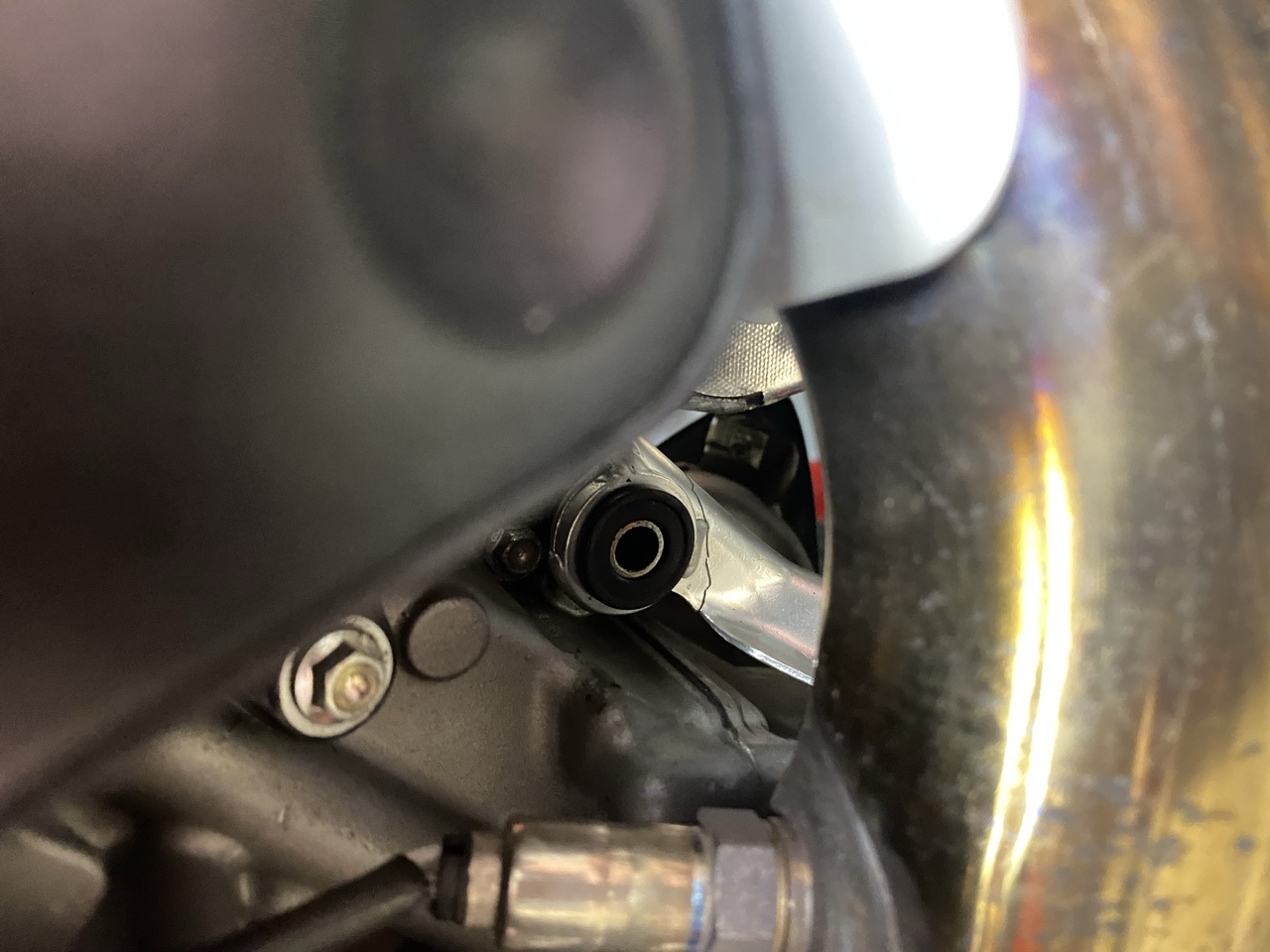

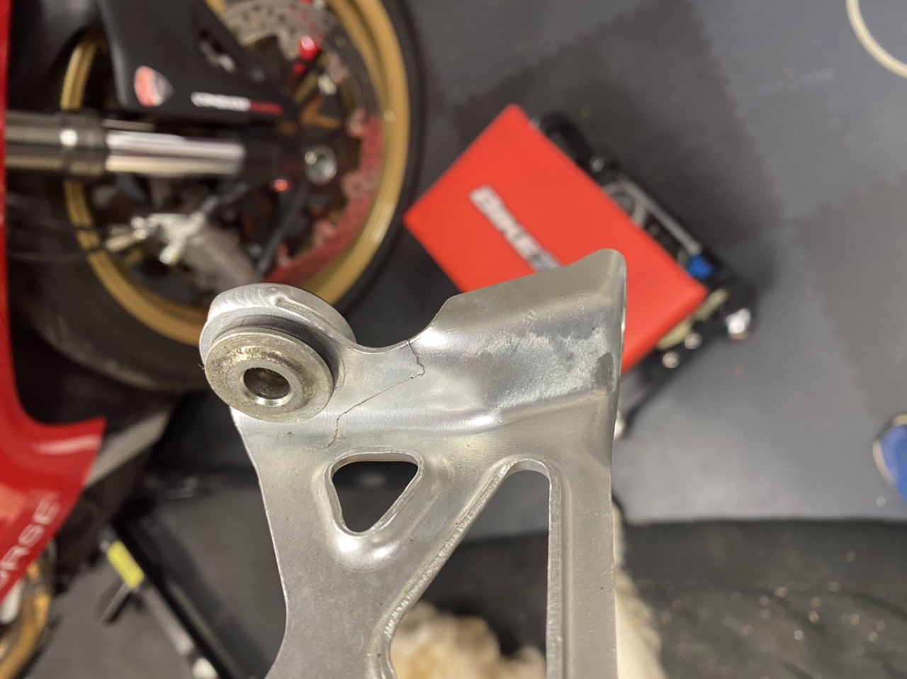

    Might be worth checking the front exhaust hanger.
    Mine has a crack in it.
    V2 with 5800 miles.

    I cba arguing. The part was £20ish, so I ordered it and fitted it myself.

  8. Don’t some garages just jack up rear of bike using the underslung exhaust as lifting point? Taking lower fairing off first, obvs.
    This could stress the bracket I think.
