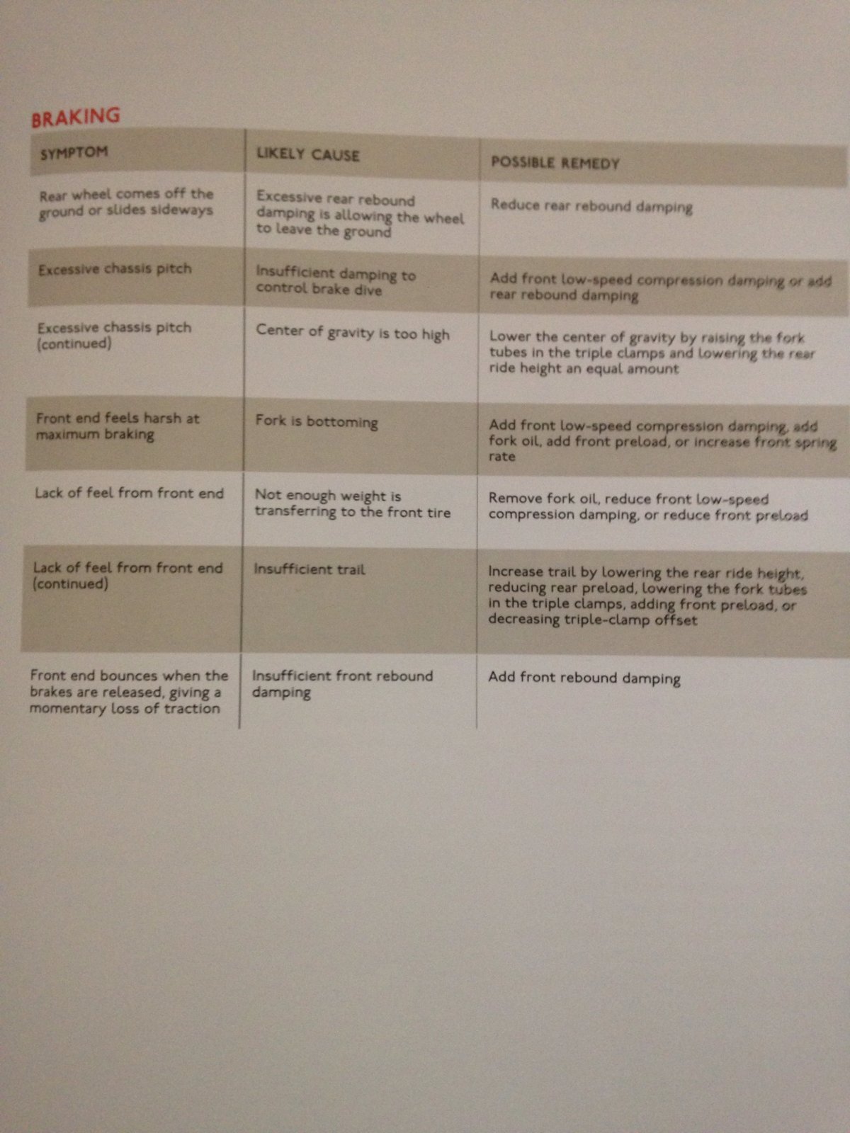

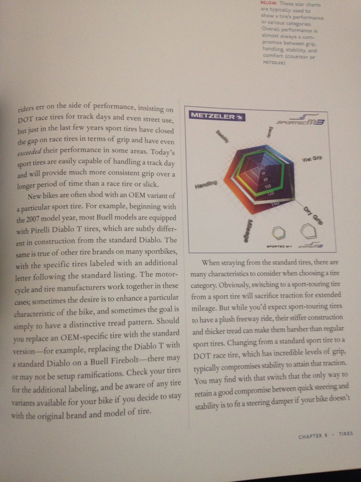

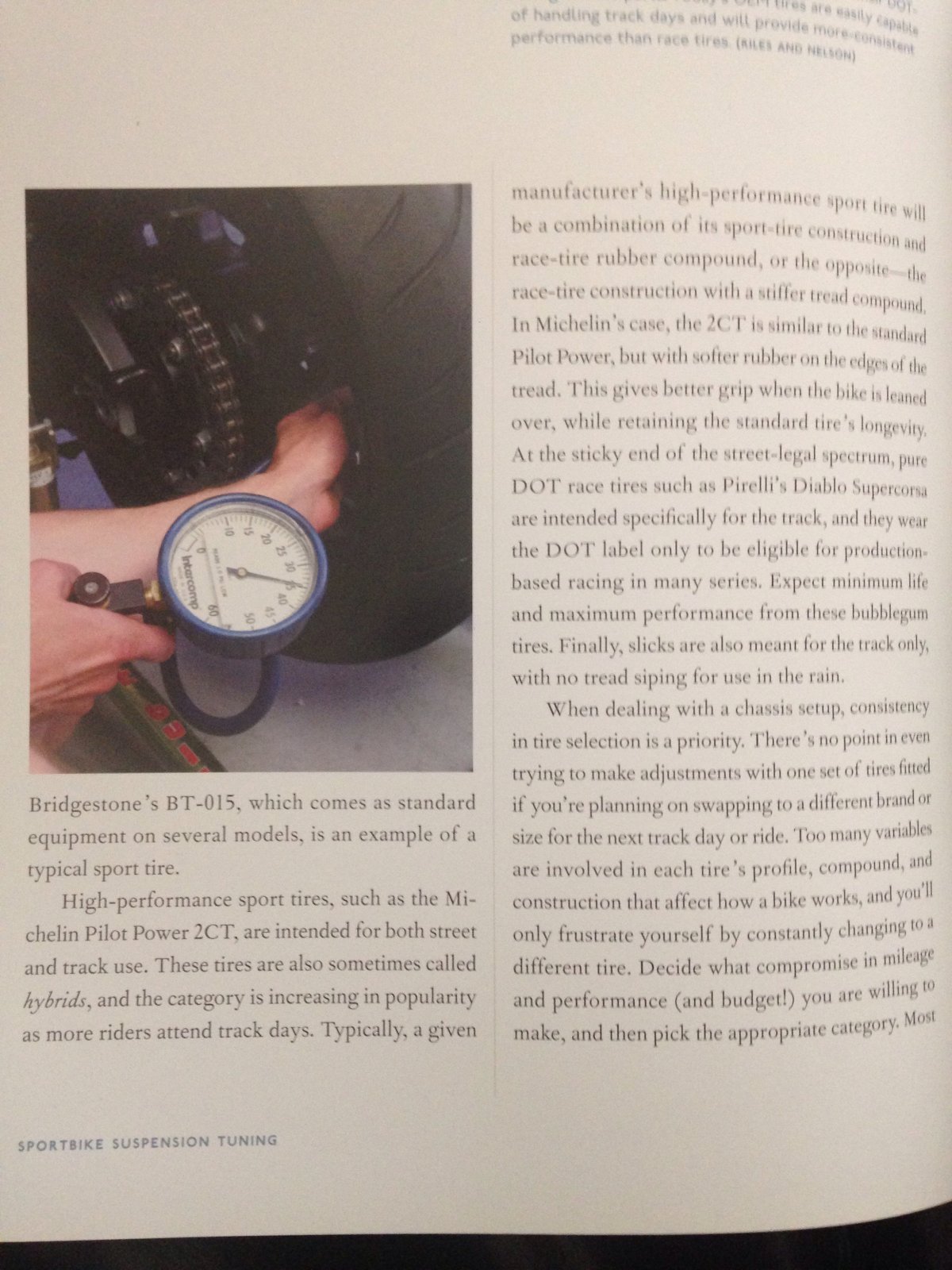

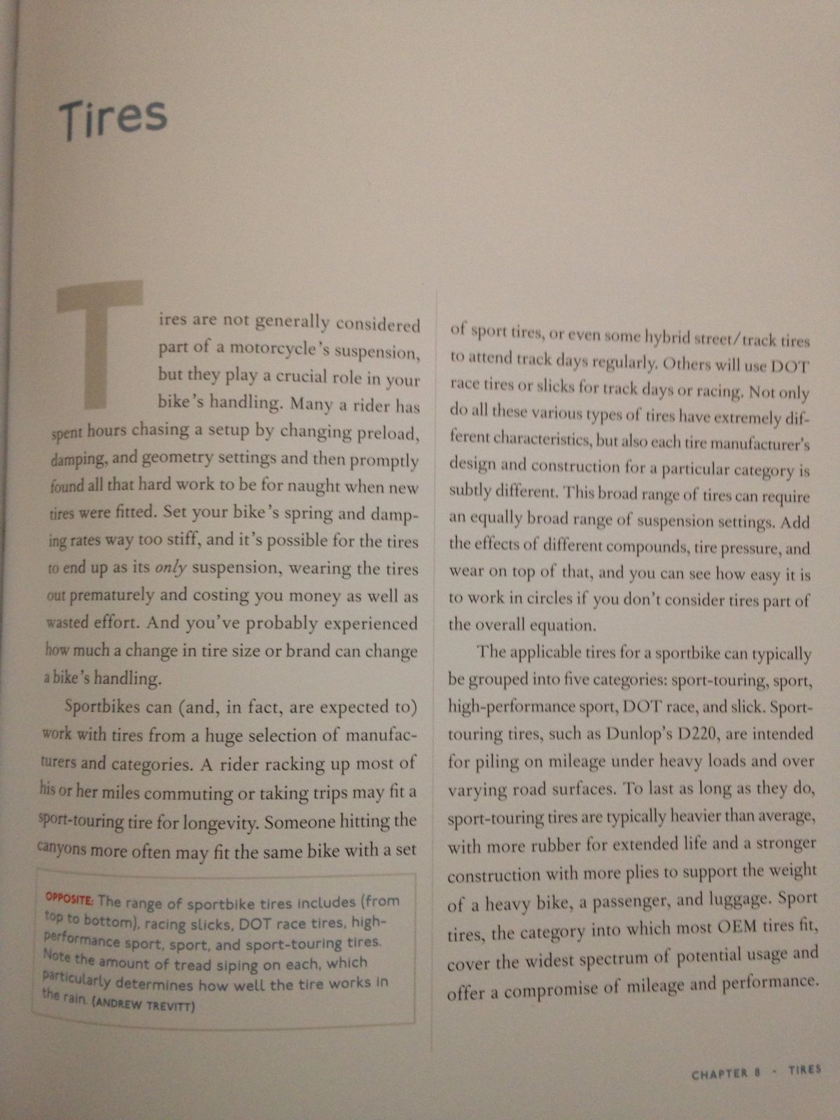

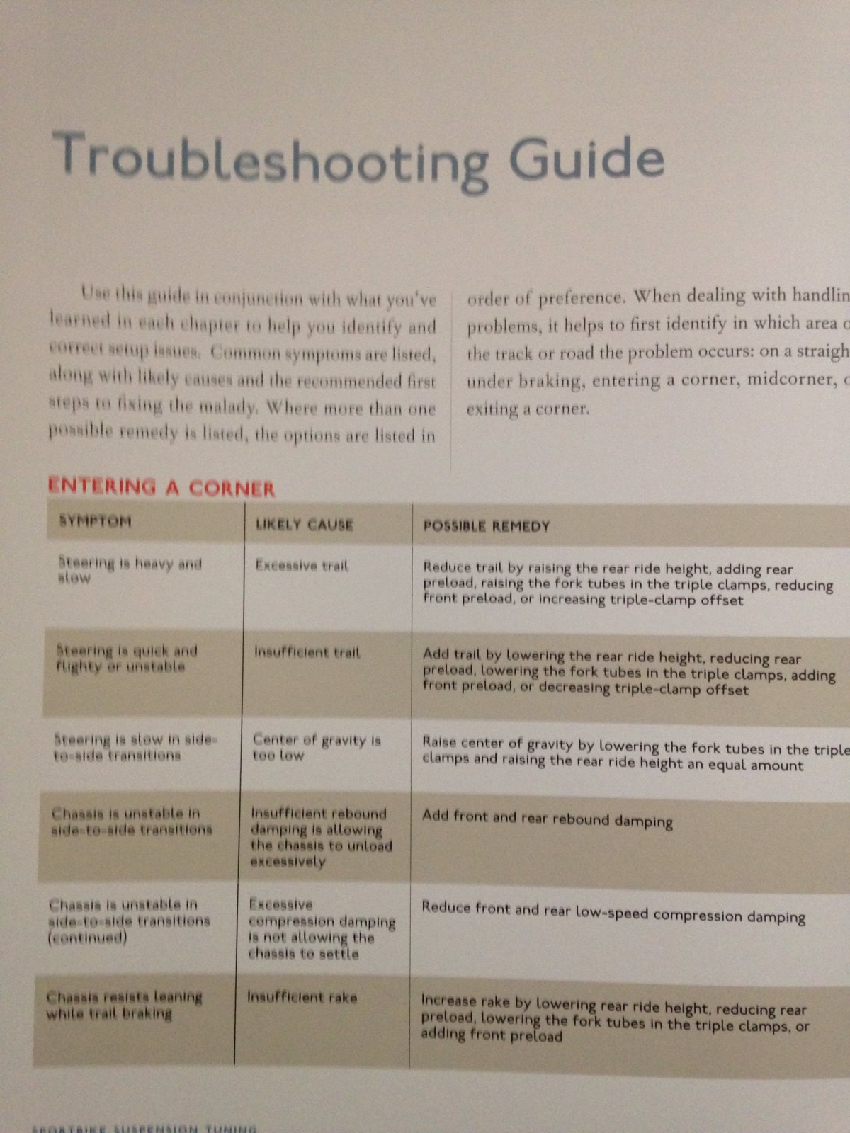

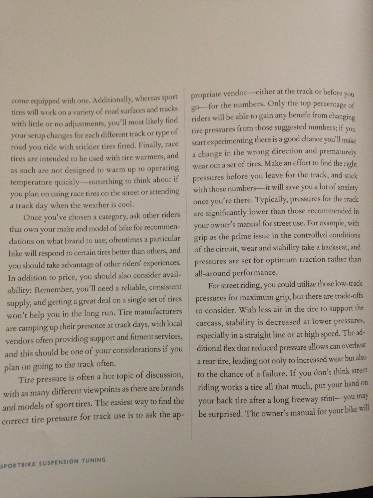

  15. image.jpg image.jpg image.jpg image.jpg image.jpg image.jpg Forgot I had this, bought a few years ago when I put usd forks on my 907 and changed the offset/trail etc. Bit late now but if theres any sections you want a pic of pm me, although the books only about a tenner+pp.
