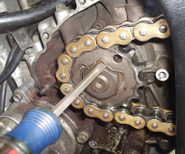

  2. Isn't there a part on the nut that needs squashing with a screw driver to stop it spinning Tim? My R6 one came loose this month and wrecked a bunch of threads on the shaft. Luckily there's still plenty left but it's a major job to take the shaft out if it's far gone. Pani might be different as I've not looked.

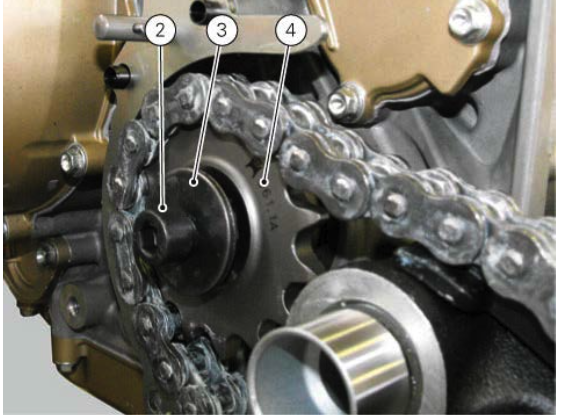

  3. Not by the look of it there isn't There is something called a thrust washer that I had to order from ducati But its not arrived yet. Ill put a piccy on here when it arrives
  4. There's usually a soft washer behind the nut that needs folding upward to lock the nut in place.
  5. Pretty sure its just a washer with an allen key head on the panigales

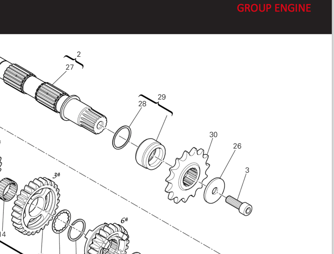

  6. hope this helps

  7. As you say @Benny899 just a lock washer (num 26) at 55Nm . I didn't expect that.

  13. Parts have been ordered but not yet arrived, its not the usual fittings with a bent over washer, the washer required is called a thrust washer which is domed and the screw compresses the washer into place. Ill put a piccy on here once it arrives and I've done it. Thanks for the input chaps.

  18. The crucial point about the "soft" washer is that it locks both to the shaft, via some sort of "tab", and to the nut when it is bent over.
    This is the essential difference that Steve was referring too.
    A plain, soft washer would do nothing.
    In many ways the Belleville washer is a neat solution .. better than a conventional spring washer as it contacts/seals around the full diameter, thus closing any leak path for corrosive fluid (water) to get in.
    It seems that theory is not standing up in practice though.
    One possible issue might be that the washer needs to be put on the right way round (concave inwards) otherwise it won't get compressed at all as the bolt is tightened, and will be totally ineffective.
    Another might be that there is much scope for excessive friction due to surface corrosion, lack of lube etc, to compromise the torgueing up process.
    Incidentally, you can double these up, to provide even greater locking .. as long as they go on in alternate directions. In this case the first one would go on concave outwards, second one concave inwards.
    Intuitively, I reckon the best solution would be to get hold of a Nylock bolt to replace the std one.
    These have a nylon insert, much like the more common ones in locking nuts.
    Such a bolt could be re-used many times and should stay tight reliably, without the need for scrupulous cleanliness and special grade threadlock.
    Getting hold of one is another matter though .. they're not commonly available.
    At a push you could make your own, by drilling a lateral hole through the bolt (close to the free end so as not to compromise the strength) and fitting a short piece of nylon rod in said hole, trimming flush to the thread crests.
    Haven't tried this myself, but I reckon it should work if done accurately/neatly.
    Final shot .. you can get loctite which works without the need for scrupulous cleaning first.
    No 222 .. and its purple.
    Might be more reliable than conventional grades in this, greasy location.
