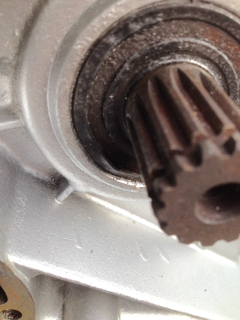

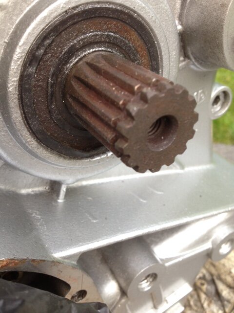

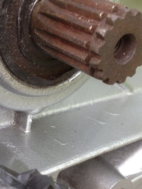

  1. Apologies if I've got the terminology incorrect.
    The lower part of this rubber gaitor/seal doesn't look too clever.
    Have I got a problem here, anything major to worry about before the engine goes back in the frame?

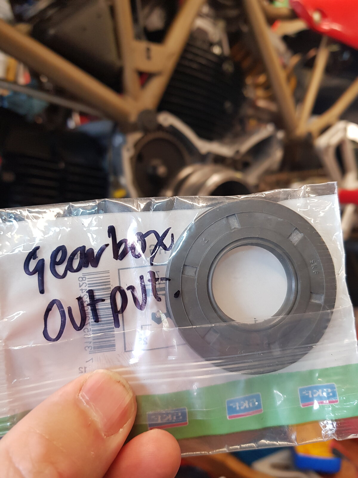

  2. Its a metal ring seal with rubber around it, so as long as the metal is secure in the hole, I would think its ok, however, although I am not 100 precent, I think you can replace these without splitting the cases. I have only done it when my engines have been apart so thats why I am not 100 percent. If it was me, I would replace it before putting it bcak in. Ill get you the sizes, its a standard SKF or equivalent seal. Get from ebay as its cheaper than Ducati.

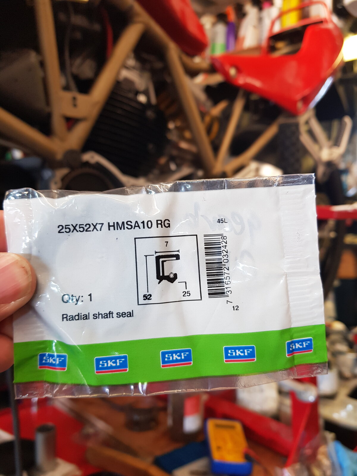

  3. I have one. So here you go for sizes. Should go in without splitting cases, may be tricky pressing it into place but I would try it if it was my bike
