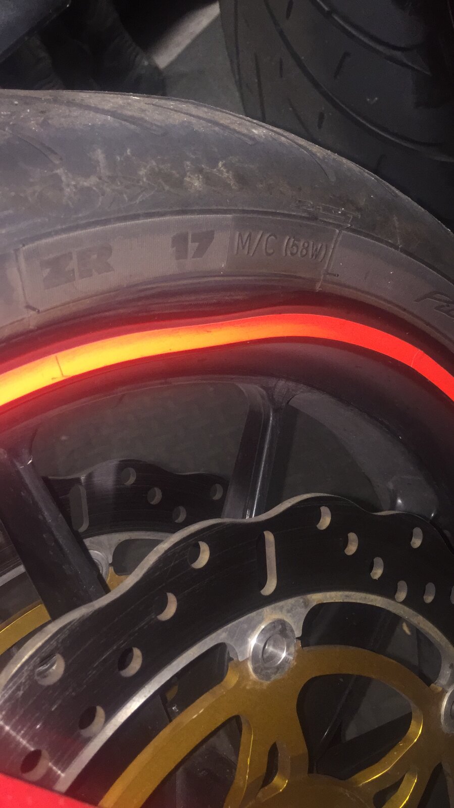

  1. The rim on my 2010 Multistrada 1200S is ever so slightly bent ,it doesn't affect the tyre pressure at all . I was thinking as I am putting a new tyre on it would it be possible to put 2 pieces of metal either side of the defect and g clamp it apply some heat tighten the clamp and hey presto fixed ! My concern is if they are magnesium they maybe too soft and I will cause irreversible damage . Does anyone know what the wheel is made of and whether I should just leave it alone ? Its not a great picture but hopefully you can see it. bend.jpg
  2. Rest assured they are not magnesium. The MTS wheel are an aluminium alloy of some sort.
  3. ...how was it caused & at what speed?
  4. It was the previous owner and he said wasn't going fast over a small pothole
  5. How much did they charge if you don't mind my asking?
  6. £174 all in
  7. +1 for Motorliner
    Cheaper if you just take a bare wheel.
  8. They are very light these wheels , so much lighter than my VFR800 99 even with the fat 200 section rear. I have visions of the metal snapping off a chunk if I apply too much pressure .
  9. And another one for Motaliner.
  10. Much cheaper - but they will take the tire off and refit / balance as well.
    Ducati wheels / Italian alloy wheels tend to bend; Jap ones tend to break.
