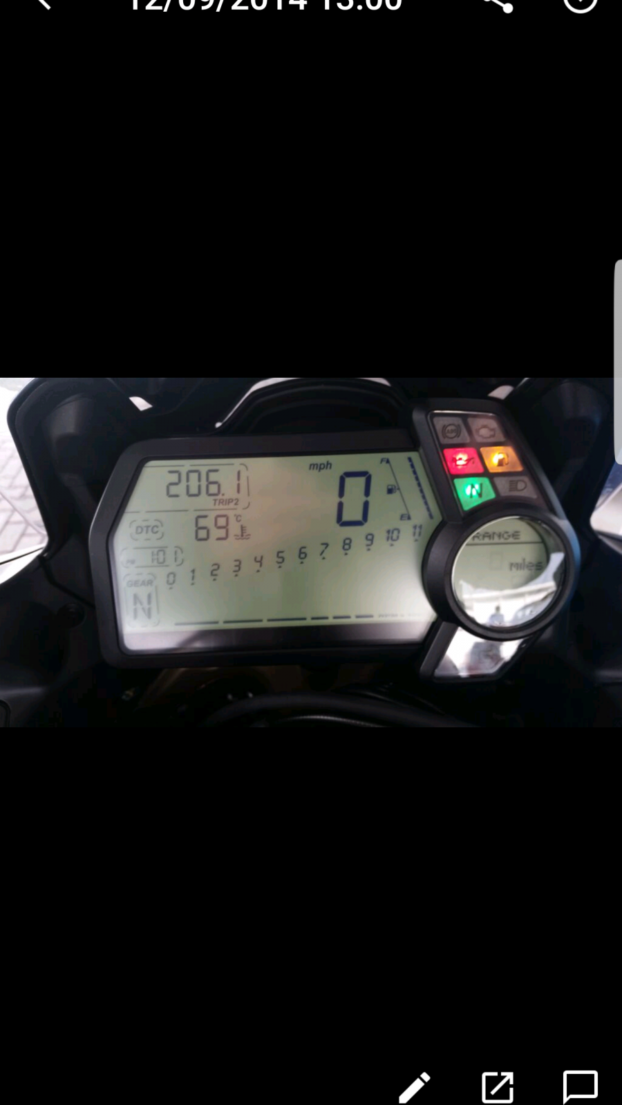

  10. I have run my 2013 twin spark to 207 miles on a tank full with 0 miles remaining and when I did fill it up it only took 18.65 lts so there was a few more miles in it ... but now my fuel gauge wouldn't go over 3 bars had it out tonight and fuel light came on with 32 miles remaining so went to fill up and could only get 10.65 lts into it ...
  11. I have run out of fuel at175 miles, so now i get figity around 150 miles, refuel only to find i have another 4 litres unused! Cant trust the fuel guage nor the how many miles left indicator,does my head in when touring
  12. Screenshot_20170331-162909.png this is mine a 2013 multistrada fully standard twin spark photo taken at my house so another 1 mile r so to petrol station was getting really worried lol incase I needed to push big D to fill her up .
  13. And how many litres to fill her up?
  14. 18.65lt to fill I was very surprised so still a few miles left in it
