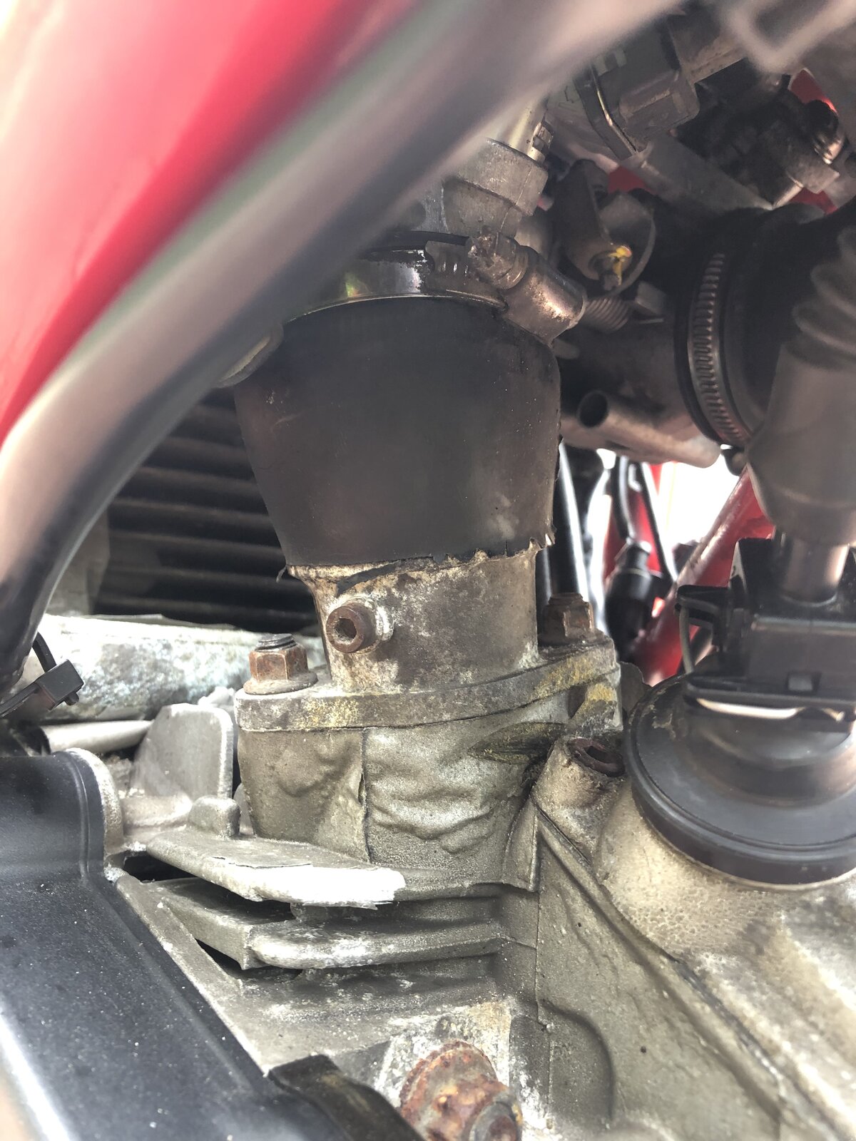

  1. Hi, hoping for some guidance. We have been working on a monster 695 which was crashed and then sat for some time. Long story short, it’s gone from very bad, to engine running and most of the bike is now new. We’re having an issue with the part in this photo. Where the rubber joins the metal part of the inlet manifold it seems to be momentarily separating once the bike is warmed out and letting off quite a loud pop. This confuses me because that suggests to me that there is pressure in the manifold and I thought that a naturally aspirated engine like this would have at most atmospheric pressure or most likely, vacuum. I’m assuming the rubber and metal bits should be fused and so there is an issue there that needs rectifying but I’m concerned by what is causing it to blow open.
    Can anyone explain what is going on here?
    For info, I did a compression test and the results were circa 100 on both cylinders. Injectors and bodies have been replaced.

  2. It's back firing, most likely down to excess air getting in through the rubber. That's shot... the bonding between the rubber and alloy has failed, and needs replacing
  3. Thanks for the very quick reply. I feel a bit more relaxed about it now as my fear was that the valves weren’t seating causing gasses to get forced up the intake manifold causing a pressure build up and ‘pop!’.
    Is it normal that it would get worse with a hotter engine?
    Do you suppose that a screw down metal clamp (like the one above) would solve the problem?

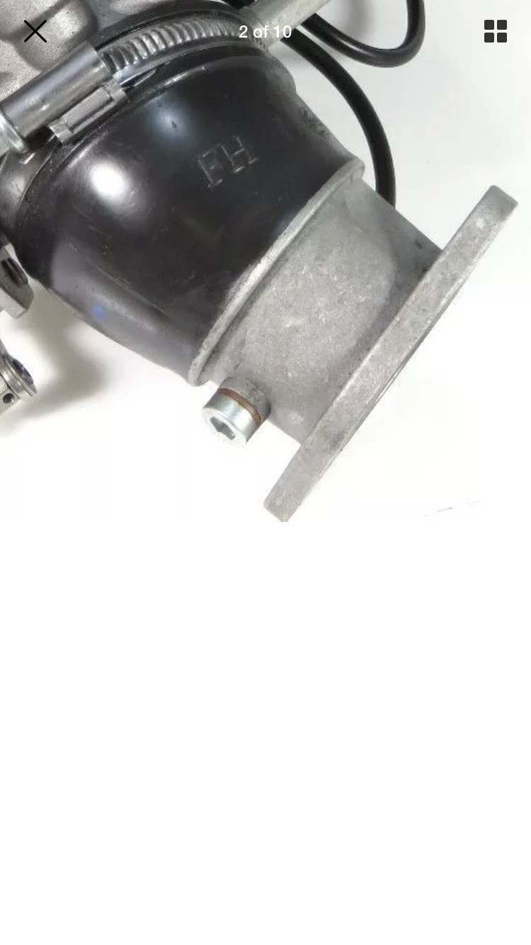

    After the belts were redone and tensioned, the issue persisted. It was actually happening on both cylinders and blowing the rubber hoses out which needed replacing. That’s fun because it seems to be the one part from Ducati that you can’t get anymore. We found that 696 manifolds fit just fine but there’s an extra theaded hold that needed blocking.
