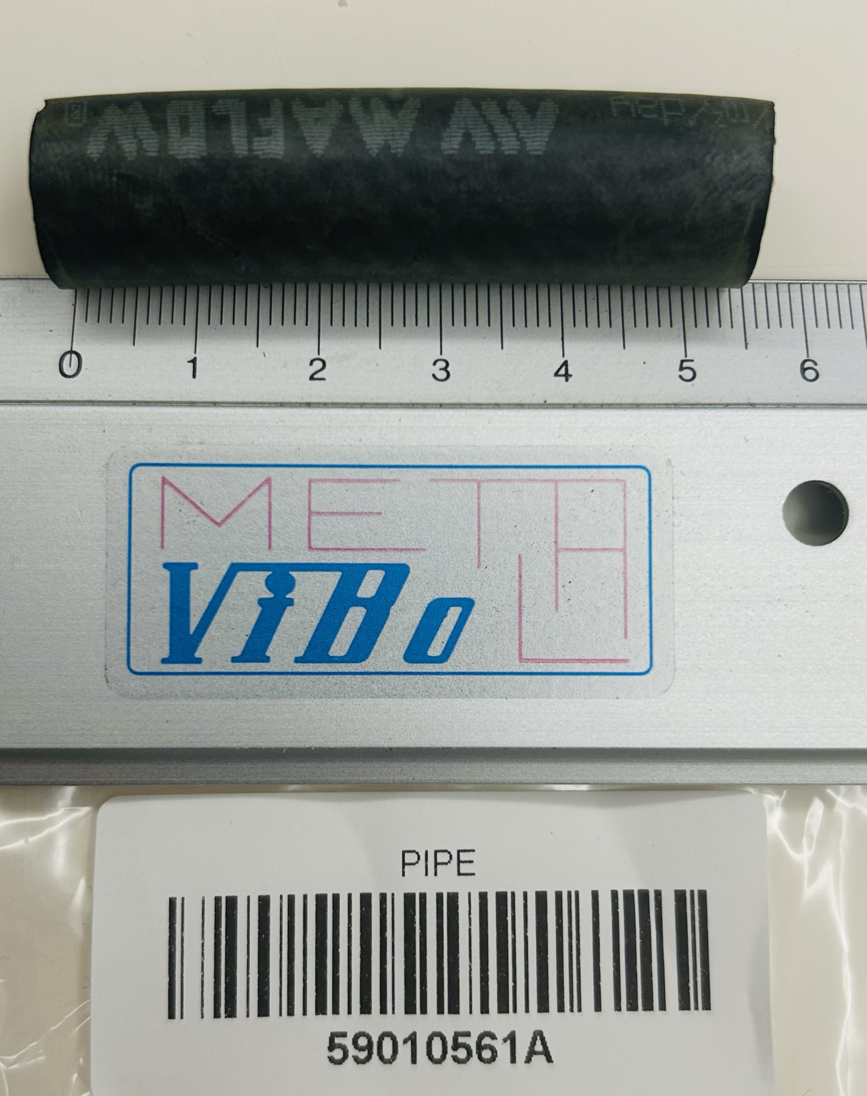

  1. Been hearing some squirting noises from the fuel tank on start-up and I am led to believe that a submersible fuel line from the fuel pump assembly has very likely failed/split. With the fuel cap open and once the fuel pump primes, I can see some small squirting activity too but can’t actually see where/what the issue is (https://canva.link/xhk3u9f801hckg1). The bike still rides fine regardless, as was shown by a rather cheeky thirty-minute drive earlier today.

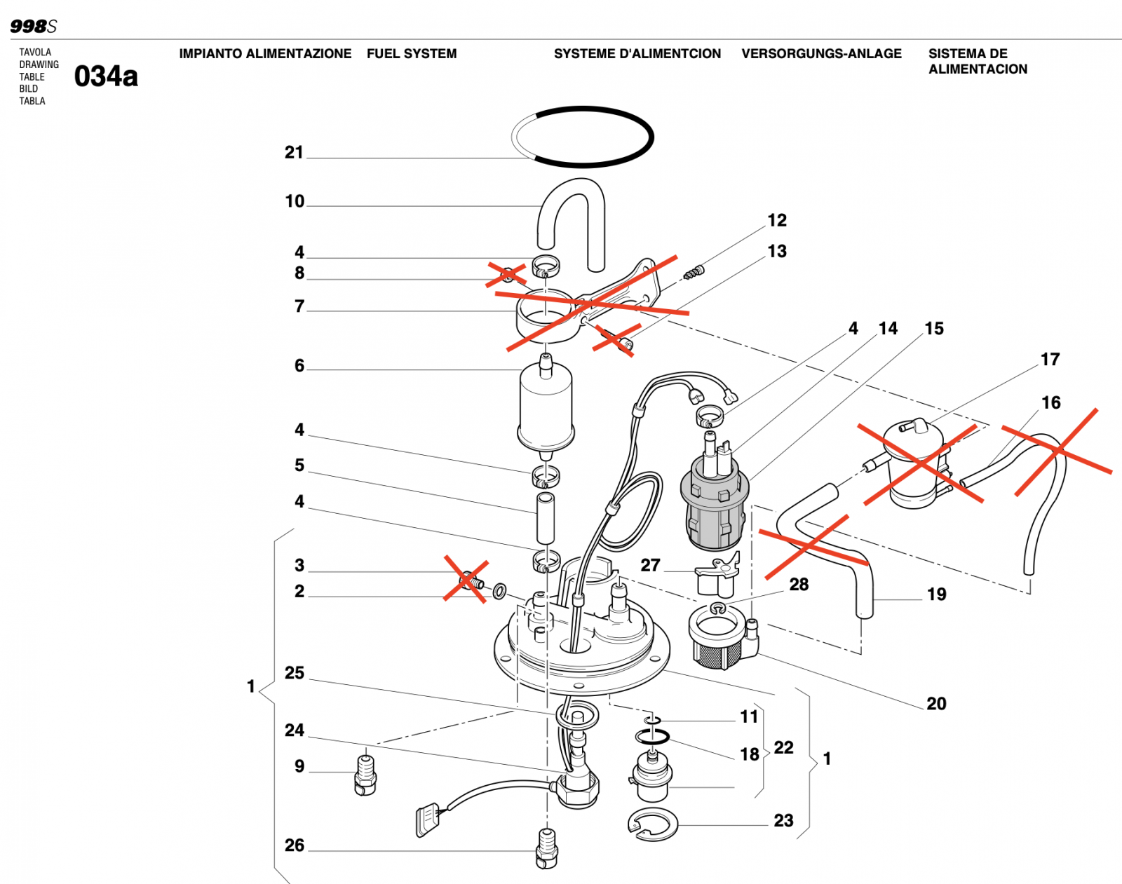

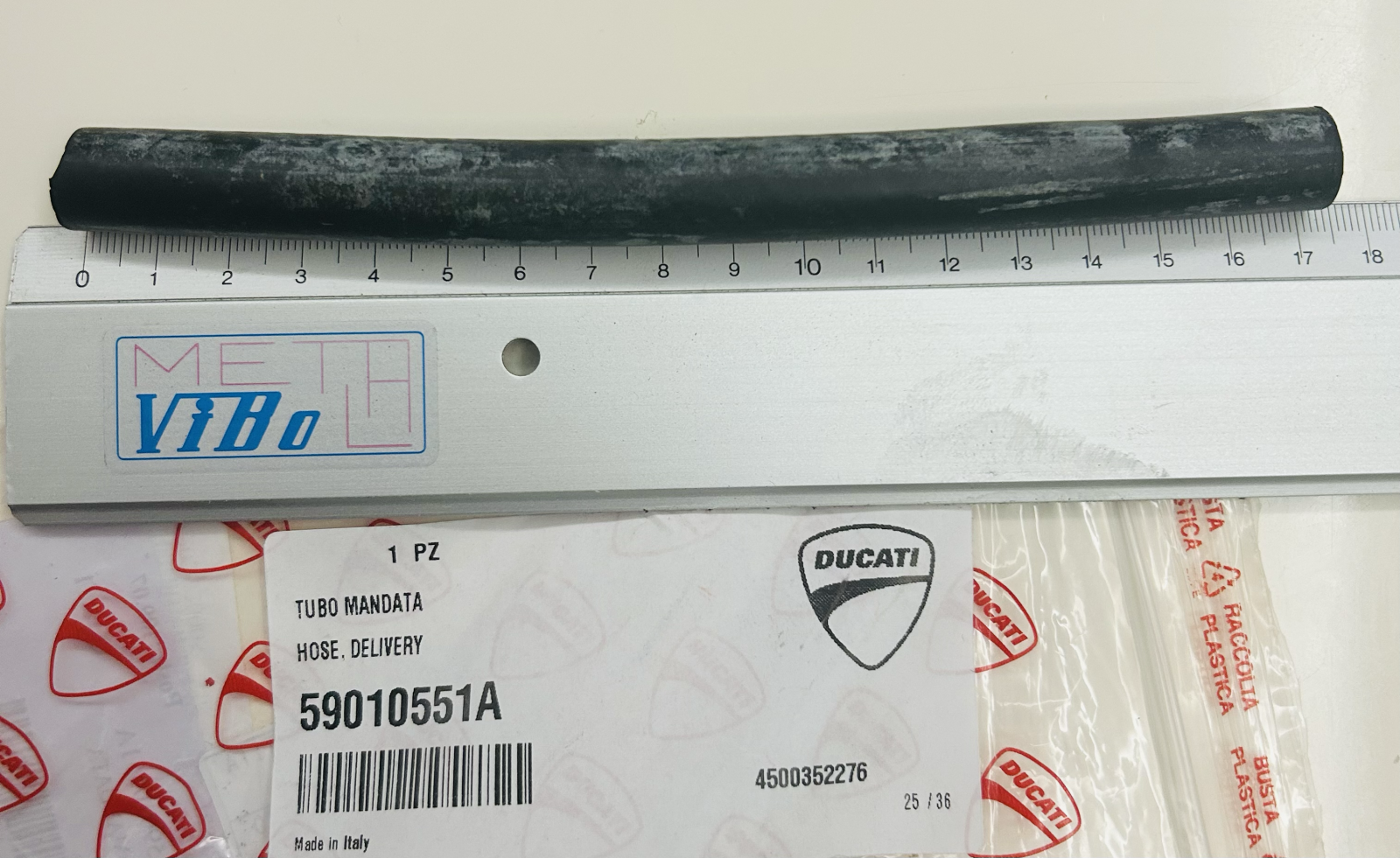

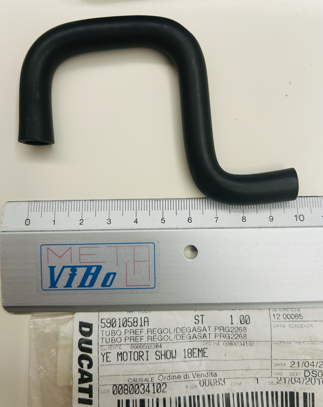

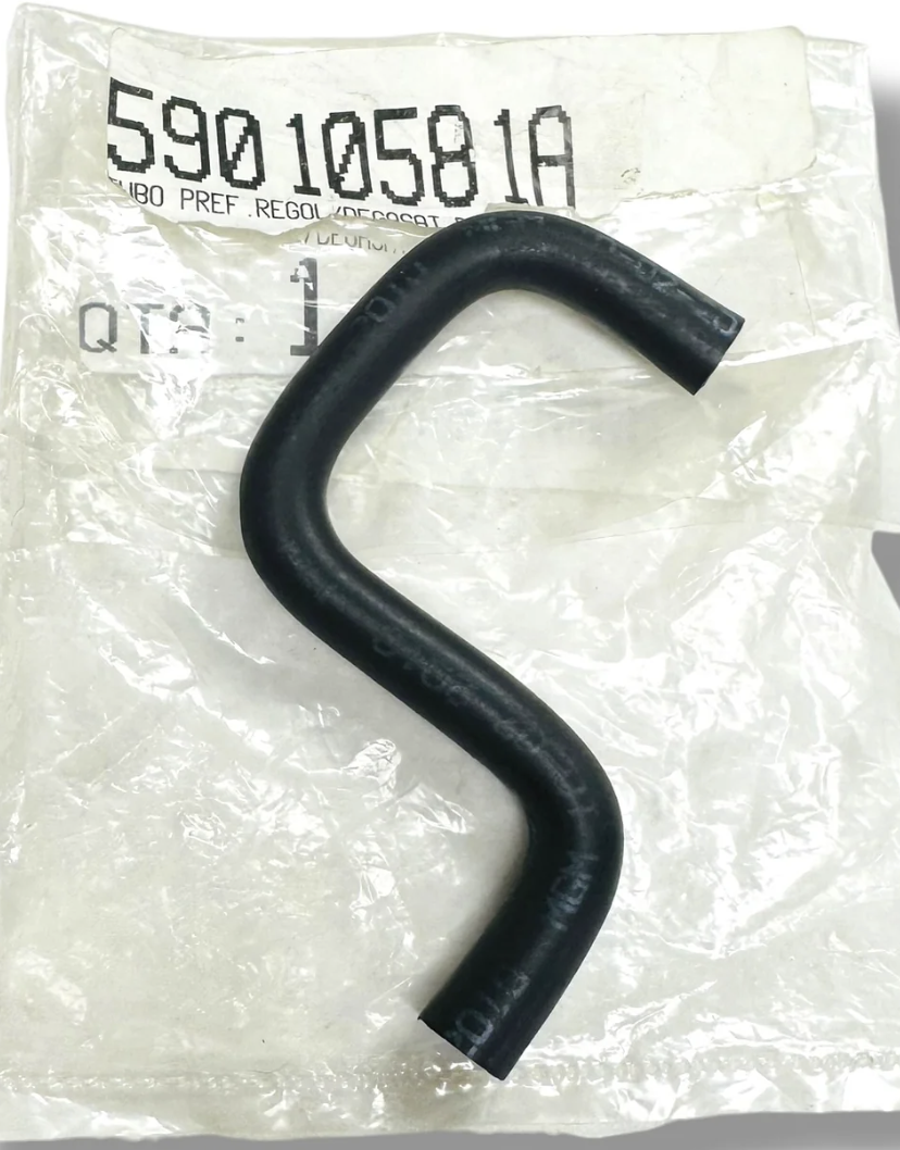

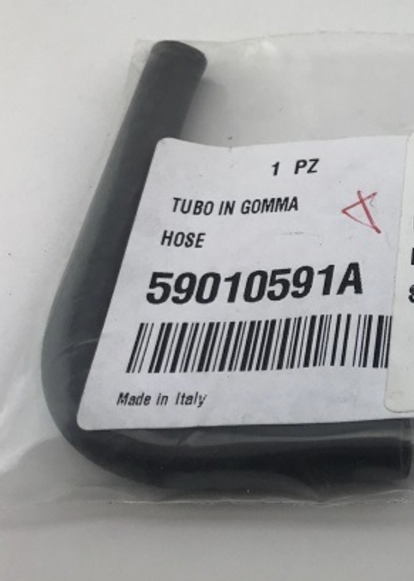

    By way of pre-emptive maintenance and since I’ll be taking the fuel pump assembly out for the very first time after the factory put it in, I’m contemplating to replace pretty-much everything on it (other than the fuel pressure regulator and the base fuel assembly flange/plate where everything bolts on).
    Most submersible fuel lines are no longer available to order from the factory and was wondering whether any of you have found a reliable source for alternatives of equal (or better) quality to do the job. From the factory discontinued fuel lines, some appear curbed but can’t see this being an issue if a non-curbed alternative is found/sourced instead.
