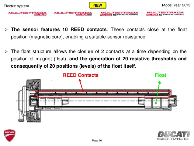

  15. From what I've read it appears the float gets distorted, swollen or similar and then either sticks in one position or is very slow to react. It's been a problem since the early days with all multis.

  18. Did a bit of research, and sure enough there is a float which triggers contacts in a long thin PCB. Evidently the issue can either be solder joints in the PCB or the float swelling and getting stuck...or both!
    Seems like it may be possible to improve the design, and a failed sensor might be fixable. I'll wait for mine to pack up completely before looking at it. In the meantime I might look at buying a secondhand one and having a play.
