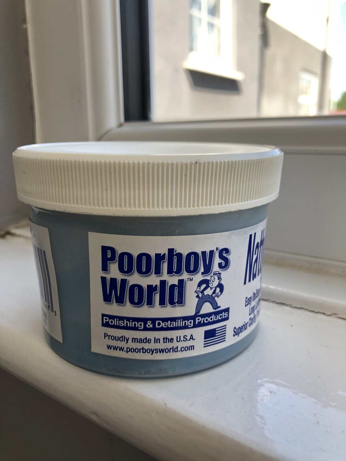

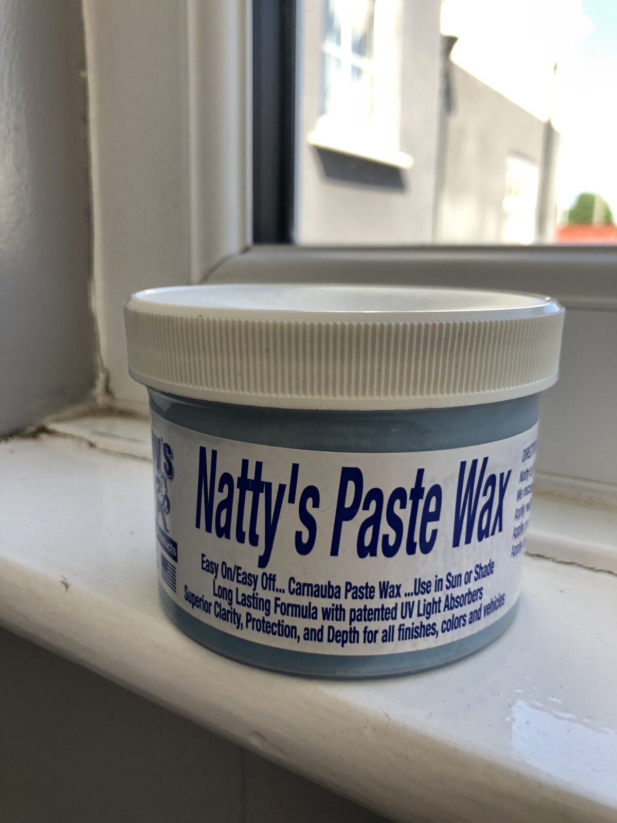

  17. I know this is an old post but I’ve just done the same thing myself. I rinsed it straight away in the petrol station but the white staining was already visible. When I got home I tried TCut, but that didn’t work. I then tried Poorboys World Natty Paste Wax and that’s worked a treat. It’s taken about 15-20 mins rubbing, wiping, rubbing and wiping but it’s now back to being a perfectly clear screen again. I have absolutely no affiliation to the company that makes that product, I just thought I’d share my results with anyone else misfortunate enough to do the same.
