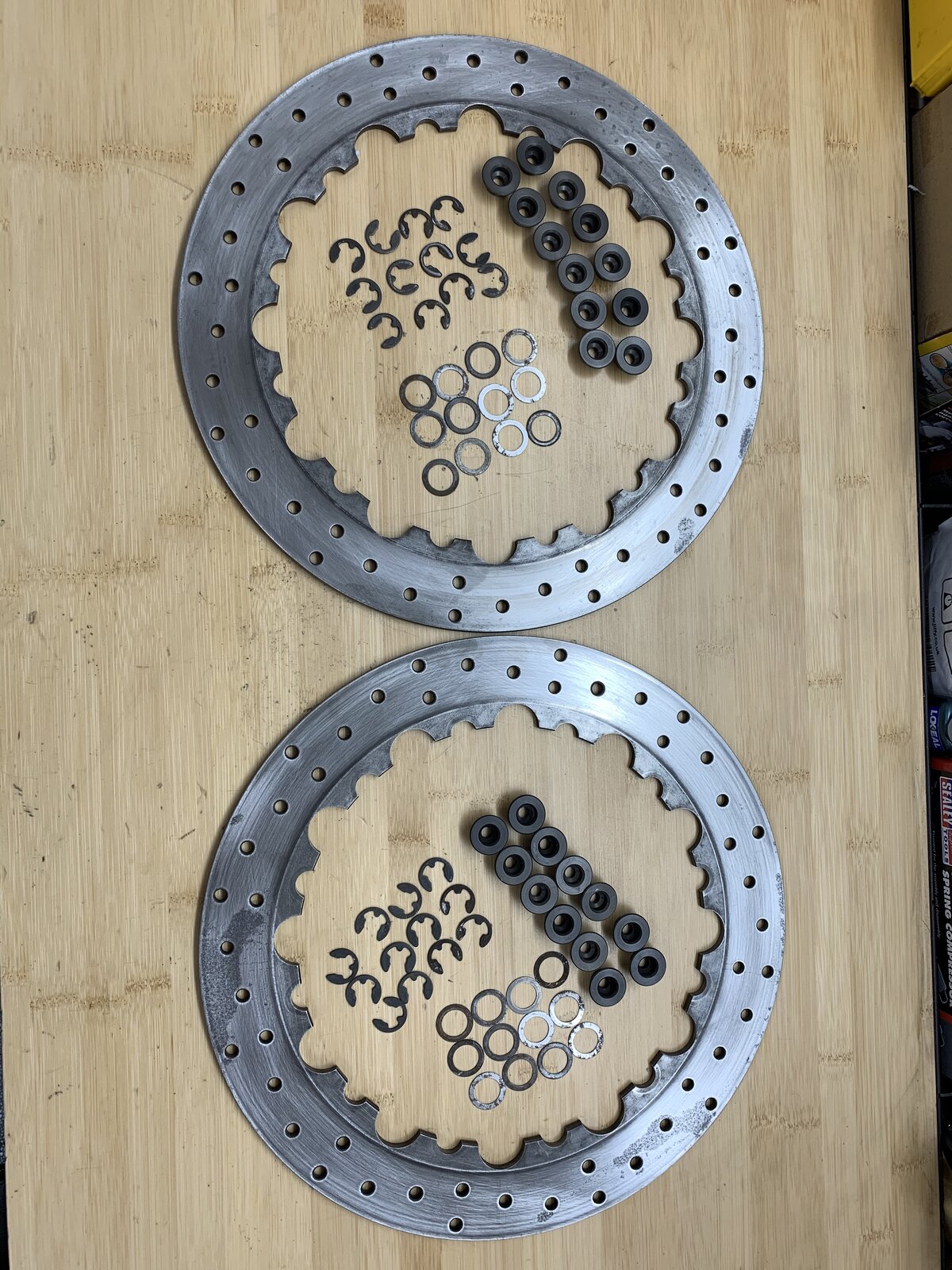

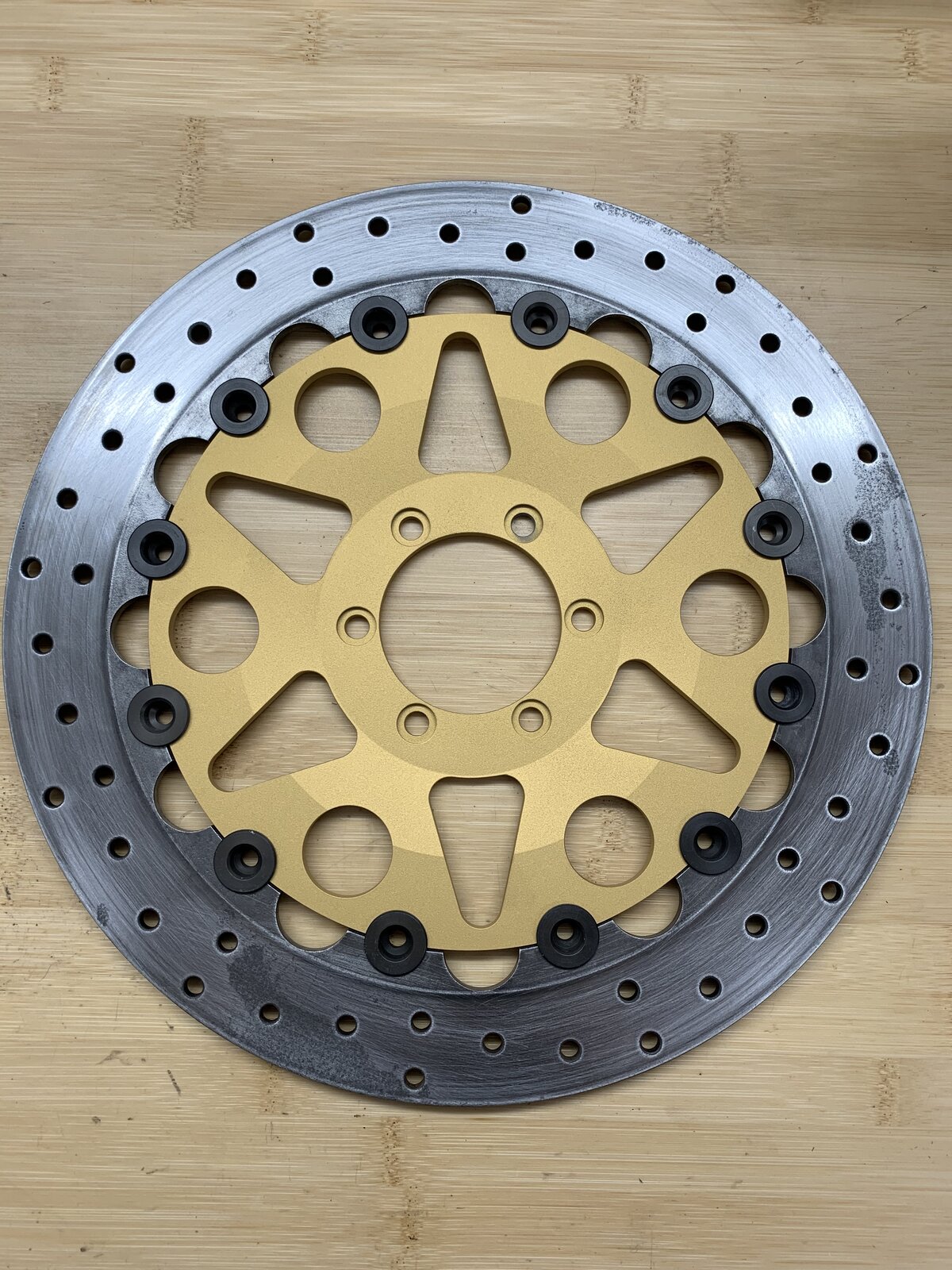

  8. I made some for the early Snowflake discs, made of 7075 aluminium. much tougher than the early brembo discs and I have swapped mine out and kept the outer discs.
    I have 4 pairs left, if anyone is interested.

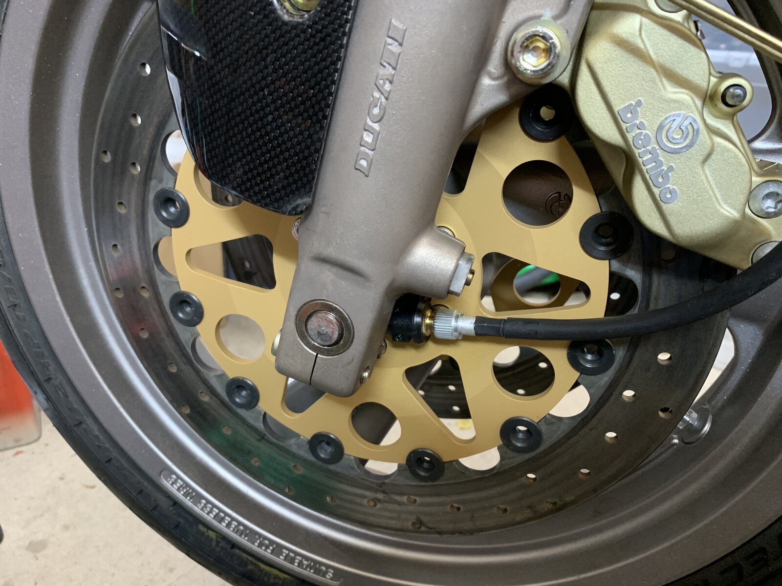

  9. Before and after rotational movement.

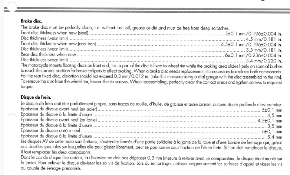

  10. Here is the minimum wear from the 748/916 workshop manual and 3.5mm is the minimum thickness for cast iron discs and 4.5 for stainless.

  11. What years is that covering ? My 2002 748R’s original cast iron disc carrier is stamped MIN TH 4mm. Andy
  12. Not sure of the year exactly, but it would be for the early ones by looking at the models covered.
  13. I will get my discs measured and will be interested if they have enough meat left in them.
