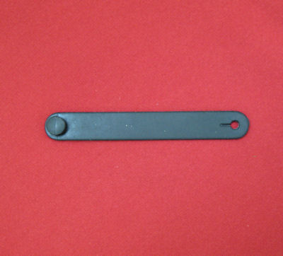

  8. They only fail as are too loose, just pack out with washers, dzus fasteners are counter intuitive, look at the design, impossible to undo as you push and twist to undo. Unless you buy the copy versions which will ultimately work loose...Or apply lockwire so they can't twist. Unless your fairing tabs break, thats another matter...But the best solution are the titanium ones...the never come undone!!!:p
  9. oh, believe me they fail and they don't necessarily have to be loose but at the same time there's nothing wrong with the design or application, as a quick release fixing, it's perfect.. stopping there as off topic.
    #29 Chris, Jun 16, 2019
  10. I bought titanium dzus/receptacles for the sps, as found, even on non-ti genuine dzus, that the receptacles tabs become worn making the dzus fastner itself pretty easy to fall out. But like you say, they are great for quick access. Don't know any other alternative apart from nyloc nut/bolt or straight-thru lockwire, bit of ballache though
