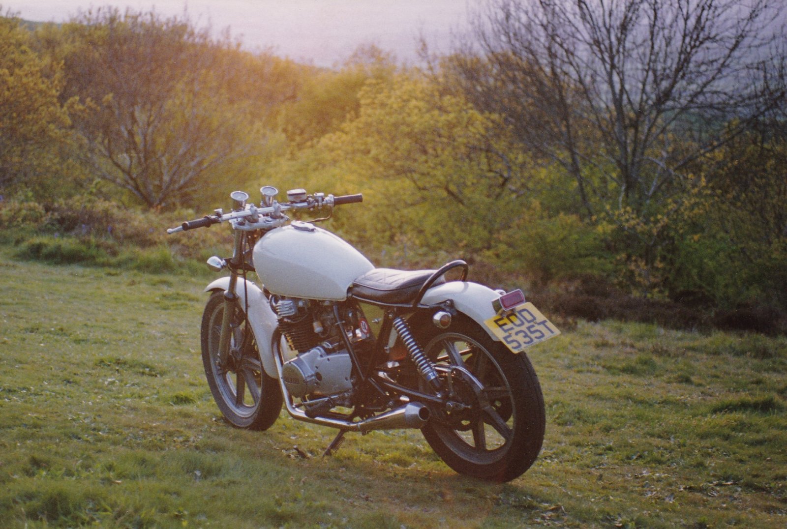

  12. Iracroft formed the stainless pipes for my one and only custom build: IMG_20140826_0006.jpg
    Think it might have been before you time though, about 1993/94.

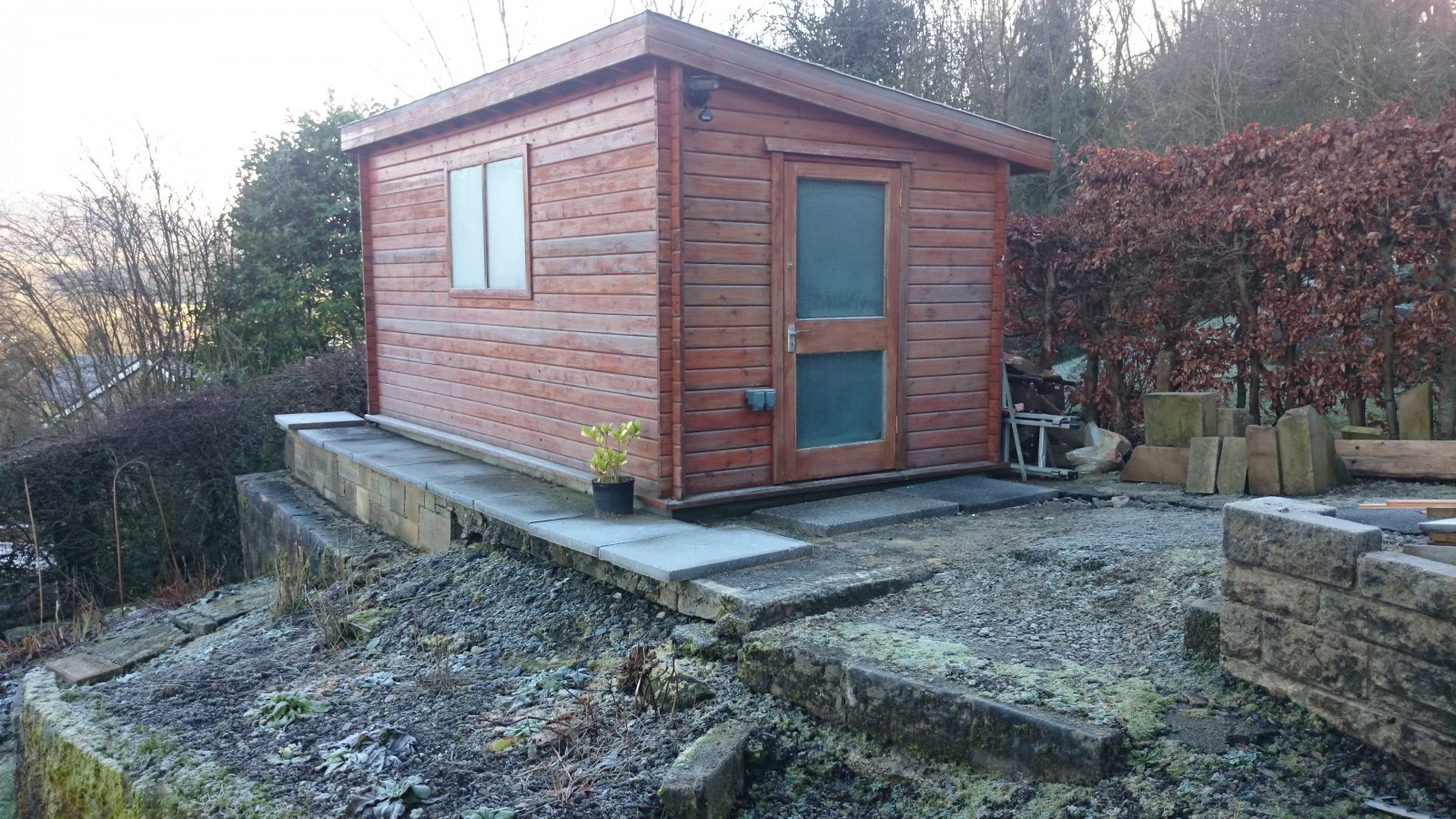

  19. I built this one about five years ago, the concrete base cost £200 and the log building 32mm log half lapped at the corners and a felt shingle roof, it cost £700 and measures 5m x 2.4m internal size. I keep bike parts, model helicopters, planes and joinery machinery in it and have no condensation problems.
    Steve
