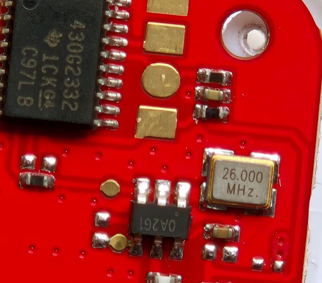

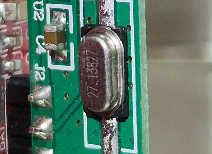

    Opening up my remote and receiver I was a little surprised to find Oscillator crystals at @26/27Mhz, which is the frequency used for remote control cars etc and worries me with regard to security.
    Receiver:
    Remote:

    Can the units be transmitting at 433Mhz using 26Mhz Oscillators? I doubt it.

  2. Never worked on remotes as they are all made in Asia. The Oscillators and Crystals can't run at 433 so they shall be upscaled to the frequncy needed., one of the "little black spiders" shall do that. 433 is the low power no licence standard in UK. This is the carrier frequncy. The info/data frequncy (which is modulated on top of the carrier frequncy) shall be very small maybe Khz
  3. Can you identify a frequency multiplier on the circuit board? Something like a 16+ PLL.
    Does not really make sense when the correct frequency oscillator crystal could be bought just as cheap.
  4. Check the spec of the MSP430G2332 for 433mhz

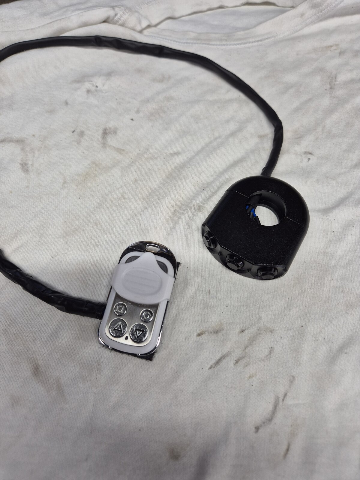

  7. Thought I'd update this thread.

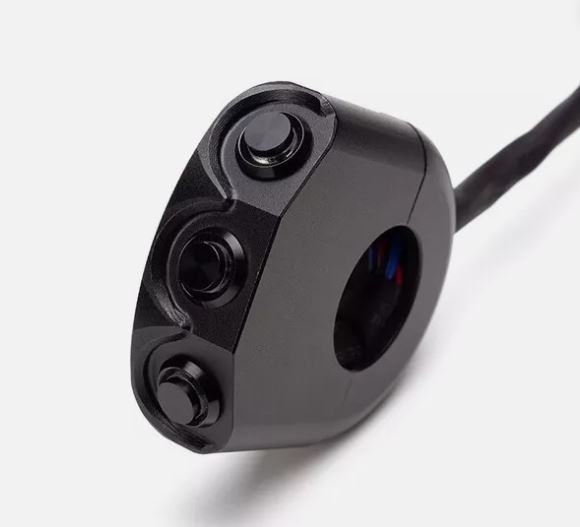

    I brought one of these:
    https://www.ebay.co.uk/itm/393871967236
    Cut out the backlighting wires as I didn't want to connect to the bike at all which reduced the loom size significantly.

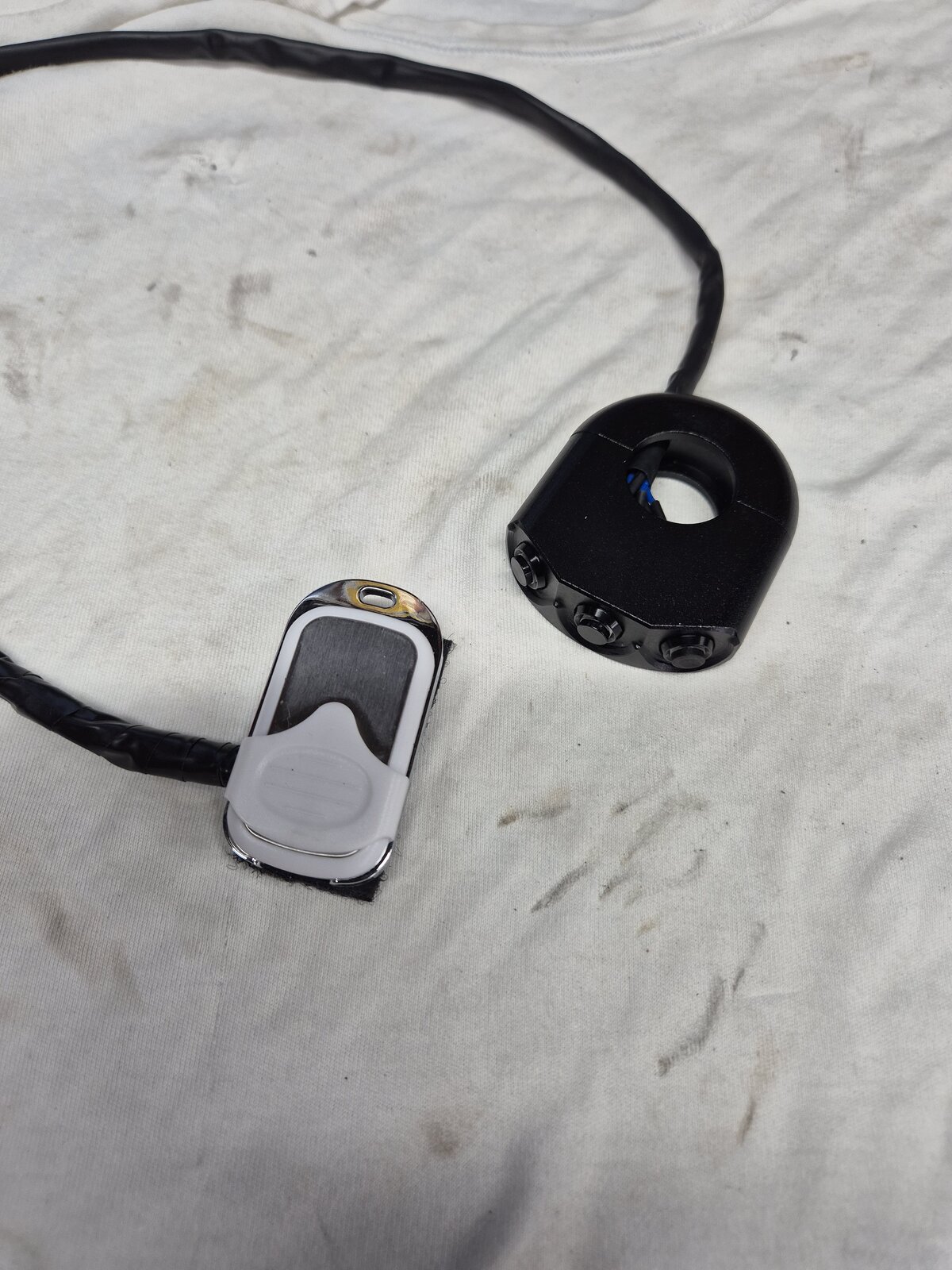

    Then stripped one of our spare remotes down and soldered the wires from the handlebar switch either side of the Up, Down, and Stop buttons:
    Note the slide still covers the buttons, and they still work if needed.

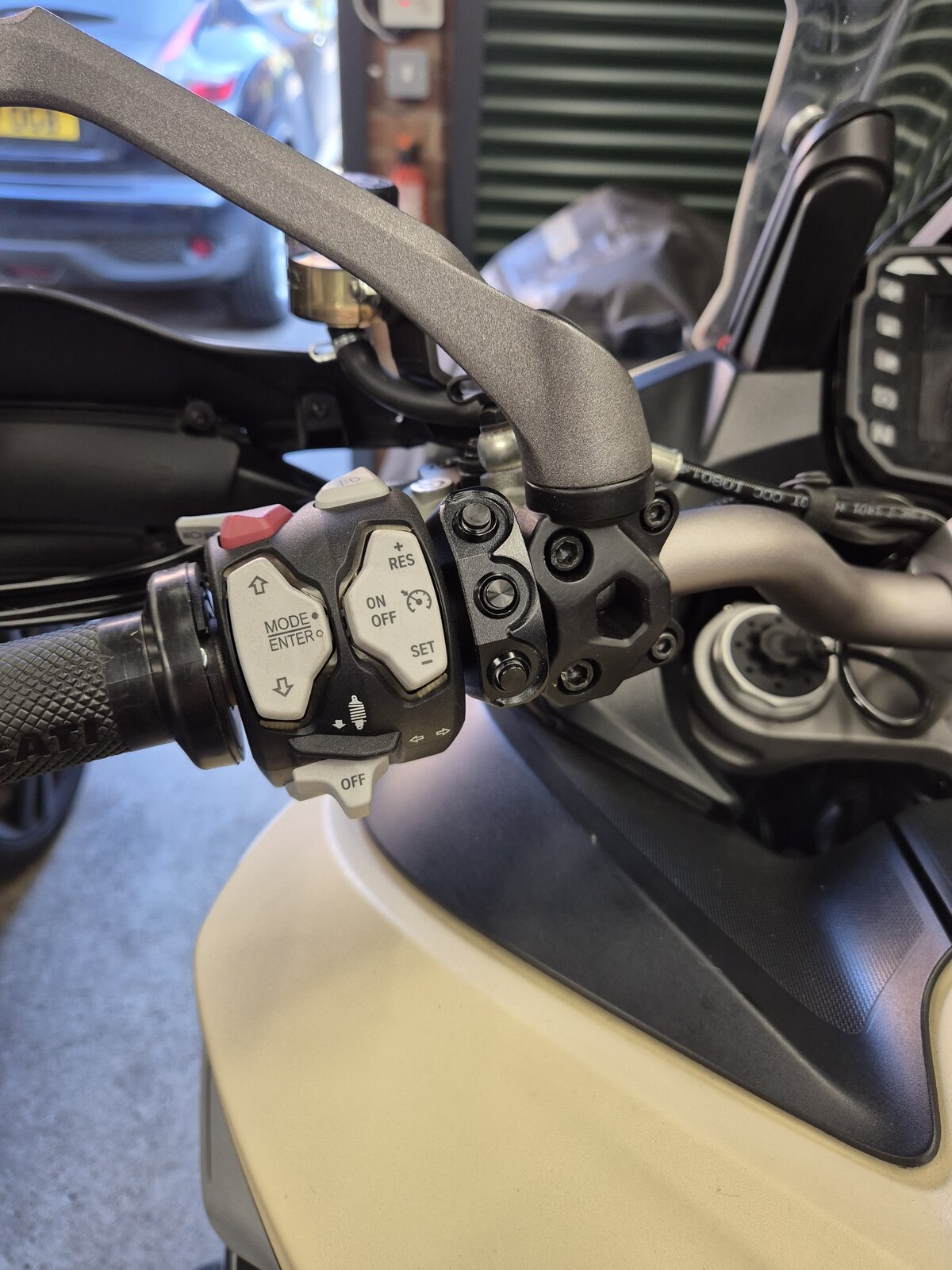

    The switch was then simply added to the Left hand handlebar, and the remote stuck under the nosecone plastics out of the way with self adhesive velcro:
    It worked fine when I tried it, so now I can push the up button as I approach the garage, and the down when I leave.
