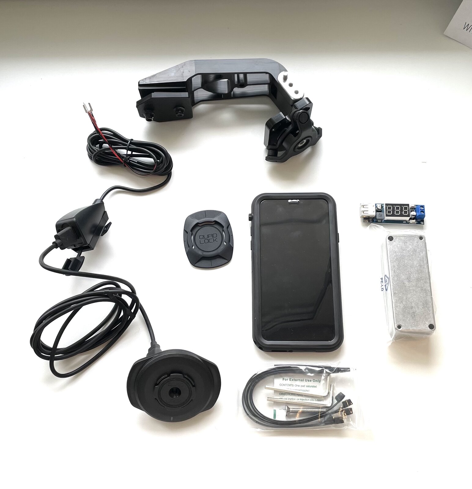

  1. Would like to hear your opinion. Will this work or should I switch back to Garmin?
    -Quadlock wireless waterproof charger (their offer was missing some cables)
    - Iconic parts navi holder (how to stop the vibration at high speed?)
    - Waterproof USB dock (will be connected to MTS1260 factory power cable)
    - Quadlock stabilizer (this might fix the Iconic part, vibration issue)
    - iPhone X (should not have camera issues due to vibration as newer models)
    - Sygic navigation app (30€ per year with support for offline maps)
    - Hitcase for iPhone X (makes the phone waterproof. What about heat resistance?)
    - An alternative waterproof USB card (if the waterproof USB dock does not work)
    I do trips of 4K-8K in Europe in all weather conditions. Is this the way to go?

    I'd go for a Quadlock case.
    I used a Quadlock mount without a dampener with an iPhone X without issues. I now have a 12 Pro, and installed the dampener to be on the safe side.
    The charging head works well - I have mine connected to a 2.1 amp usb connector. I can use satnav, track my ride and stream bluetooth music, and still charge the battery. Be sure to seal the USB-C connector to the head to prevent water ingress. This is supplied with later models - I was an early adopter and used Sugru.
    Once you're down the phone route, navigation software is down to personal preference. I haven't used Sygic, but believe it's well regarded. Lots on here use the myRouteApp system to create routes for loading to Garmin devices. I use their navigation software too (can't remember the annual fee, but it's less than €30) and am happy with it - uses the same routing as Garmin, so is compatible when it comes to sharing routes.

  4. If end up switching to Garmin what's the best way to attach the Garmin Zumo XT on a Multistrada 1260?
    The Iconic navi holder looked good but it attaches to a part of the bike, that is vibrating by default. In combination with the length of the Iconic navi holder the vibration at 100km/h becomes very strong.

  7. https://www.rammount.com/part/RAM-B-367U. Successfully fitted to my 1200 Multistrada and an 803 Icon. Andy
  8. If you're not using a tank bag one of those would work well. I used one on my 1260 whilst waiting for my higher mount DP mount to arrive. The higher mount, although it does vibrate/flap around a bit, is more in your line of sight.
    I find the that Zumo XT is better in terms of vibration than the Zumo 590 I had previously. I put this down to the fact that it's significantly lighter.
    If you don't have an XT, or other Garmin that's comes with the parts, you'll need other RAM components to make up your mount. Such as a short or menium arm and an AMPS base plate with 1" RAM ball.

  10. I’ve got an original Navihalter I was probably going to sell (the original German one) which also has the 3D printed spacers that bring it slightly away from the screen. Used it with a 595 (heavier) and my XT with no noticeable vibration that I could see. I’ve used it with a normal screen and a short Pikes Peak screen
