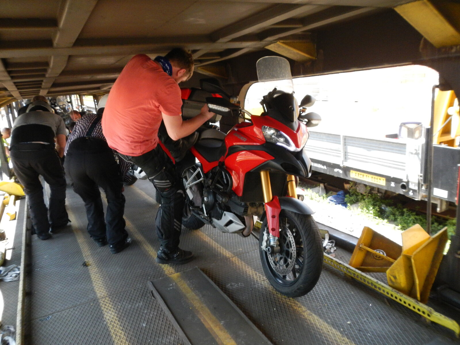

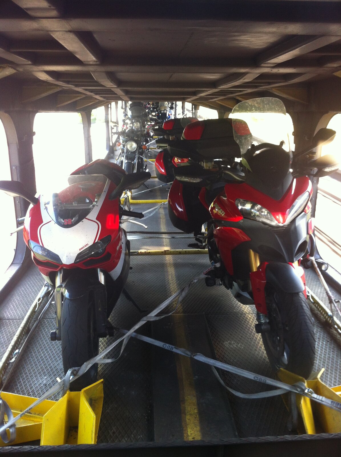

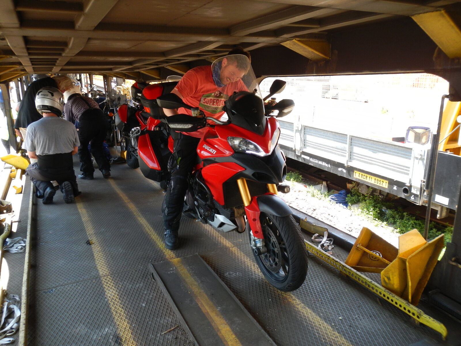

  14. @Biot - you did really well not to knock yourself out riding your bike off that train :)
    @Biot
  15. It was bloody close at times I can tell you:upyeah:
