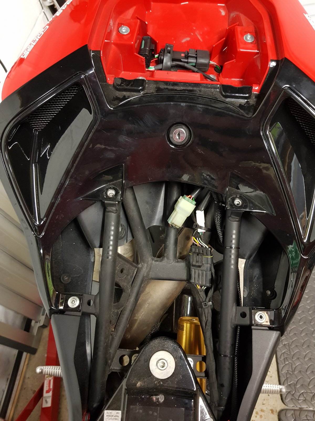

  4. No problem at all. This evening I rewired it but added some heat shield as ice attached in the picture. Plus with the finished result.
