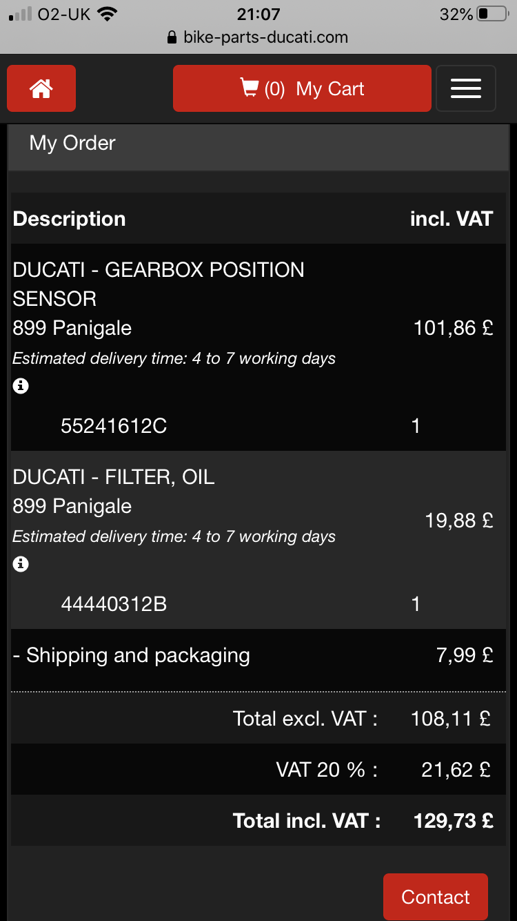

  10. Unfortunately I haven’t got a ‘Local’ dealer so found this whilst searching online.
    Will do @IanR.

  14. Hasn’t arrived yet, hopefully today!

  19. Update: @IanR sensor came yesterday and I managed to find time to fit it this evening. Was just plug and play and worked straight out of the box as @nelly and @khmer1199 said. Haven’t had chance to ride it yet but ran though all the gears on the paddock stand and always came back to N. Thanks for your advice guys.
