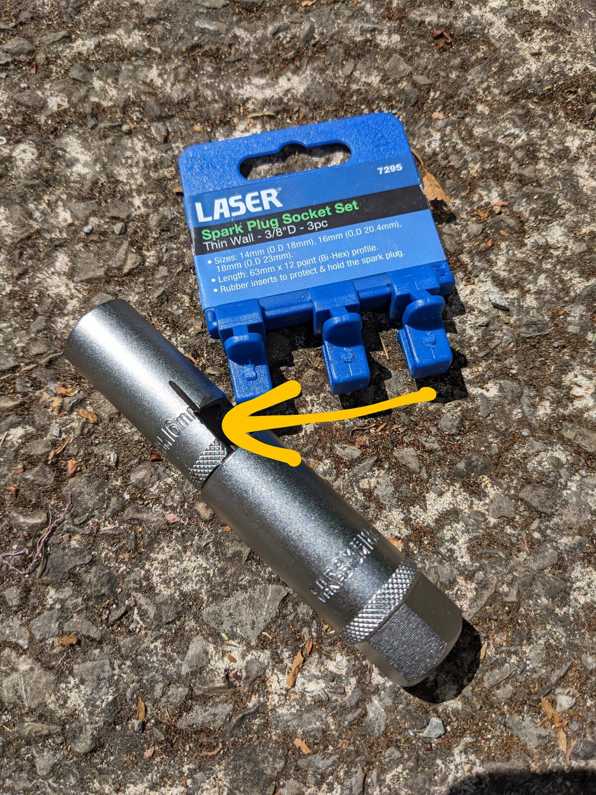

  7. It's a 16mm (deep) hexagon. I butchered the 16mm socket in this set to accomodate the cable and used the 18mm to drive it. Had to remove much exhaust on Hyper - no idea for your Multi...
