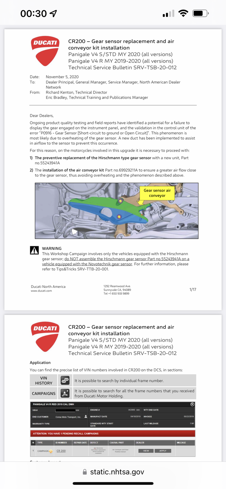

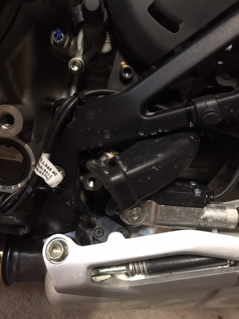

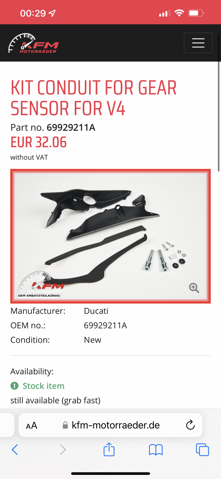

  2. Out of interest did you have the GP sensor air conveyor kit fitted? These were mandated in the US as a factory recall but I am not sure Ducati UK ever implemented it here. Also the QS has heat shield fitted around the body on later models.
  3. Interested to hear more about this
  4. Attached Files:
  5. My understanding is that from MY21 bikes, this design has changed slightly to that in the PDF which is for MY18-20. The heat shield around the QS body is just a piece of reflective film, tie wrapped around it. Easy enough to replicate.

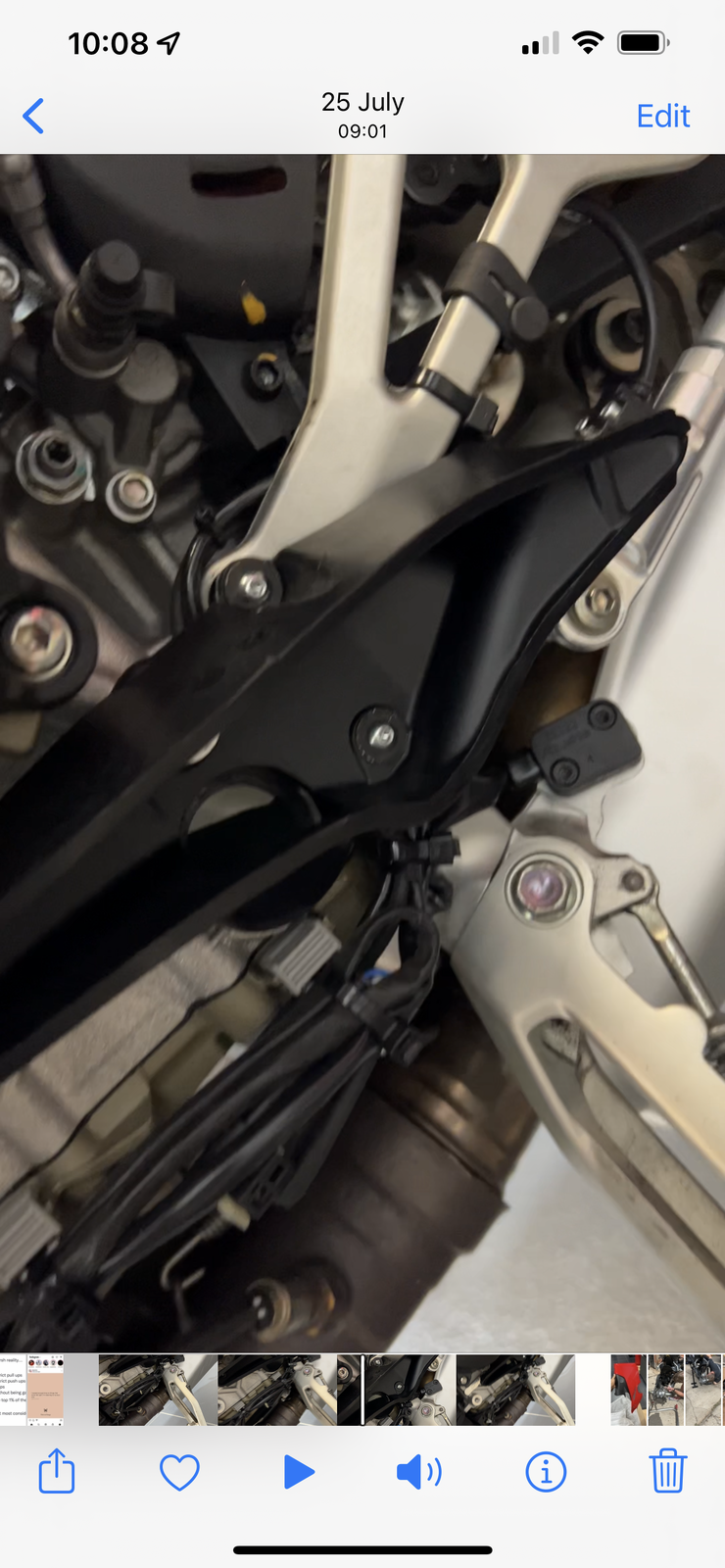

  6. Yes mine failed in mugello and hyside fitted a new sensor with the new air vent guide under warranty . So the brand new sensor only lasted 1 day at snetterton and 1.5 days at almeria. Disappointed with this ducati part - Big time . It’s my 2nd sensor to fail.
    seems they haven’t changed the part number since 2020 either

  8. Kaspar, I'm assuming you had the 'Hirschmann' sensor on your bike, looking at that part number. Allegedly the later 'Novotechnik' sensors are more reliable and the air conveyor kit is not meant to be fitted if that is the sensor on the bike. Saying that the 22 bikes have a slightly different vent setup, so perhaps even these newer sensors are prone to failure and require additional cooling. Did you read the thread on the US forum about heat sinks? It seems even a small stand off from the crankcase surface, might increase the longevity of the sensor's working life.
  9. This is the new style duct on MY22 bikes.
