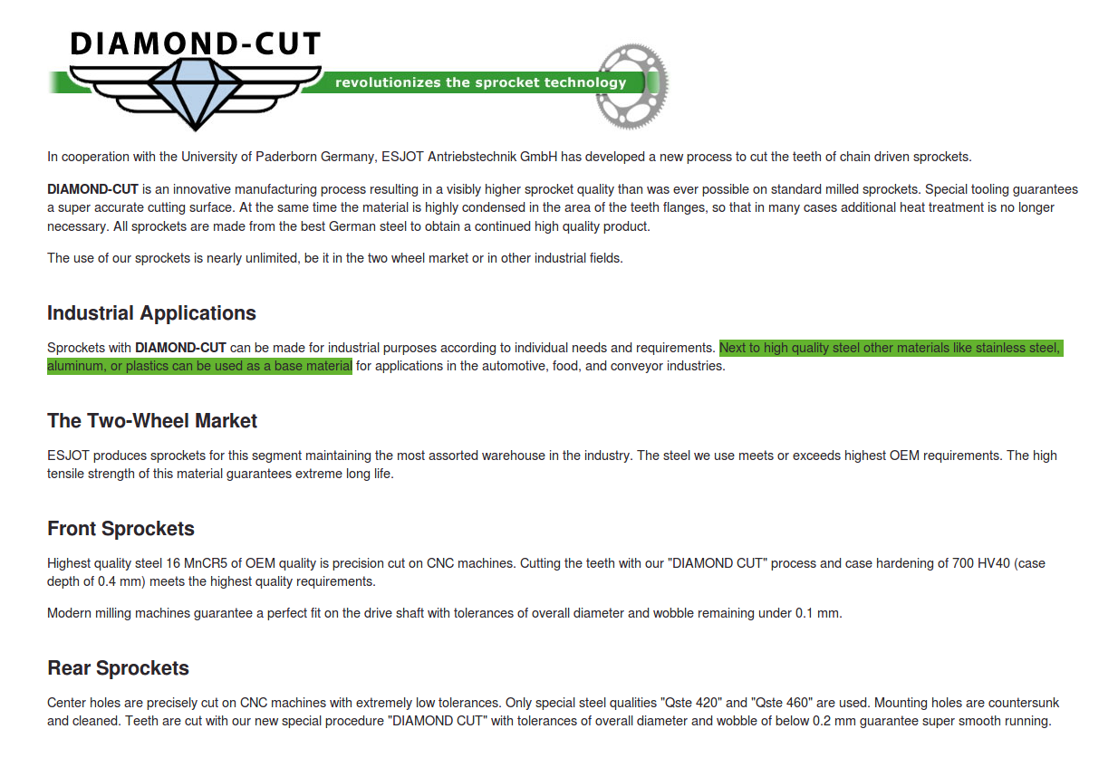

  6. Stainless you say? I always though stainless was too hard for sprockets.
  7. #8 DarR, May 28, 2019
