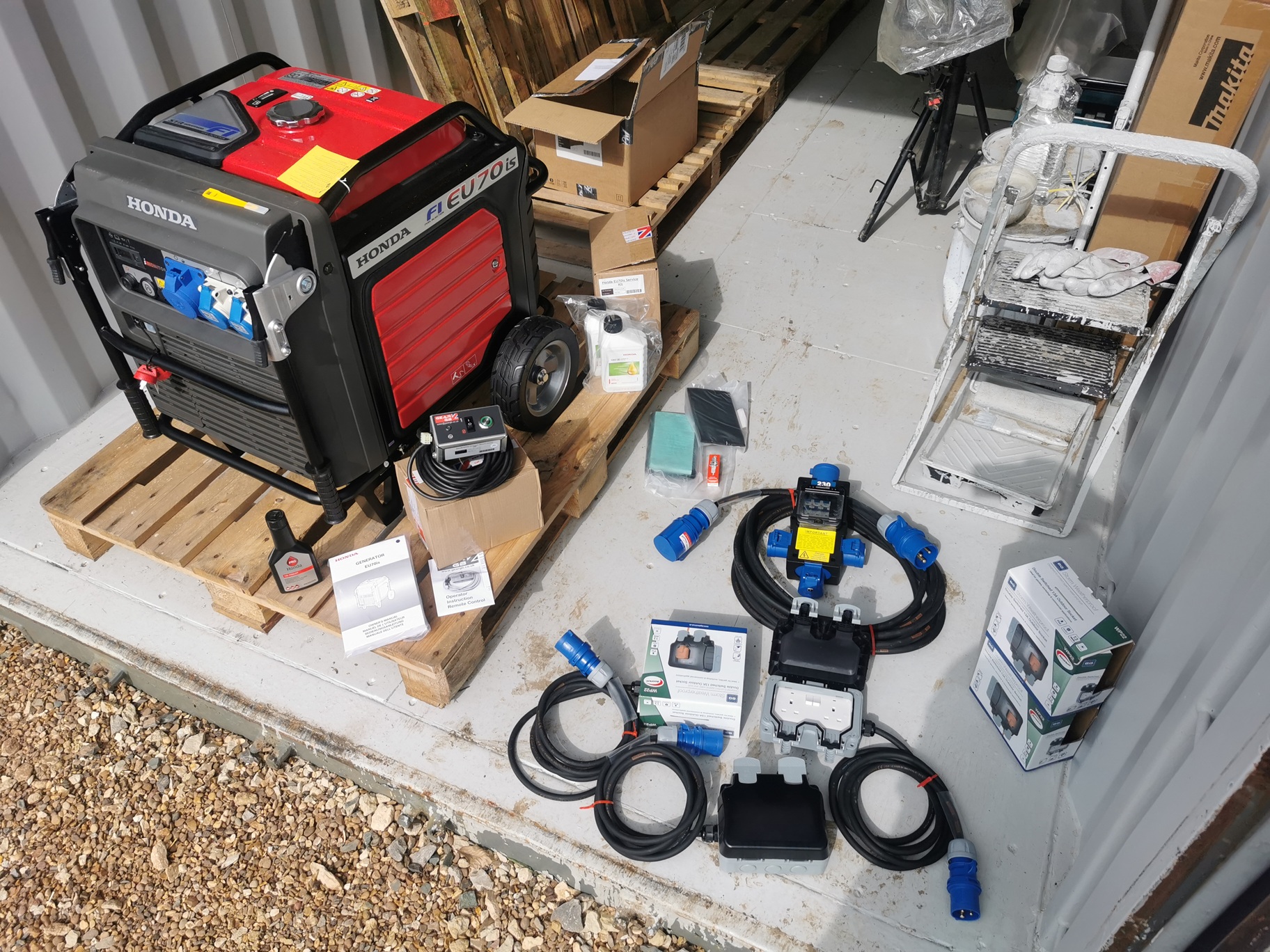

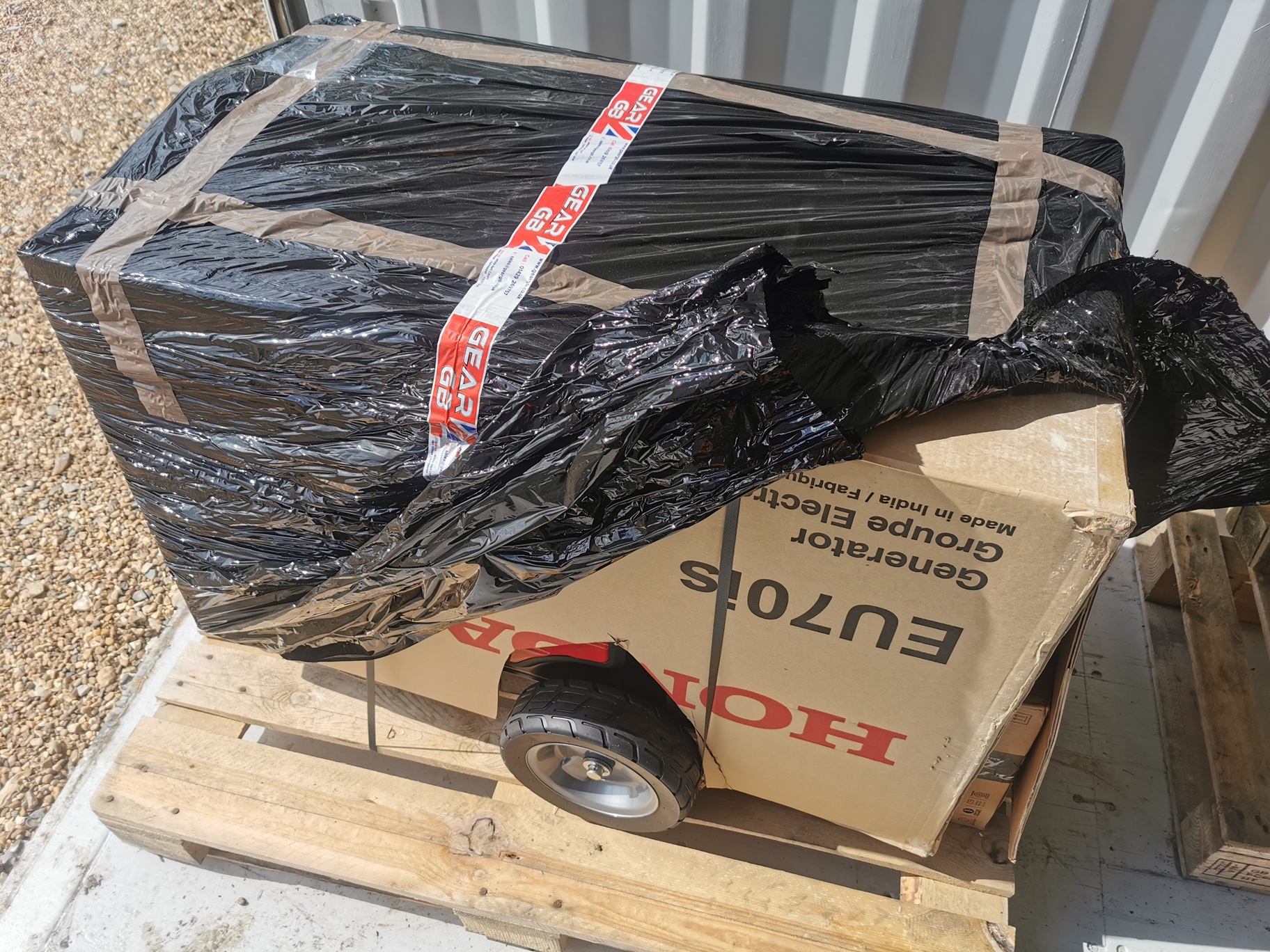

  6. Just brought a new honda eu70is with all the extra bits-n-bobs. If you want the best electrical pure sine-wave for equipment don't skimp. Because our expensive phones & laptops & batteries need smooth true sine wave low harmonic distortion signals to last!

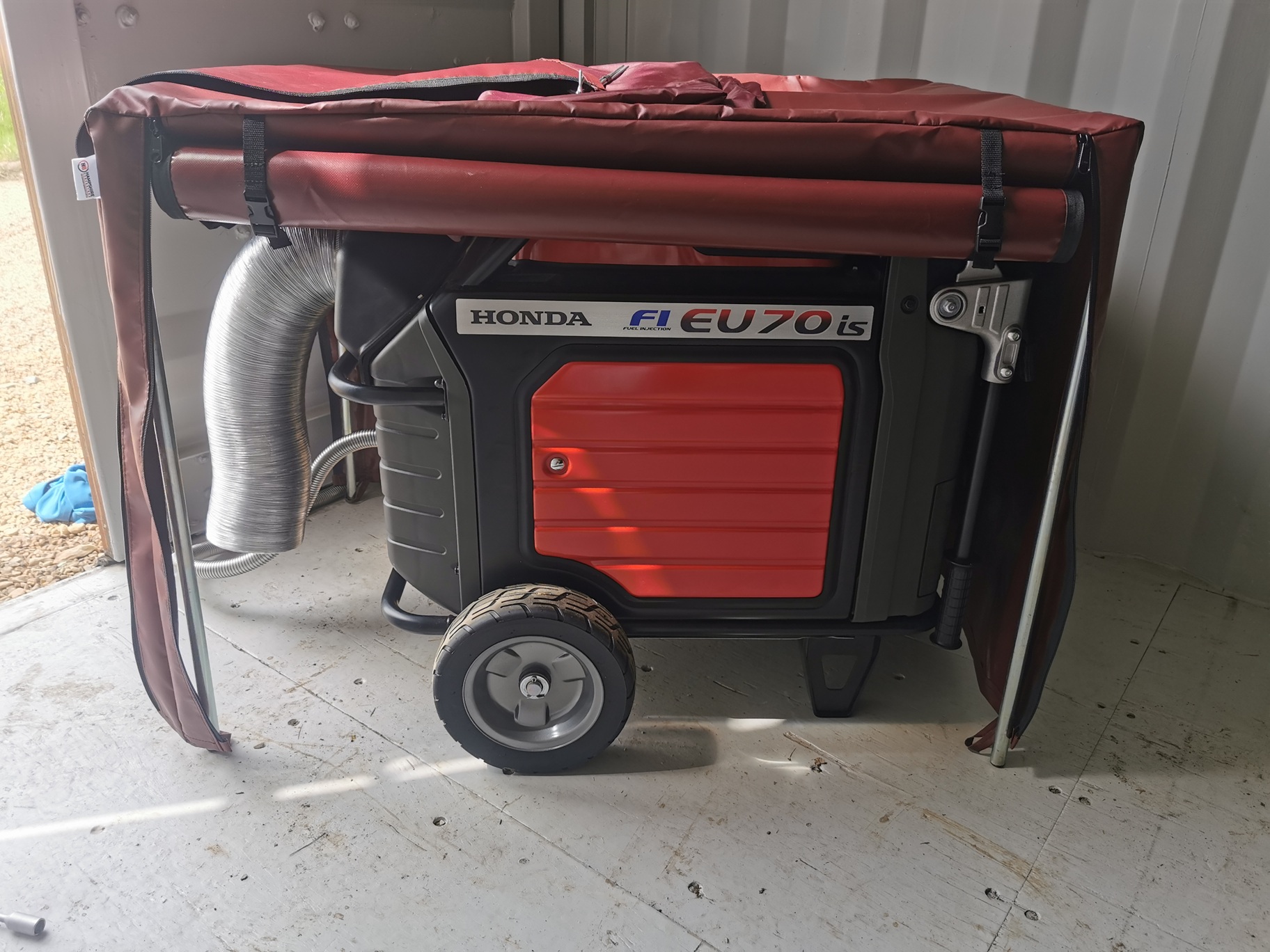

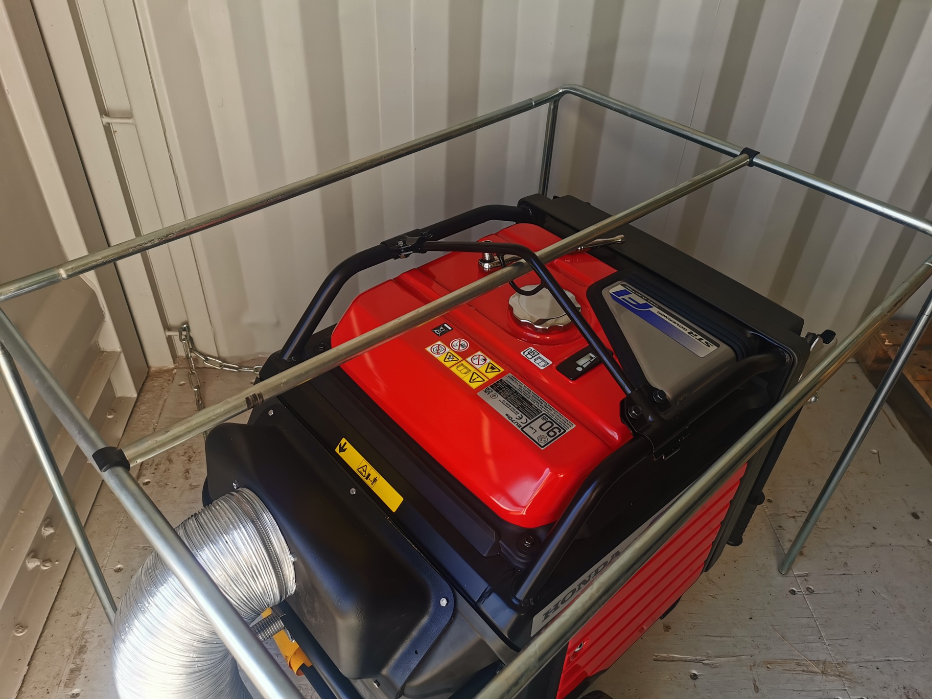

    https://www.hampshiregenerators.co.uk/ large cover, will be tweaked so both ends are unzippable.
    Honda lifting kit for eu70is when I have my hoist for lorry, luckily the central frame rod sat pukka.
    Overall view of inital purchase kit, without stainless exhaust & vent kit. I have a EU26 (obsolete) for my static-caravan jobbie so two service kits were brought for both genies. EU70 kit is emergency power for my lorry project & power during its contruction phases.

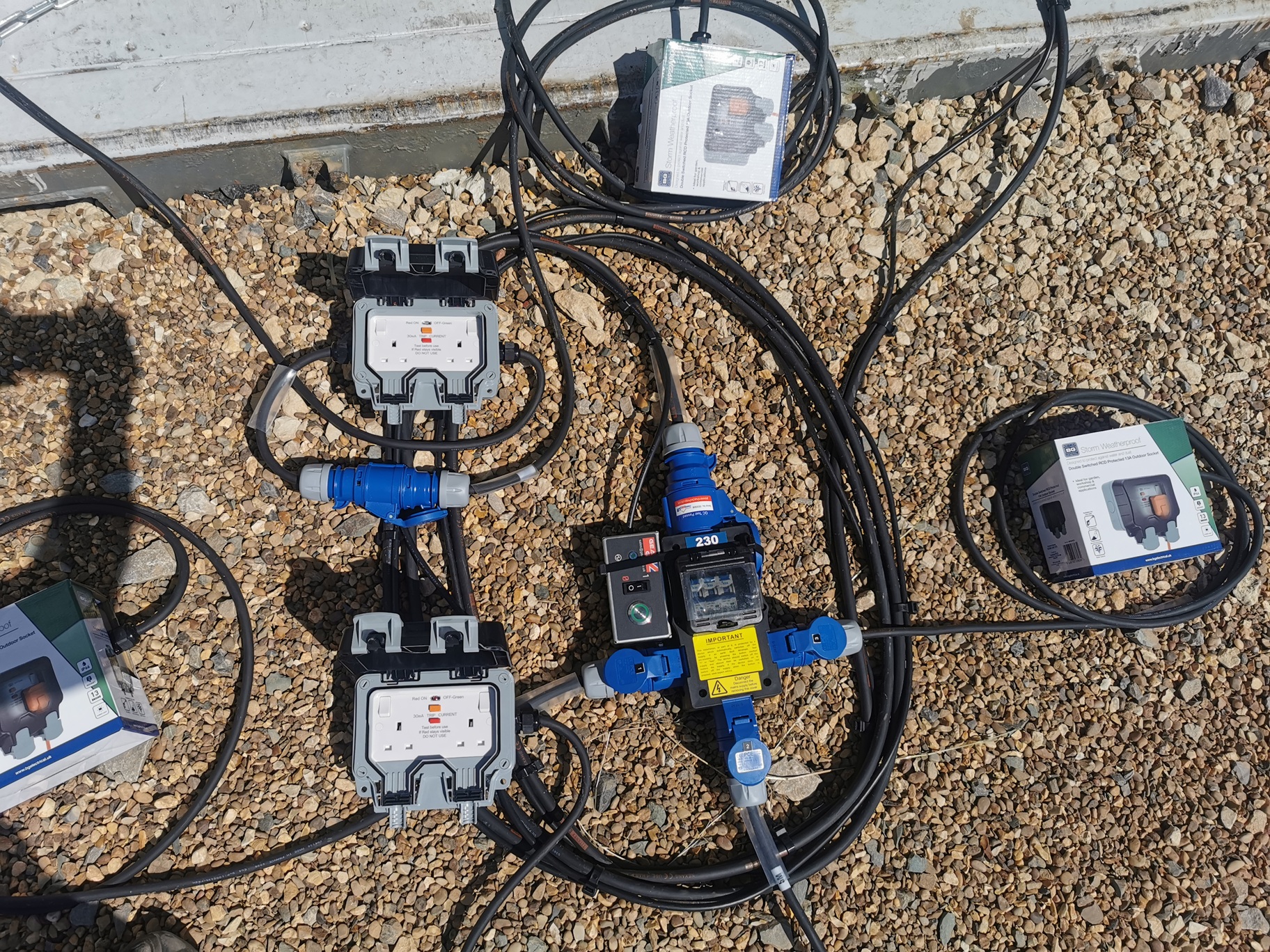

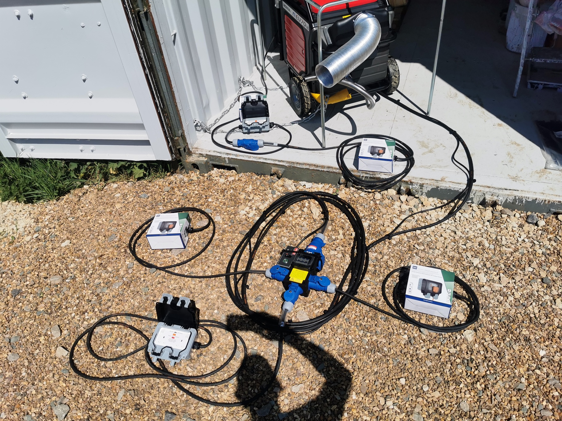

    https://www.simplysoundandlighting.co.uk/ PCE ST ANTON Distribution box 32A with 10-meter cabling & https://www.geargb.co.uk/ remote (better than OEM remote) strapped to it.
    https://www.powershackshop.co.uk/ very kindly made a specific lead for me, 16A RCD 13a waterproof to 16A outlet allowing me lights inside my container rather having several leads creating love-lines.
