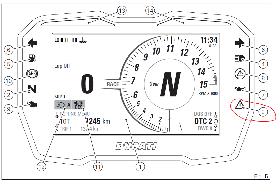

  1. Anybody have any idea why this warning light is permantly on ..
    I have full akra system and ducati race faring kit, so no lights front/back etc...
    1st session out this light came on, checked manual and its a generic error of some sort - but not the ECU.
    Bike was performing fine on track..
    Called Ducati and they stated that if bike is running fine then ok to use but bring bike in for a check
    Bike checked by Ducati - zero errors (alerts for lights disconected showed on laptop) - they cant tell me why its on as none of the electronic modules are showing errros .
    So Ducati are stumped.. and asked me to try the bike in street mode on the track and see if it goes out , if so then take a picture of screen, put it back in race mode and see if it comes on again take another picture of the screen, them thinking its got to do with being in race mode etc..
    The issue i have is that while its on, IF anything did fail - like abs, qs etc i would never be shown on the screen as the light is permantly lit..
    I cant find anything in the manual or online about it..
    So wondering if anyone has a similair issue in track mode with zero lights ..
  2. Might just be a dodgy light blank or something? If there's a problem with ABS or QS or whatever then the other lights will come on anyhow so it's no big deal really. ABS has it's own light. QS failing rarely shows on the dash anyhow, it just stops working properly. Engine or other serious issues will flash up on the screen in large writing. Lots of people who dont have the light blanks ride around with the warning lights on all the time.

  4. Nah, you’ll be fine. And yes, you get the warning ⚠️ light on the dash when you disconnect your lights.
    If you stick a resistor across the pins it might ‘fool’ the ECU and clear the fault. I’m not sure. I’ve got the same thing mine but just give it a good ignoring.

  13. The yellow triangle is due to the DLR light being disconnected , either ignore it or Ducati can cancel it for you
  14. Hi. So to update on this. Ducati said the same, that it was the DRL light causing this. I thought it was the tail light dummy connector because when I plugged the tail light in it went out. So I received a new connector, same problem.
    Anyway it turns out that even Ducati were wrong. With the number plate blank comes a little dummy connector which stated to be used on V2 only. Even the pictorial showed the V4 wiring simply tucked away so I thought I’d give it a go anyway, I plugged this connector into the number plate light wiring and that was it. Fault cleared, never to return again.
