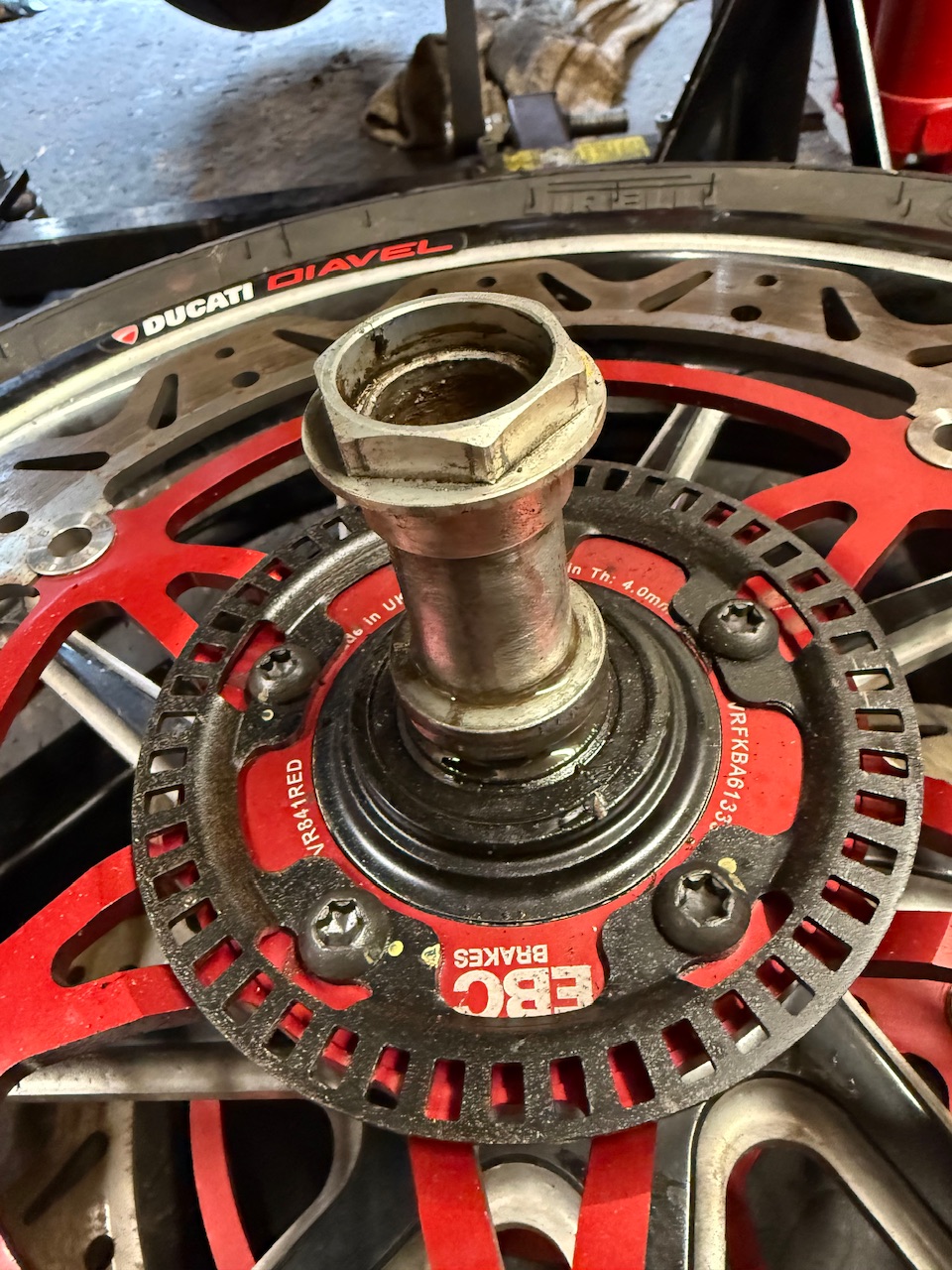

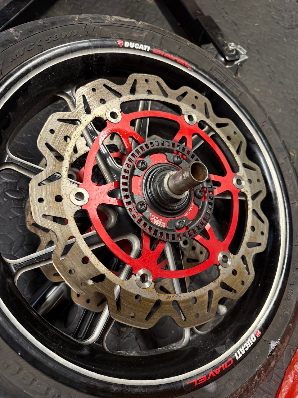

  1. Can you get a three legged puller around the spacer, and protect the end of the spindle with a flat plate? Might do less damage than 'percussing' it against the bearing inner race.
    (Pullers are chump change on Amazon....)
  2. Or summat like a chain wrench round the spacer and a spanner/socket on the nut and see if they can be twisted apart.
    Or how about getting down and dirty with the spacer and hacksawing the b'stard off by cutting with the blade running down the side of the axle.... ho hum... ahem...

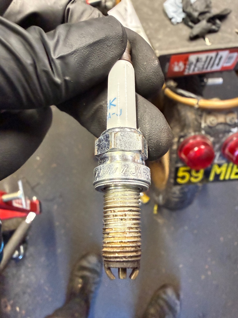

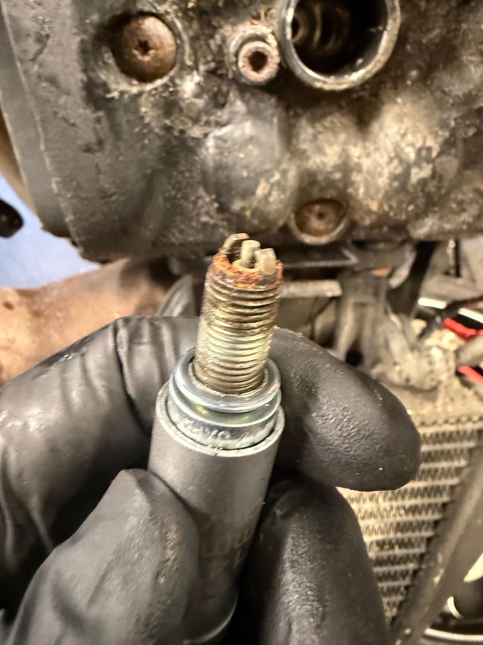

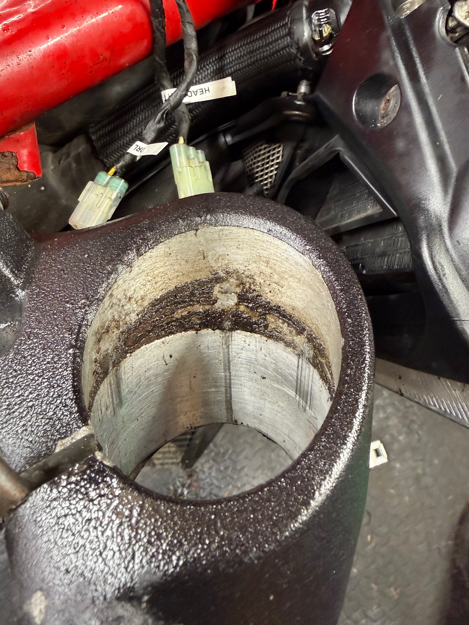

  12. :sob::joy::joy:Even the spark plug was rusty :eek:
    But look at the shaft of it, they were both the same. Those are new plugs that have done very very few combustions.
    I’m now thinking it was serviced (the oil in the sight glass is still very clean) then ridden home in the wet and parked up.

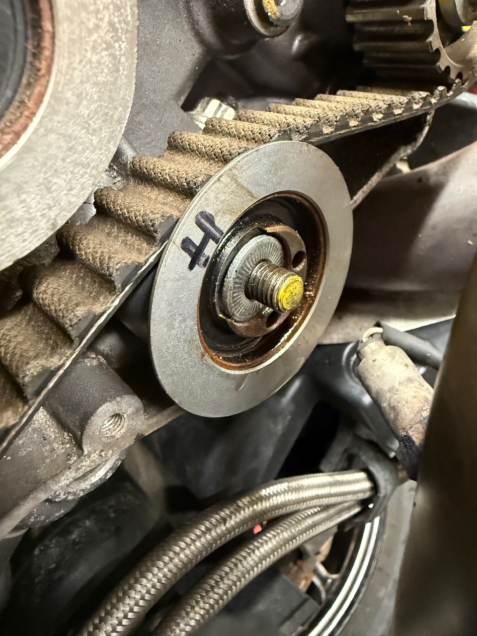

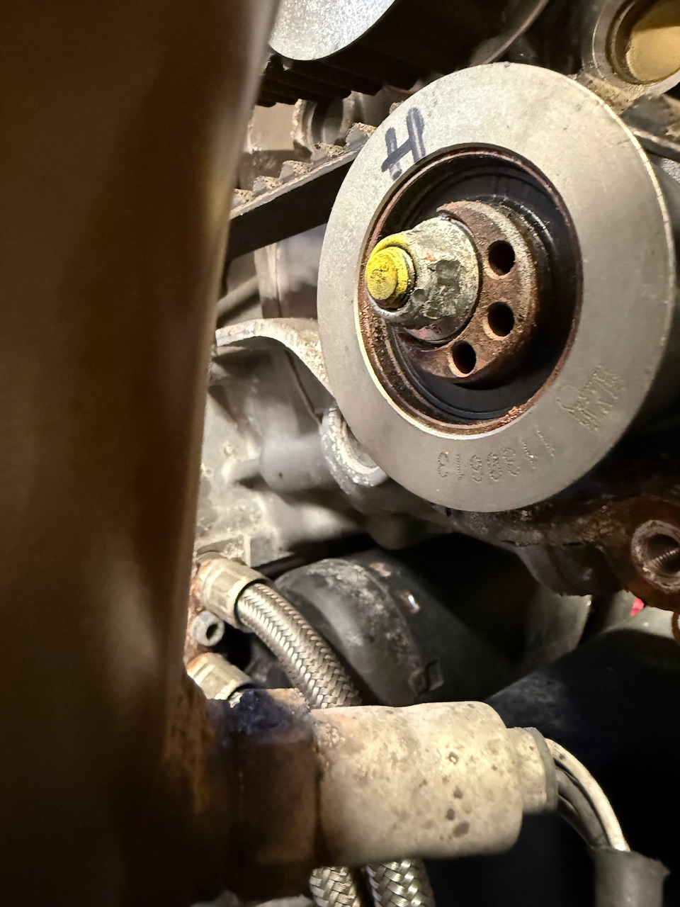

    Mind you who ever did the service was a complete ham fisted numpty. Look at how rounded off the mobile tensioned nut is.
    I reckon he reused the old ones, tut tut tut. He also didn’t have any spring washers, so, what the hell, let’s put on a lock washer. Oh, and it was considerably more than 25Nm torque on it too :confused:.
    Oh, I forgot to say, it was water in the coolant system :( and no, it’s clearly not a track bike.
    The bike actually came to me from a dealer who gets me to service & prep the few Ducatis that pass through his hands (he’s deals mostly BMW, buys part ex’s off the main dealer and sells them on), this bike’s been sold to a customer in Spain and is due to be loaded up onto the lorry a week on Friday. Its touch & go it will be ready.
    I can honestly say, I seriously considered calling him up and telling him to come and collect the thing as I’m not working on it. I’ve a 1980 Pantah 500SL with me at present too, which has been in a lean-to unused for a few years which I thought was bad, but by comparison to this Diavel, once you get under the covers, the Pantah could be described as ‘mint’ :joy:

  15. Ill be having a conversation with the dealer this morning, setting him up for the fact he probably won’t have the bike back in time for his planned shipping as I’ll most likely have to cut the axle and/or spacer and wait for a new one to arrive.
