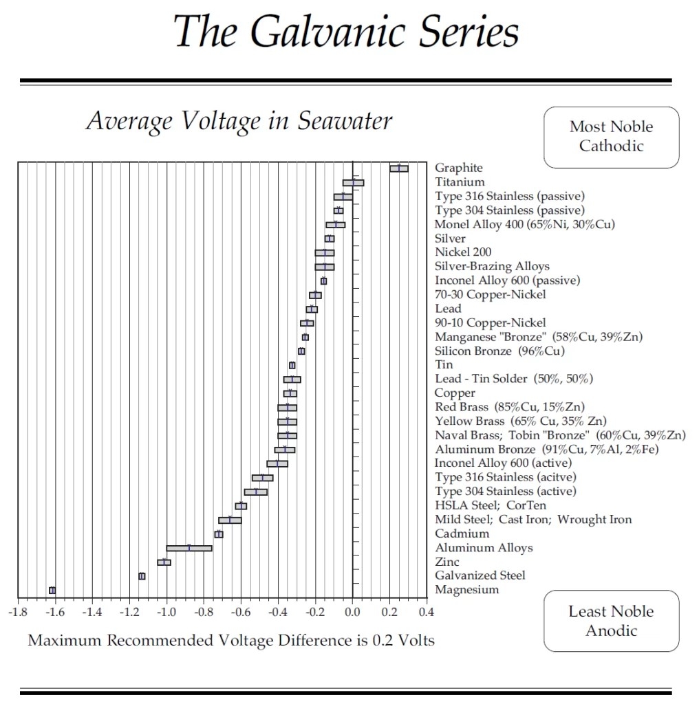

  1. Bingo, all these more cathodic fasteners turn the lovely alloy you're screwing them into into an anode, i.e. it will preferentially corrode. There are guidelines available for the use of dissimilar metal fasteners & the prevention / elimination of such anodic corrosion if one want's to be anal / if one is an aircraft mechanic, however; in a dry environment / garage queen or for a race bike that's apart a lot and subject to regular inspections I'd not be worried, but I'd think twice about replacing the standard zinc plated fasteners on my tourer / daily beater with anodes.
  2. I think that corrosion mechanisms are a speciality that most engineers aren't aware of, never mind 'normal' people! Knowledge is useful but needs to be interpreted case by case, so yes - it's not all doom & gloom, merely science that needs to be respected. I'm in the @West Cork Paul school of maintenenace - I try to help the next person along the chain have an easier time and quietly thank me for it.

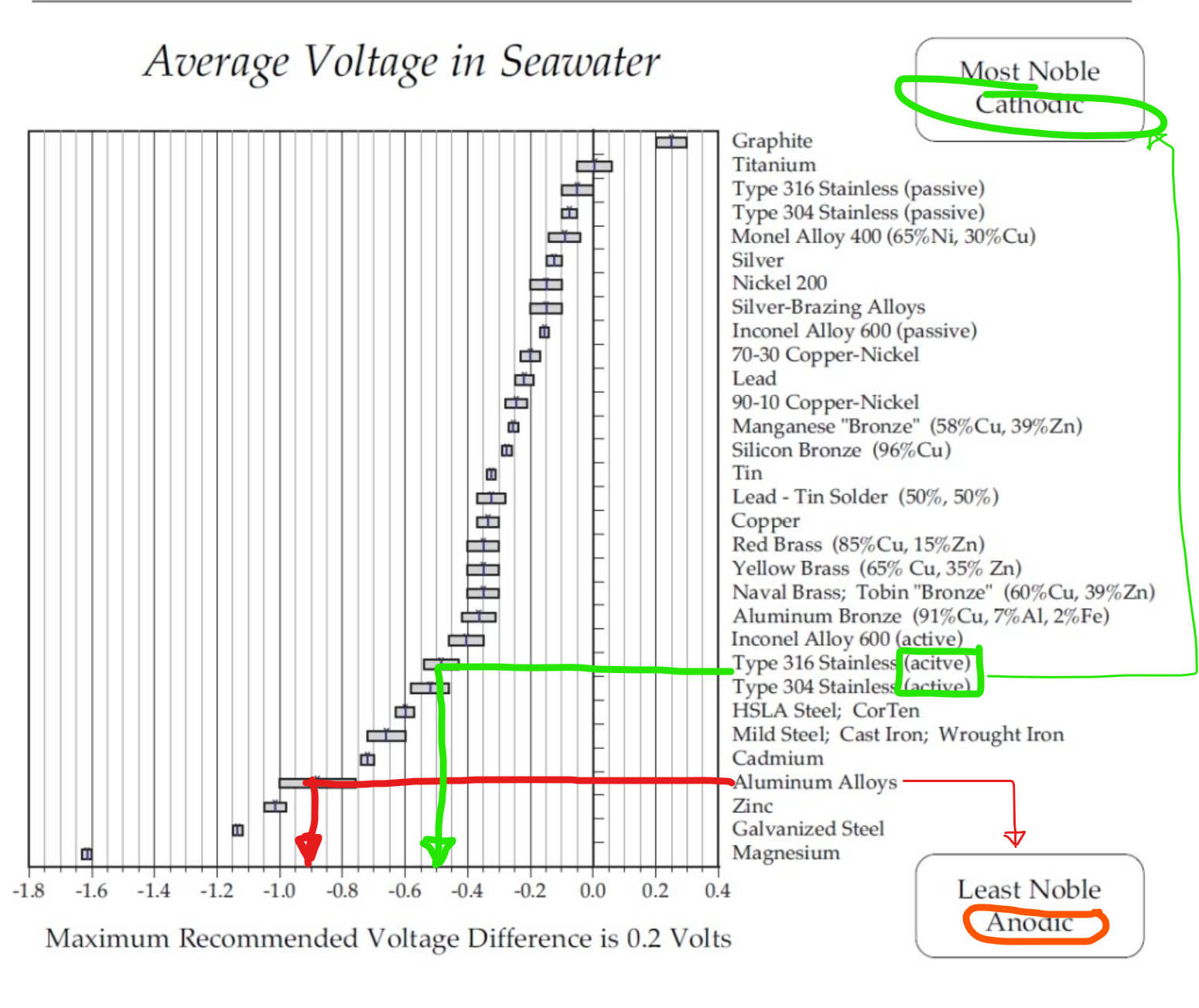

  4. Nuh uh uh... minimum voltage difference is around 0.5V for "active" but realistically that's trying to repassivate itself so one could argue that thr delta V is closer to 1 volt...
    One could always argue that the SS will repassivate itself pretty quicky to be more inert to galvanic corrosion so there's that but on yer daily beater, covered in winter salt, nah, I'll still take the zinc plated fastener & replace / replate them regularly.

  9. Totally understandable. The exterior part of the bolt, be it Ti or s/steel doesn’t corrode with exposure to weather. However, the unseen sections where the Ti or s/steel is in contact with an Alu alloy, with the presence of water (moisture from the air) creates a little battery (the voltages of which can be seen in the table above) and ions start to flow. It’s this galvanic corrosion which can cause issues if not prevented or regularly cleaned off. This type of corrosion can be as bad as the regular rusting of ferrous materials.

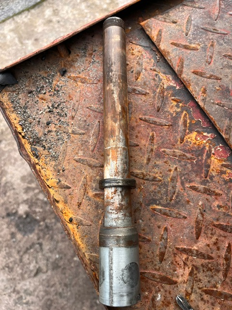

  20. And, eventually, it came out.
    The dealer made a drift out of some copper cylindrical bar and hammered the f&&k out of it on the threaded end until eventually it started to move.
