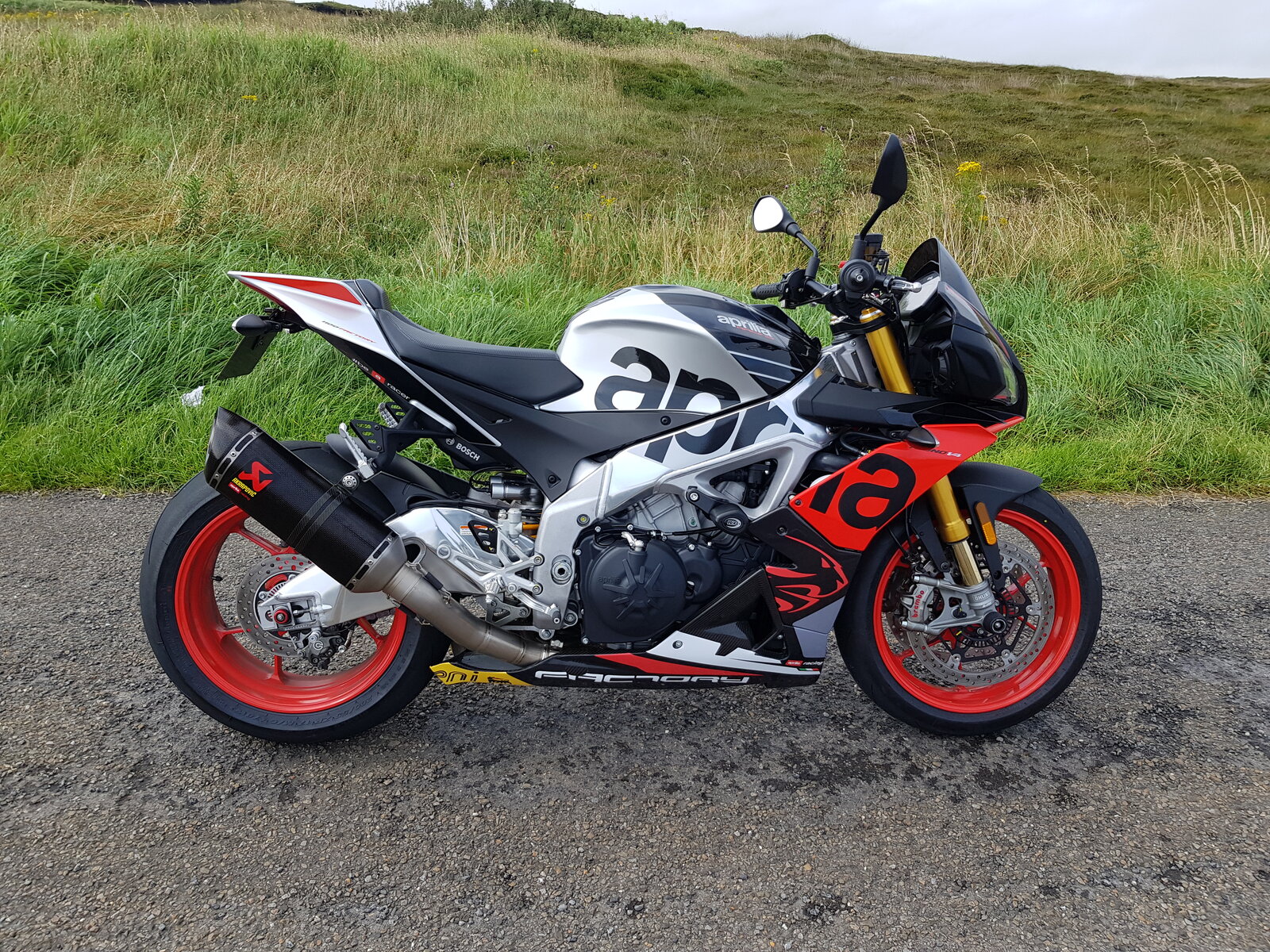

  10. Mostly track. Tried all 3 and find them all fine tbh. have to post a photo
