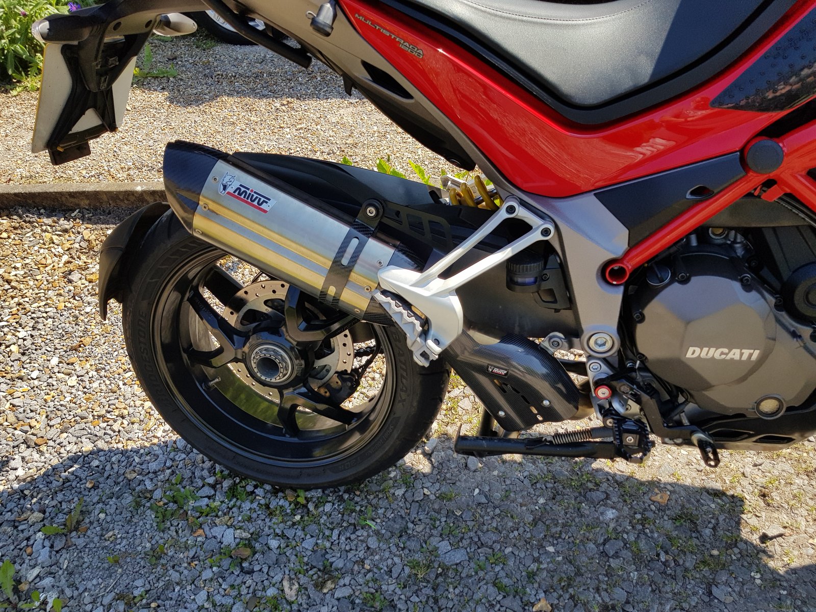

  7. Well I've fitted mivv suono and decat today but only run it workshop....Christ it's noisy. The baffle in it is non existent has anyone fitted a proper one.
  8. Someone has fitted the baffle for a BMW gs as it bolts in the same and is quieter.
  9. Well got this bad boy fitted and gave it a good 200ml run in the sun .bloody awesome !!!.
