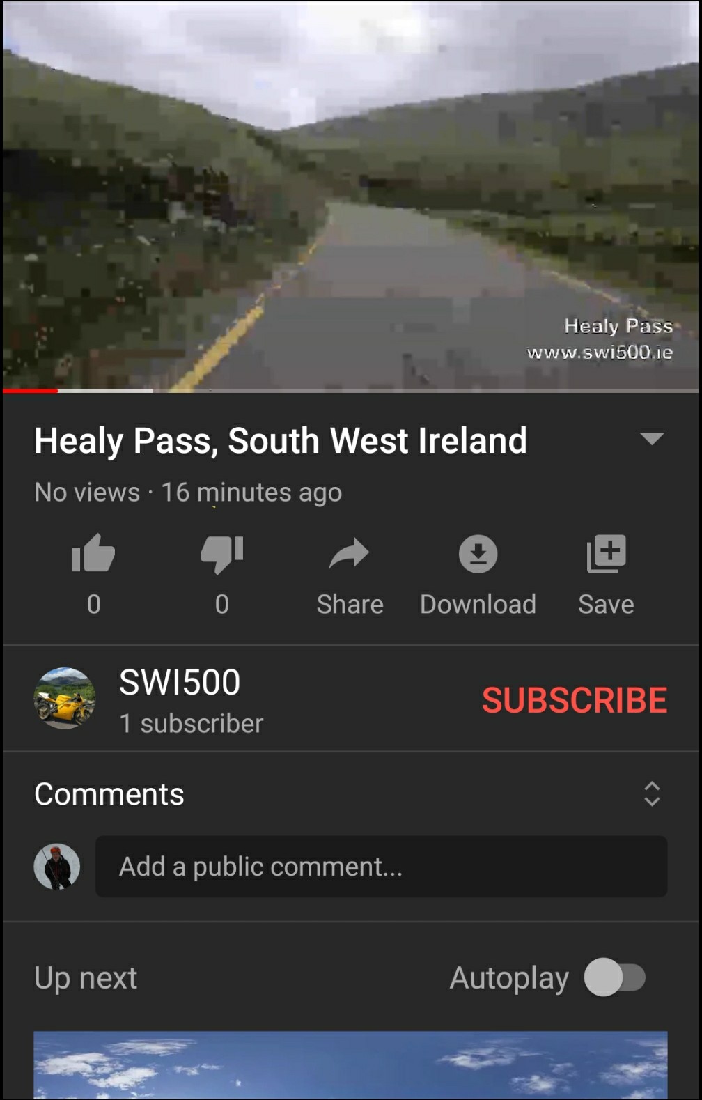

  4. Paul - the YouTube video is really low quality (straight in, didn't play with any settings) - sort of pixelated. Screengrab is a good representation...
  5. Thanks Keith, I just saw that on a mobile myself. I watched them both on the computer once they were uploaded and they were fine. I’m gonna have to play around with the export formatting some more :(. Ah well, it’s all a learning curve. Thanks for taking a look anyway:upyeah:
  6. The Caha Pass vid was better and loaded at a resolution of 480p. 720 would be better and 1080 ideal, (although I think youtube defaults to 720 and the viewer can set higher - not sure about that) maybe your editing programme is compressing the file as it exports it? Are you exporting direct from the the editing programme to youtube or to your hard drive and then to youtube - either way see if you can check. Yes a "windslayer" foam cover will cut down on the wind noise. Also, on your GoPro (easiest done using the GoPro App on your phone) have you turned Protune "On" and set it to "Wind only"? This will also assist.

    The quality is pretty bad considering the camera, I just watched on my mobile. I would consider using Vimeo.....
  8. Paul, I think whatever program that you're using to edit your video is doing a poor job or you have the settings woefully wrong. GoPro footage should be excellent. YouTube does 'crush' the video a fair amount which degrades the quality a little, Vimeo less so, but you should be able to get very acceptable results from YouTube. Some video editing software has pre-sets specifically for outputting content for the various video hosting platforms. Might be worth checking if yours does.

    For the purposes of helping anyone other Newbie now or in the future, I'm filming at 1080p 60fps and importing the 4Gb GoPro .mp4 file into iMovie as this permits me to trim out boring bits from anywhere in the film (so far I seem to only be able to trim the beginning or end of film in GoPro Quik). When importing it the default option is to import it as "Large file 960 x 720", the accompanying blurb explains this will be sufficient for web based videos etc. Having done what I need with it I'm then exporting it to my hard drive where there are further options complete with a handy little table that tells you what's the best option for a variety of devices. I'm selecting the standard YouTube option including mobile. This is reducing the file size even further and bringing it down to 720p or even 360p in one case:(.
    As it's been shot in 1080p I will override the default options at the various stages and will retain it in 1080p throughout the process and see how that fares.
    @Bumpkin I just read your post and yes, I suspect that's exactly what's happening; the default options within iMovie have not kept up to speed with what YouTube and other web based video sharing platforms can handle data & file size wise. In my research I found iMovie's not been updated for a few years as Apple want people to buy and use FinalCut.

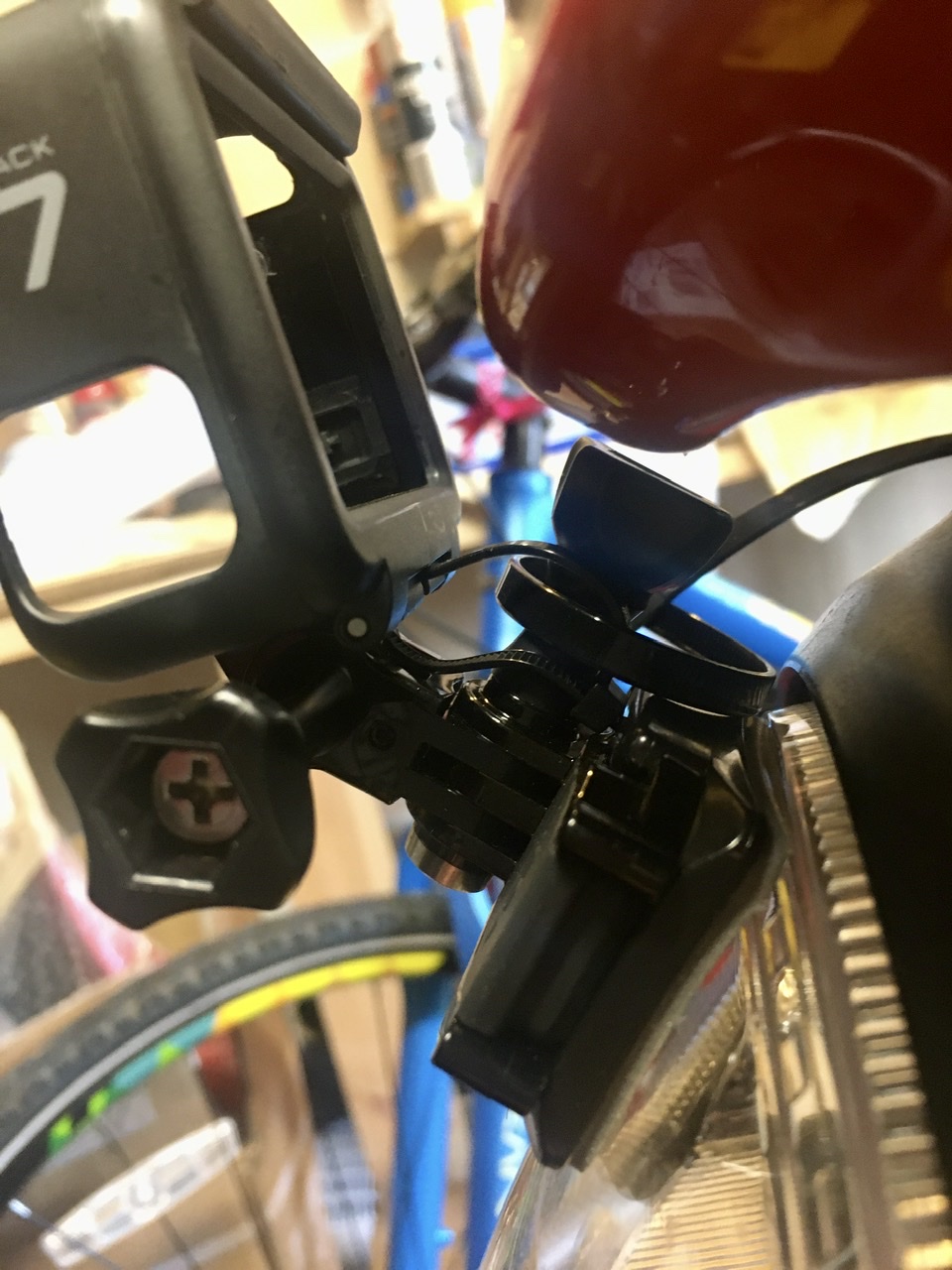

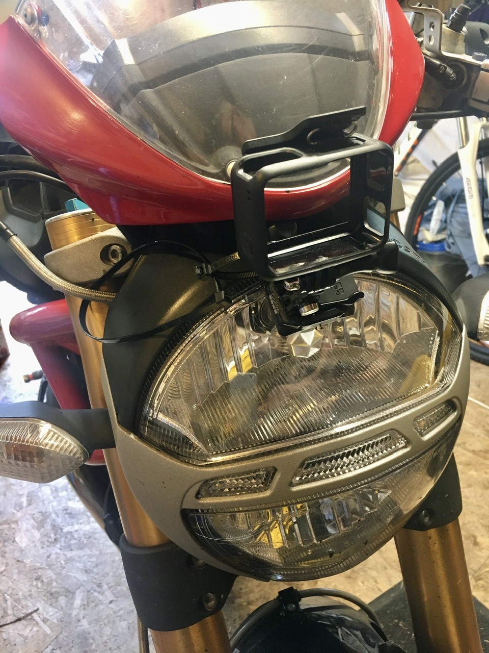

  18. @BobTheBounder make sure you secure your GP just in case it decides to do a Brouny. Here’s mine, a very small cable tie through the hinge of the case then a thicker cable tie through that then another to a secure point.

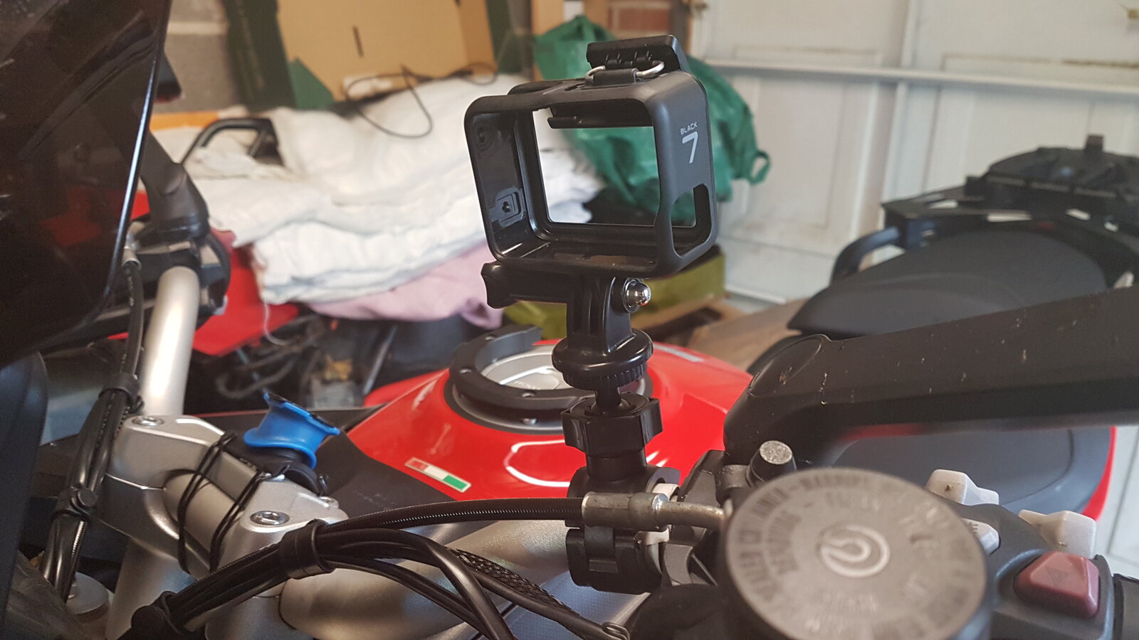

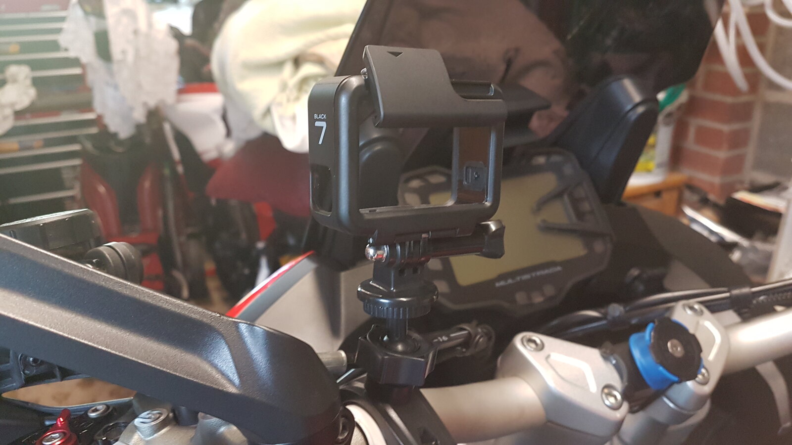

  20. I as temp measure have secured GP7 to my LH bar thus
    I encoded to 720p x265 to maintain quality for file size, original file was 3.76Gb, encoding took 38 mins upload to YT was 34mins as file was reduced to 830Mb, if I play 720p file in vlc player its far superior quality than the same file uploaded and played in YT! Am I doing something wrong?
