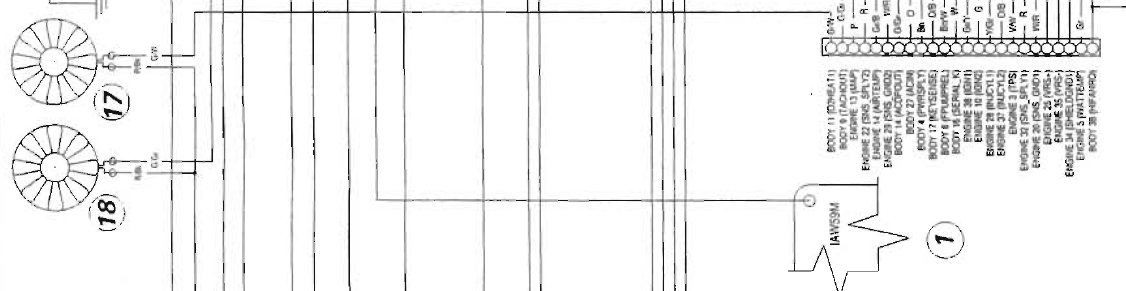

  2. screenshots from the 998s workshop manual I have. if you need a copy, let me know and I can sort an upload somewhere. it is 61MB, so can't go by email.

  8. @Birdie you are correct - item 1 is the ECU, 17 & 18 are the fans. I have got hold of a simple switch to do a manual bypass for when it looks like it's getting hot.
    seems to be switched on the ground side, as the common connection to 17 & 18 is from the fuse box, so I guess I am going to have to fit the switch as a short to ground from the G/G & G/W wires (or at least that's what I think they look like).
    maybe I might need to fit a diode or similar to prevent shorting the ECU to ground, too??
    Anybody done this mod and can confirm/correct?
    edit, maybe a 2-way switch would be better with fan as common and switching between ground and ECU?

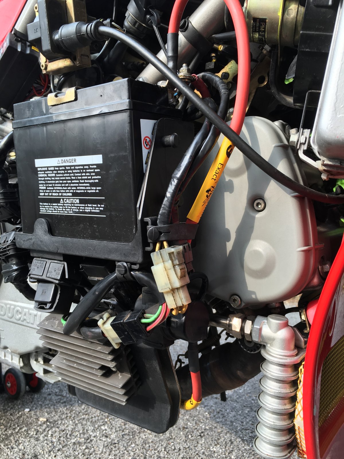

  16. All sorted now.
    And Firing better than ever with the new starter motor, a new Yuasa battery and @Exige 's grunty leads.
    Thanks again for everyone's support. I've learnt quite a bit about my bike in doing this work myself.
    Cheers.
