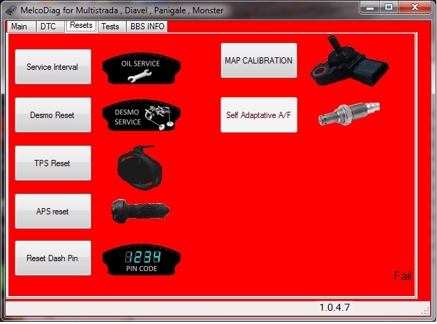

    In my case, I am puzzled as to how and why I cannot reset the 37k mile Oil Service reminder.
    Using Melcodiag I have successfully cleared the 15k Desmo, the 22.5k Oil Service and the 30k Desmo.
    Somehow out of the blue I cannot clear the 37k.
    I think something happened to the ECU. Wonder if there is way to reset to factory settings or reinstall the program :thinkingface:
    Once you have the right cables, you can reset it yourself with the jpdiag software.
    I've documented it on the thread below.
    https://www.ducatimonster.org/forums/ducati-monster-1200/354324-engine-light-reset.html
    Software available here. Register your ECU to get a license that will free-up all the functionalty.
    http://jpdiag.akress.com/

  6. Must be a cheap Chinese ELM cable. Happened to me also.
    Make sure the ELM327 USB Cable OBD2 is genuine and has been confirmed to work. Many on Ebay are Chinese bootleg where their cables contains a counterfeit "Prolific" chip that uses the same Vendor ID. Consequently, Prolific modified their newest drivers in Windows to render the counterfeit adapters unusable. As a result, any Windows OS drivers newer than the ones in XP will result in a "Code 10 error"
  7. This is a good point, all I can say is once I set the port up and the program it showed a green bar under the connect button but constantly said conect............ next to it, the LED on the VAG OBDII to usb lit up red but it just couldn't interrogate the ECU. I had the same problem with the kit I bought for the Android app with the Bluetooth OBDII adaptor. It was much quicker and cost no more money than buying all the leads to get it done at MBR Motorsport. I just wish I had known he was there. I only found him by accident from a person you might know box on facebook.

    Speaking with the guy who wrote the JP Diag software when I was trying to reset my service light, it seems not all bikes connect reliably, or reset correctly. Some bikes need the desmo service reset sent to reset what should be just the oil service.
    Interestingly speaking to a friend yesterday he says the JP Diag software works for his 2015 base model DVT (using a bluetooth OBD dongle, not the wired one).
