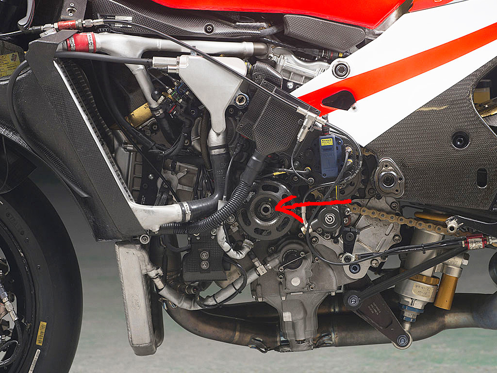

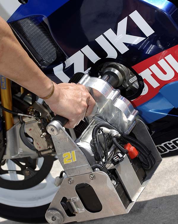

  2. Do you know which bike it’s for ? Andy
  3. Is this connecting to where a starter motor might sit? Too high to be connected to the end of the crank. This one looks interesting - battery and starter motor in one package

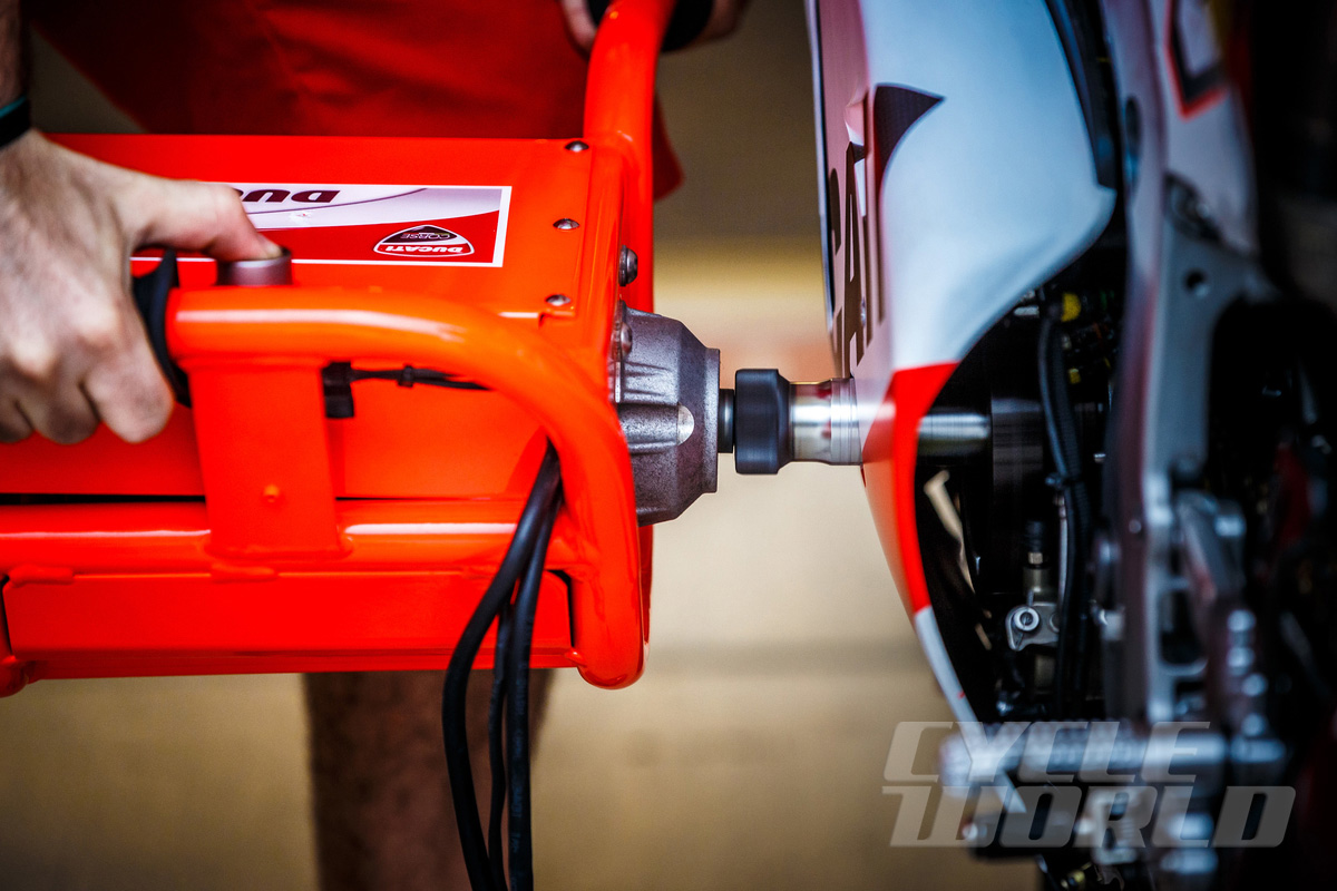

  5. Best I can find are these but I can't quite see what that socket is going onto

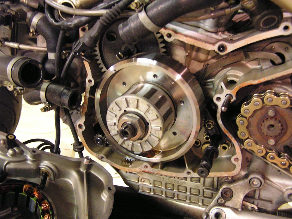

  6. So think I've found part of the answer !
  7. Okay, I believe that the 1098/1198 can still use the early 916/996/998 style of 4 spring slipper clutch where the pressure plate has 6 holes. The 2 diametrically opposite holes (with no springs) are for a spigot starter. I’ll have a poke around for pictures. Andy

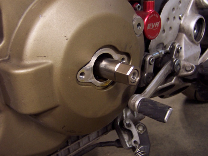

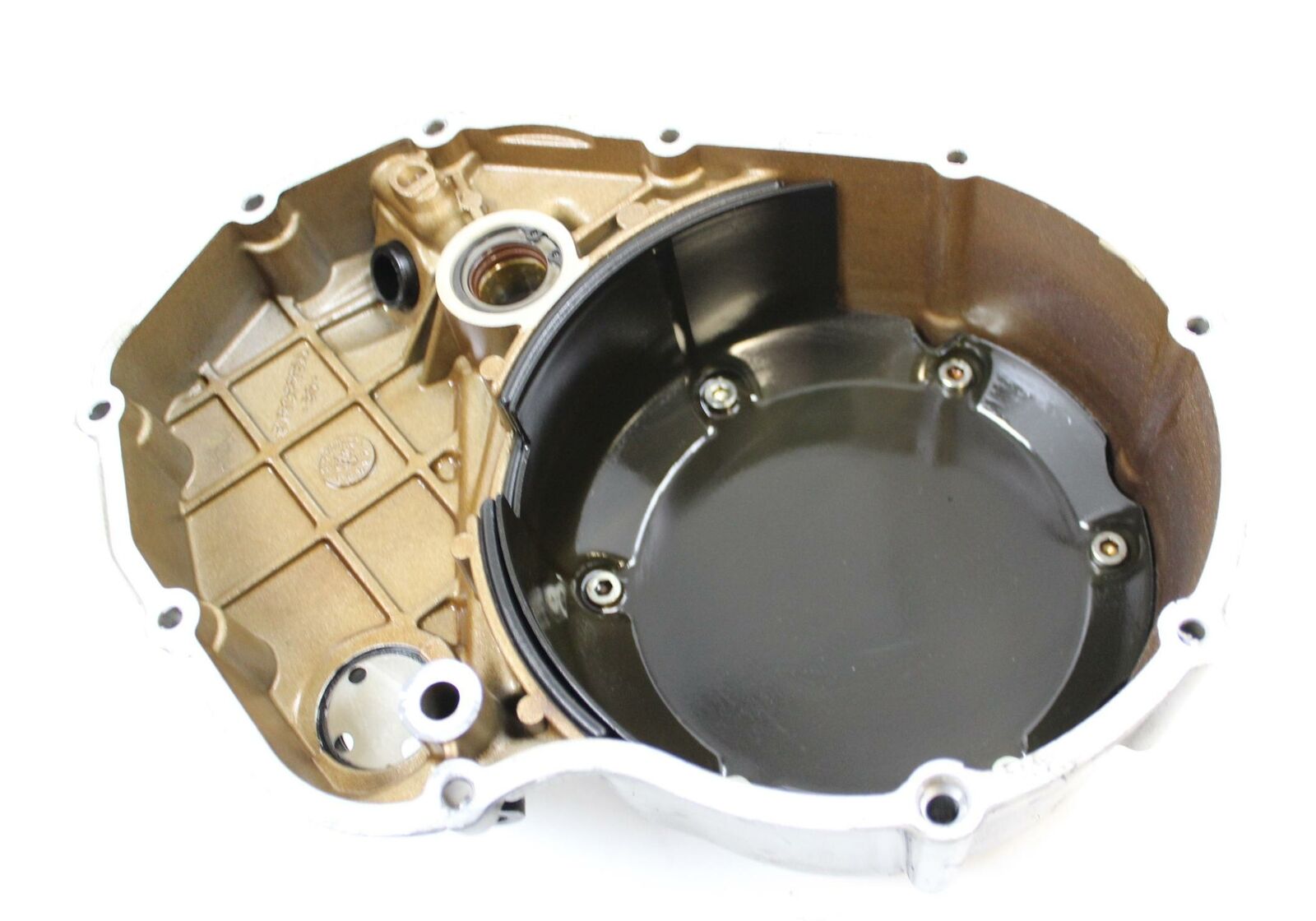

  8. I have one of those clutches somewhere I'll dig it out and have a look

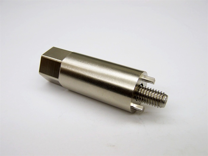

    Just as a thought if I machined a new alternator case cap with an oil seal in it and made something like this crank turning tool !
    Need to consider the forces on the end o the crank ?
    Don't know how I get myself into this shit :confused:
  9. I reckon it would spin and you would shear the tabs off the crank tool. I managed to do that to one simply by forgetting to take the plugs out. :blush:

  13. Derek .... wasn't for one minute suggesting using the tool, just the idea, I'd make it out of something a bit more stable than an off the shelf tool
  14. Quite right, would have to be a permanent fixture with a decent oil seal with sealing edge/lip set-up in place. Also as said, the std slots in most Ducati cranks probably aren't suitable for constant starter engagement in this way, you would be better off adapting/using a deeper crankshaft nut for this use, but this would have to be on the R/H (clutch) side** of most Ducati engines* due to the crank rotation, so as to tighten, rather than loosen the crankshaft nut (as in lower picture, std gear fixing nut cannot be used/accessed, additional drive would have to be attached directly to crankshaft nose).
    *not sure which engine you are adapting.
    ** not straight forward, (see below) and would need investigation but crank is tapped on this side also.

    The "spare" holes are for a pin that locks the slipping action of the slipper clutch, which is what makes the paddock starters a bit tricky.
    I went through this ball ache with a 999RS engine. Long story short you can't just fit starter parts to an RS engine because the crank isn't drilled like a road engine, so the starter sprag/parts receive no oil. So my perfectly good 6 spring slipper clutch was pulled out and replaced with a Corse 4 spring unit. Of "Corse" the locking pins are impossible to find but I found a photo of a pin fitted to one of the Factory bikes and guess-timated the rest:
