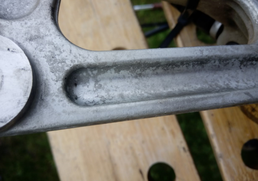

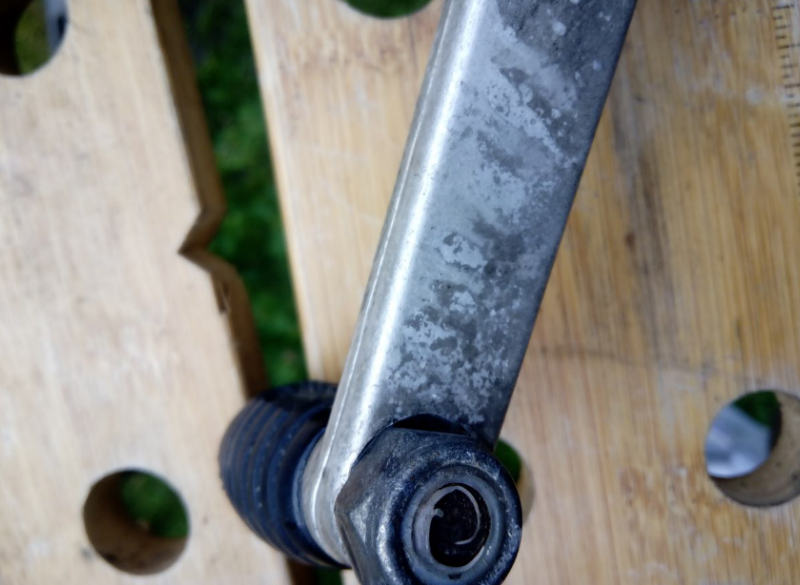

  1. What is the best way to restore these brackets?
    There's an oxidisation of some sort which seems impossible to shift.
    Or polish them back to bare aluminium?

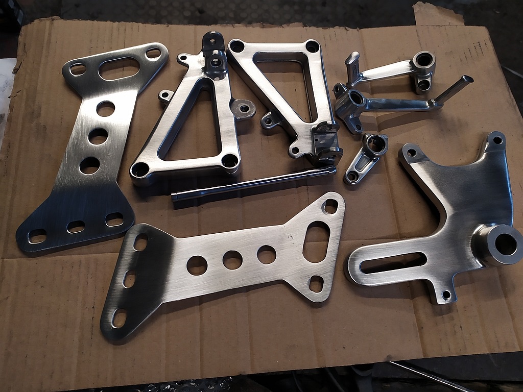

  2. seem to think they are clear lacquered alloy easiest way possibly rub down with wire wool polish and re lacquer
  3. Polished then brushed works well. 'Race' finish I've seen it called.
    Matches the factory swingarm finish.
    Done these recently.

  6. Get someone else to do it :laughing:
    I farmed these particular parts out.
    Apologies as my first post could have been worded better.
    However, I'm doing some other parts off my Hilux Surf at the moment. I machine polished using my bench grinder with mop then lightly brushed over with a wet fine grit sanding sponge. Finished with a clean/polish using 'Peek' to get the remaining crap off.
