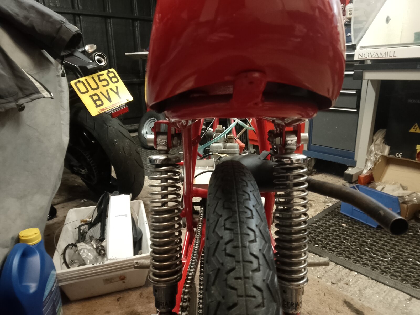

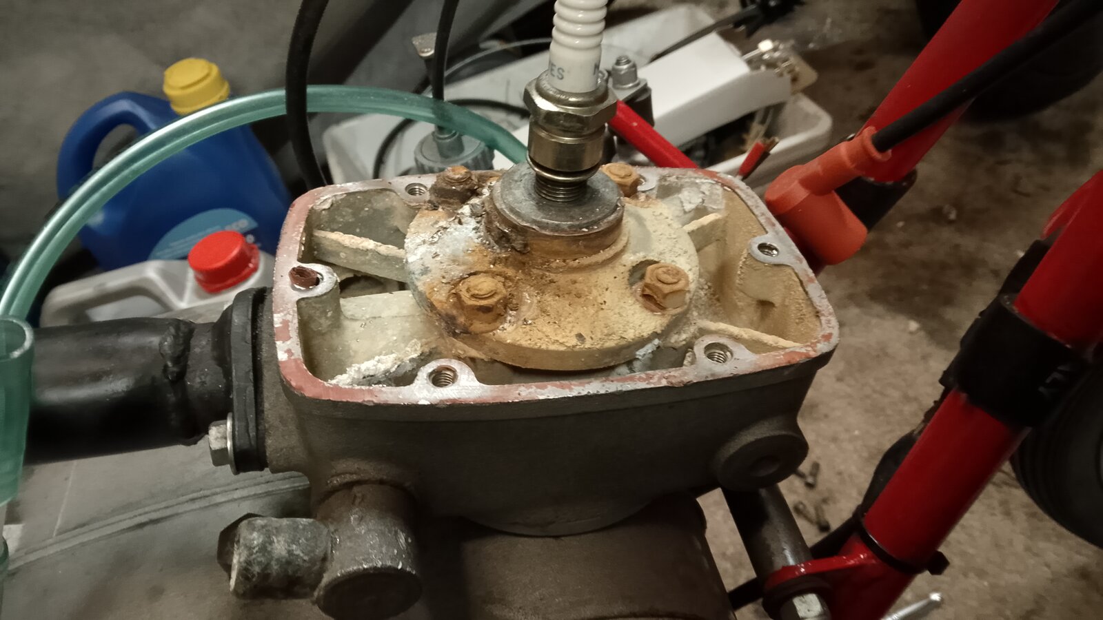

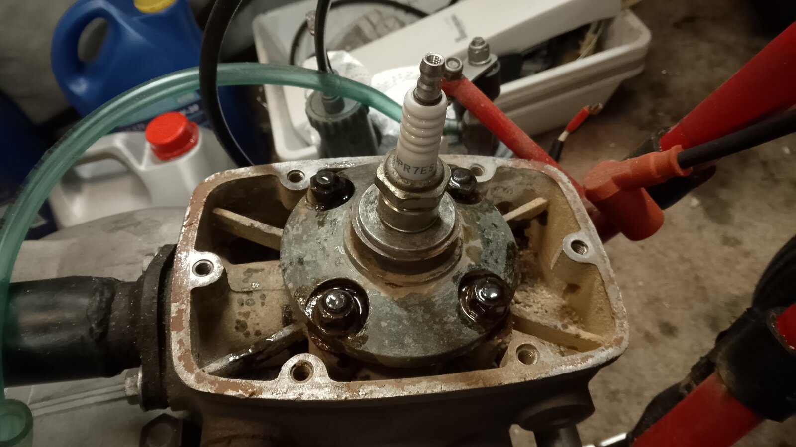

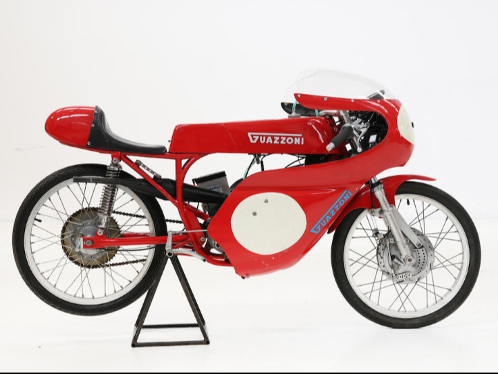

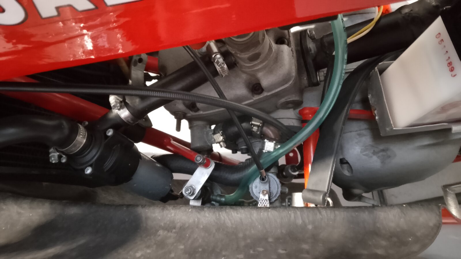

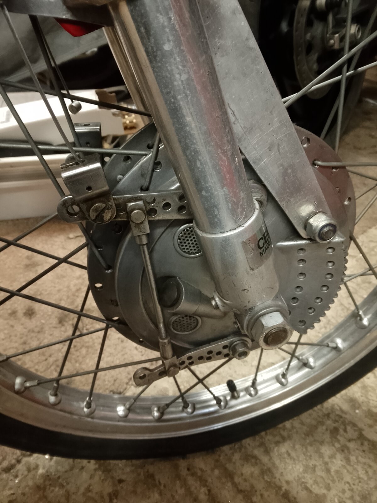

  18. IMG_20250211_125224.jpg IMG_20250211_124509.jpg IMG_20250211_125347.jpg IMG_20250211_125229.jpg IMG_20250212_182358.jpg IMG_20250212_183048.jpg So, the journey of discovery has begun. The jury is still out whether it is a original race bike or a modified road bike. I'm not sure I'll ever know for sure. Not that it matters. I now believe it was always a race bike as there I no evidence of the frame having has things like centre stand bracket removed and it has some of the characteristic differences to the road frame. The engine is a 4 speed with 60cc and not 50cc as thought. The Italians had a Cadet class which used 60cc bikes with a 17mm carburettor restriction. Now comes the interesting bit. They never did a 60cc water cooled cylinder. That only came out in 1973 and the Cadet class was no more by that time. I however have a very well made 60cc water cooled cylinder. Someone has gone through a lot of trouble to convert that from a 50. Not only did it need a new liner but also a spacer at the bottom. Somehow that manages that but didn't manage to sort out the water circulation system so I took all the ports off and start again. I'll try to convert it back to thermosiphon as that eliminates the need for a battery.

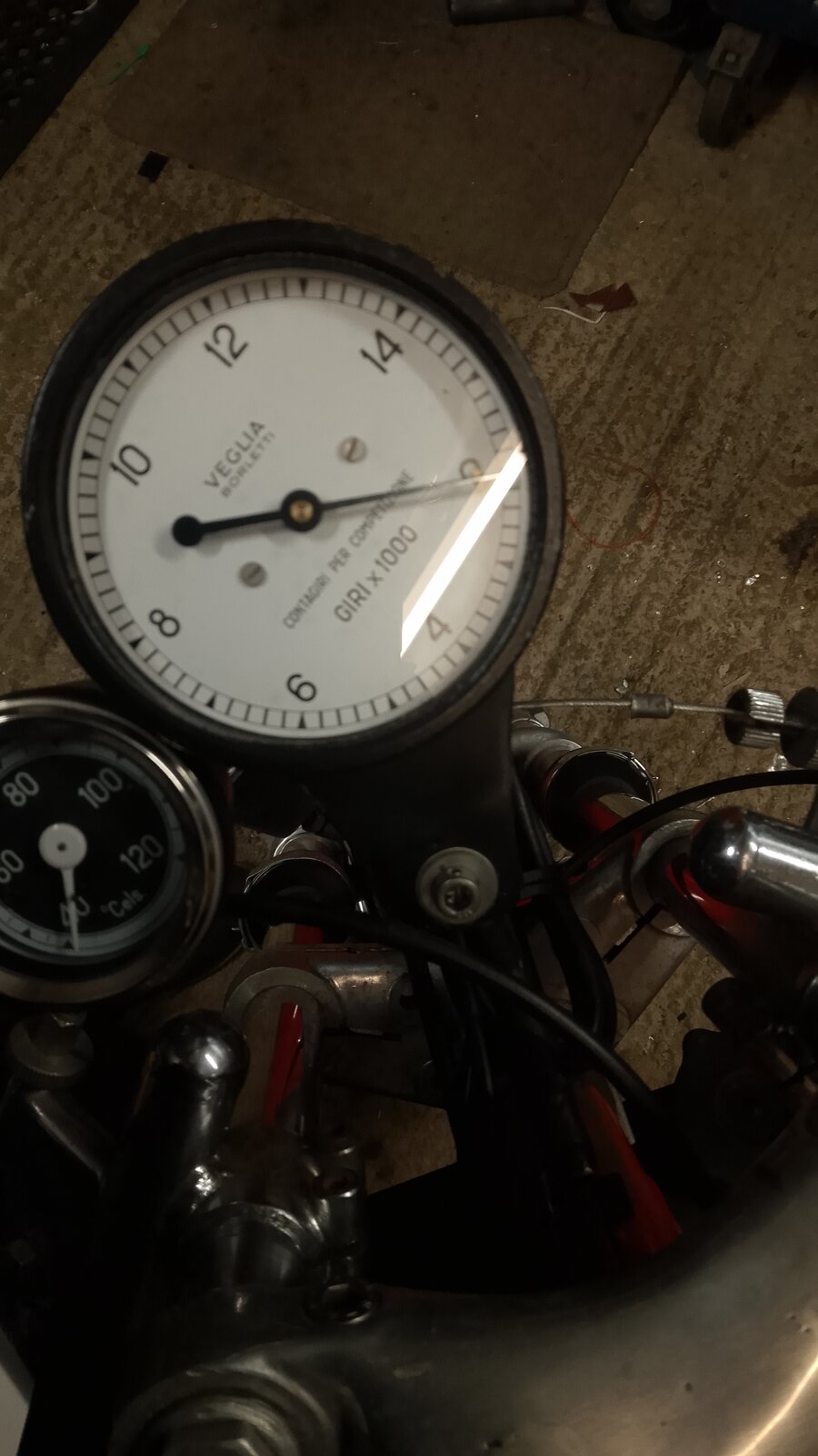

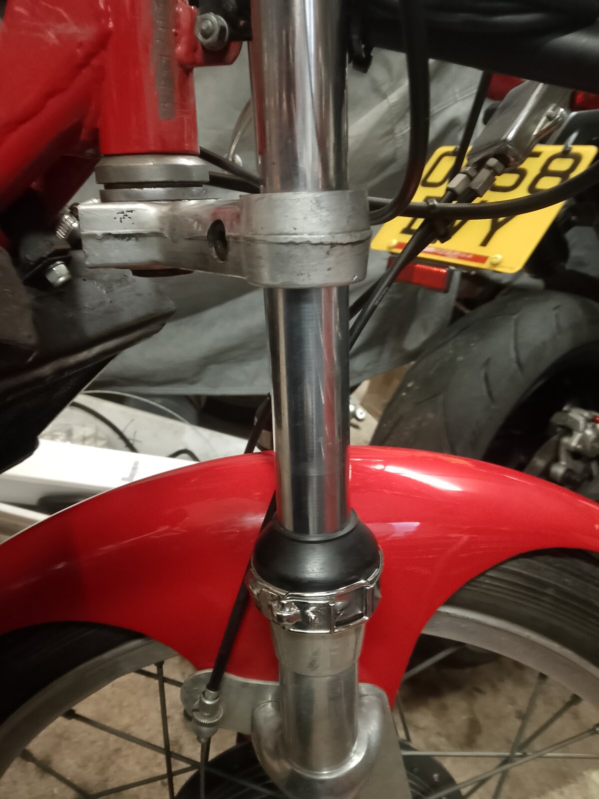

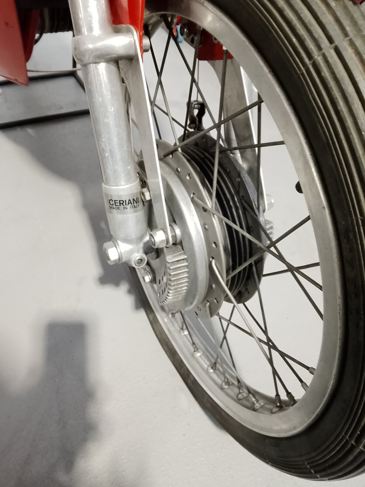

    The suspension is the finest money could buy at the time. 28mm Ceriani race forks and preload adjustable Ceriani race dampers at the back. A Grimeca 4 leading shoe front brake with Borani aluminium rims front and back. Tomaselli clip ons and throttle twist grip and a Veglia mechanically driven rev counter. They also managed to find a remote temp gauge that works without the need for electricity. I'm not quite sure yet how that works but it does.

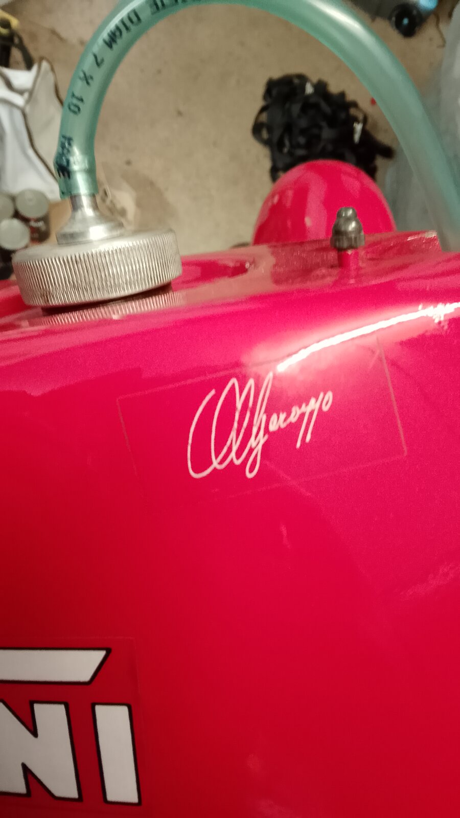

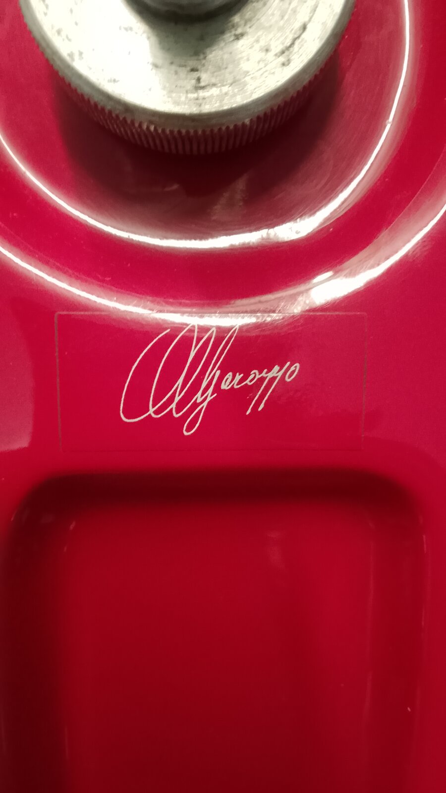

    Sombody signed the tank, no idea who. IMG_20250211_124435.jpg IMG_20250211_124444.jpg

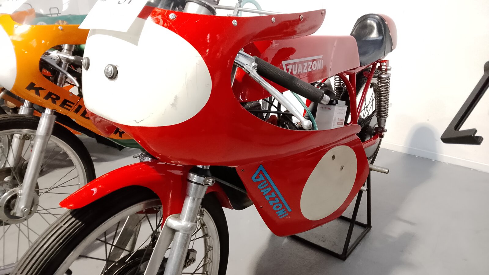

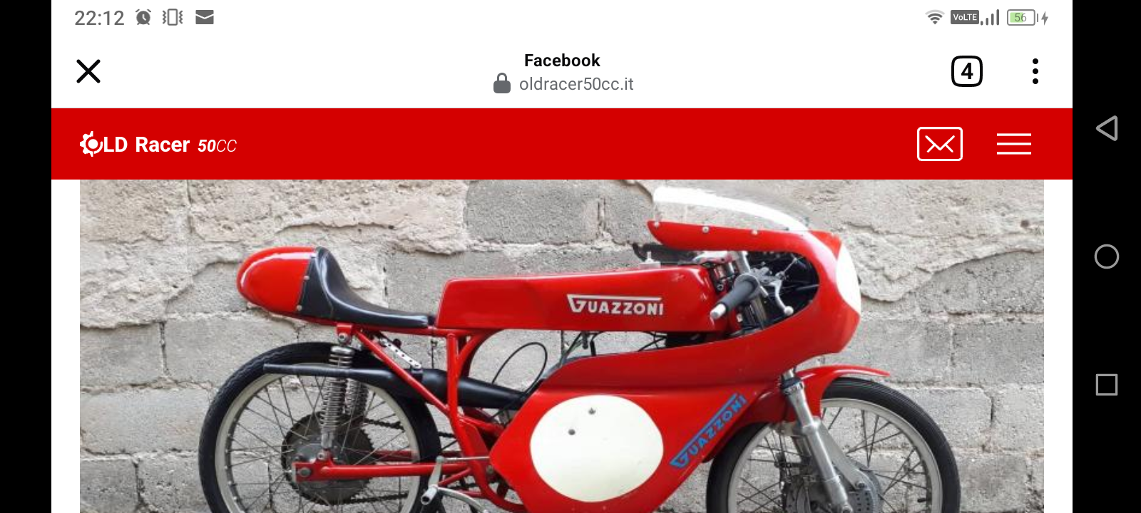

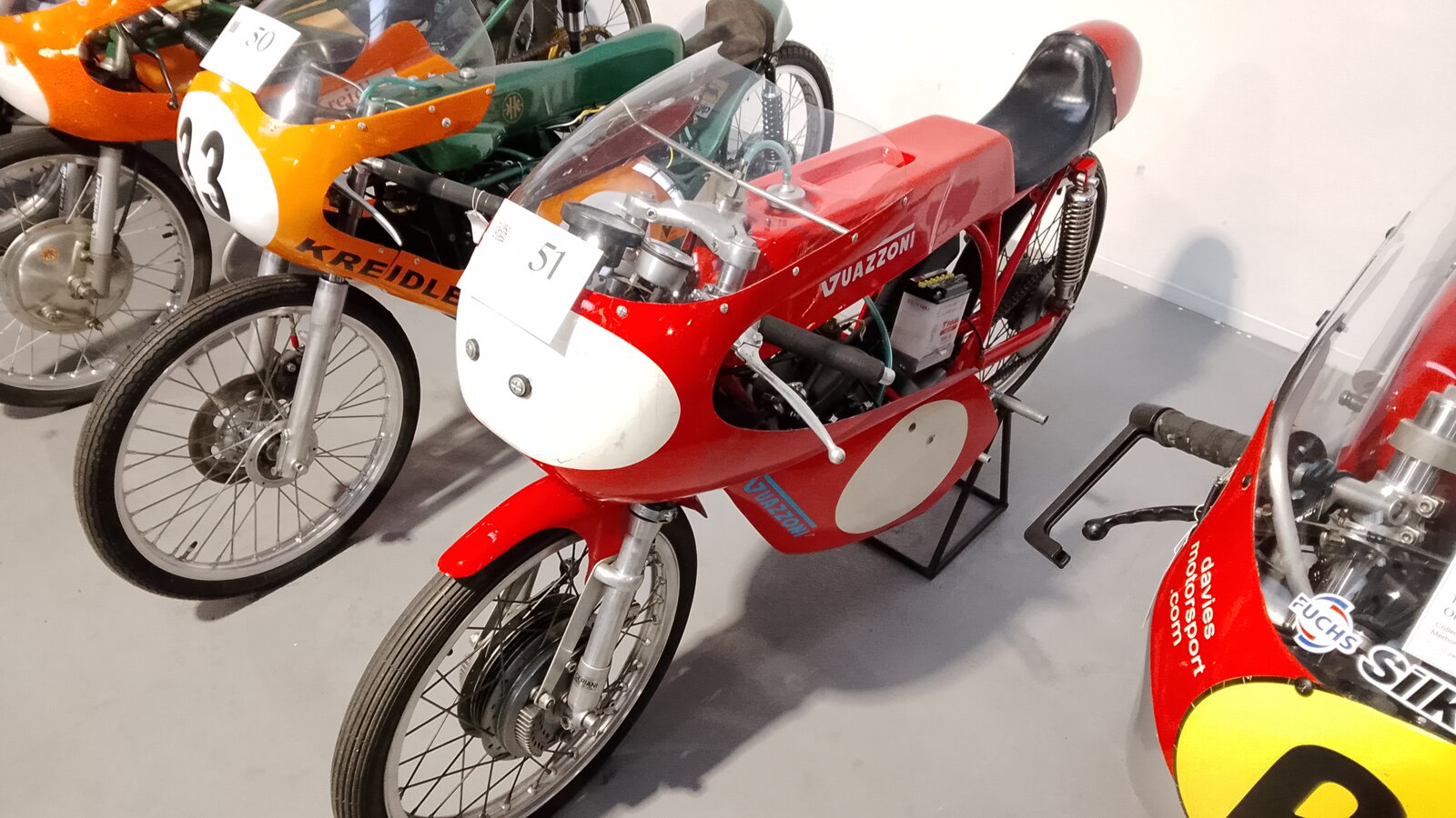

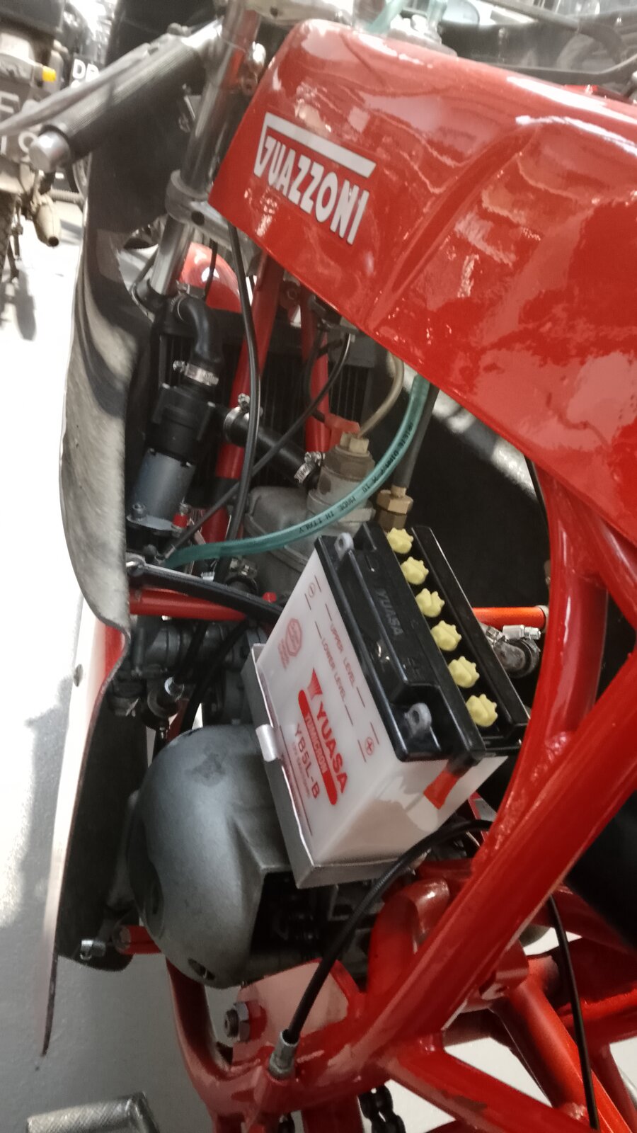

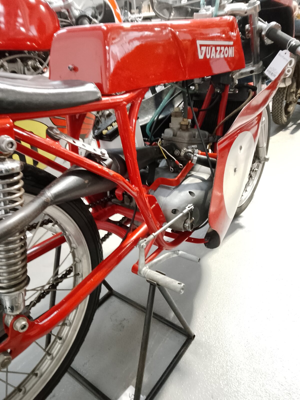

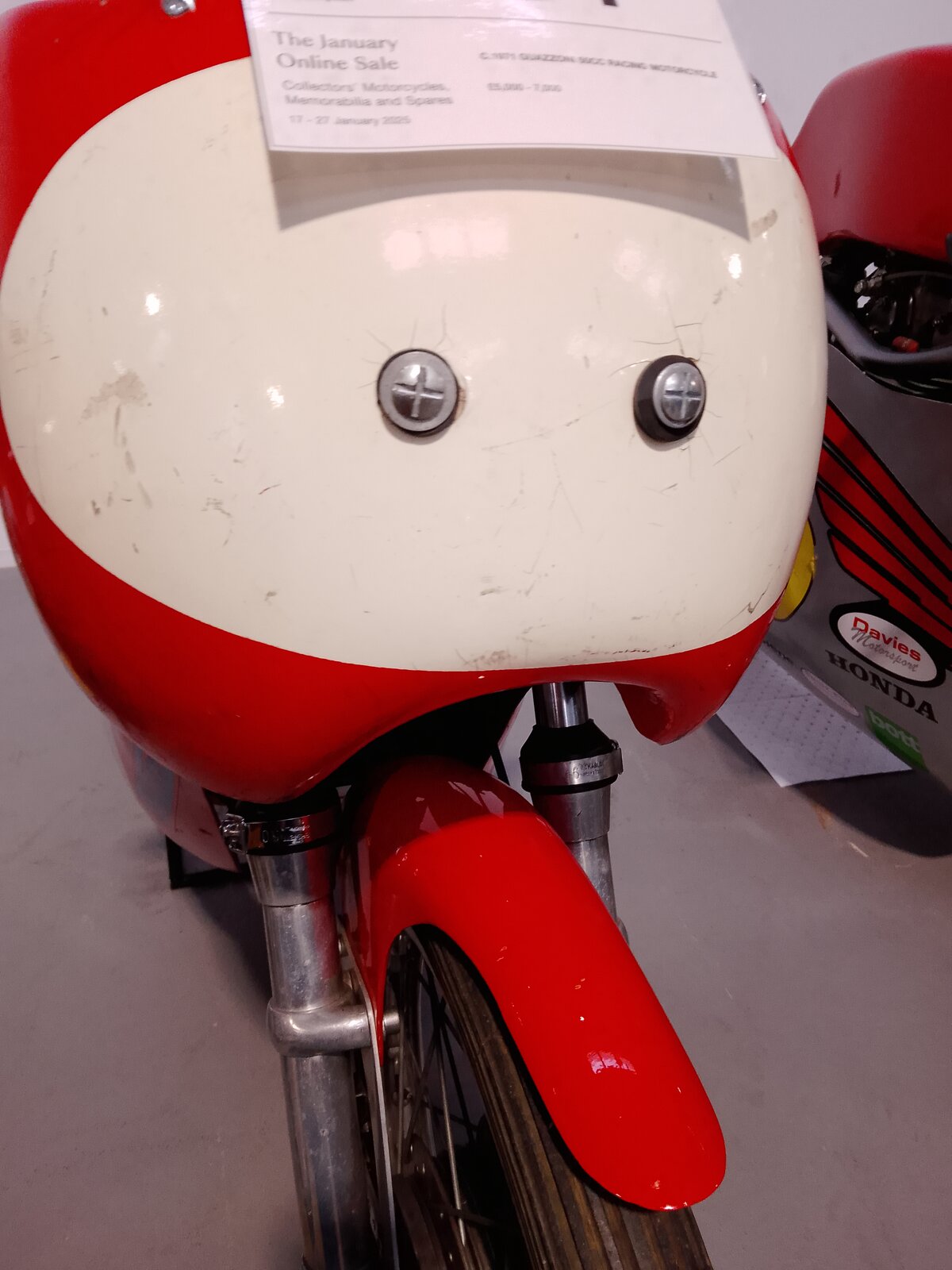

    Here's a picture of the same bike at a sale in Imola 1995 FB_IMG_1739024387751.jpg

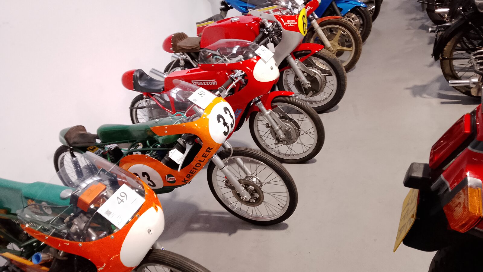

    And then again at a specialist Italian dealer not so long ago
