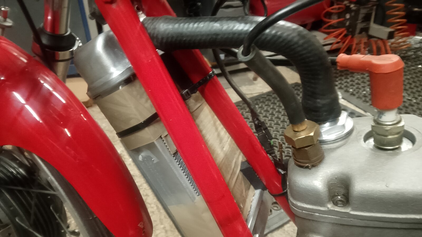

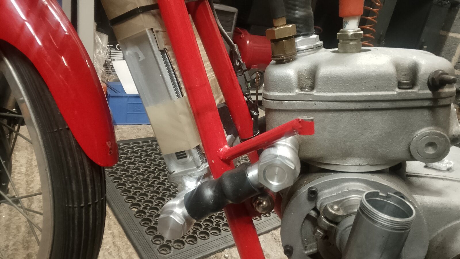

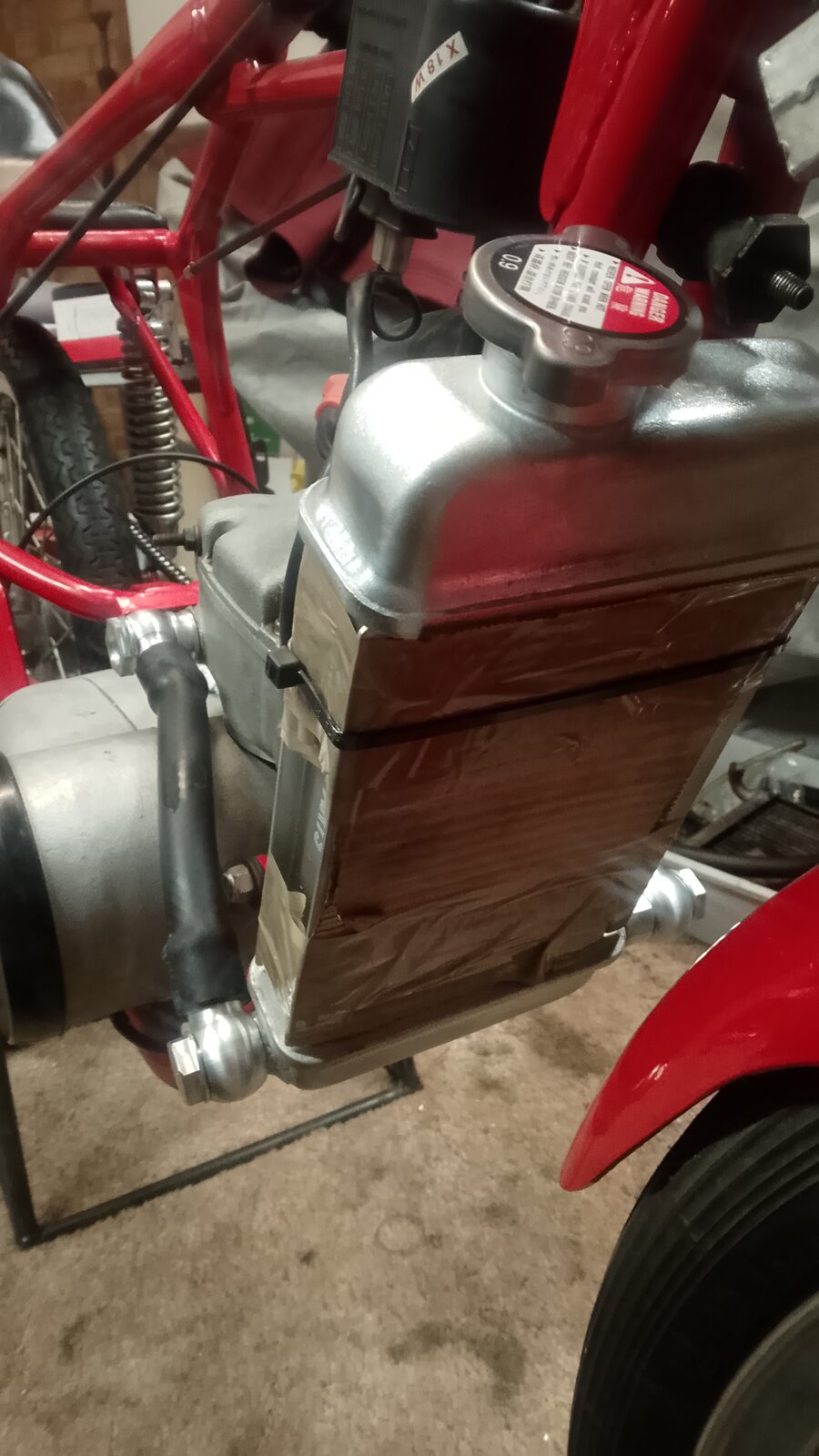

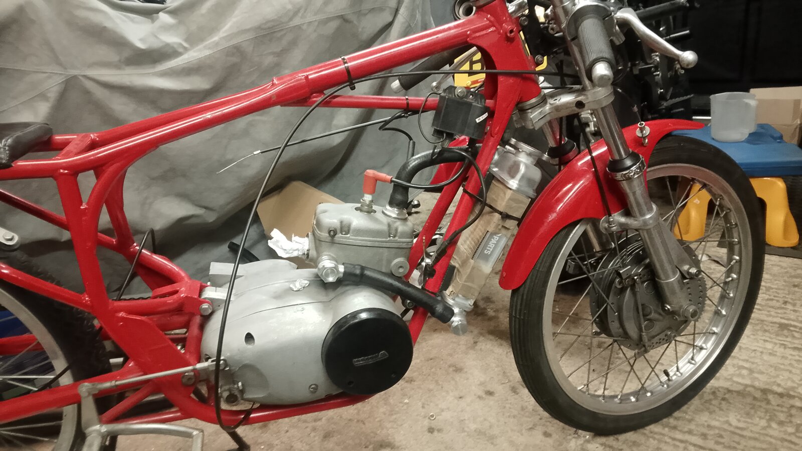

  1. Yeah, the battery is history. They only used it to power the water pump. I'm converting it back to thermosyphon so I can get rid of it.

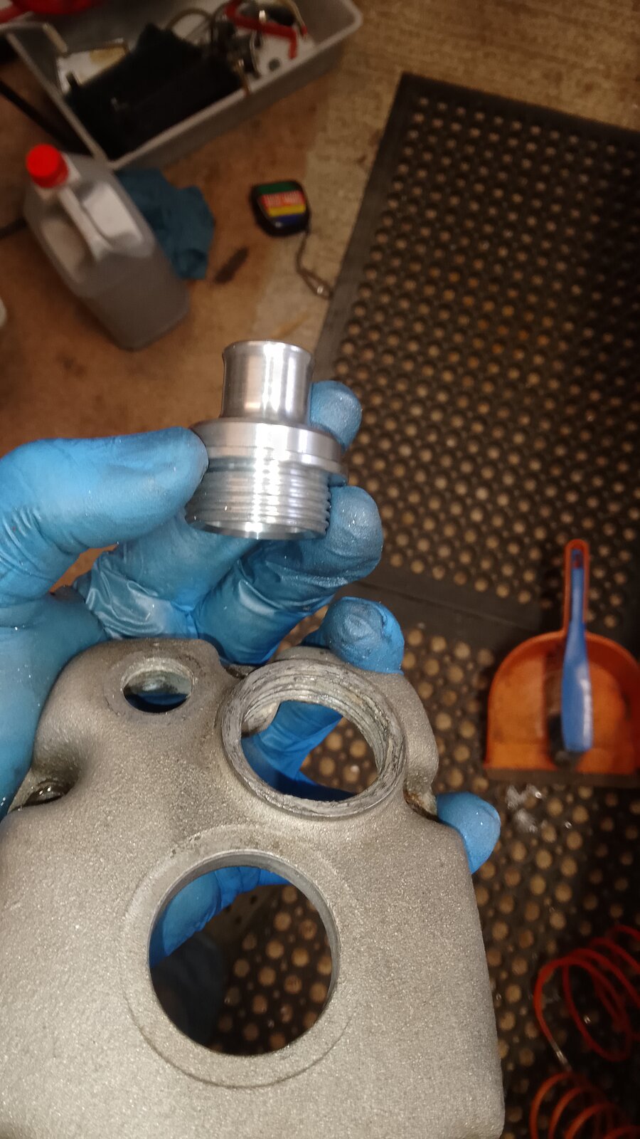

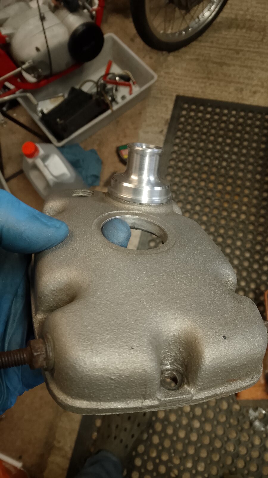

  2. Started to make some new parts, water outlet on top of the cylinder.

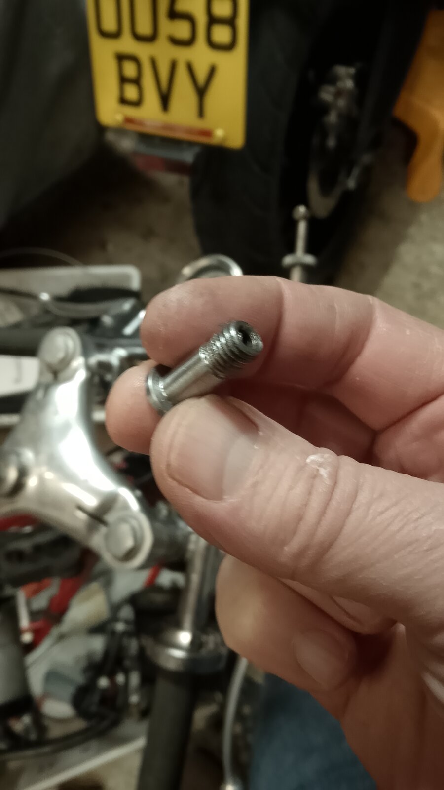

    I've also bushed out the clutch and brake lever and made some Ducati style hollow lever axle bolts. IMG_20250218_192941.jpg

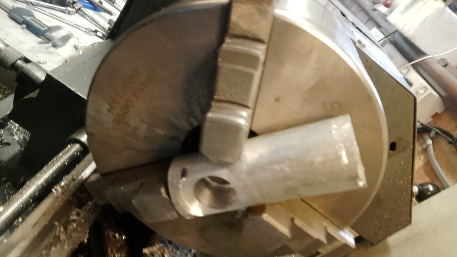

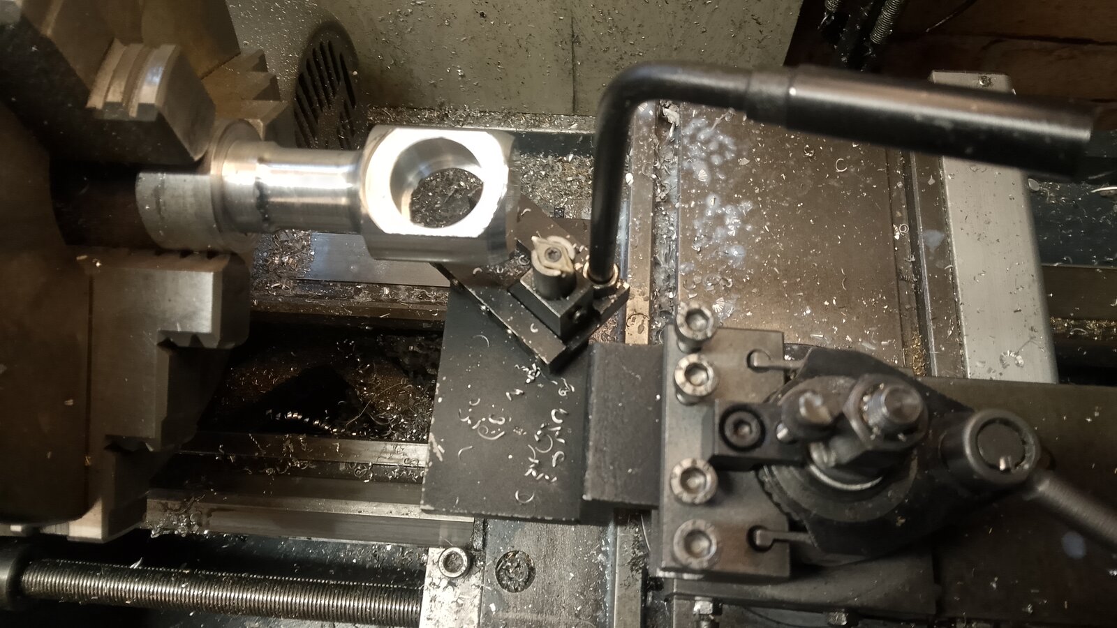

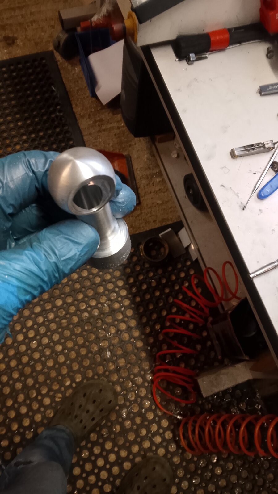

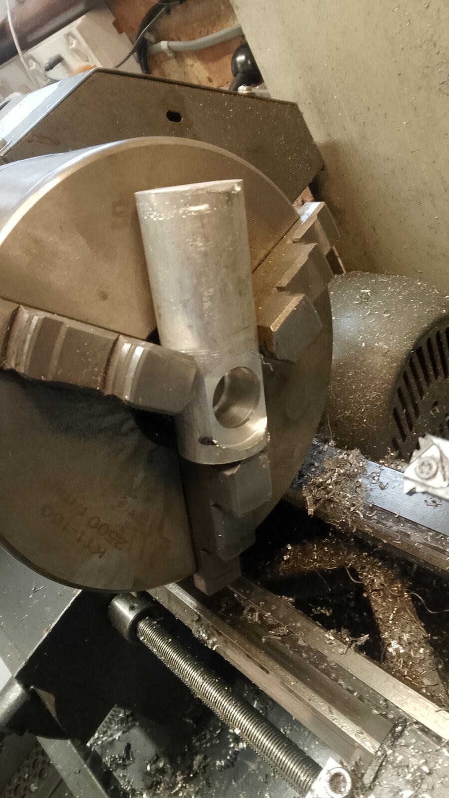

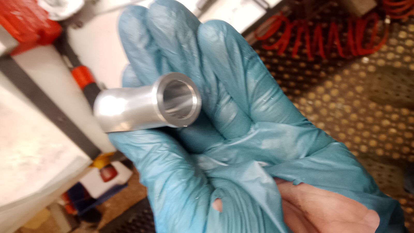

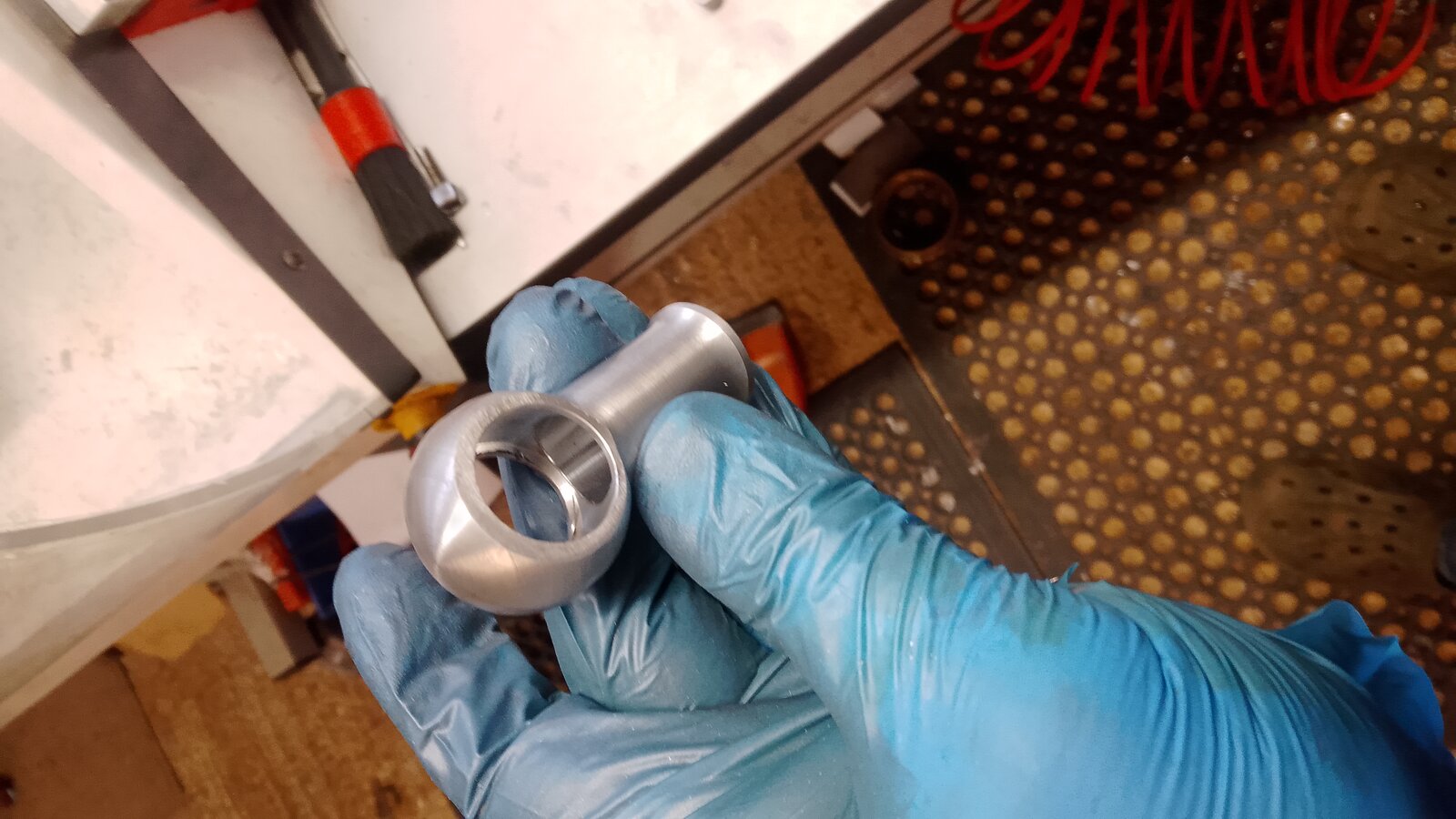

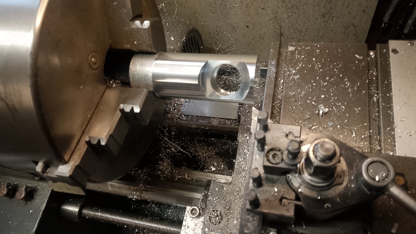

  3. Next is the water inlet. For routing purposes a 90 Deg fitting is required, which was in there but it faced the wrong way. Always a problem if you screw in such a fitting. The thread ends where it ends. I felt a banjo is best. Had to do a bit of working out so flow doesn't get restricted. The outlet of the radiator I'm using is 15 mm diameter so there's little point in going bigger.
    Making a banjo on the lathe was fun. I did enjoy that.
    #23 Petsmith, Feb 20, 2025

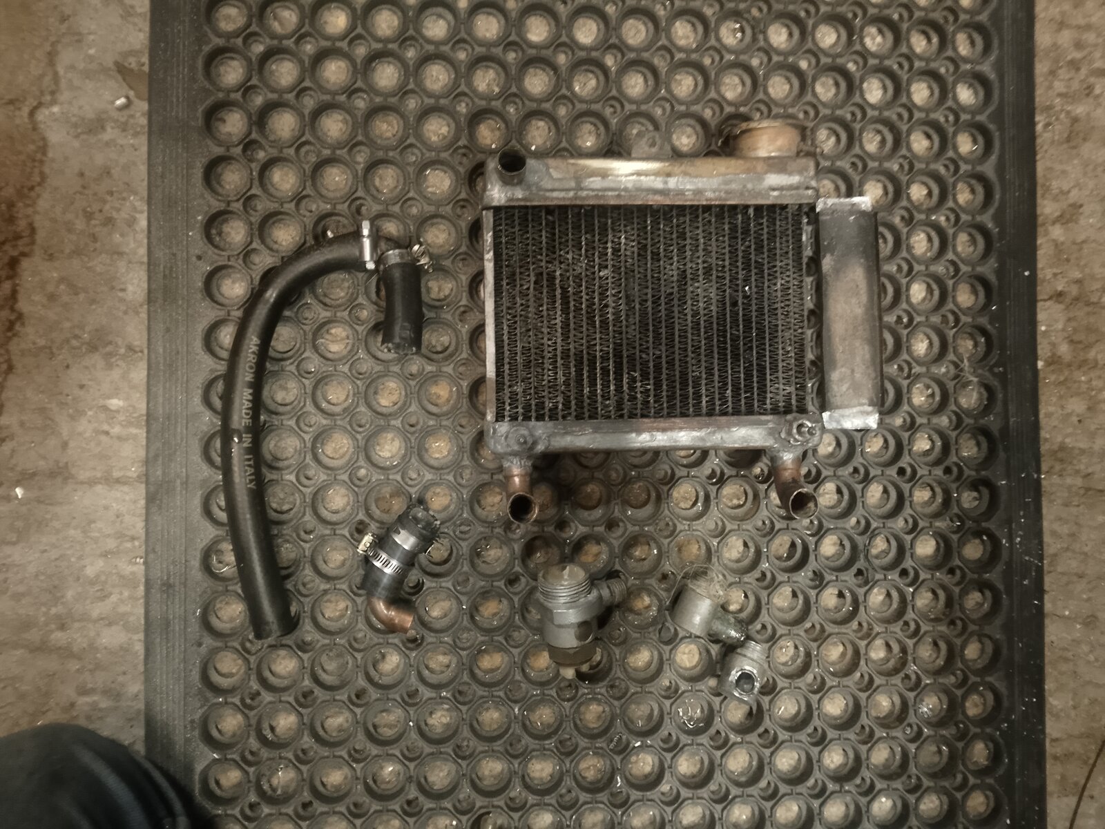

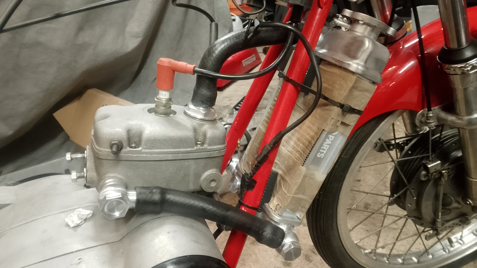

  4. Off with the old and on with the new. The water system is taking shape. Chucked all the old stuff away as it wasn't really usable and started fresh. Had a busy couple of days machining all the parts.
    Less than half the weight which pleases me no end. IMG_20250224_214729.jpg IMG_20250224_214342.jpg IMG_20250224_214325.jpg IMG_20250224_214316.jpg IMG_20250224_214246.jpg IMG_20250224_214445.jpg

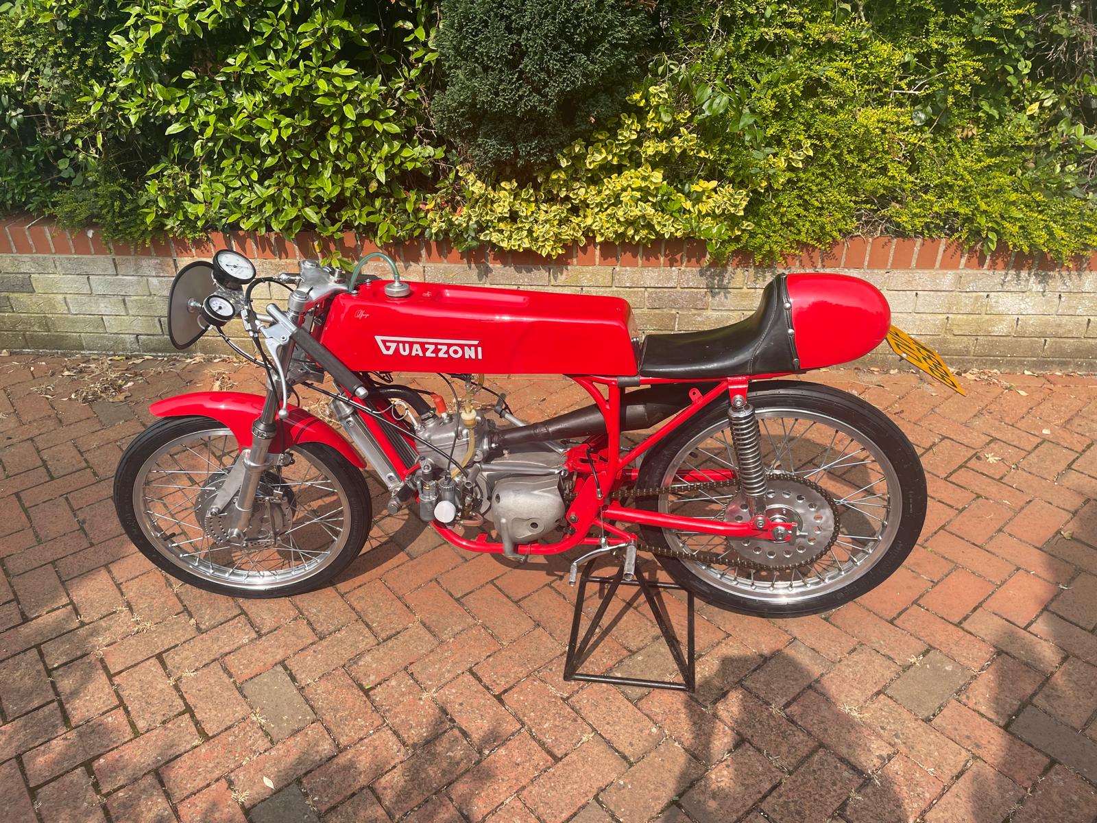

  6. Still a way to go. Haven't looked at the brakes yet, the tank is just sitting there, the instruments need a proper bracket, new brake and clutch cables, a number plate bracket..... The list is still long.
    Anyway, the plan is to get it technically sound and use it, probably as a naked this summer and then paint it all in the winter so it's going to be all lovely lovely this time next year.
