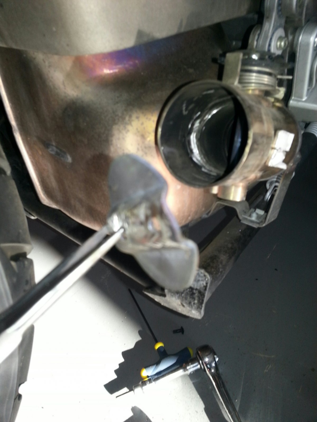

  1. 20170428_175303_resized.jpg Got you you lill fucker lol

  2. Nice one, notice a difference??

  4. My exhaust butterfly vavle mechanism seized and the engine light came on.
    It was eventually replaced under warranty but before it was the dealer tried a short cut (disconnected the motor cables) but the DVT's slightly advanced system showed this up and the light cam back on after the dealer reset it.
    So I'm guessing removing the 'butterfly' itself (as above) would still leave a light on if the mech was already seized?
  5. Yes, but with the butterfly removed, the engine restriction you face (5-6000 rpm limit) when it seizes shut is gone, and on the DVT at least, I've had no warning if mechanism seizes, so as long as the butterfly gone, I don't care if it seizes. The shaft and spring that are left in-situ don't restrict the engine rpm . As an added bonus, when the valve normally pulls in at 3000 ish rpm, there's a little more punch and noise from the motor, with no butterfly there.
  6. My butterfly seized shut 3 times in Spain, with no dash warning, hence why I was confident of removing it, so I imaging the warning is if it seizes open , where mine was seizing shut, all good now though, and I drilled it out over a 1000 miles ago, no warning and all is well.
  7. Haven't tried it yet but just seeing how restrictive it was in there I'm sure it will be an improvement for sure!

  15. Had an 'idiot!!' moment yesterday - used a combo of 4mm drill bits and dremel to cut of the welded screw heads, all spot on until I lost grip of the butterfly disc and it fell into the cat!!!!! removed cat and cant the life of me get the disc out! Gutted!!
  16. Doh!!! Hit it harder with a bigger hammer :)
  17. yeah i certainly had the rage with it last night, my arms were pumping lol! Ive decided to stop waiting and order the Arrow works titanium with decat, might as well while Ive got the 10 tonn cat off! Just hope it turns up before my Scotland tour on the 11th June!
