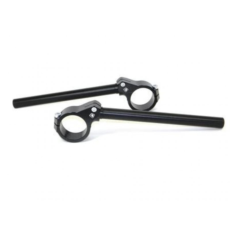

    I feel they need to be much further Back and lower but obviously they aren’t adjustable as standard so would need aftermarket clip ons.
    Has anyone tried any?

    Maybe you could try the race or comfort seat. That would raise your seating position up and put a little more weight on your front end. If you are still struggling with the reach after that, you could look at the DucaBike clip-ons. They do a set that bring the bars back.

    If you think the bars are too flat, try a set of aftermarket bars with a more aggressive angle. I think 7* is the more aggressive one, if I’m not mistaken.
    https://www.revzilla.com/motorcycle/vortex-clip-ons-7-degree
    http://www.cycletreads.co.nz/produc...ars/17060-zeta_pilot_handle_for_street_c.aspx
    Other than that maybe a taller seat so you’re putting more weight on the bars.

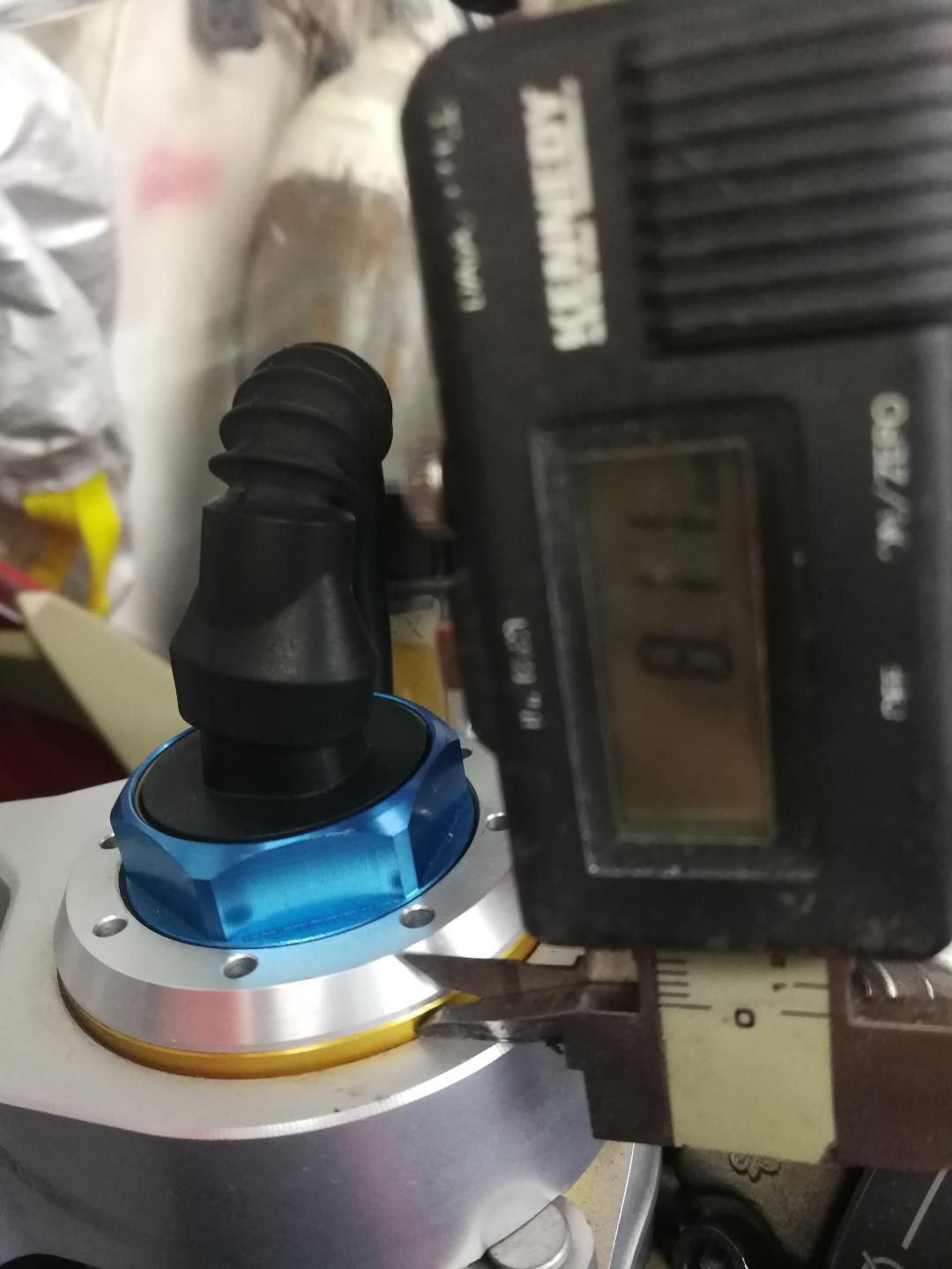

  12. If you want faster steering then shove the forks yhrough the yoke a few mm. I have done this on mine, start with around 3mm and see how it feels. It made a huge difference on mine
