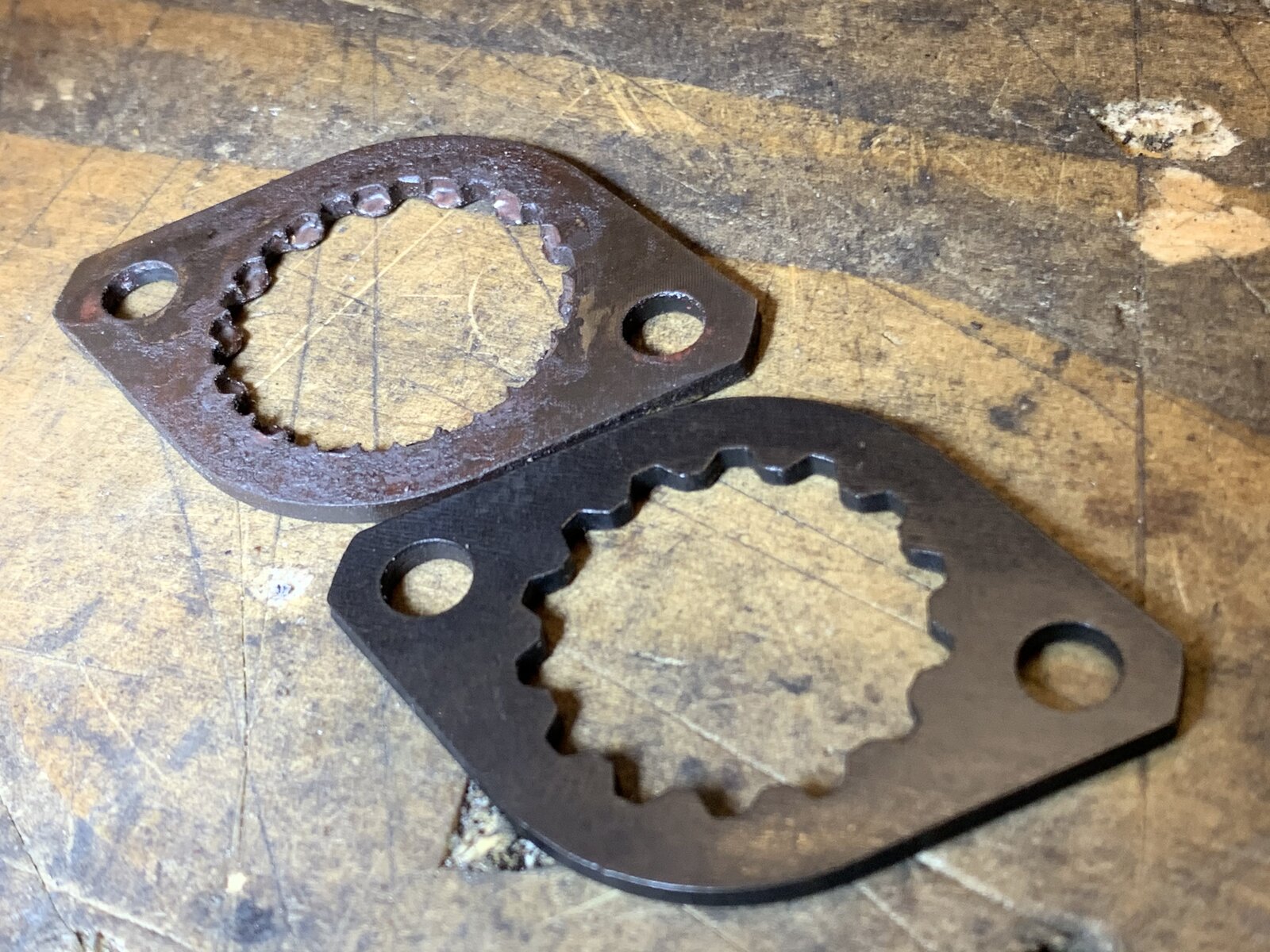

  3. Mark, it seems you missed the point on this post as well, BTW I know where the locking plate should sit and how much movement to expect of the sprocket with the locking plate fitted correctly. The sprocket should move very slightly on the shaft (unless it has rusted on like Paul's) and you normally get witness/light wear marks on the splines from the sprocket and witness marks on the plate teeth where they sit abutting the splines within the groove on the shaft. The plate must have worn as a result of the sprocket and/or locking plate moving excessively. Eventually the locking plate teeth have been worn away by that movement leaving nothing left to prevent the sprocket sliding along the shaft. So you either have an alignment issue, the plate was loose - perhaps due to a bolt falling out at some time, the chain has been running far too tight or you had a single dodgy plate. Frankly I doubt it was the plate. I have had a 748 for 13 years which has over 40k miles on it which has the same set up and have changed the front sprocket a few times but as far as I know still use the original locking plate. To get the amount of wear you have suggests to me a problem elsewhere that needs to be bottomed out before it gets expensive.
  4. [​IMG]
  5. I do apologise for missing your point again Denzil, perhaps I speed read it a little or perhaps it could have been written more clearly, but I don’t think given the amount of incidences of this issue on other Ducati’s that use the plate that it is necessarily a product of misalignment, over tight chains, or other maladjustment (although I wouldn’t rule out extreme maladjustment as potentially being a contributory factor), Ducati make this a yearly inspection item on their service schedule , that leads me to believe that they expect this item to wear, certainly my bike has never had its chain in an over tight condition, or misaligned, it was serviced by Cornerspeed for the first 2 years and had an upgraded chain fitted by them 6 months into the 3rd year at which point they will have adjusted the chain again, in between services when necessary I adjusted the chain myself, I’m meticulous when it comes to this sort of thing, my mechanical skills include full engine rebuilds so I’m more than capable of adjusting a chain correctly, I suspect that tolerances between the splines in the sprocket and on the shaft (manufacturing variance) could could be a potential contributor (more movement of the sprocket relative to the shaft) but I think the true root cause is the design itself, this was a known issue on the 797 which is very similar if not identical in design, there will always be variance in wear across a population of parts, yours having survived for 40k miles being at one extreme and the example given above lasting 2.3k miles being at the other , I checked my M900 and wear was evident but not severe, I checked my 900ss and no wear is visible (Note nobody other than myself has adjusted the chain on my 900ss in the last 5 years).

  15. Thanks for the heads up, I checked mine and you will see the wear on the BACK side of the retainer, compared to the replacement in the foreground. I have done 10000 miles on my Icon and chain obsessively nurtured throughout.

  17. That was getting close!, mine went at approx 10k, I’ve checked it again this morning, the new plate has done approx 1700 miles, no signs of wear, I’ll check it again at 3k and report back.

  19. Those two have different spline counts to my eyes :thinkingface:
