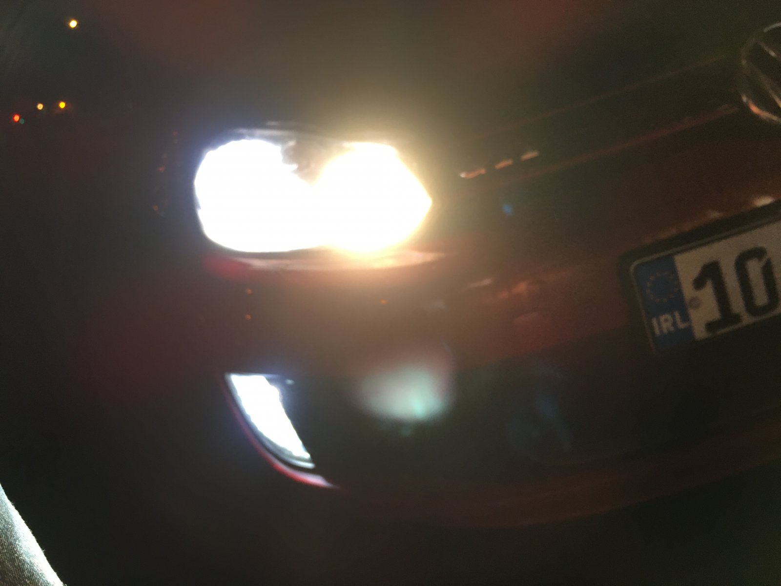

  6. I have these bulbs in my headlights on my golf and I still have a hid kit in the spot lights for the moment . I'll get a photo with them both on .
  7. Actually found one , the spotlight is a hid kit 8000k the headlight on the left is the dipped beam Philips 5000k and on the right on the headlight is the high beam standard bulb . IMG_0331.JPG

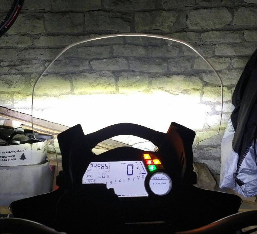

    However things have moved on and with the advent of COB LEDs there are LED replacements for headlamp bulbs that work as well if not better than the bulbs they replace. These LEDs radiate light in all directions in a hemisphere. By placing two back-to-back at the focal point of the reflector they emulate the bulb very well.
    I fitted these to my MTS for the high beam and I was so impressed I have taken out the HID dip beams and fitted LED to them too.
    I haven't had it out on the road yet but they look good on the garage wall and I'm confident that they will be a success. If not, they weren't expensive (£22) and I can easily revert back to the HIDs.

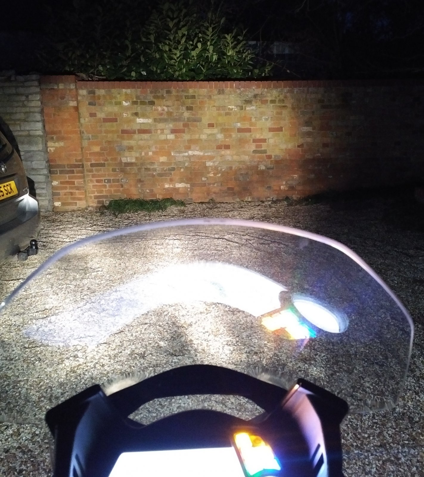

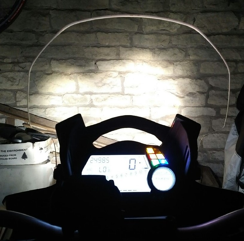

  16. Yes it came out of nowhere....I must try and get some better pics to properly show the beam.
  17. Some better photos - the LED dip is incredible and should really assist those in metal boxes seeing me in daylight! Probably needs adjusting down a tad. By comparison the main beam look dull and yellow. Lights LED Dip.jpg
    Dipped LED
    Main beam Halogen Nightbreaker Plus
