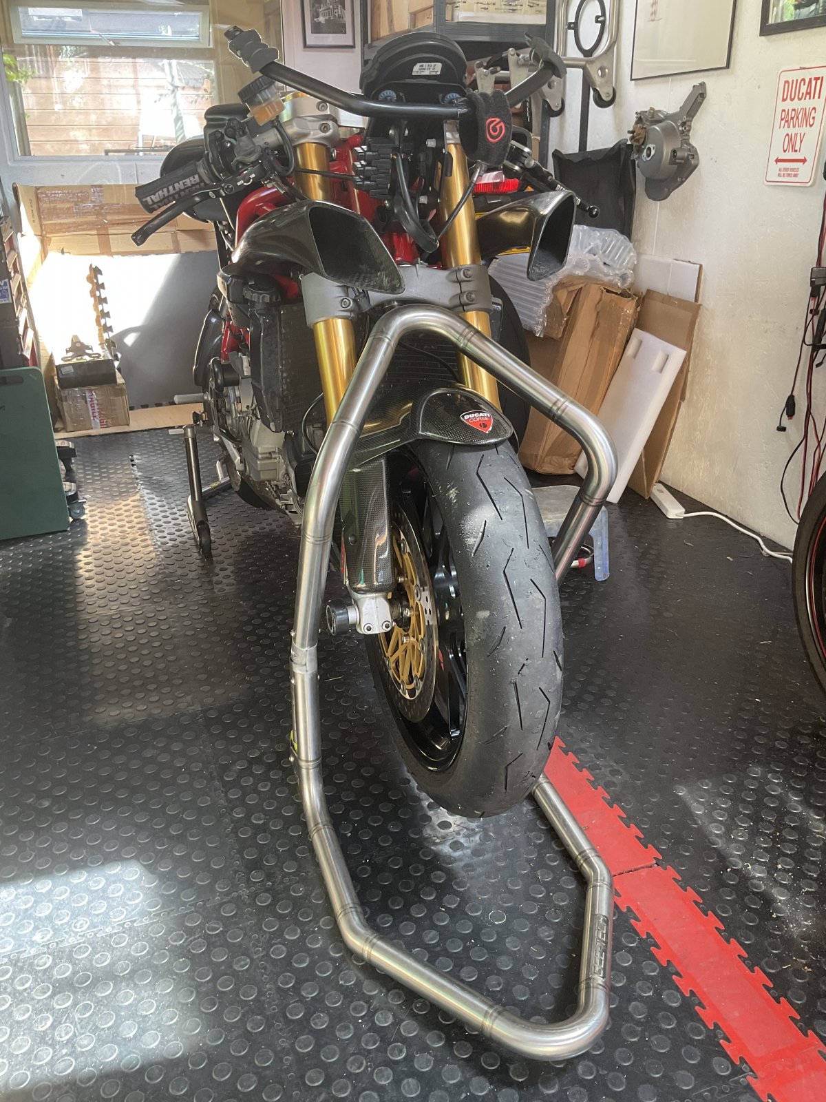

  1. Afternoon all,
    I have just bought a lovely second hand Gee-Tech Headstock Stand.

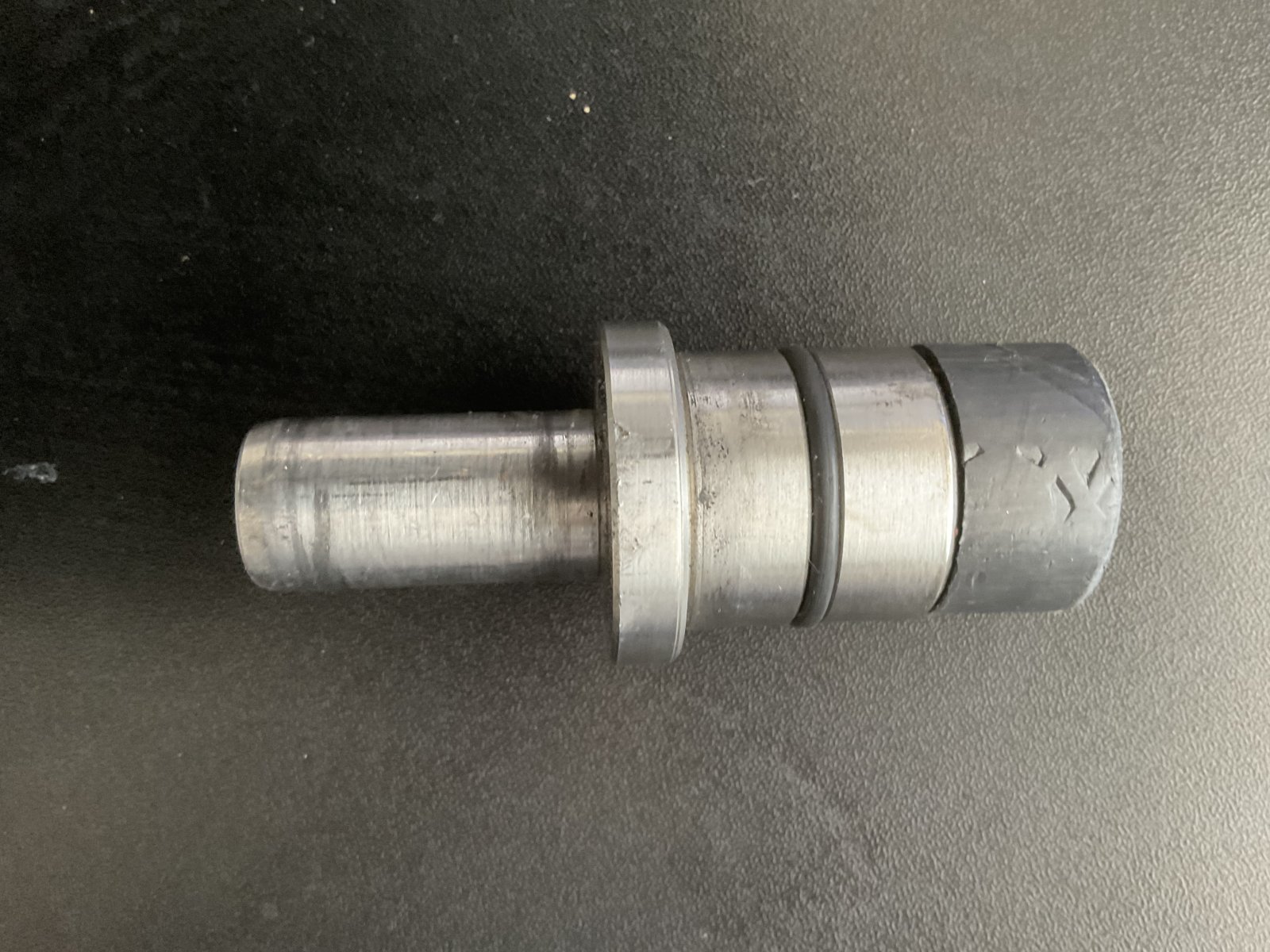

    I knew that the 16.68mm dia pin supplied would not be suitable for my 749R.
    Shouldn’t be a problem as so I can get it turned down to the correct size.
    I measured the hole in my yoke and it’s just under 14mm diameter - bit tricky to do as the internal prongs of my caliper aren’t quite long enough to get a reliable reading.
    Couple of questions:
    Does anybody have a pin for a 749R? @Paul55 ? @nelly ?
    If so, could you measure it please?
    What sort of clearance is needed - tight fit or fairly loose.

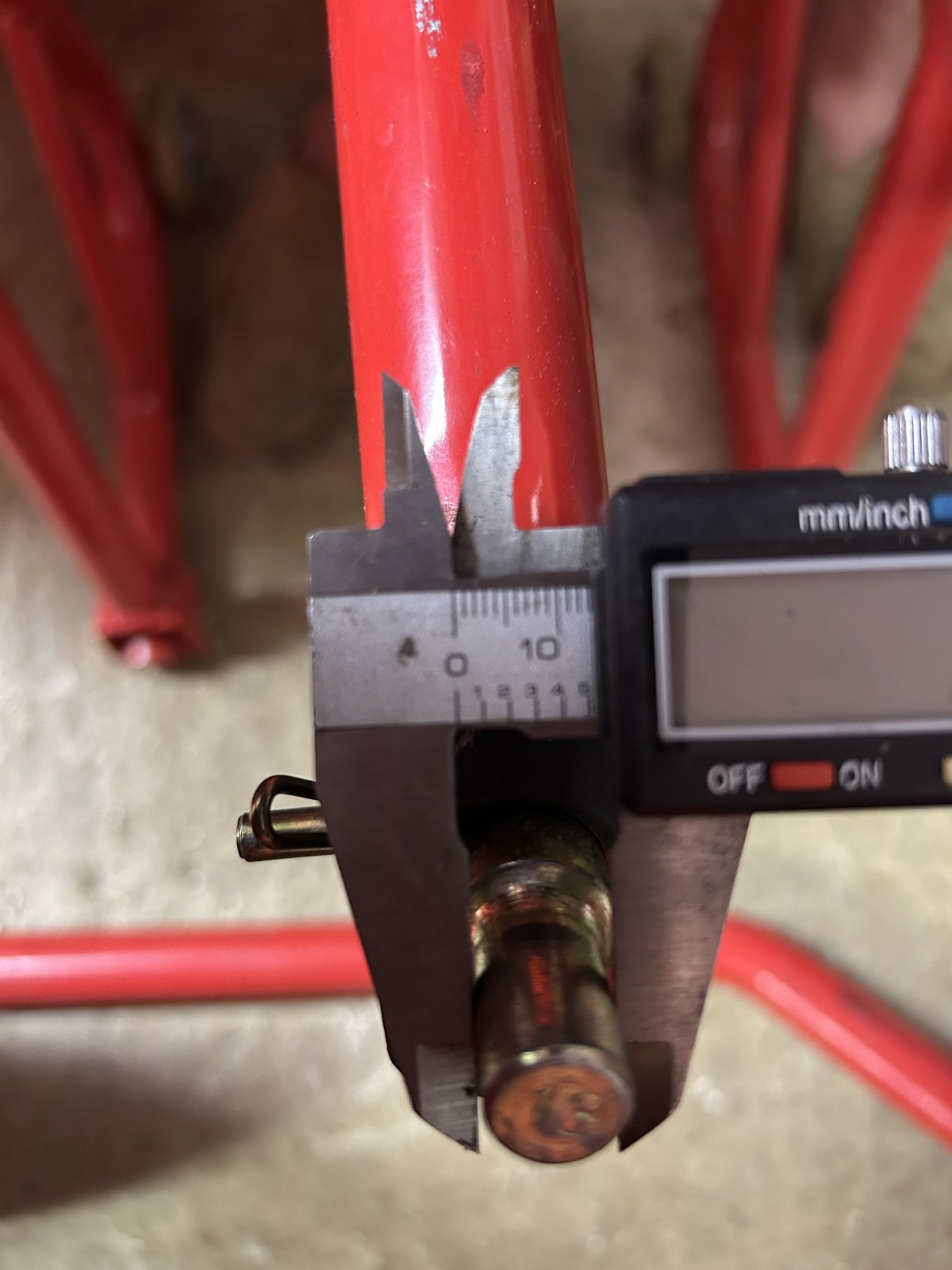

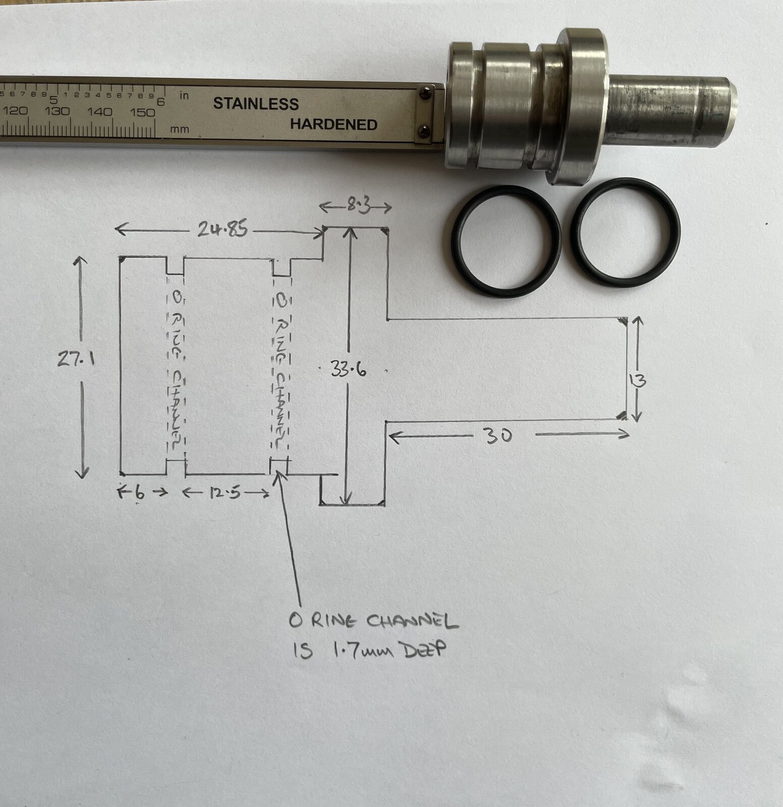

  2. I will get the measurement for you tomorrow although I think this stand is not specifically for the 749 hole.
  4. Ooh, that's great Richard! Thanks!
