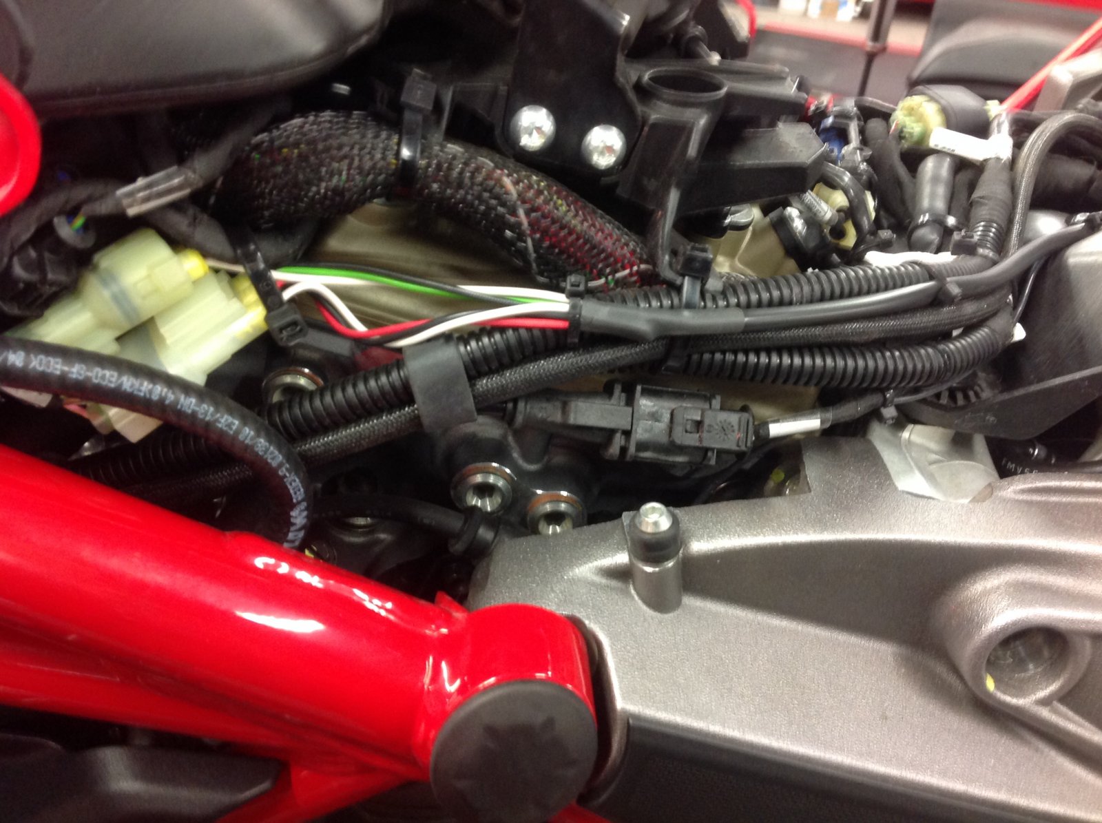

  6. OK fitted and working fine. Will post details and pictures tomorrow or Friday. BTW it doesnt connect to coils, its one connector to the injector control, one wire for horizontal and one for vertical cyclinder and a common.

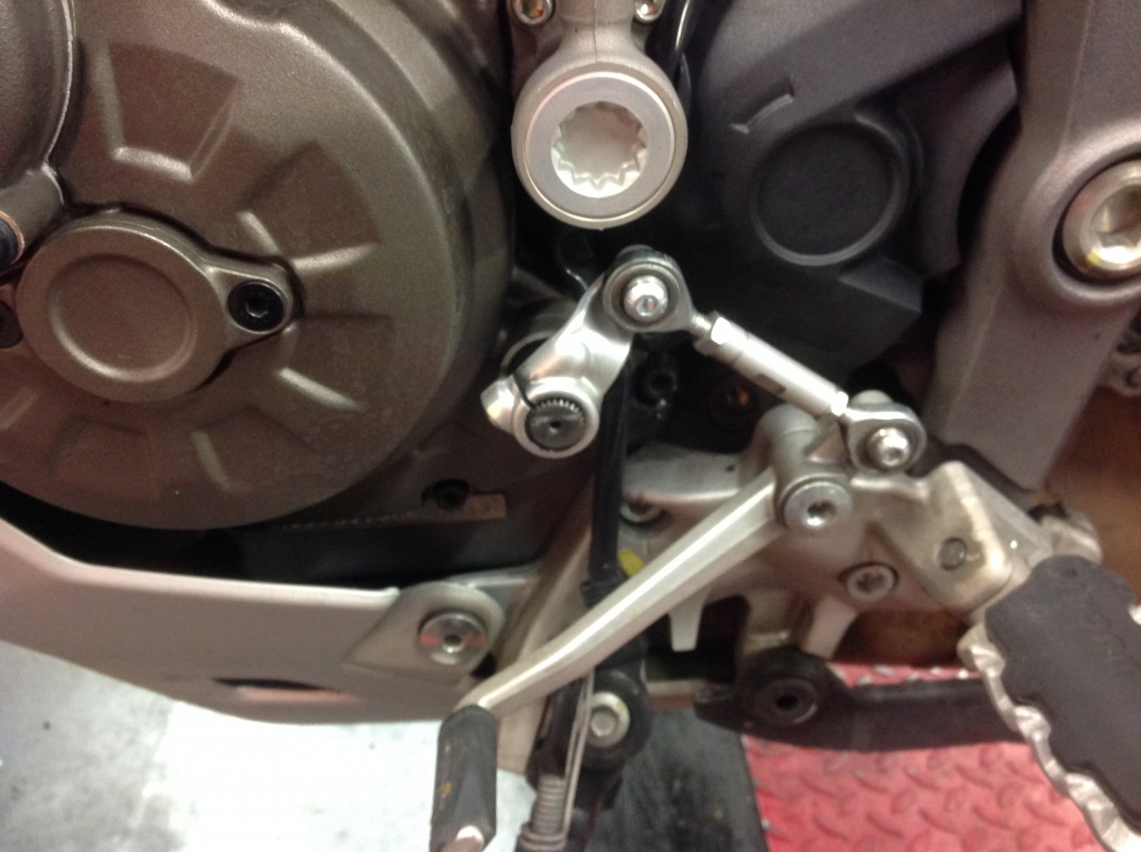

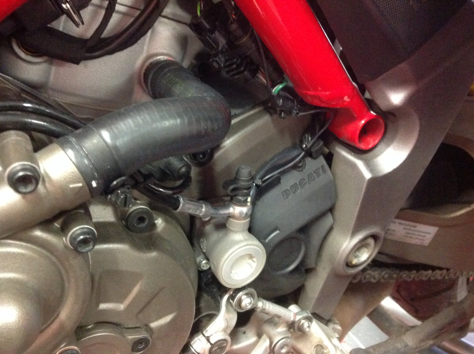

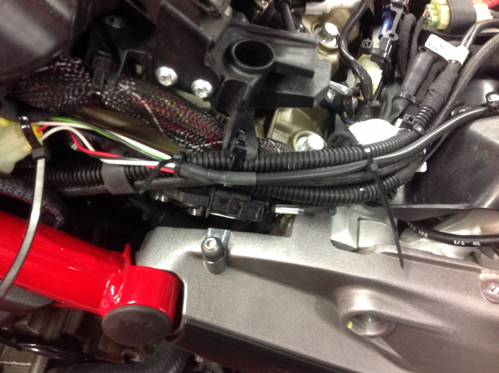

    As you will see from the attached photos, the Heal tech QS comes with a round sensor that fits on the gear box spline linkage bolt. They supply a new longer bolt. This in theory allows D/s as well as Up shifts but I woundnt recommend down shifts for below 5 to 4. Be sure to install the two conical washers like this ( 0 ) around the sensor.

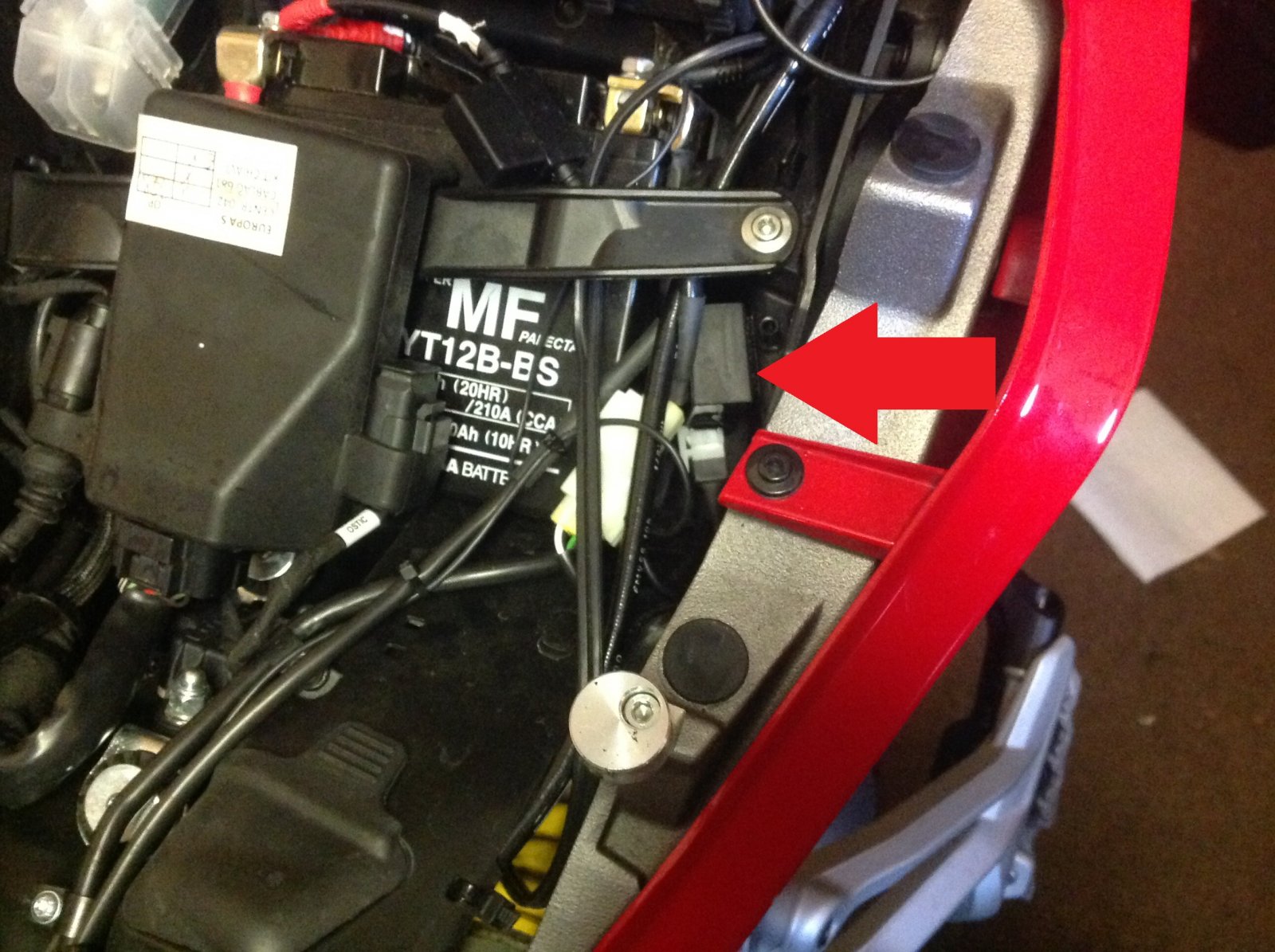

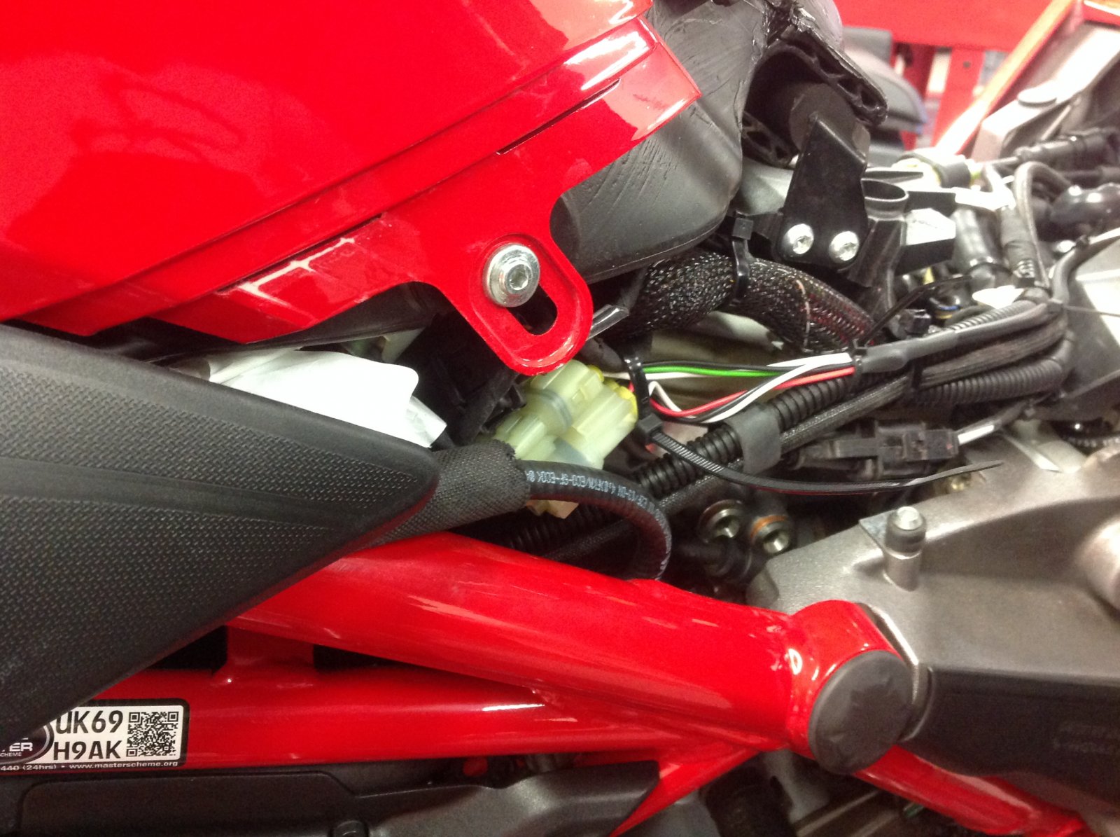

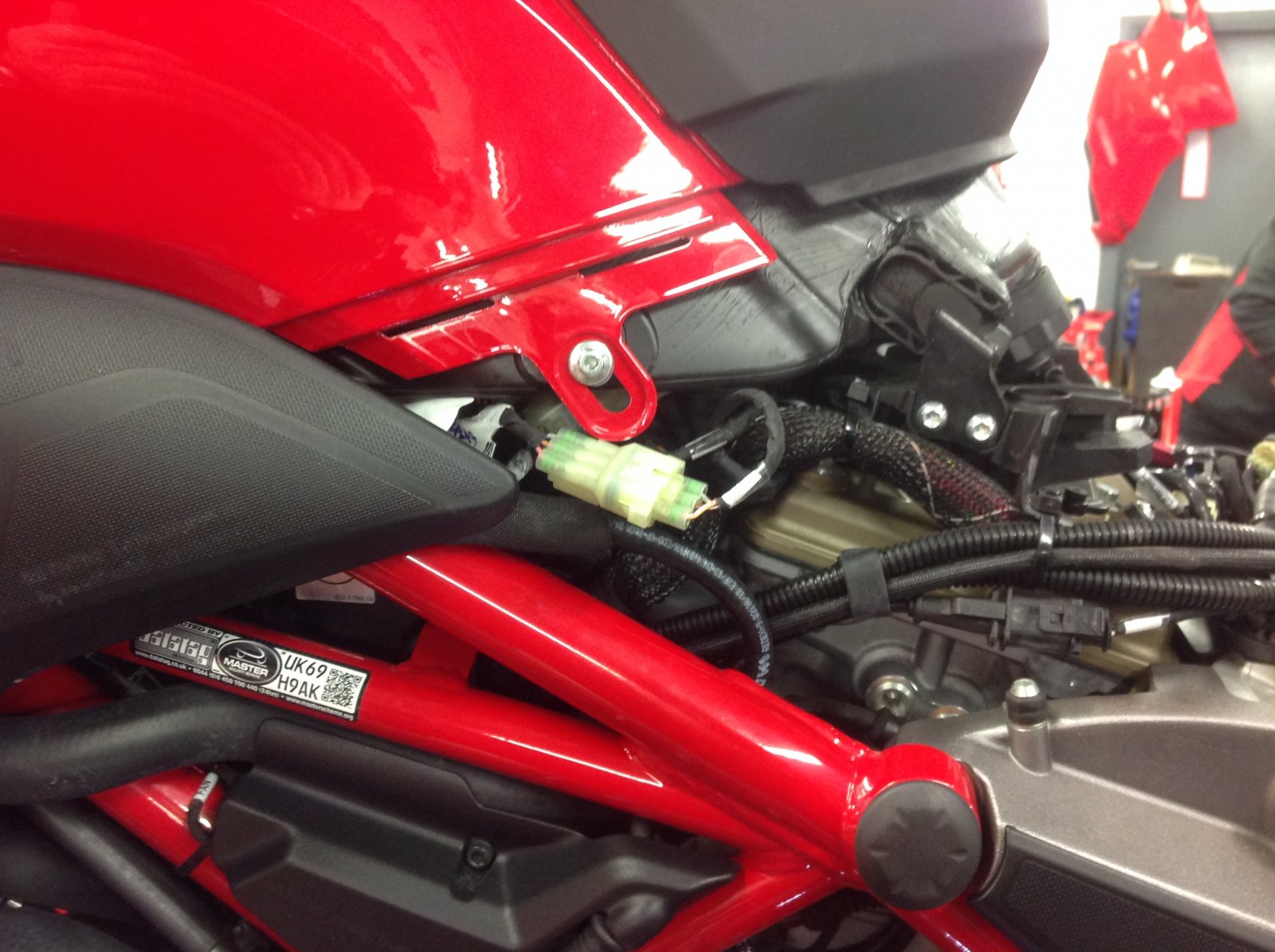

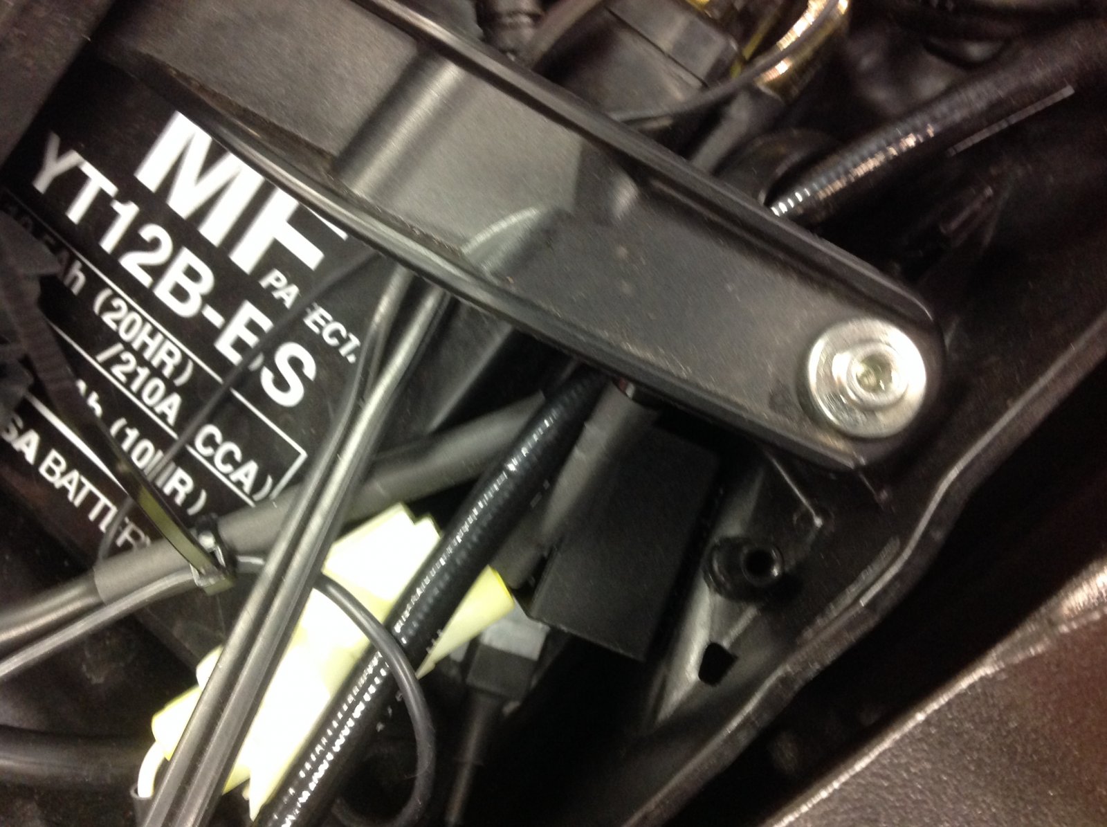

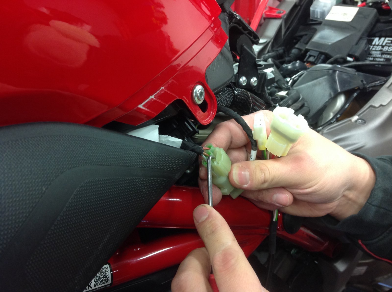

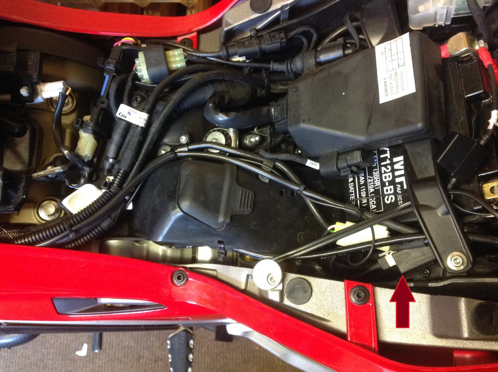

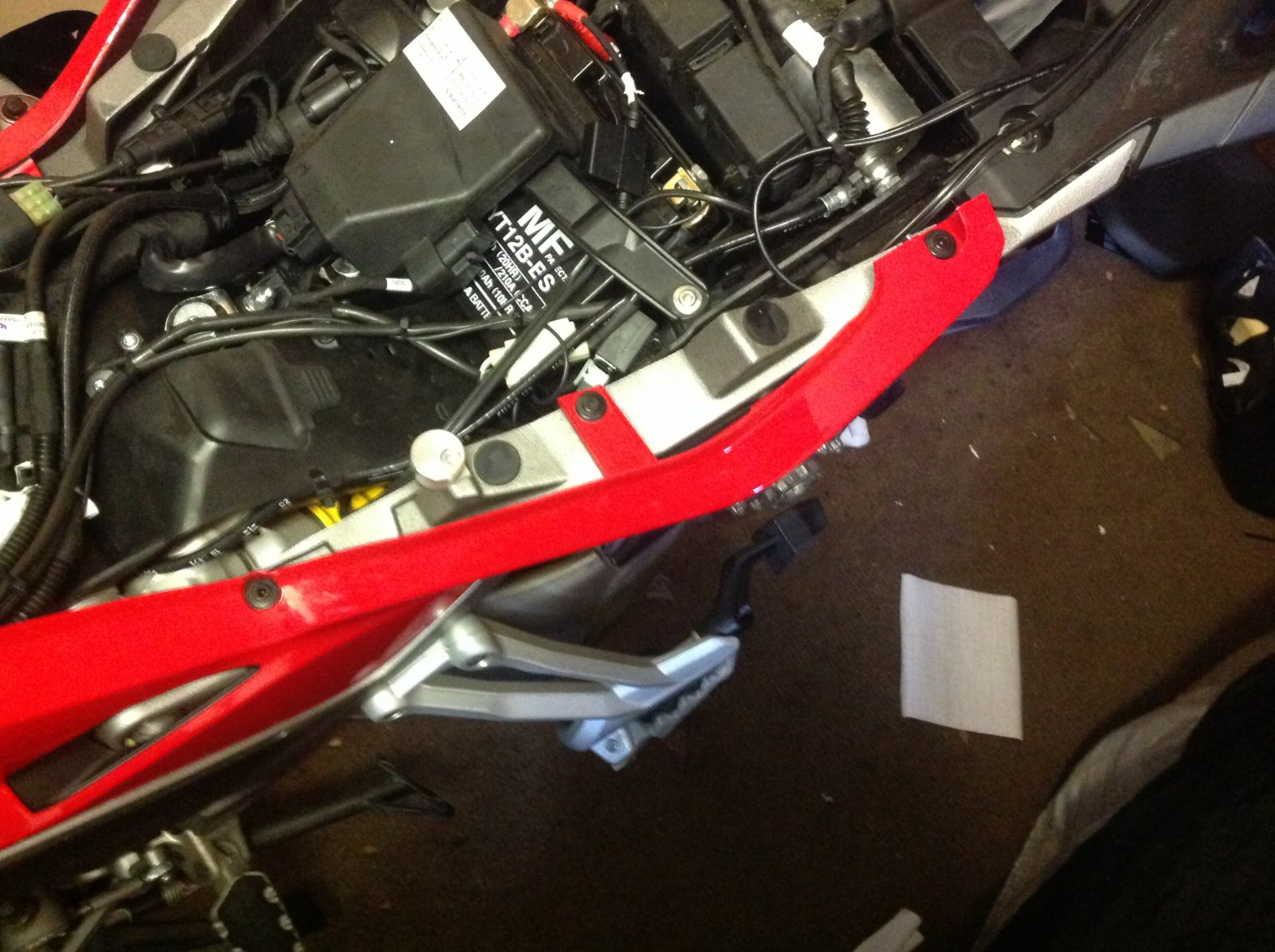

    The unit which I located under the riders seat next to the battery connects to a single connector situated on the LHS under the tank. Its possible to get to this 3 wire connector ( marked "INJ") without removing the tank. remove the LHS red panel ( 3 screws). You will need patience small hands and a spring hook as shown to free the connector from its mount. You can then pull it out and connect the QS cable. I removed the ECU mounting screw to route the cables and used the battery -ve for the earth. ( you will need to reset all the dates mph etc if you do same).

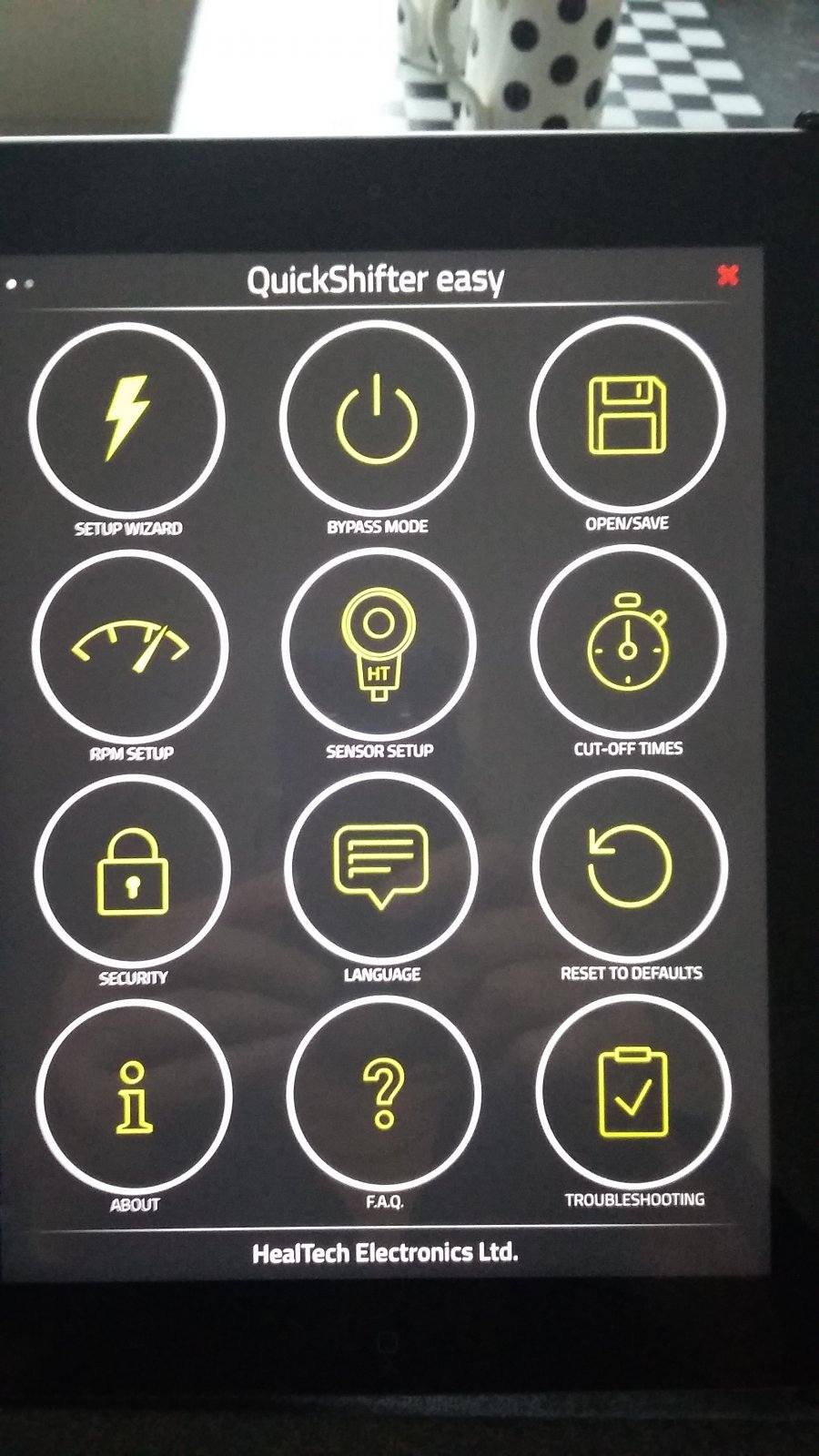

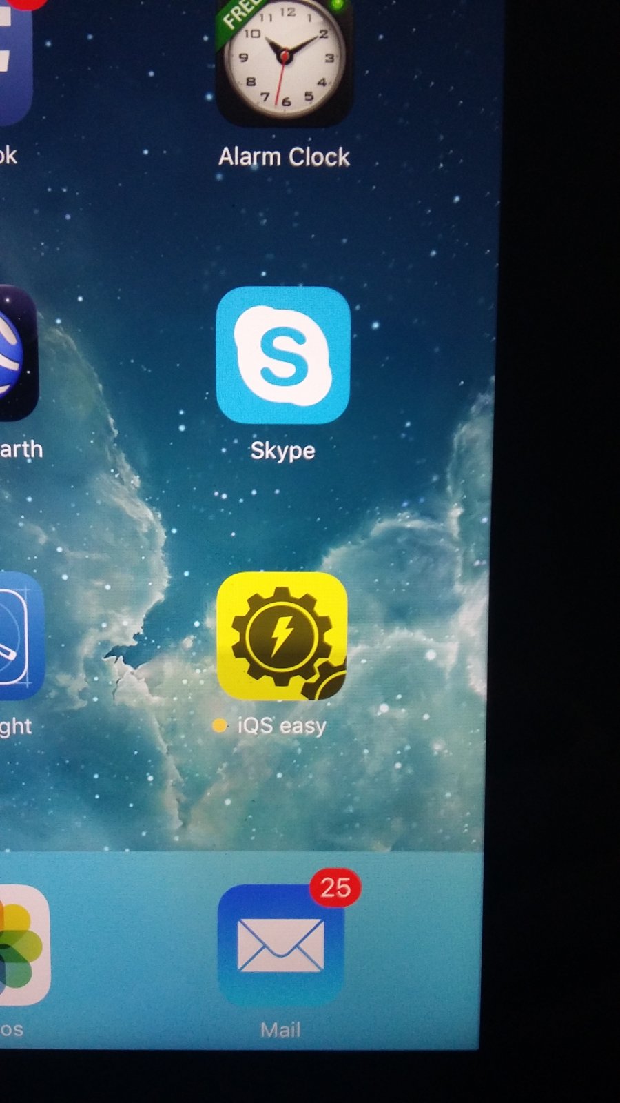

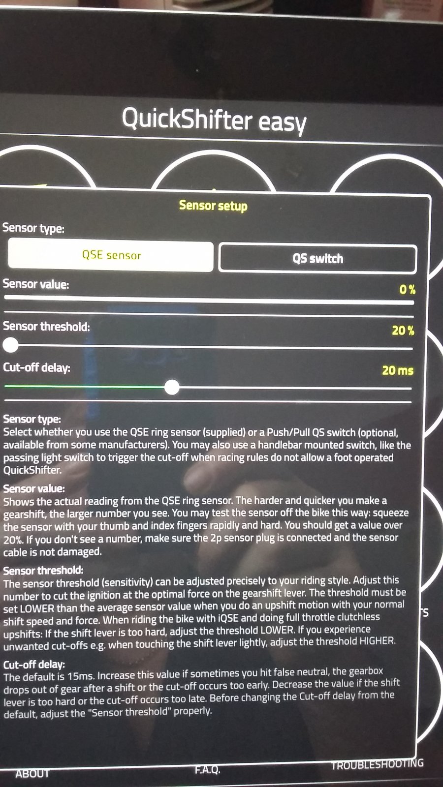

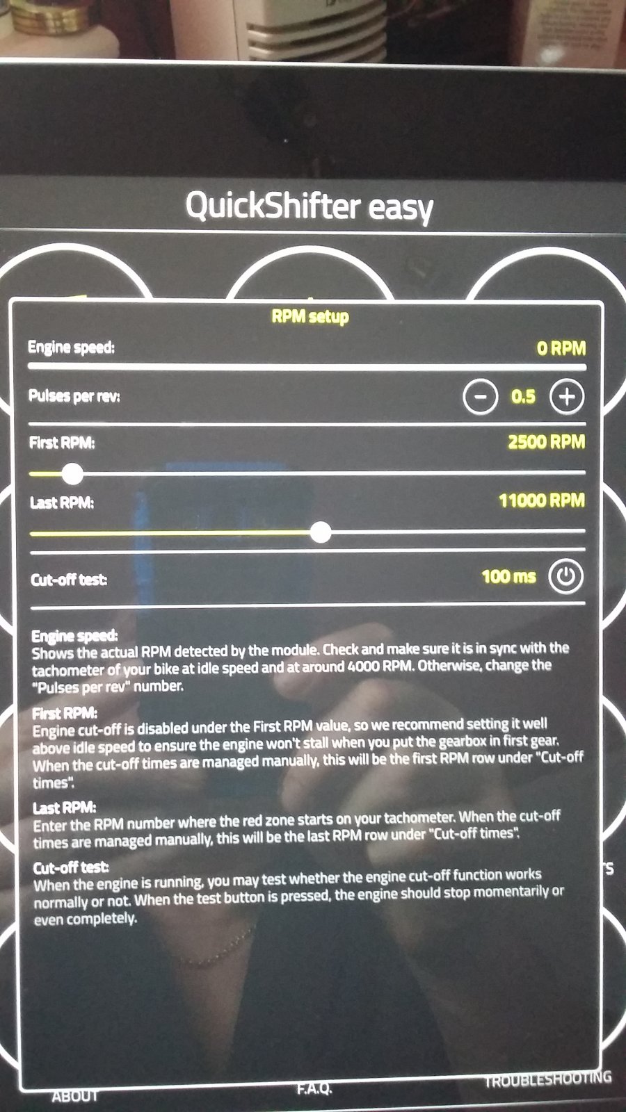

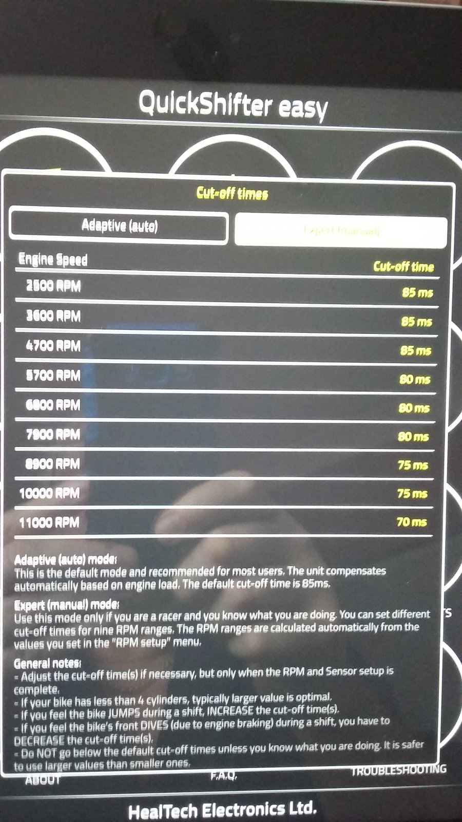

    The new unit only works with IOS ( Android coming in 4 weeks ) The IOS unit will be upgradable to support Android I am told. The new unit app, loaded from the App store has a new function which provides an Adaptive or Auto option for cut off times per Rev band. I found this to work very well.
    You will see my settings for the Advanced option which you can use as a starter.
    The installation took about an hour including linking the Ipad to the unit and setting the rev lower and upper limit ( mine set at 2500 and 11000). Cut off delay set to 20ms and sensitivity to lowest at 20%.

    20ms cut off is that a little low ! What's it like on the rd .
  11. Dave thats the Cut off delay NOT the cutoff. Its the delay from the unit sensing a movement on the gear lever to starting the cut off. The IOS easy pictures show the actual cut off times. You can save multiple versions and load them from the ipad to try the difference. I started with cut off at 120ms for the low revs but this was too long. Currently at 90ms decreasing as revs increase. The auto feature is set at 85ms but again you can change that if you want.
