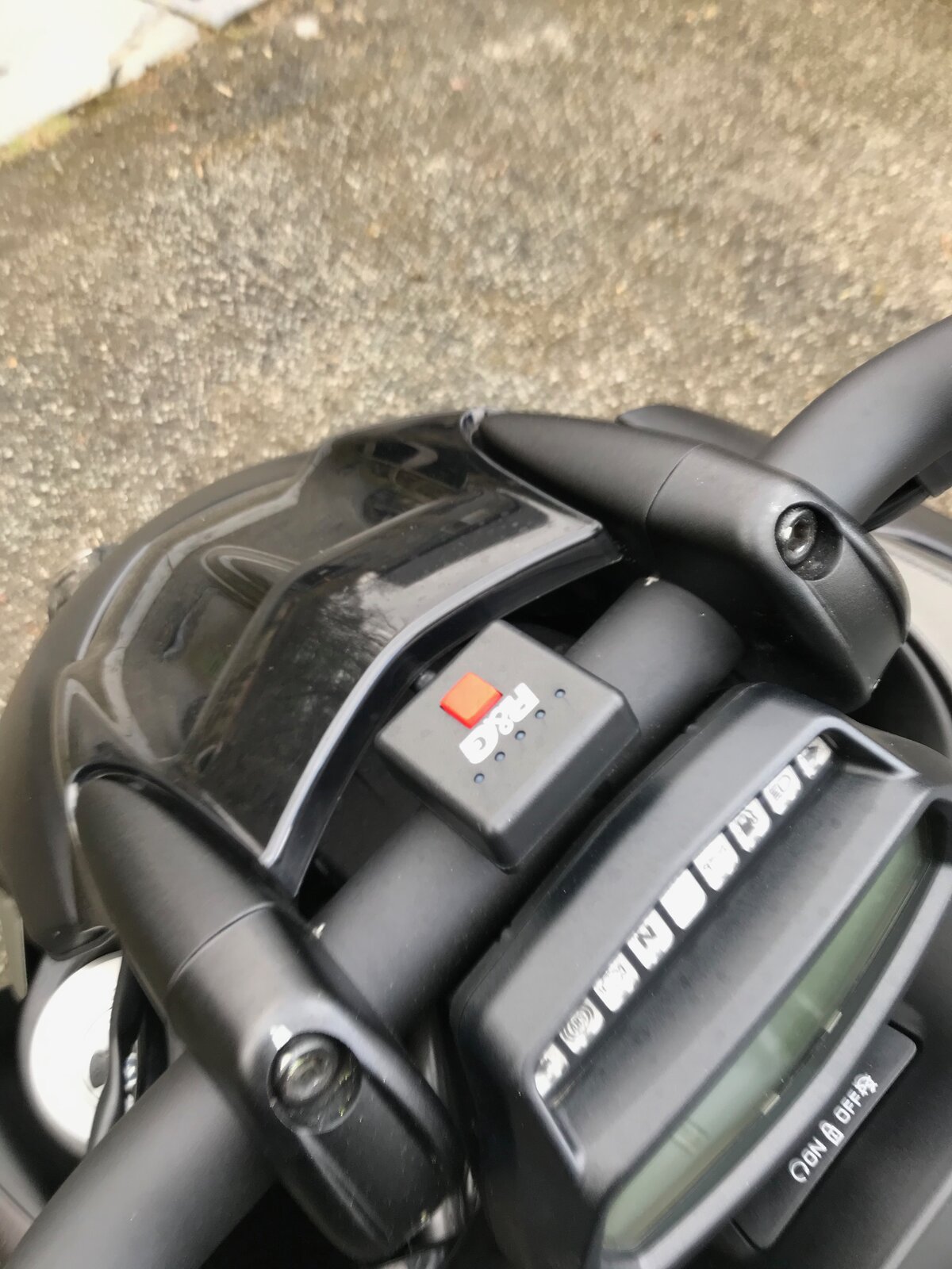

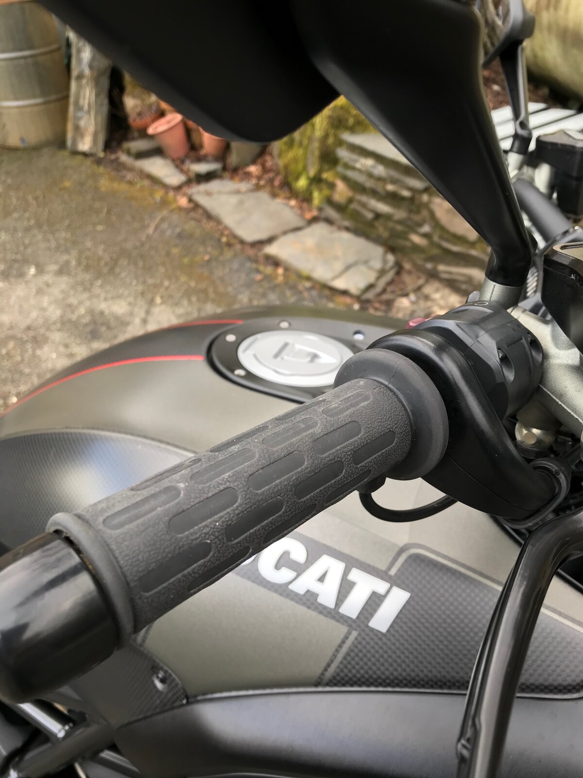

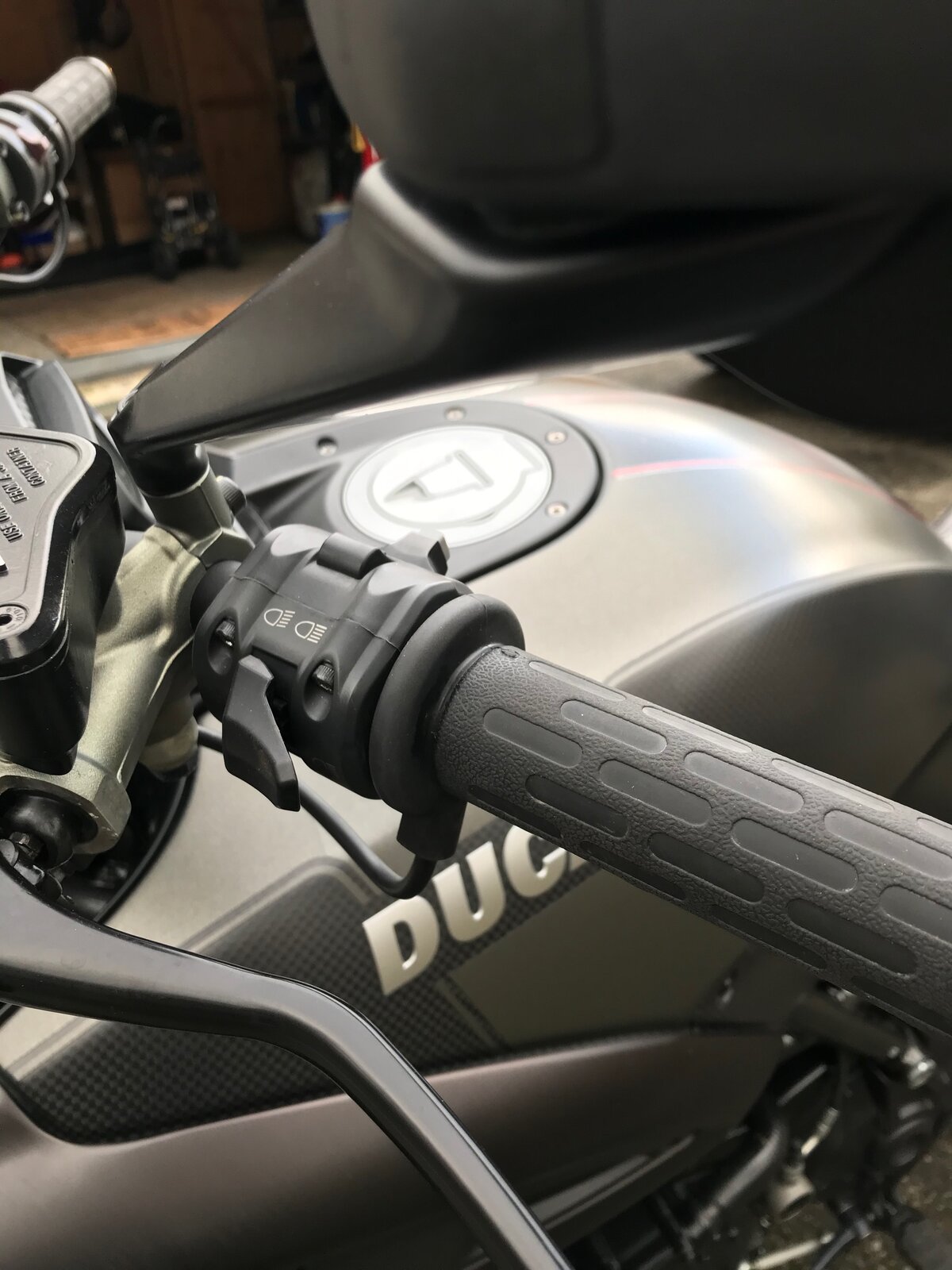

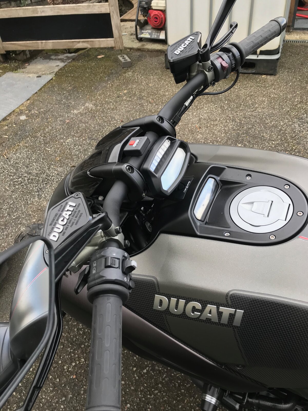

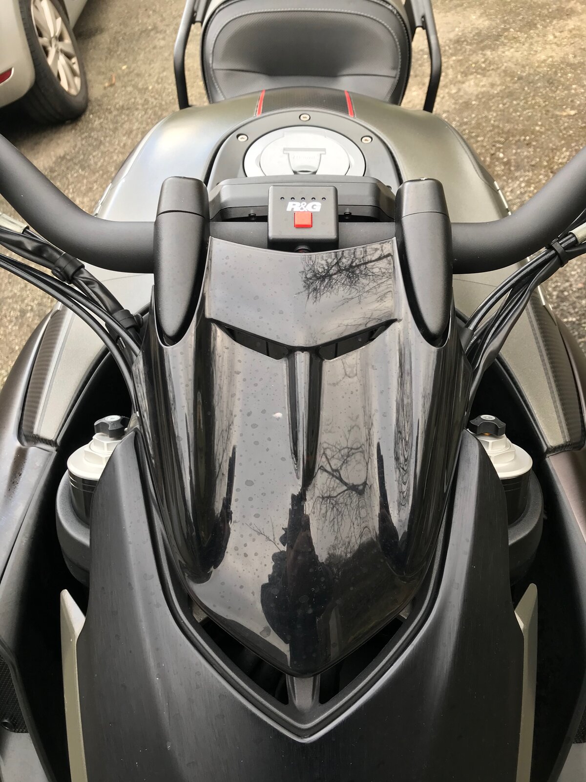

  13. I fitted as pair of R&G heated grips and wired them to the auxilliary feed underneath the windshield/fairing. They work really well - I placed the switch on the centre of the handlebar but that might not be everybody's preference. £35.99.
