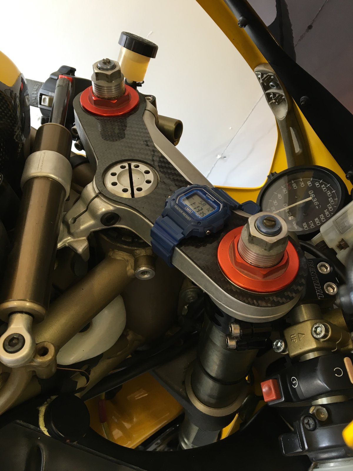

  14. Thanks for the advice folks! Managed to get the height adjuster to bits, cleaned up, greased and refitted.
    Lifted and softened the front a lot and gave it less preload. The front was solid before. Makes it loads easier to ride now. Can feel a lot more.

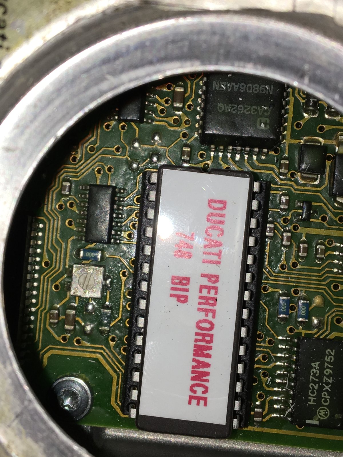

    Adjusted the idle fueling slightly and it feels loads more responsive. Is this a standard chip?
