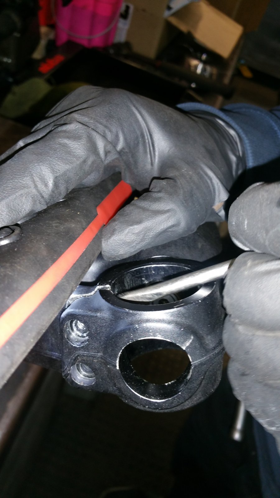

  7. Guys thanks for the advice once again.. been reading all your interesting techniques and replies.. I'll take note of all the advice you given to me as I'm sure it will be helpful for future reference. :thumbsup:
    I definetly get on that list of tools you've suggested for my workshop in case else happens.
    Today, i got that stripped bolt out :smiley: Was relieved that i can continue the completion of my 1199..
    Ordered 4 replacement pinch bolts (M6) on my list to Ducati.. waiting game now for parts..
    U Must wonder how i did it..?
  8. Made a slot and unscrewed it with a screwdriver.........
  9. Almost Quantuman…. Took the fork leg out of the bike, put it on a vice, centre punch the top of the strip bolt then with a thin flat head screwdriver flick it around on the side of the fork (were there is a cut out on the side) as it turns just almost like drifting it with a drift.
  10. It was seriously free in the threads then
  11. Sooo lucky the bolt broke rather than the threads stripped...

  16. Either read the wrong torque setting, confused Lb/ft and Nm or incorrectly set torque wrench. Also some of the torque settings in ally threads need lubing with grease otherwise they bind up whilst being torqued then can let go. 6mm screws don't need much and a low range torque wrench is a good idea for anything less than 20Nm, 6mm screws in ally threads should not be much over 10Nm. So what was it?
  17. That's a good shout. I never thought of that.
  18. 19nm, I set the torque values as these settings are for "Ohlins fork feet clamps to clevis pin fastener only S version"
    Which I think it's wrong, I must have the Marzocchi forks which suppose to be 6nm. And M6 bolt is the small bolts. :confused: Got confuse with S version as mines is the S version.
    Is the Marzocchi forks are the ones with black cap on top of the fork with a red dial fitting on the top of the fork?
  19. Centre punch the top of the strip head to release tension, after spinning the bolt from the gap on the side of the fork with a slim flat head screw driver. Success!! Threads seem okay.. just waiting for replacement bolts.
