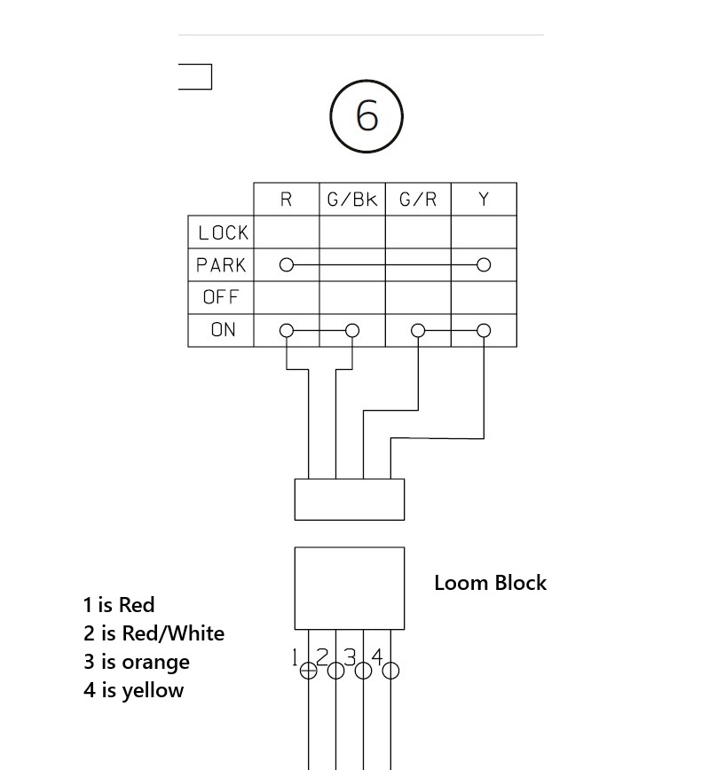

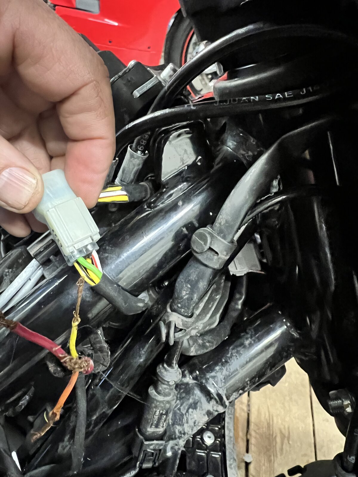

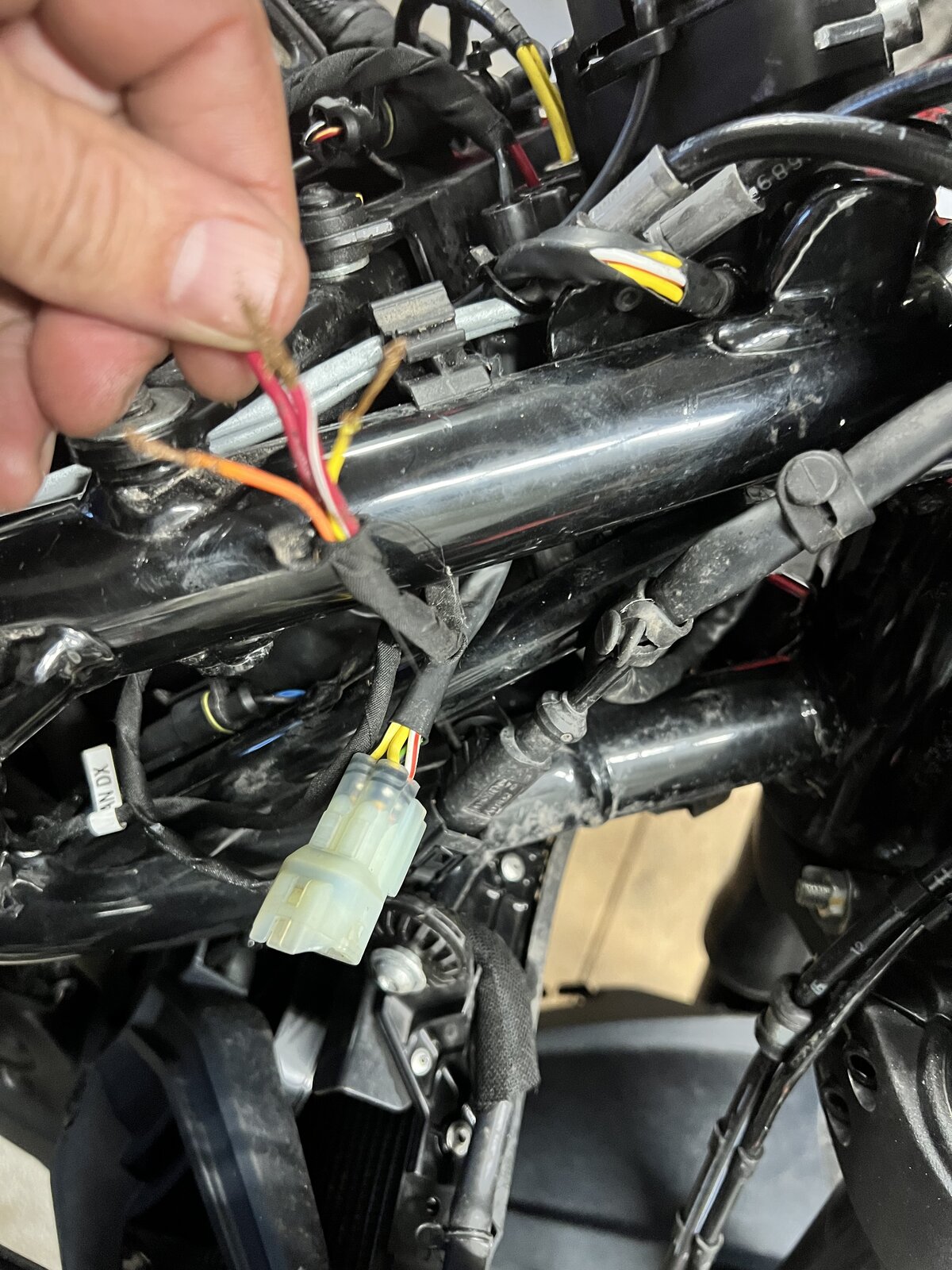

  1. Could anyone possibly help with my stolen recovered Ducati Hypermotard 950 RVE ignition lock wiring connector colours.
    I’ve acquired this bike & looking to return her to her former glory - however the little scrote who stole this bike pulled the ignition barrel harness connector leaving the bare wires showing on the loom side of the connector block (barrel connector is still intact ! Does anybody have one they can look at or know the colours of wires that should connect from the loom to the barrel connector block ?
    Any help would be much appreciated
  2. Try this.
  3. Much appreciated for this & a massive help
