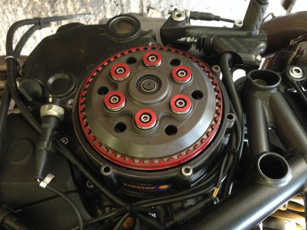

Help with clutch required.
Discussion in 'Technical Help' started by bootsam, Nov 24, 2013.
  1. I've got a new one.
  2. Got the slag off yet..?
  3. Nope. Resorting to the dremel to grind some slots in it. Bastard thing is tight. Which is remarkable given that many nuts and bolts rattle off the fucking thing.
  4. Any chance you can 'thermal shock' it? Don't suppose you have access to ( can't for the life of me think what the stuffs called now- not liquid nitrogen, but something very cold) Watched some Dutch engineers pull off a massive lathe face plate that was refusing to move off the tapered spindle, by packing the stuff that I can't think what it was called, around the shaft to chill it. what about an aerosol of the stuff plumbers use to freeze pipes temporarily?
  5. I have no access to that kind of thing CJ. However if I did, the spacer is in direct contact to the shaft. Cooling the shaft would cool the spacer at the same rate as they are the same material.
    I WILL get it off. Even if i have to remove the oil seal and grind down one side till its a micrometer thick. Then a tap with a hammer will do it. In much the same way I used to remove the inner race of lambretta crankshaft main bearings. However i will have to thoroughly clean with isopropyl first and seal the bearings with double sided sticky tape and leave my neodymium magnet stuck to where the filings are likely to congregate. What the magnet doesnt get the sticky tape will and vice versa.

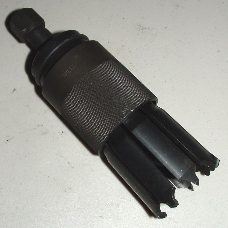

  10. This looks like it would cure your extraction problem but god knows where you could get one.
  11. Its OFF!!!

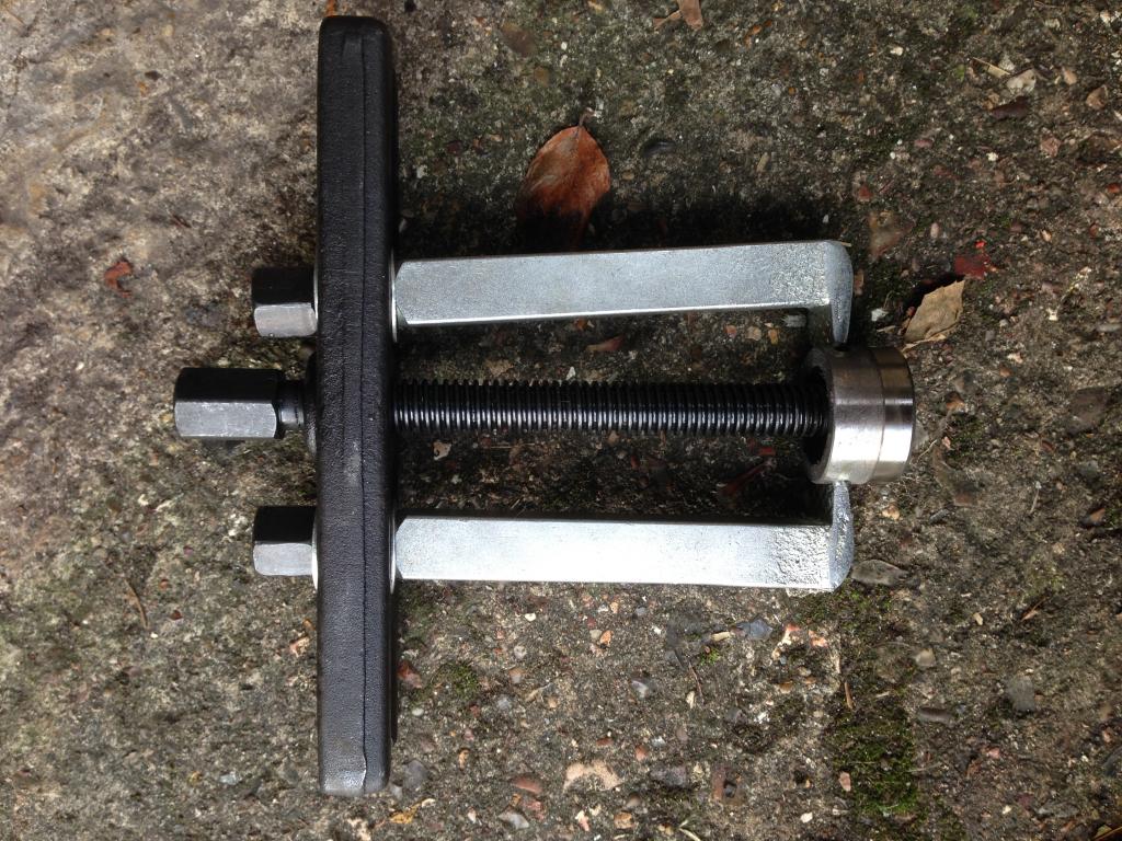

    dremeled slots and used a puller. This thing was tight and fought the puller right up to the grooves, thereafter it eased a bit.
    the cork plates are a bit dodgy tho. looked ropey and i will replace them. any recommendations on where i can get them for the least money? i measured them and they were less than 2.8mm...some less than 2.5.
