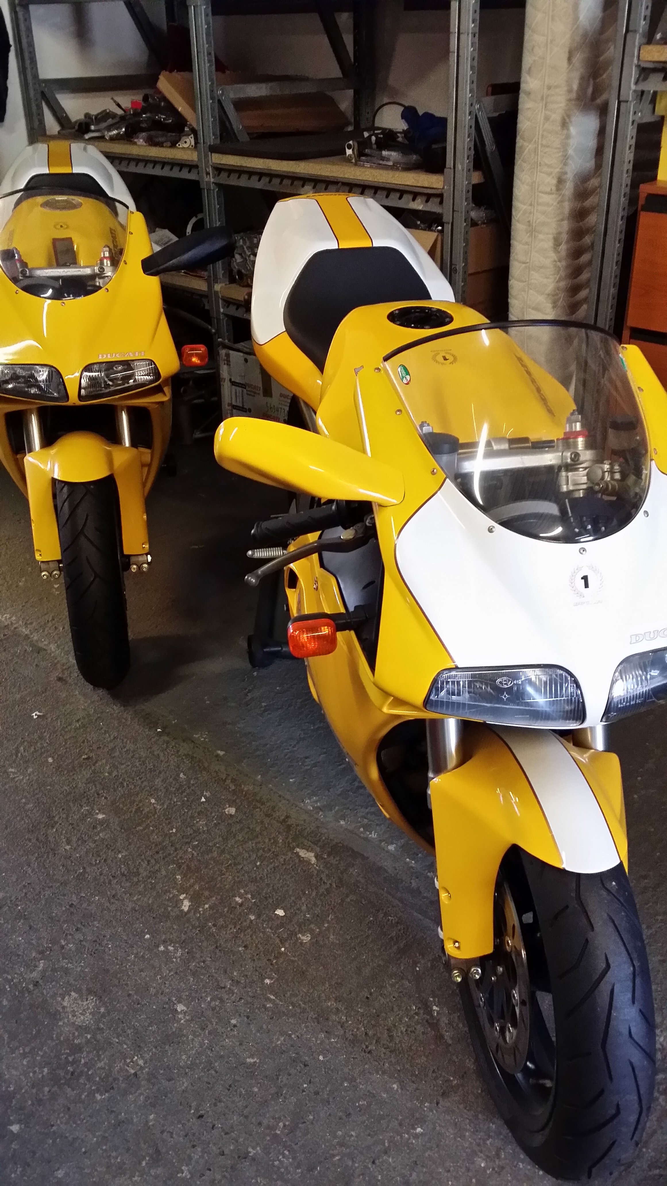

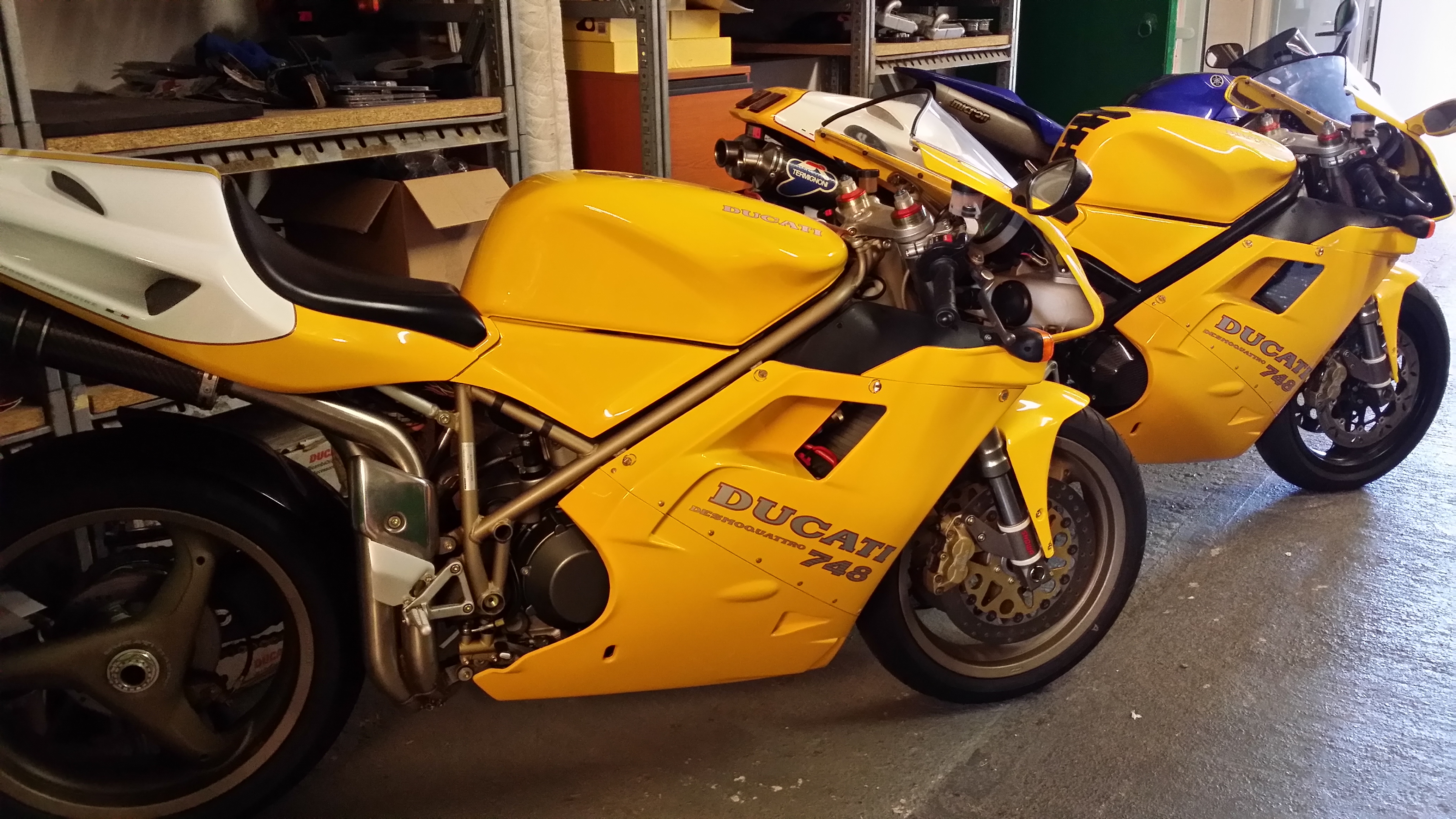

  3. Tsk - threads are boring without pics.....nice read though... 20140315_124310.jpg 20140315_123003.jpg
    There...that's better...
