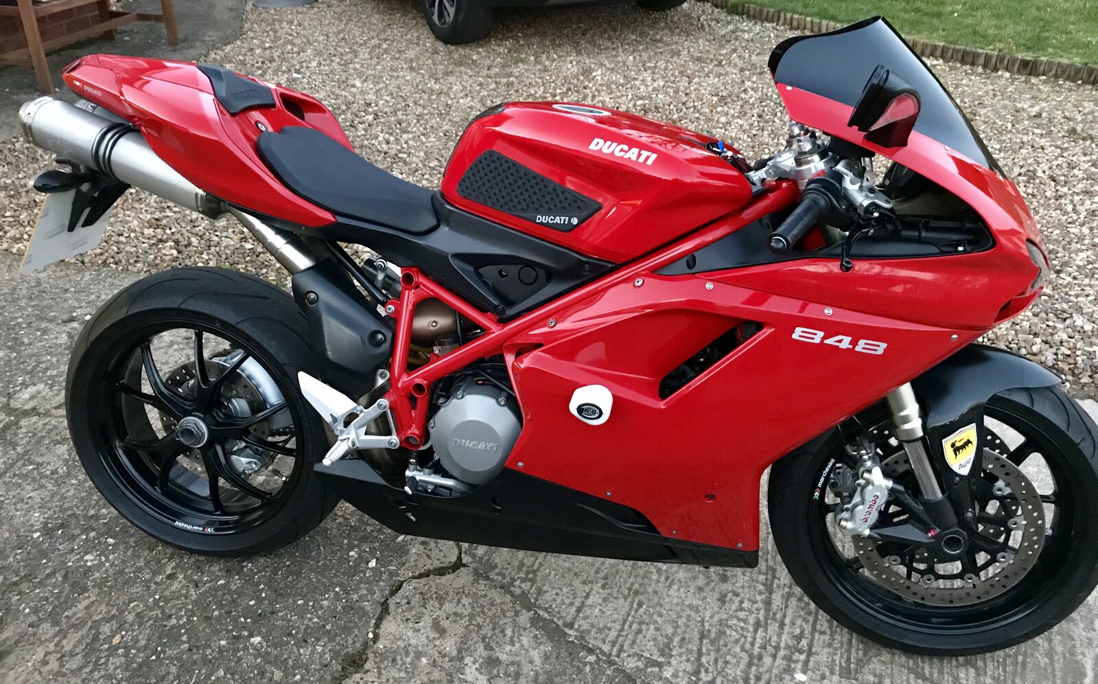

  1. 9DA7AB9F-5F34-4476-95A9-ABCC92B8FB10.jpeg Hi thank you for accepting me into your forum . I believe it’s going to be a great help and of interest.
    300 miles in and I’m already scratching my head . Low speed is not a happy time , roundabouts are intense when a car is in my way ( most times ), bike has cut out twice ! We are not friends yet but I’m patient and I love her .
    She is going to have valve adjustments and other tweaks in a few weeks . . I will let you know how it goes .
  2. Remove the servo motor etc, O2 sensors, re map ecu to suit and drop the front sprocket by 1 tooth .... makes a massive difference at low speeds :upyeah:

  7. Sounds drastic? I remember reading somewhere else same advise . Cheers , I will look into it

  11. Not drastic mate, easy, cheap and 100% worth it :upyeah:

  13. Putting aftermarket cans and mapping it to stop it running lean conditions at small throttle openings helps massively and reduces the overall heat output a little. I remember my 848 was savage with standard exhausts.
    To do this they will need to do a TPS reset anyway which should cure your stalling issue hopefully.
    Get a Oberon clutch slave cylinder also and your good to go. I have changed the gearing on my bike but I’m not sure it was quite the game changer some say it is. I guess it depends on what you do

  15. What will the Oberon clutch slave cylinder help ?

  19. The amount of effort required to pull the clutch, which you will appreciate in town. Also the Oberon units tend to be a lot more robust than the OE units which is better for the long term.
