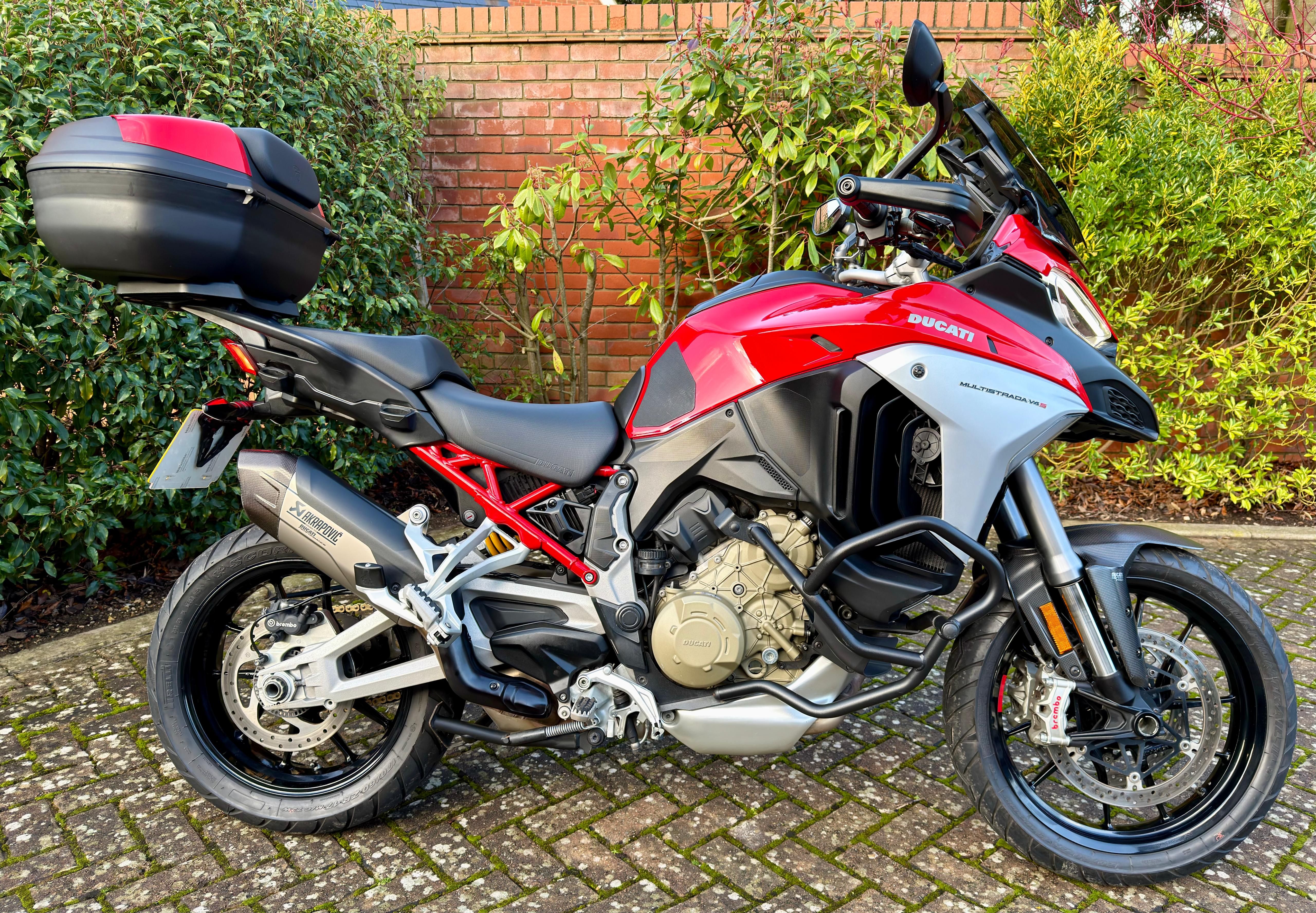

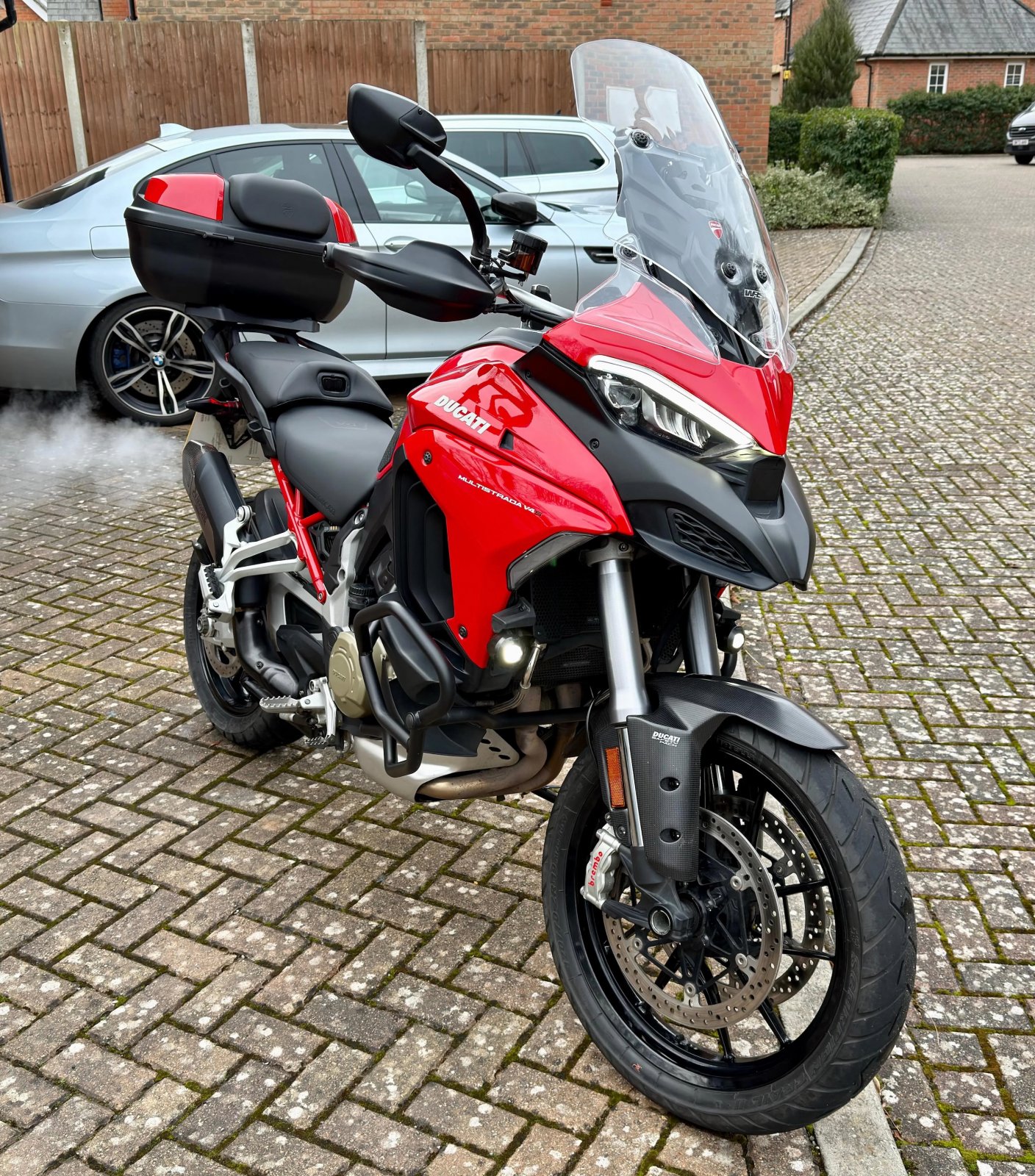

  9. Well, probably due an update here! Been riding the hell out of the V4S, when I haven't been ill anyway - some mega plague going round...
    Excuse the disjointed summary - cross-posting posts from another forum.
    Definitely the right choice. It's thirsty though, but touring with superbikes, I won't be the limiting factor...
    I've got the touring mode set for extra soft suspension, but retain full engine power, and it's pretty easy to ride and almost GS smooth - Skyhook is good. Sport remains in medium, and I haven't really needed or wanted stiffer, yet - even the anti-dive is decent. The electronics are mad - not fiddled much yet, but as set, seem unobtrusive, especially wheelie and traction control, barely notice them, and able to use masses of throttle for winter, many liberties. QS up and down is great. The engine note on song is addictive for sure, and shifting up right on the limiter makes it almost a different bike to short shifting at 8-10k - with the Skyhook gubbins, a very very jekyll and hyde bike!

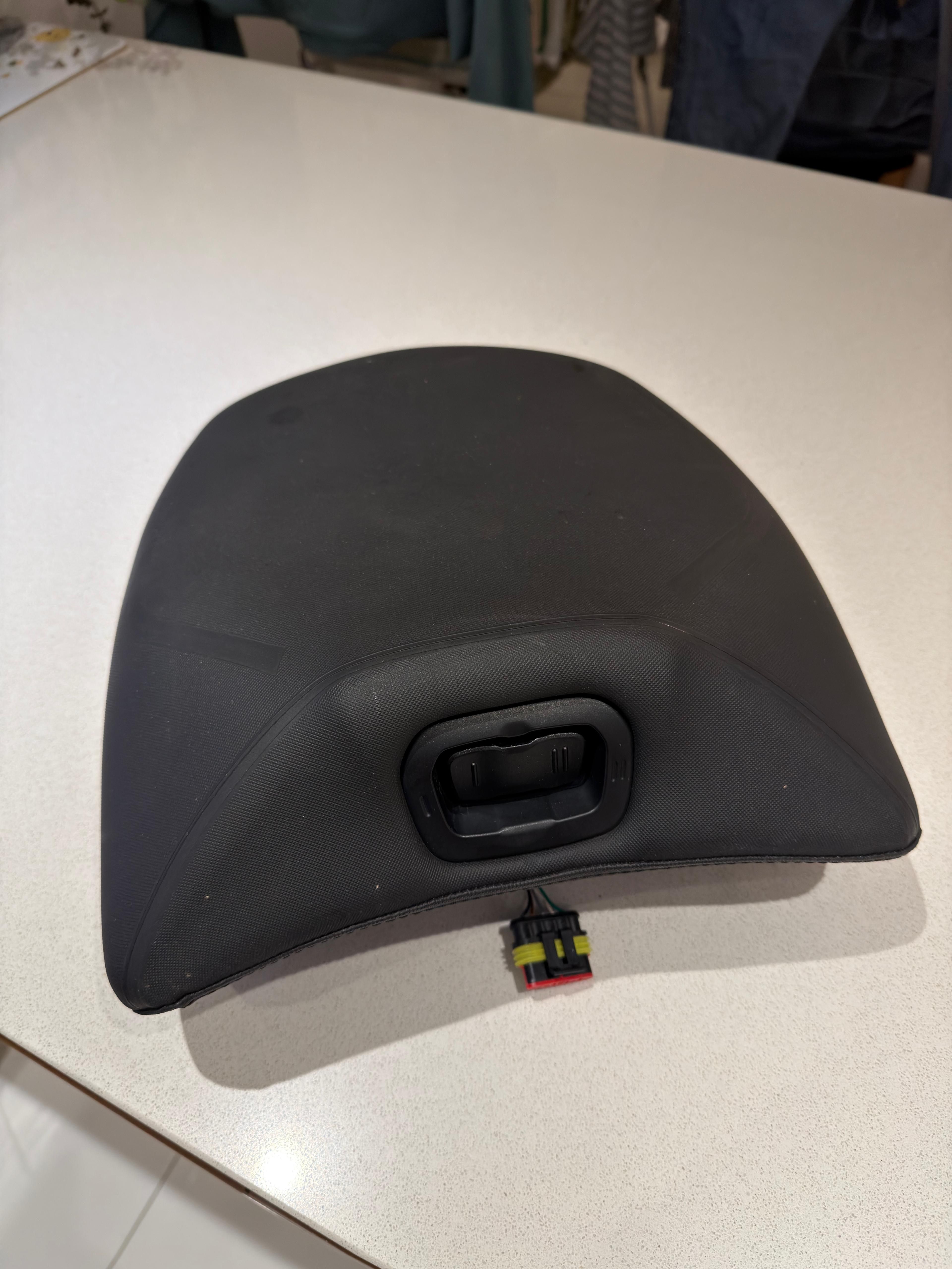

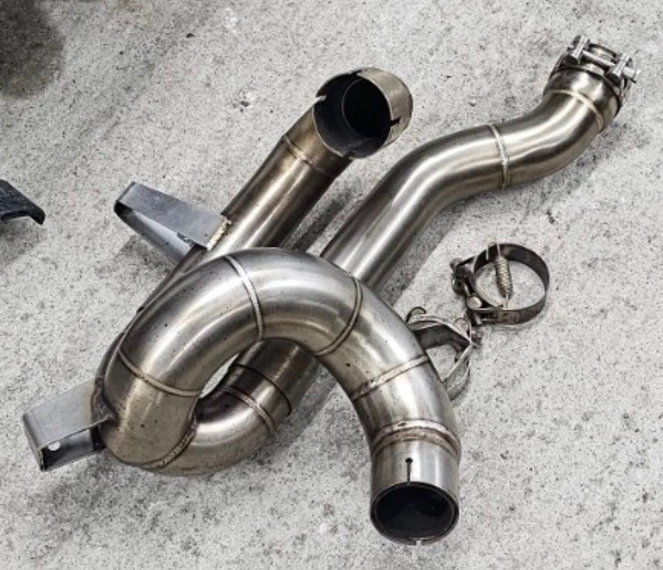

    Initial buys/changes:
    • Second hand original clear screen & side deflectors (only to find original deflectors in the top box haha)
    • Second hand decat link pipe - to go on once warranty out, unchoke it a little
    • Second hand Ducati aux lights - having missed the R1200GS' verge & hedgerow lighting
    • Second hand heated pillion seat - plug & play

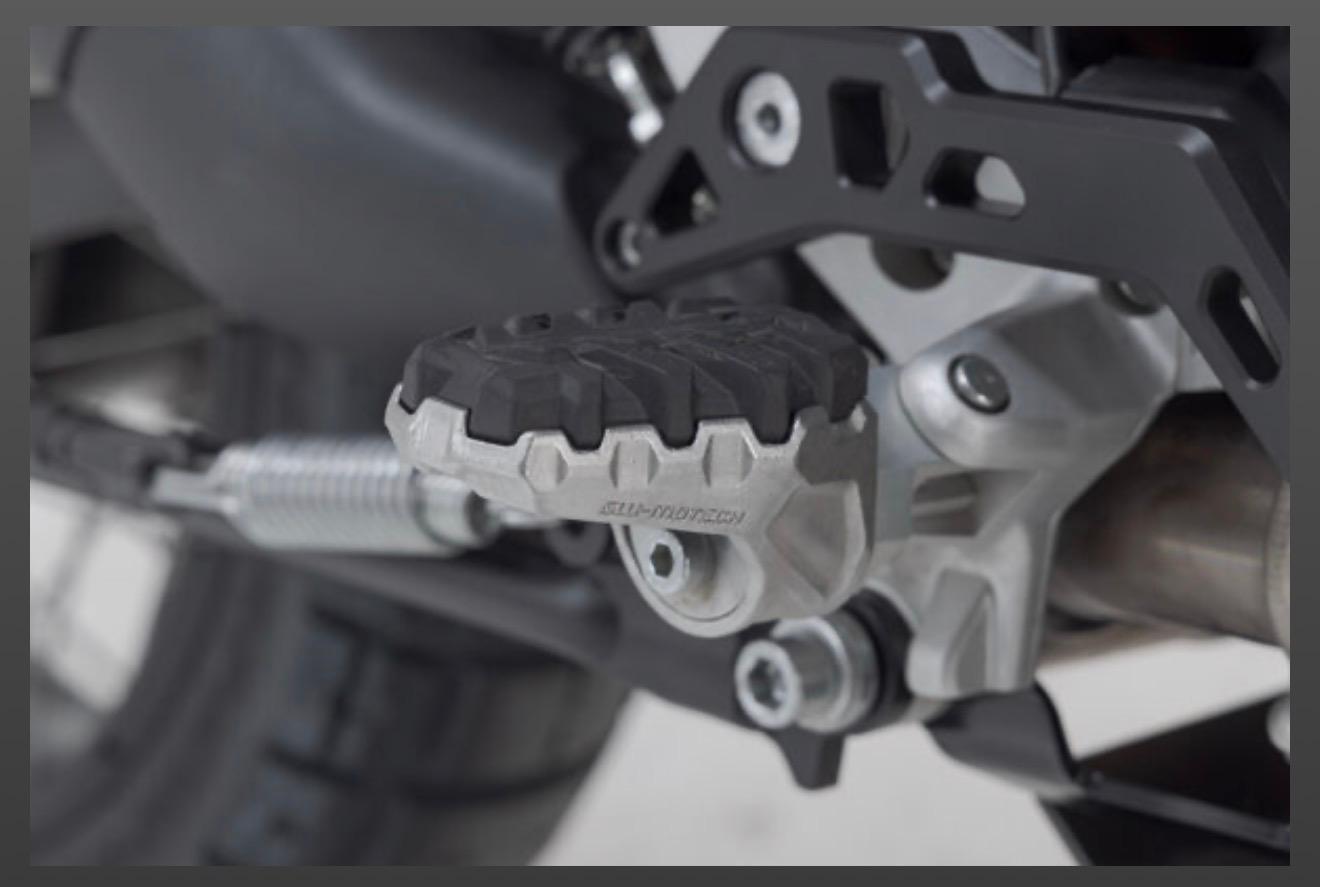

    • Second hand SW Motech Evo pegs - standing on originals better since rubber inserts removed but wider + adjustable height & angle nice

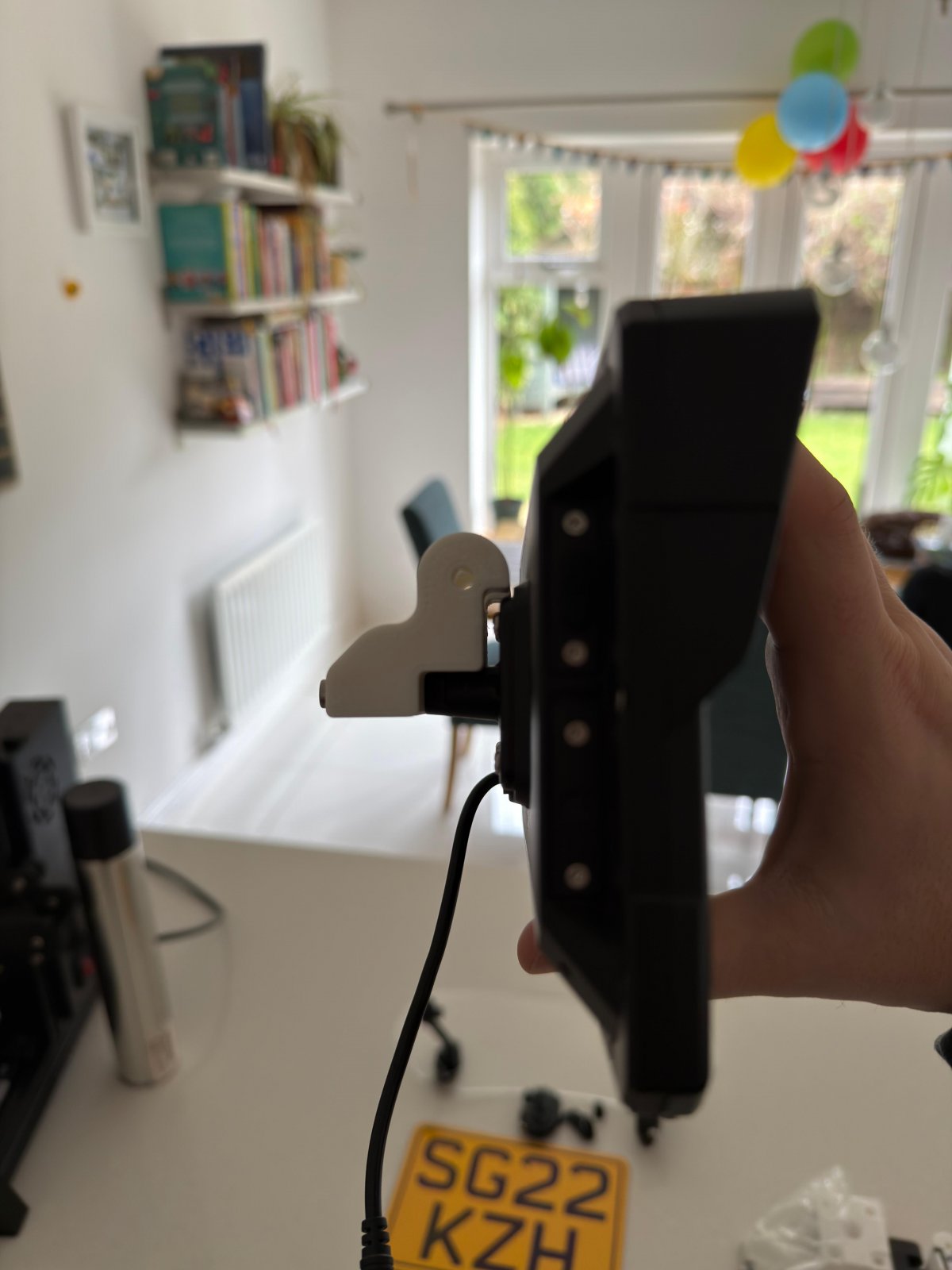

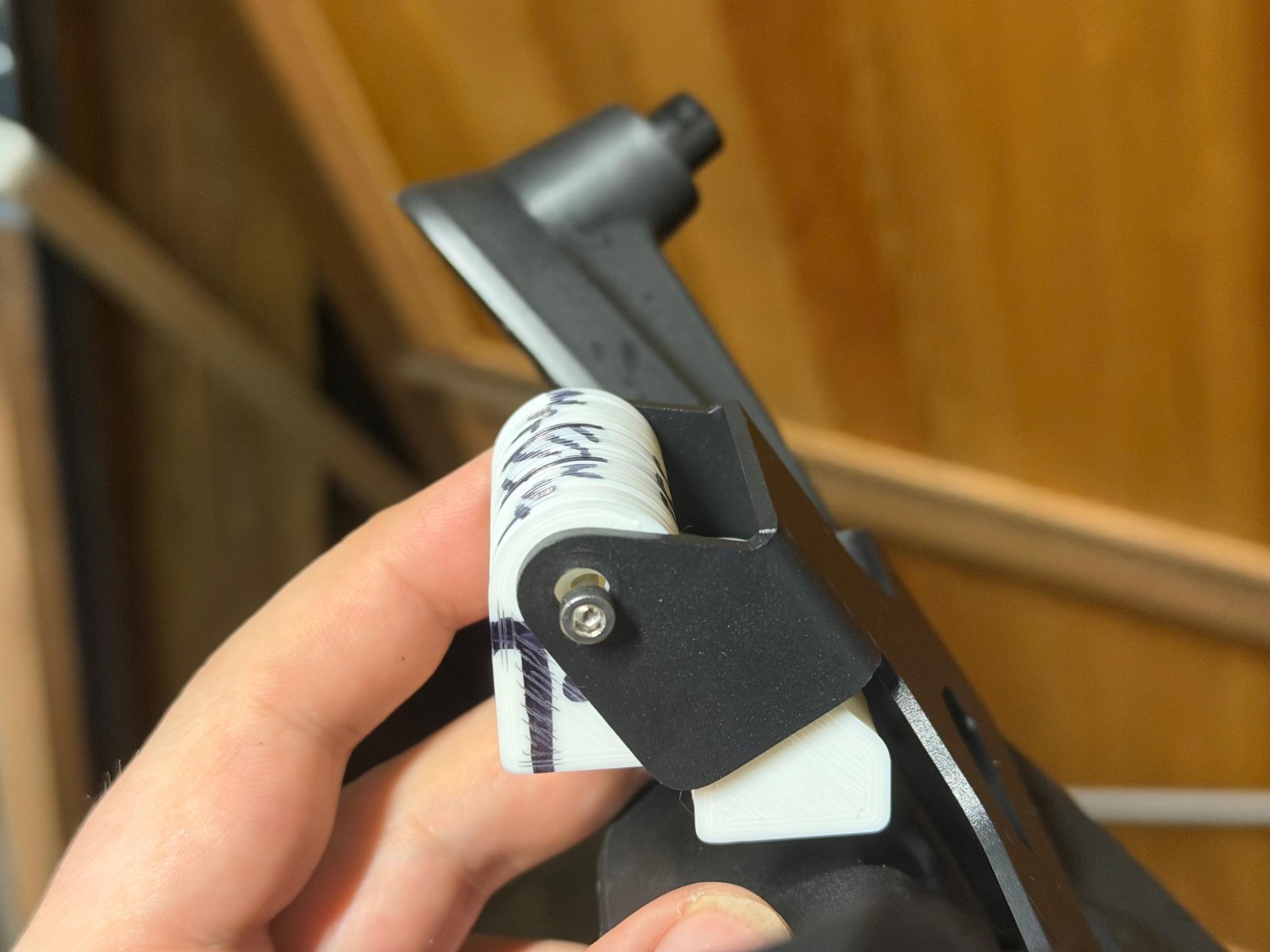

    • Xitomer Carplay screen bracket - with 3d printed adapter to get closer to the screen, less in my face, and down a bit
    • 3D printed throttle spacer to remove the initial slack
    • 7x5 plate

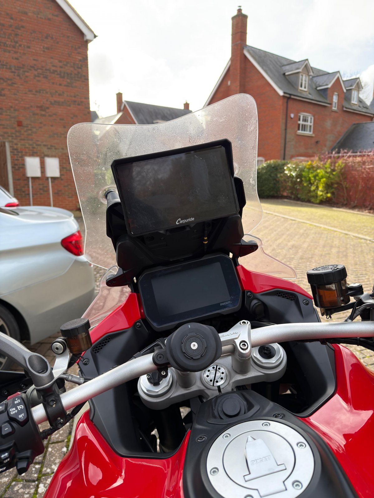

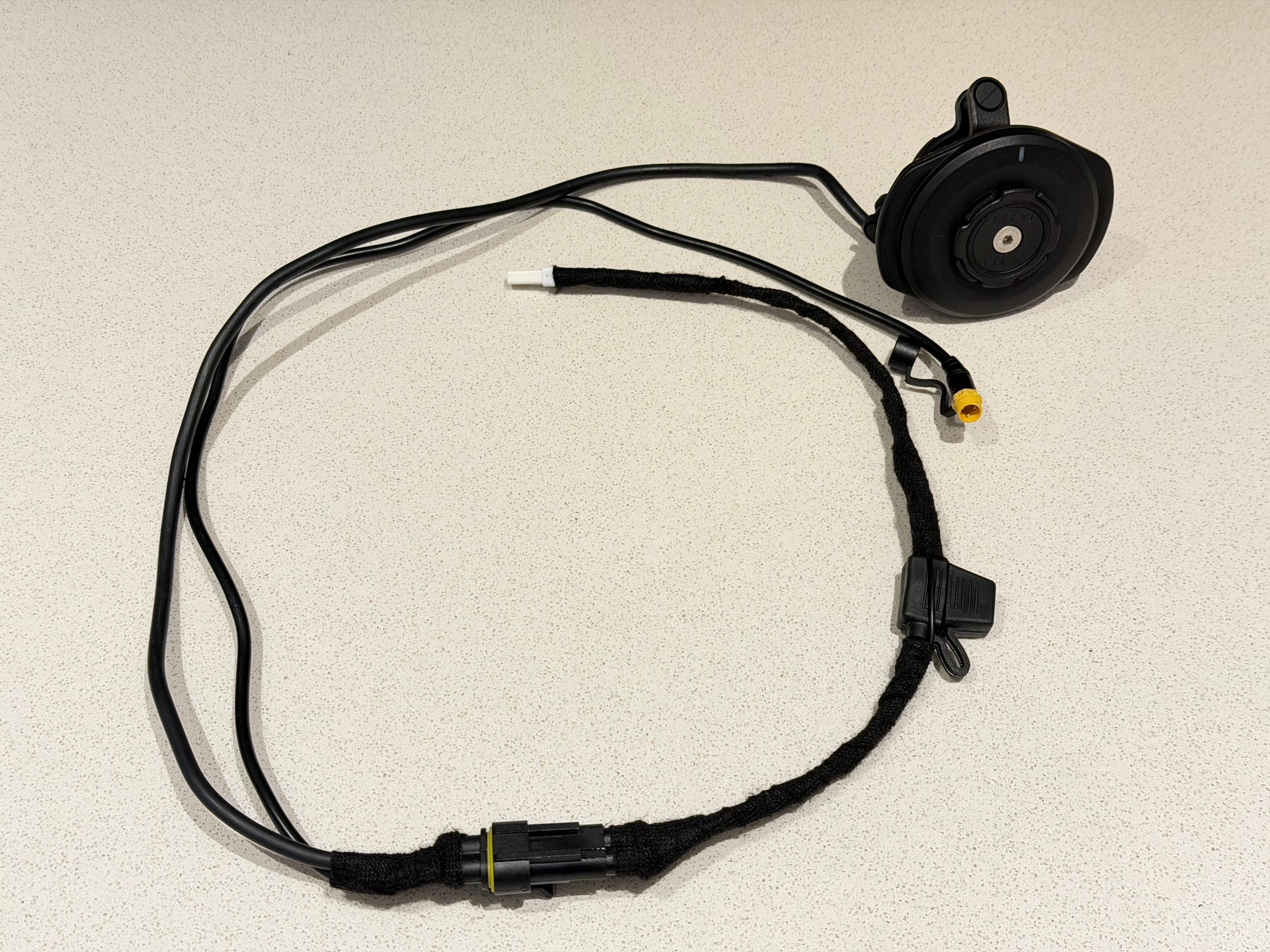

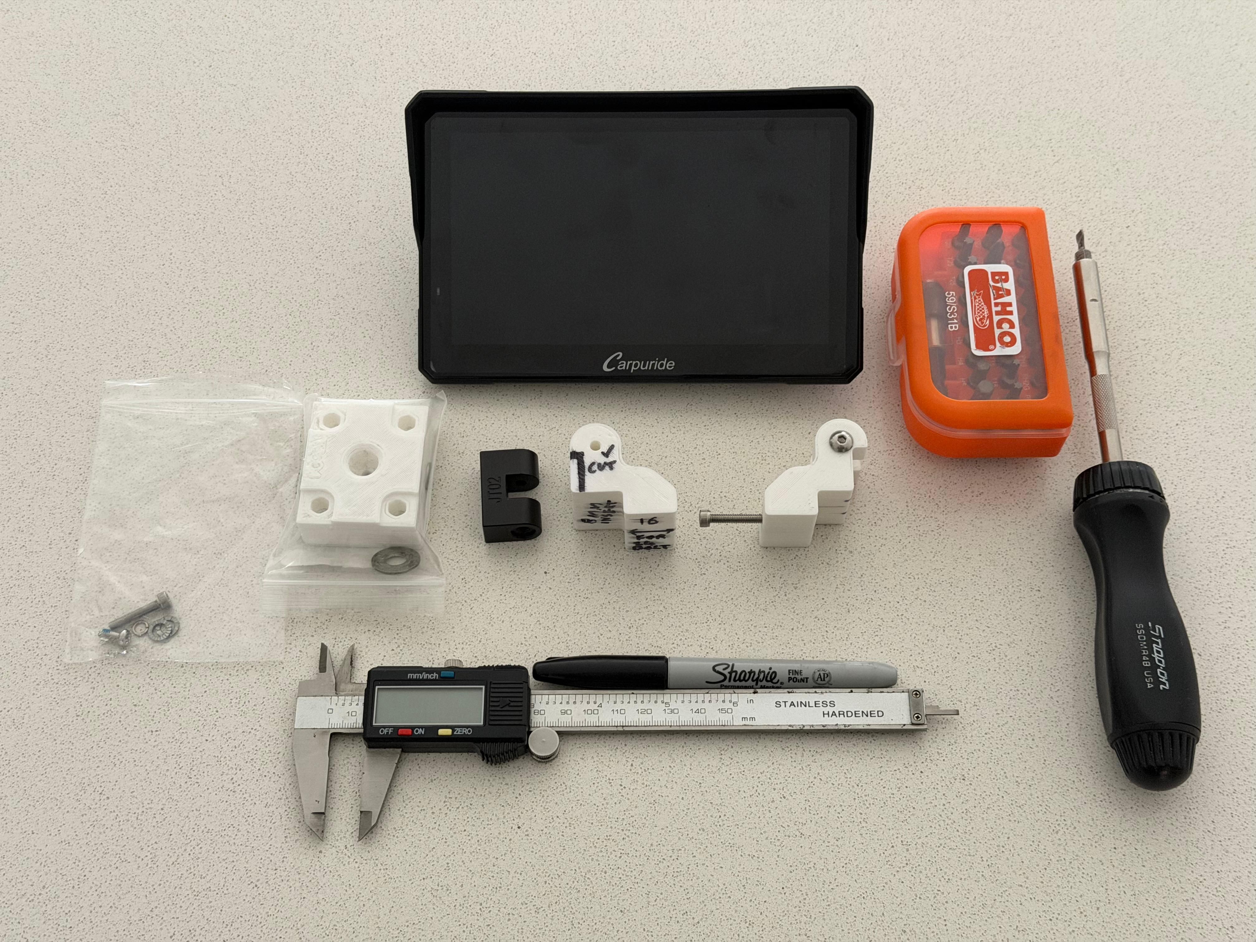

    Also moved over:
    * 7" Carpuride - wired into Ducati GPS connector
    * Quadlock hardwired wireless charger puck - wired into Ducati GPS connector - for longer trips
    * Quadlock Pro handlebar mount off my Norton, will need to replace!

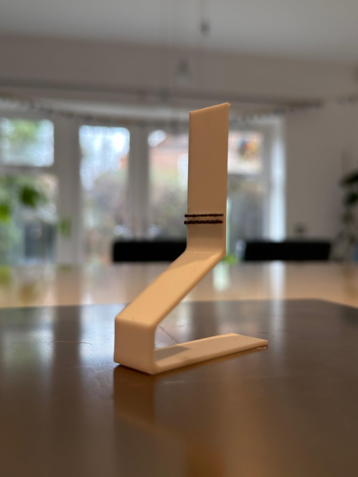

    I've (rough) 3d printed a chain slack measurement tool, as that was indeed missing from the toolkit, a stop button cover I found online to prevent (further!) disc lock damage, and Carpuride mount adapter - it was a stretch away on the GS, and on this it felt like it was in my face - limited by screen rake, but this really helped - black nylon in the end. The sticky outy bit sits on a thermal pad and acts as a heatsink for the device, else i'd just print a new lower profile offset back plate.

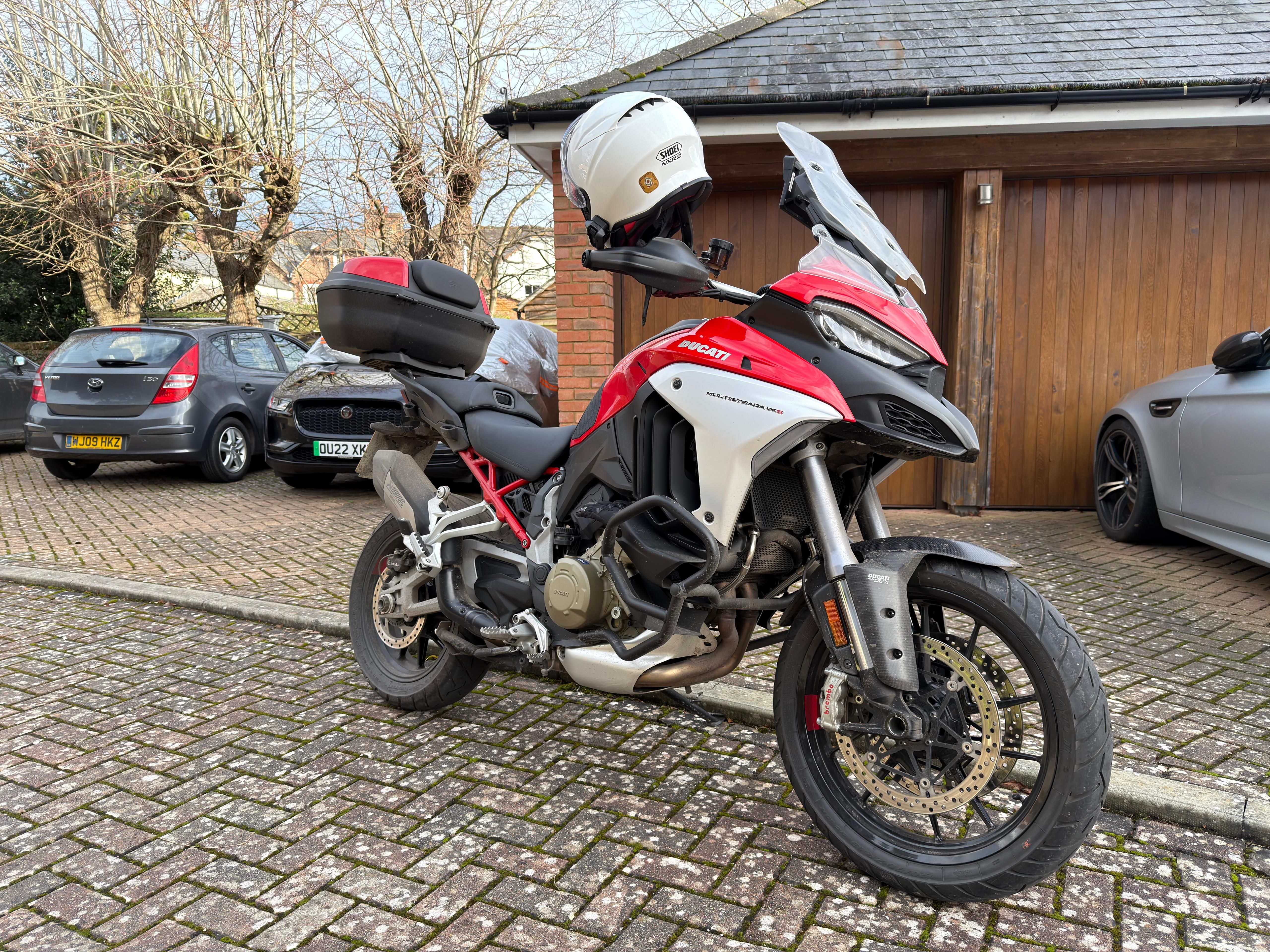

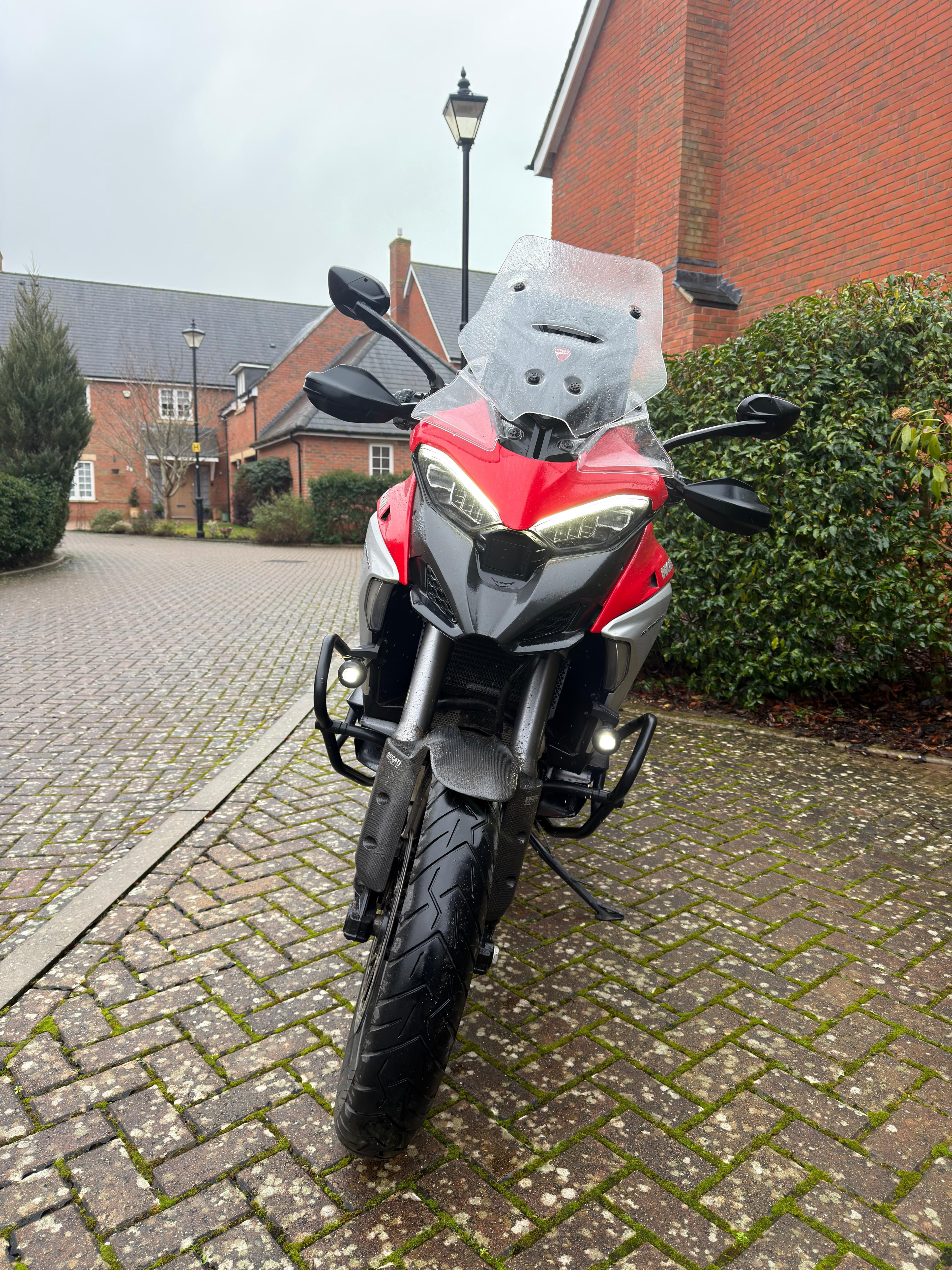

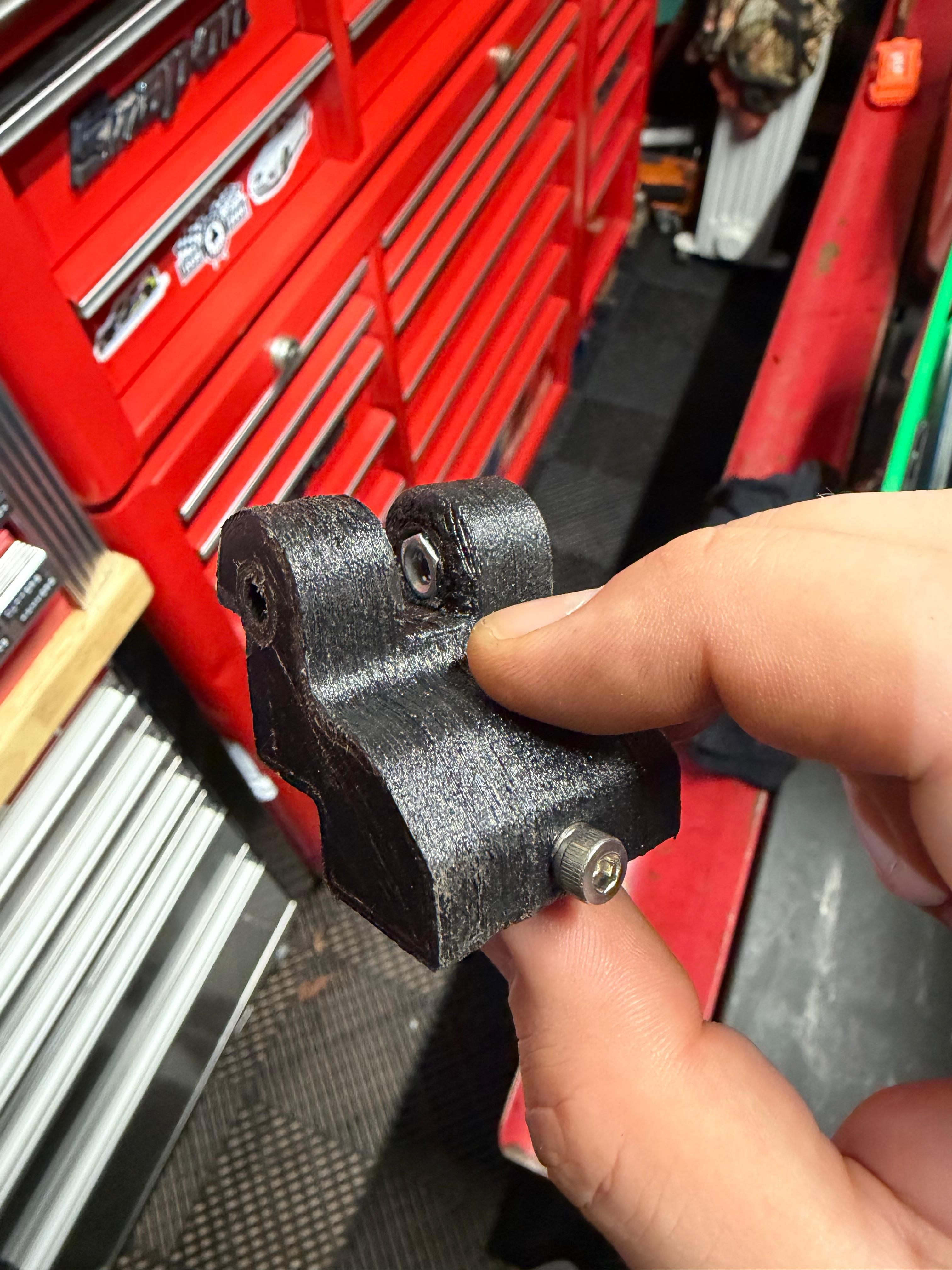

  10. Getting some use!

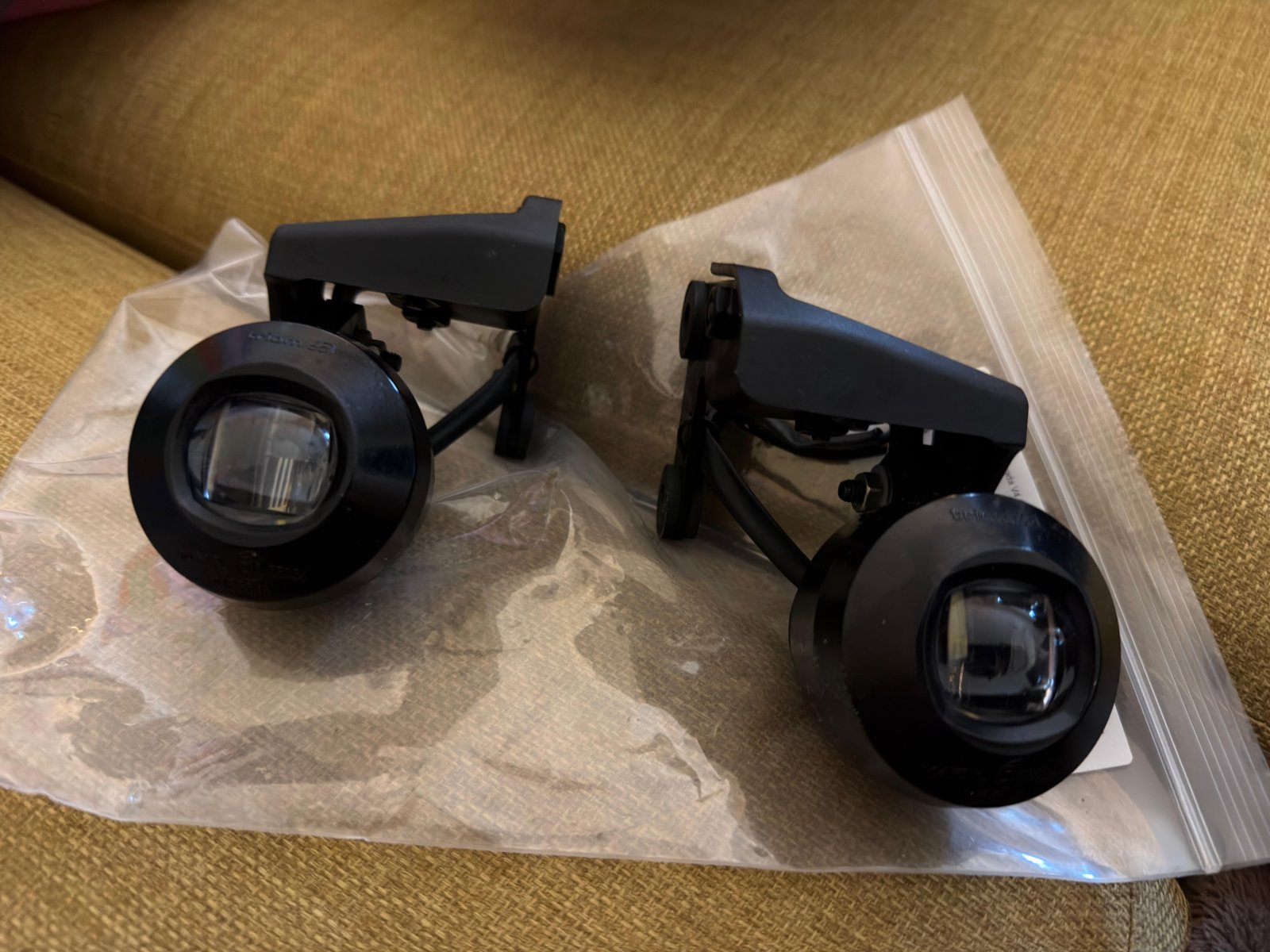

    I got the second hand Ducati "fog" lights fitted. The wide headed shouldered bolts were missing (£11/each from Ducati on the Grand Tour parts diagrams!) so I 3d printed some subtle black nylon washers and small collars to do the same job, in conjunction with stainless dome headed bolts. The aftermarket rad guards meant the cables were pinched too, so 3d printed spacers employed. Handy old thing to have around...

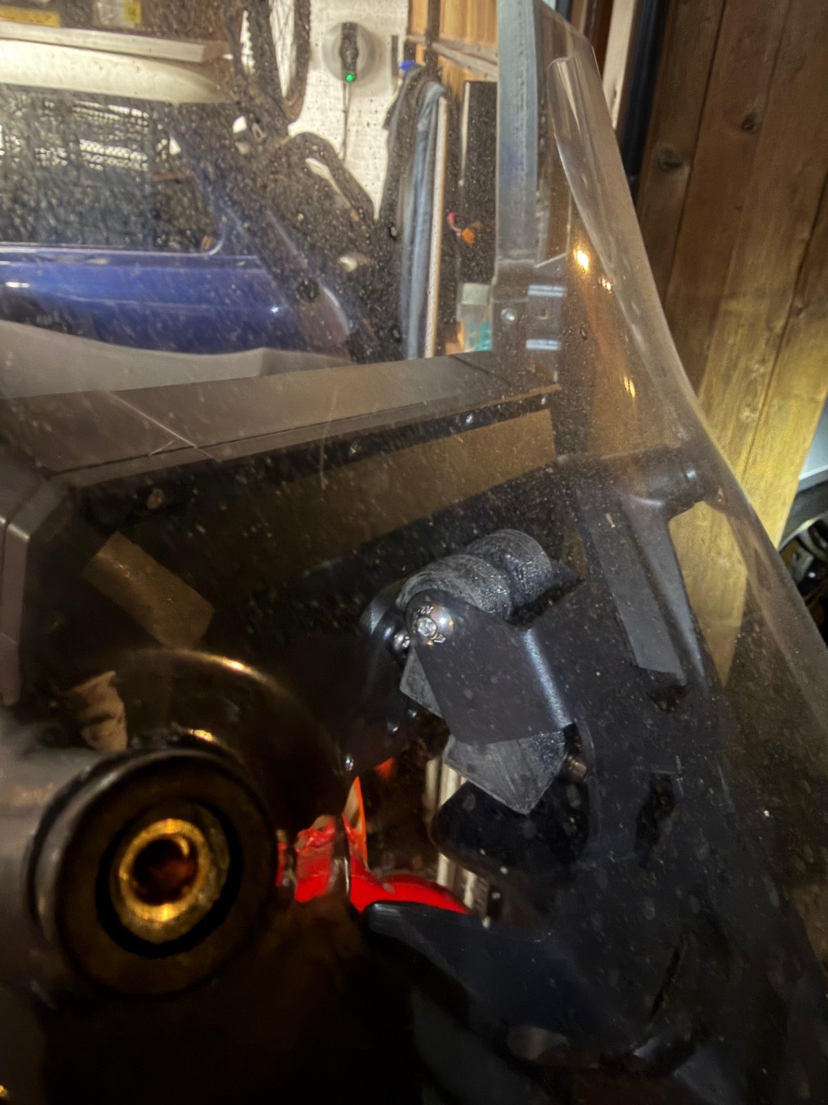

    Final mount to relocate the Carpuride unit. The nylon filament seems to be super moist, not printing well, but will do for now. I've got some nice carbon fibre infused filament i'll have to try.

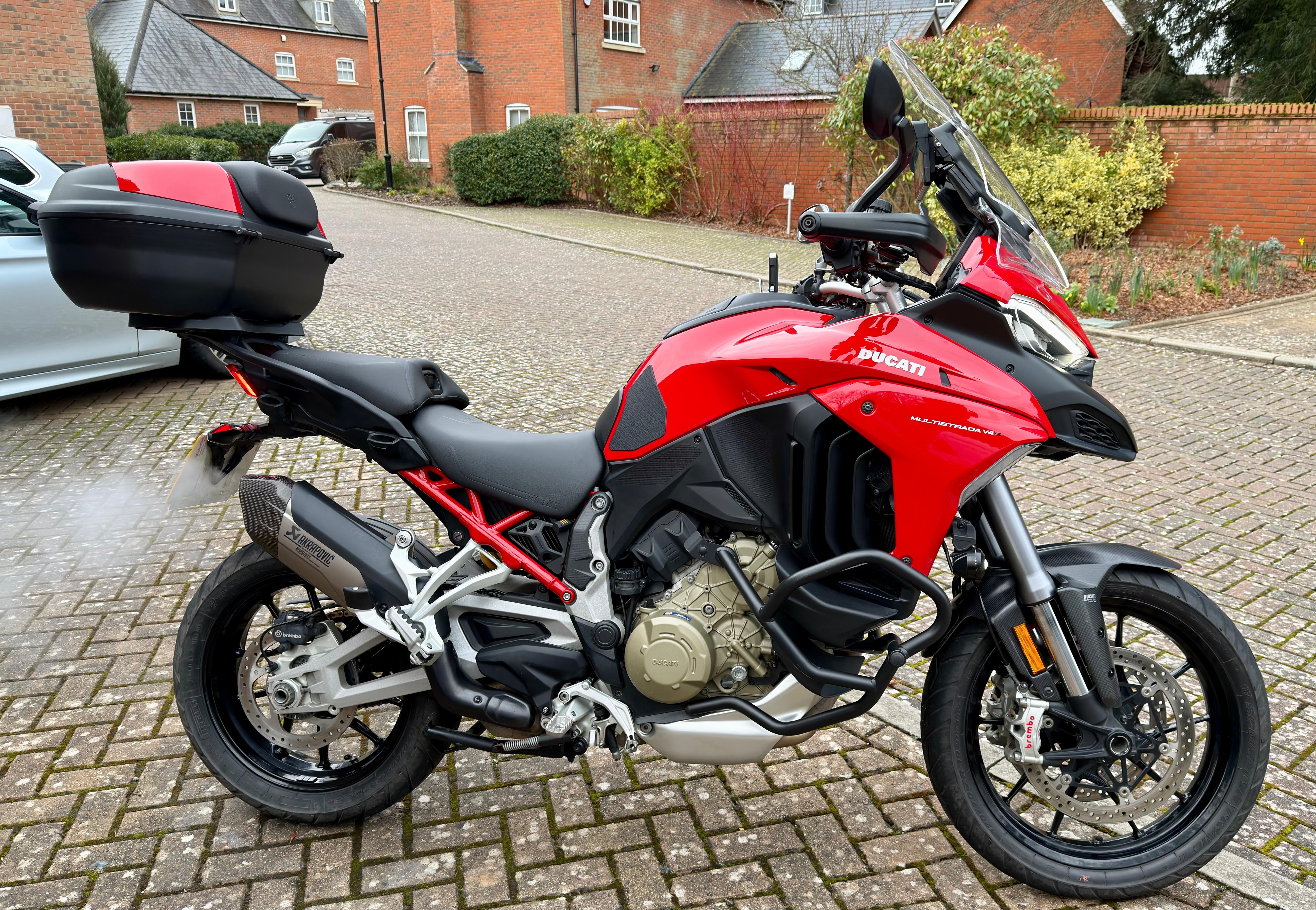

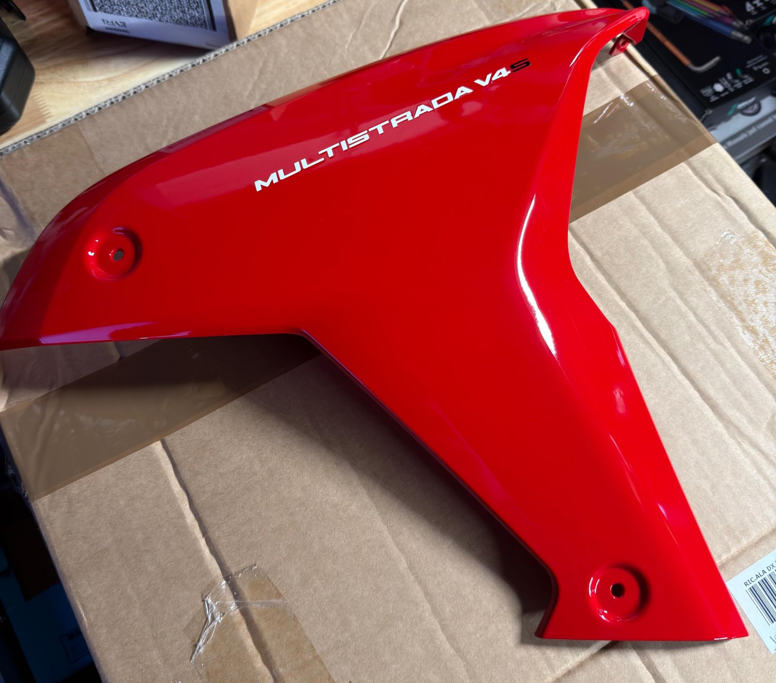

    Most recent tinkerings:
    • Red side panels ordered from Ducati Milan - big cosmetic improvement IMO - wish they'd come like this!
    • Fog lights enabled thanks to Bumpkin!
    • Taller WRS Caponord screen fitted - not perfect, still a little noisy on the helmet vents - might fabricate some brackets to make the screen rake adjustable / slightly steeper?
    • As per all my bikes, 5x7 plate now on the Evotech tail tidy.
    • Keis heated jacket harness & CTEK quick connect fitted - between the Keis, heated seat & grips I was warm enough in normal jeans @ 0c this morning!
    • Ducati Touring hand guards with wind deflectors fitted - second hand bargain - left hand one has some crash rash i'll repair, then spray the aluminium black. De-silvering...

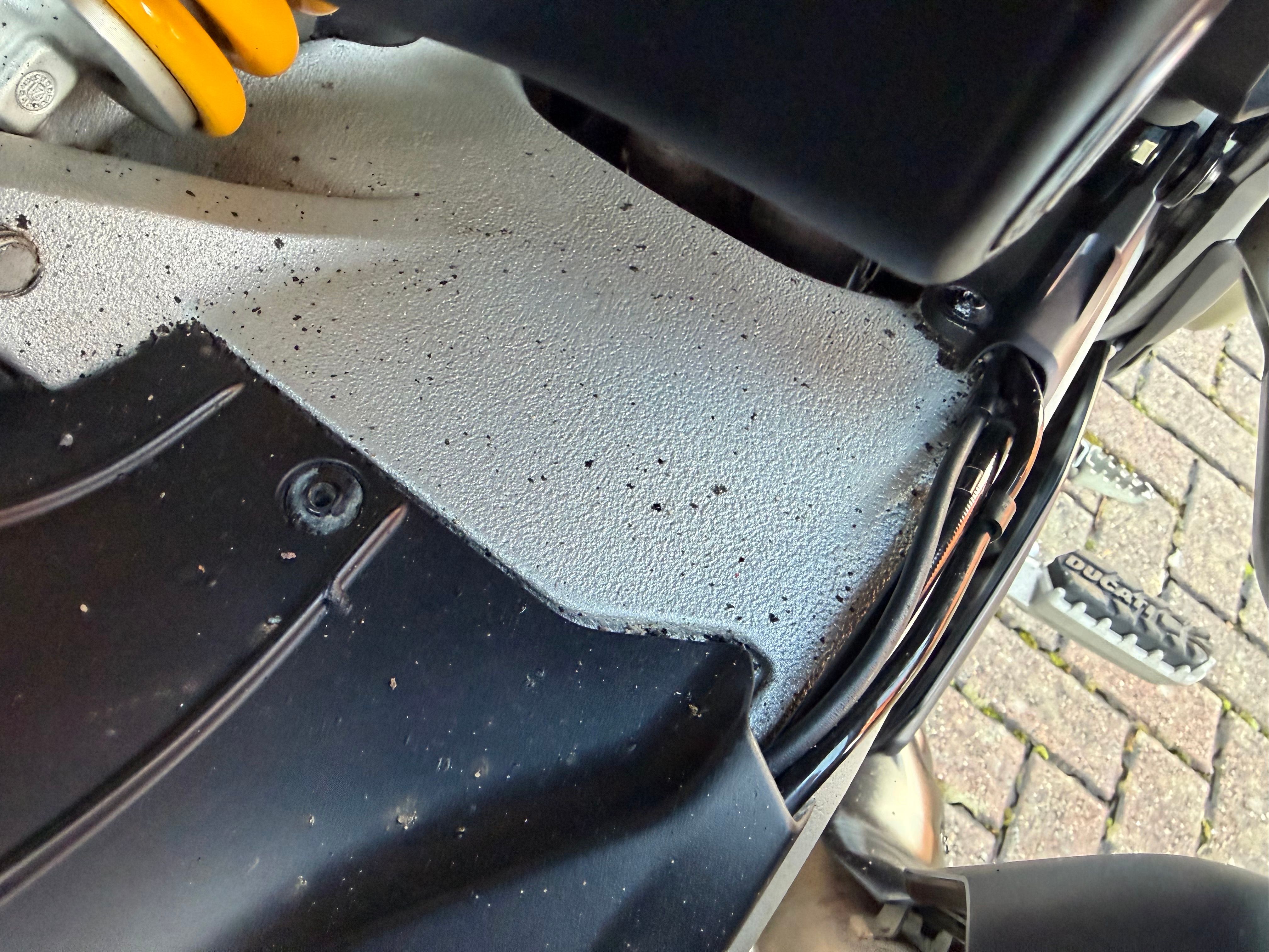

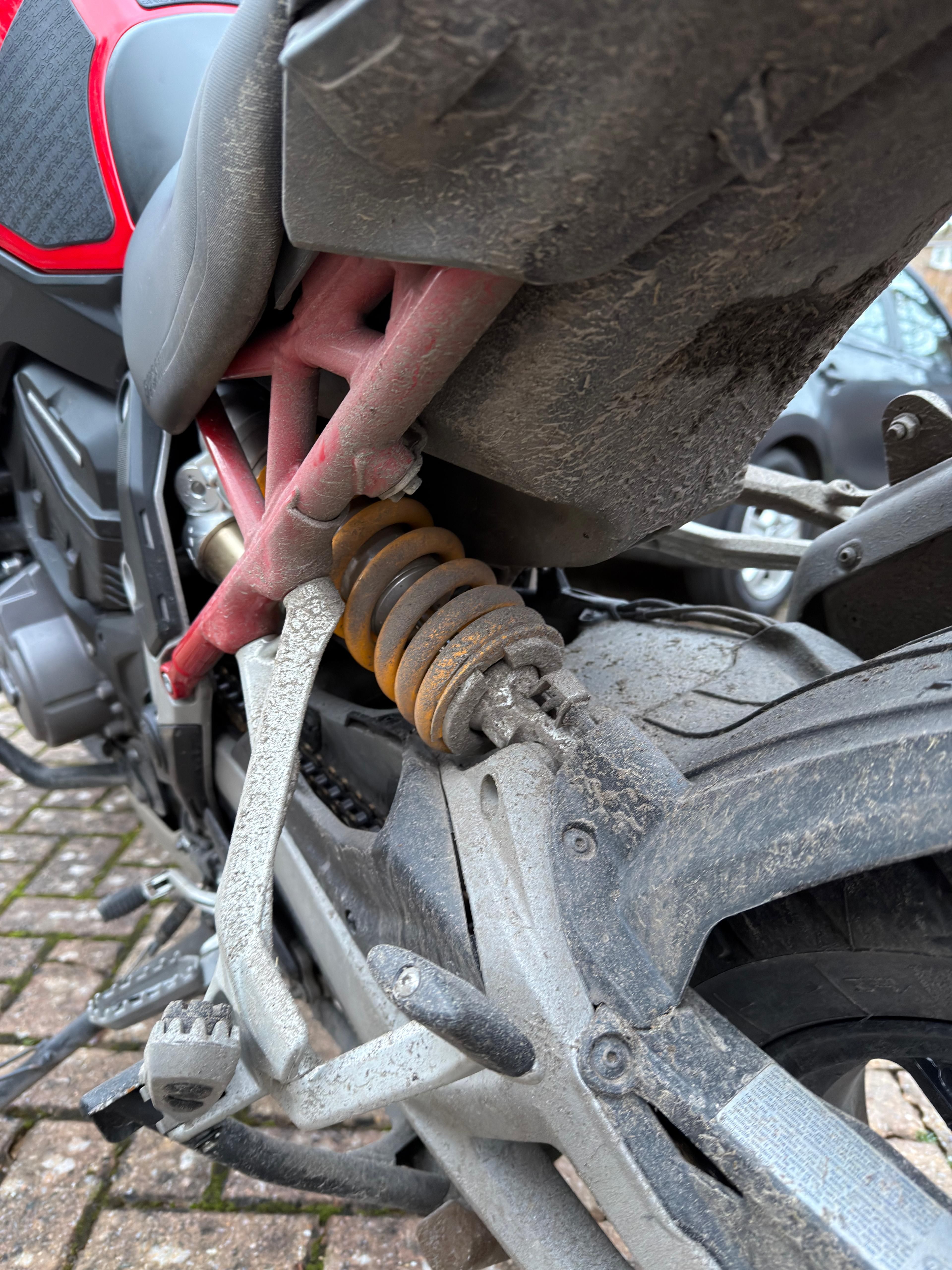

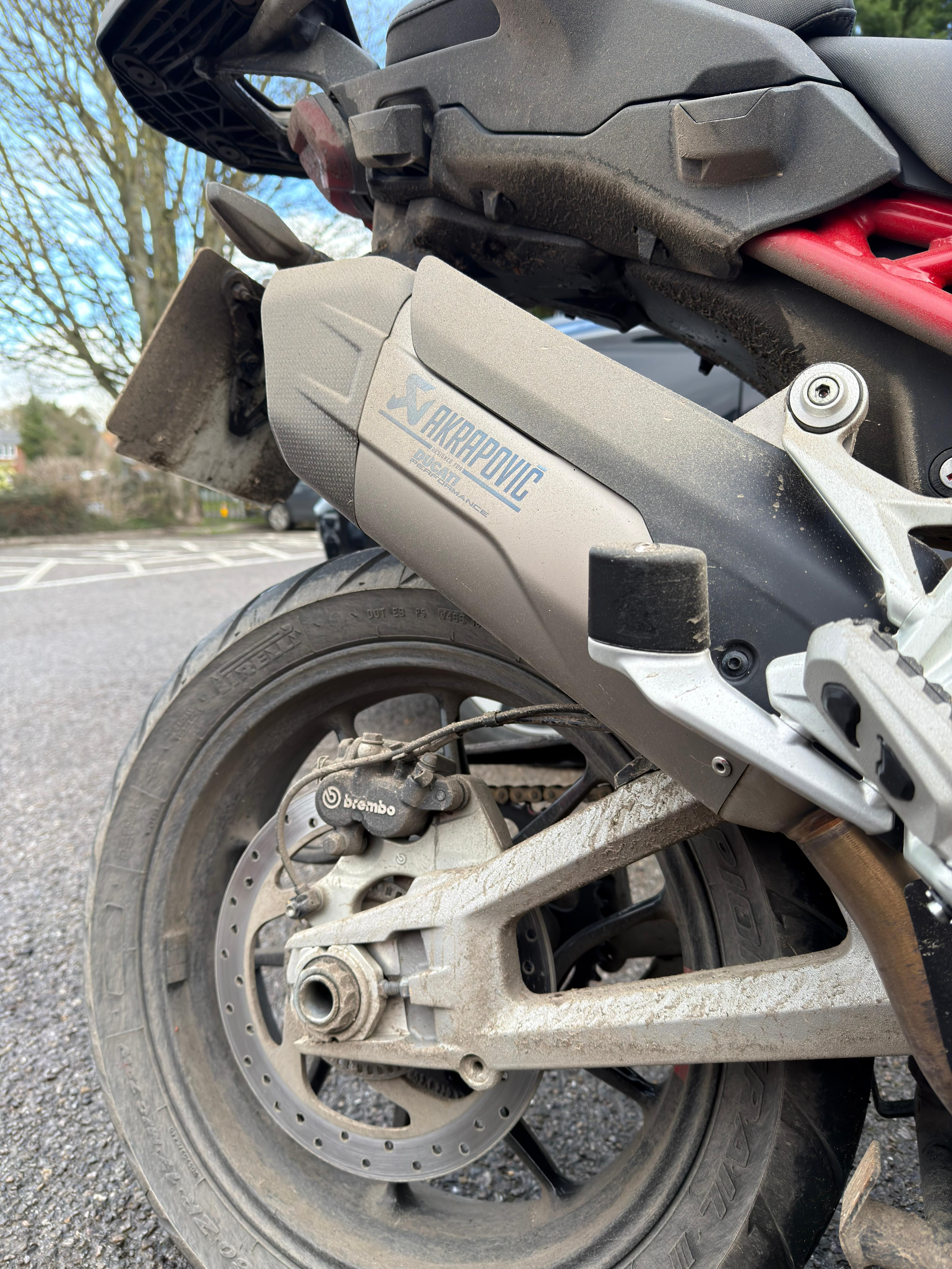

    • Masses of black tar spots cleaned off swing arm, shock, end can - never seen a bike collect so much!

    Aux lights enabled - thanks Bumpkin!
    Before:

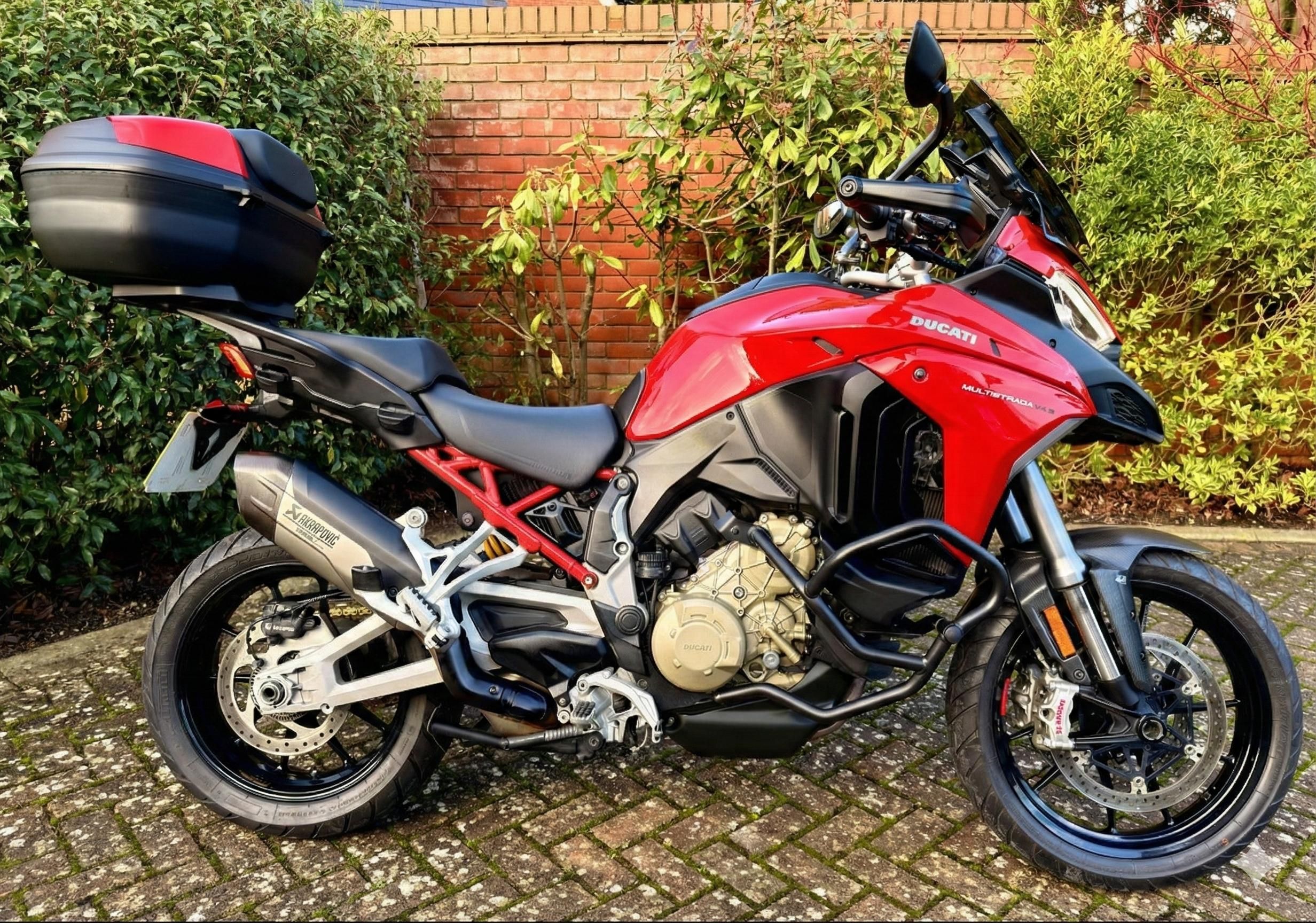

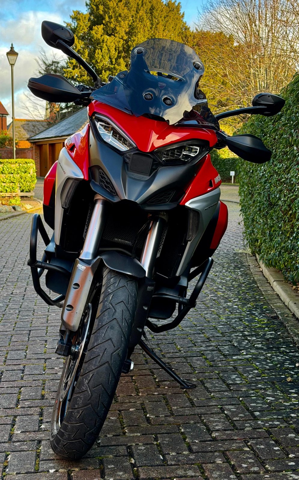

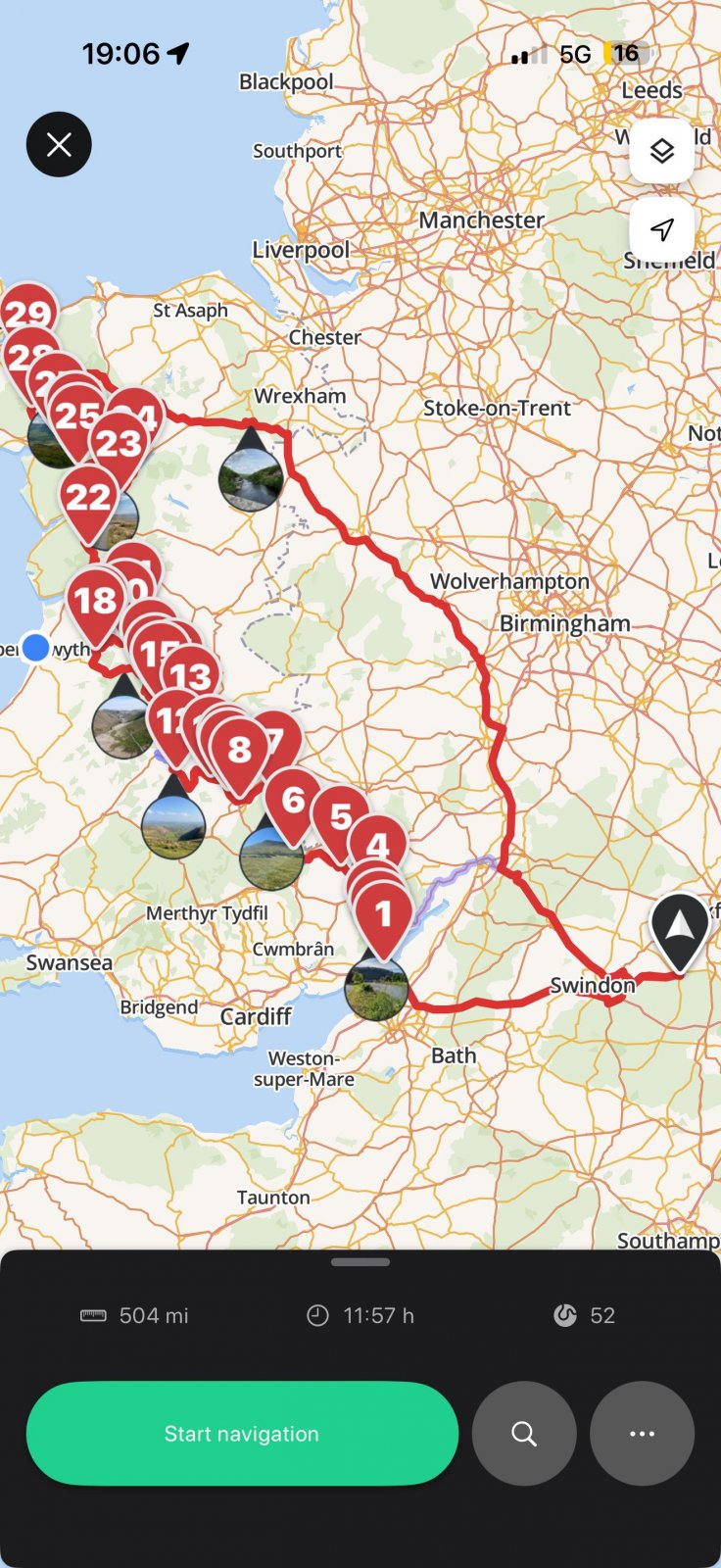

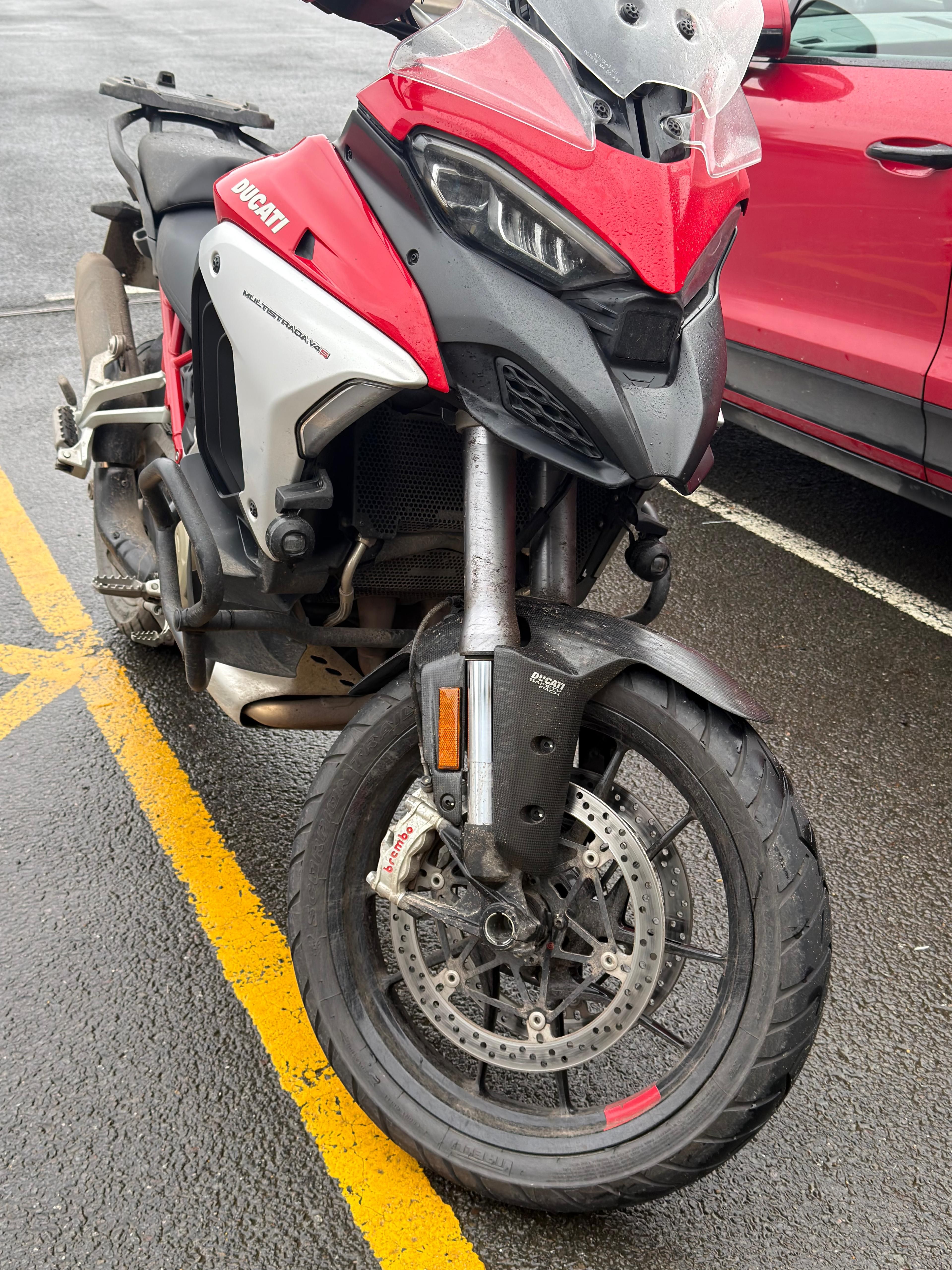

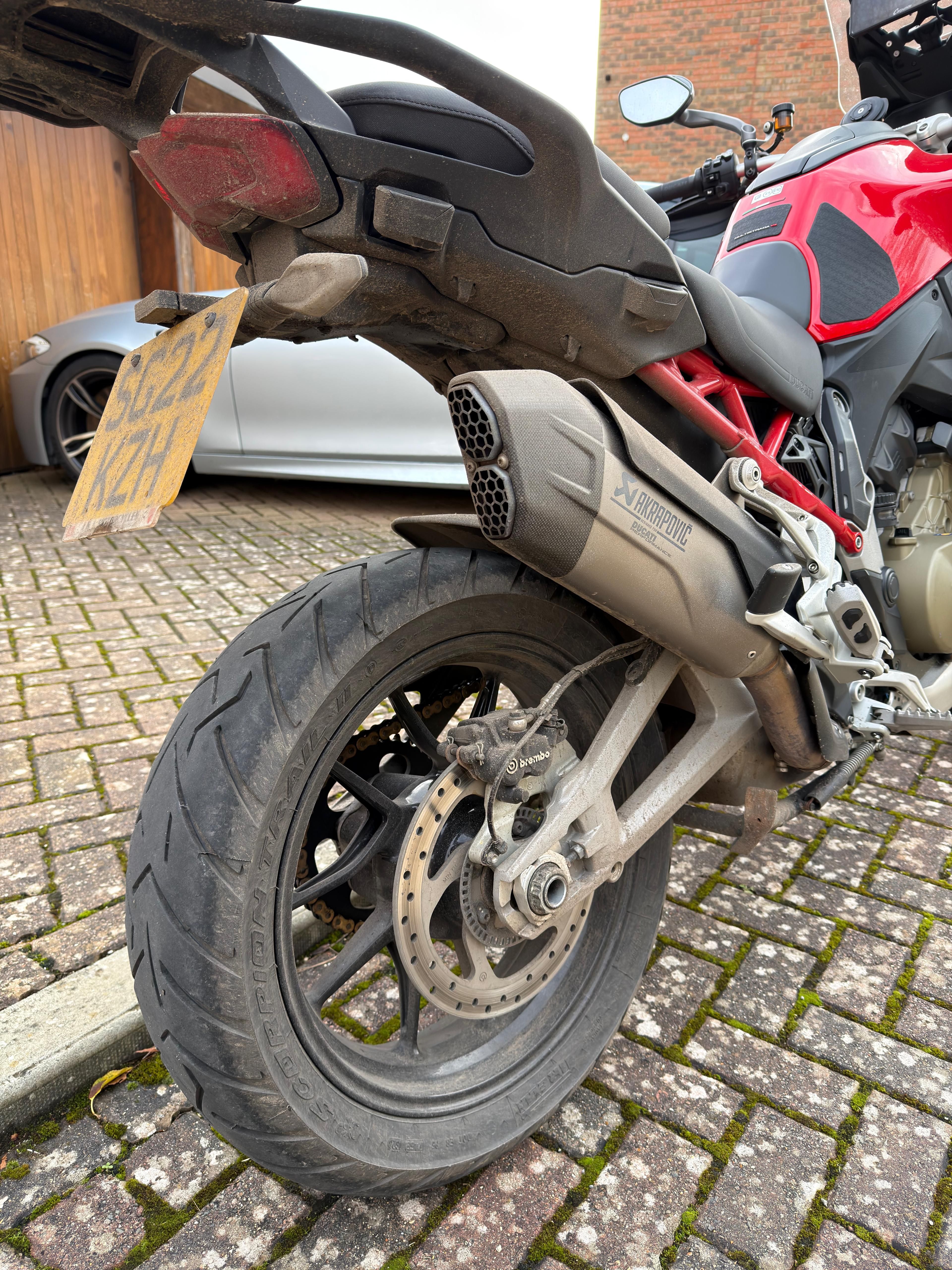

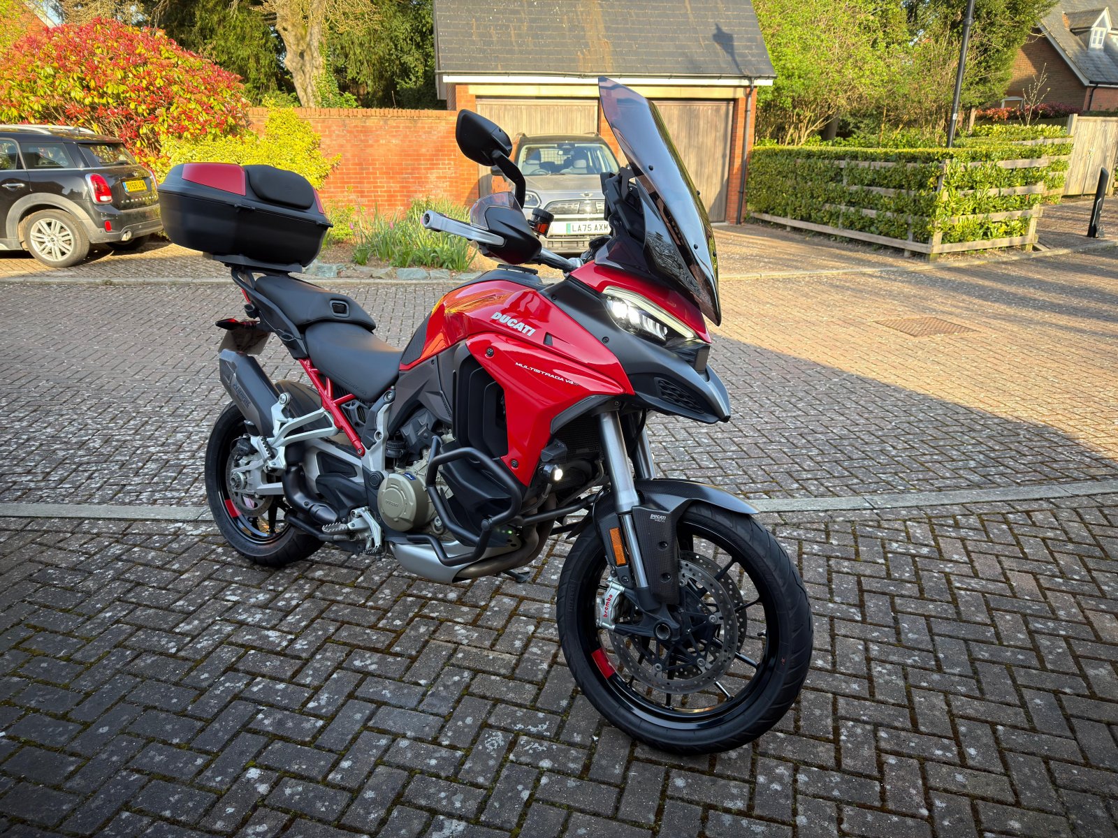

  16. Using the hell out of the MTS! Just ticked over 30k miles with a 500 mile round trip this weekend around Wales! It's looking pretty fresh for it's miles, paint & finish wise, especially with all the tar removed - never known a bike collect so much! I suppose all the plastic covers over the aluminium bits helps.
    Tightened a smidge of chain slack up, and will reset the tyre calibration, as the quickshifter is not quite as sharp as it was. The rear Pirelli Scorpion is square as hell, so it's getting new Pilot Road 6 tyres before my May 10-day euro jaunt. It won't be far from it's valve service, let alone it's oil service, by the time I get back!
    I've got a second hand (annoyingly dark) Puig touring screen on at the moment, has quietened things down a bit for me being more steeply angled and set further forwards, but the tint is annoying me, and visually it's hideous IMO. I'm going to try my large WRS Caponord screen again, the original, and the Pikes Peak small one, and figure out what is quietest, regardless of air flow pressure on me. Still find there's a turbulent air noise in my helmet - maybe I was just spoilt by the GS Adventure screen and deflector.
    Fitted some fresh (this time undamaged) second hand touring hand guards too.
    I splurged at Ducati Parts Milan (after my good experience with the red side panels) and got a +30mm seat, as after a 300 mile day, my bum hurts. I think it's just flat, always a problem! Praying that helps. Also got the stupidly expensive electronic fuel cap coming - just felt it was the only annoyance with the bike, and their prices aren't bad, and there was only two left in stock.
    Just need to decide on the screen(s), black out the exhaust shield, and get some form of TPMS now, and then the bike is the complete spec for me!

  17. Great to read mate, I put that rear tire on so it's done about 6k I think.
    I have the power 6 on my pikes peak and its been ok in the cold, can tell its a bit more performance orientated but the road 6 looks a good mid point
  18. I have keyless petrol cap on mine, courtesy of the previous owner (cheers mate:upyeah:) and it's worth noting you get a massive vacuum when you try and open it - or I do anyway. It fooled me the first couple of times, thinking it was bust and wouldn't open properly, but you have to part-release the catch once, let it gasp for a couple of seconds, and then release the catch fully the second time.
  19. It’s getting down to the wear blocks in the centre, some life left, but very square. Suppose it’s got a lot of power! Still, handles very well and loads of traction in wide range of dampness and temps. I like Pilot Roads, my road tyre of choice going back years - will be fun to feel the handling with the new tyres! I think I got 8k out of a rear Pilot Road on my S1000R.

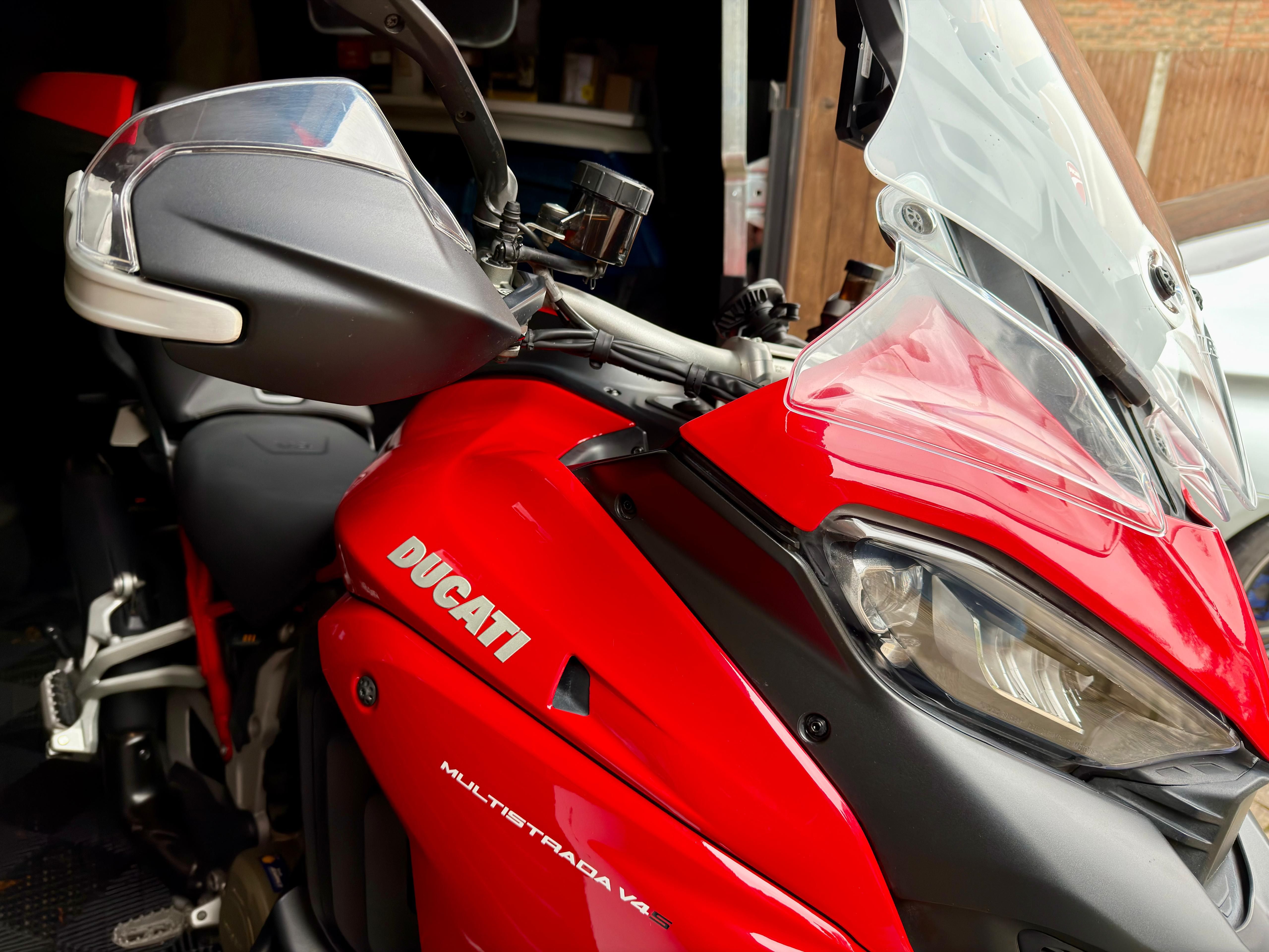

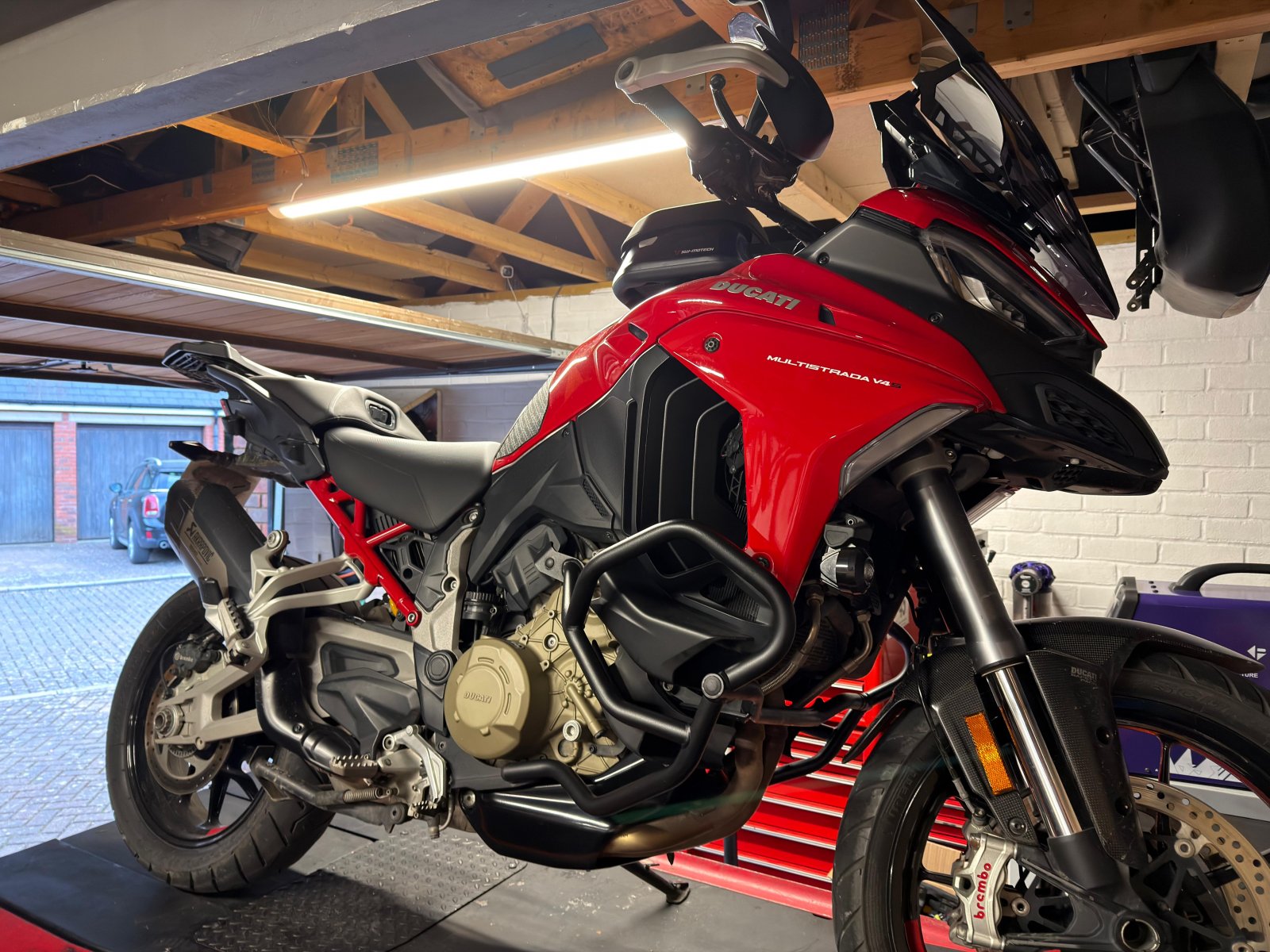

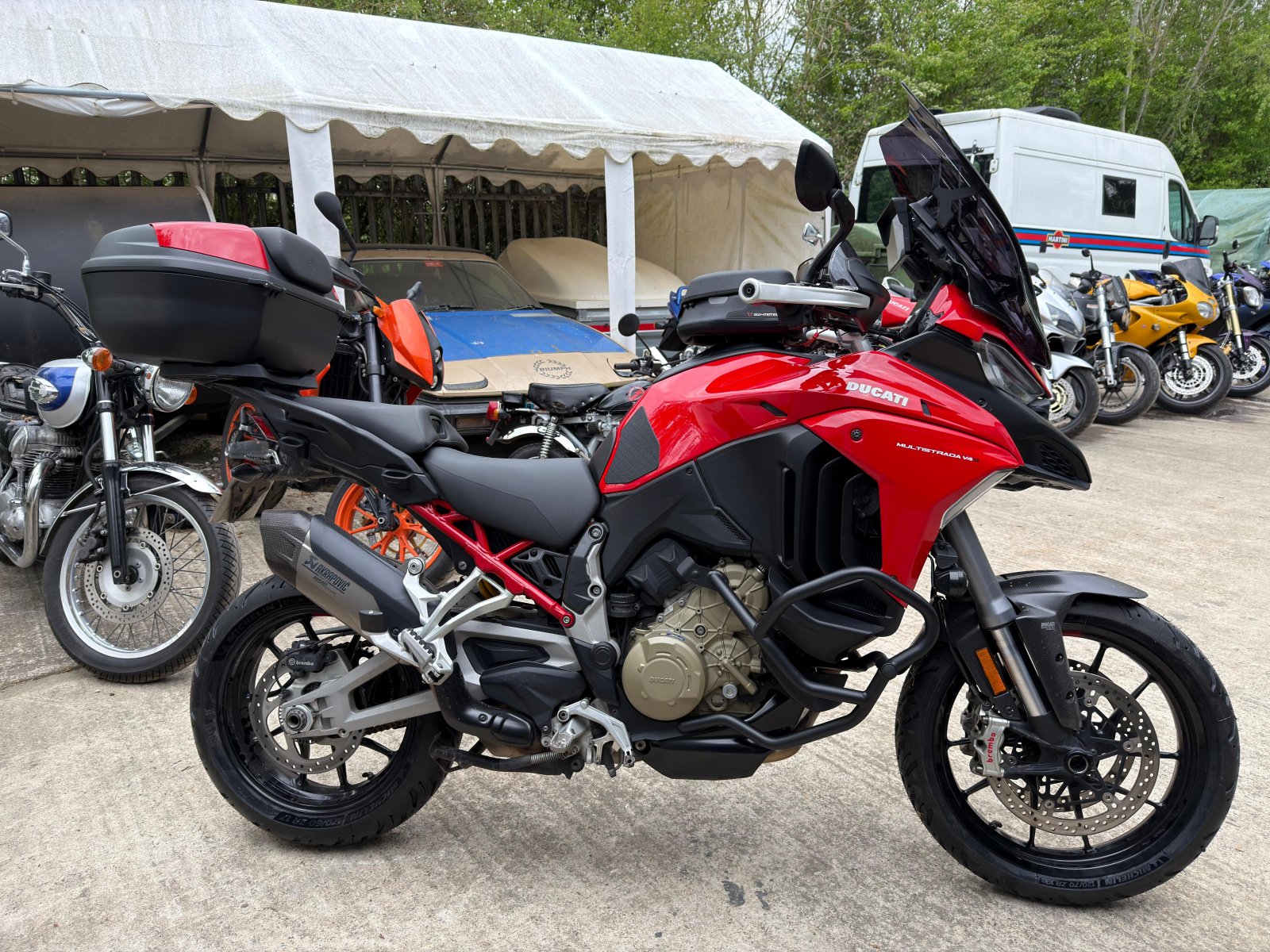

  20. Recently fitted a non-crashed pair of touring hand guards - i'll repair the second hand crashed pair I bought and sell them cheap. May still black the silver bits out... They've got a tint on the clear plastic, which matches the new hideous screen, below.

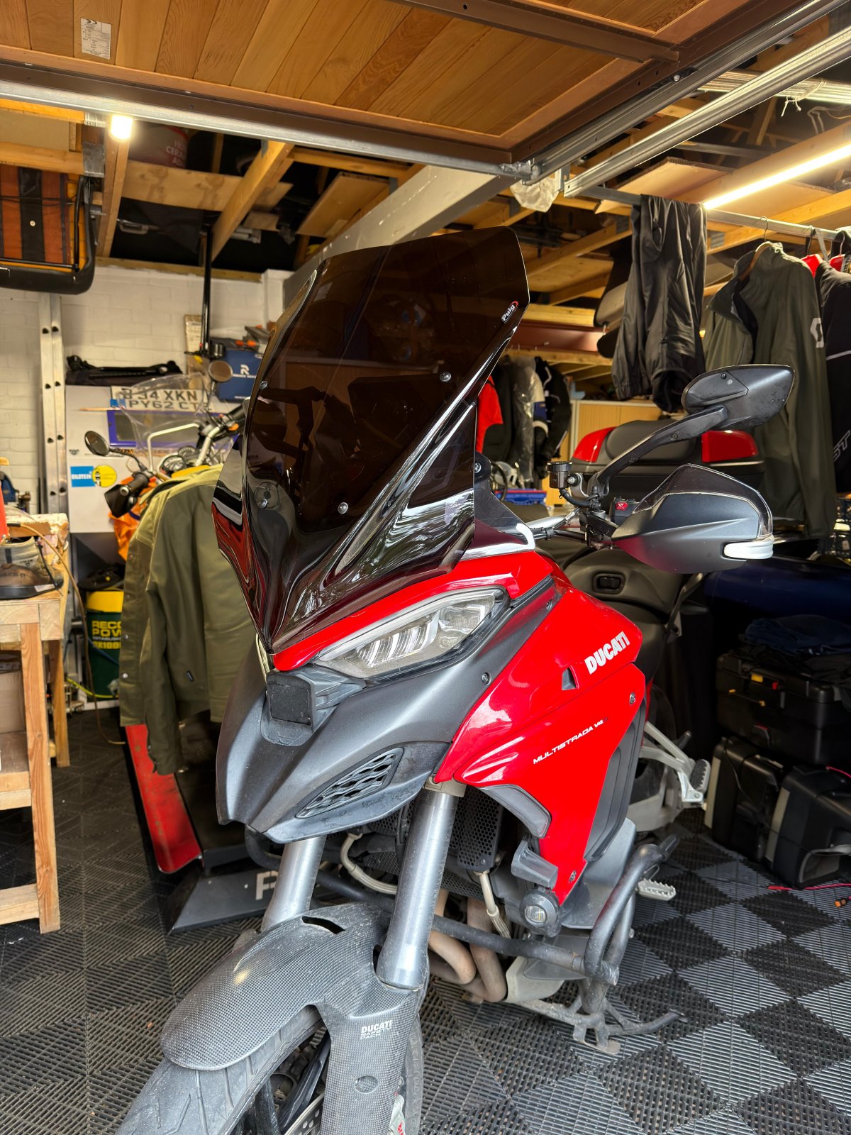

    The WRS Caponord screen was good, but I still found it a bit noisy. I found a second hand black tinted (not my taste!) Puig touring screen on eBay cheap, so took a gamble to test the airflow. It's steeper angled, further forwards, and far bigger. Again, not as quiet as I wanted (damn, the big vertical R1200GS Adv screen so far ahead of me spoilt me!) but good protection generally - but way too black, really in my sightline when up high enough. I popped the tiny Pikes Peak screen on - definitely less tiring noise, cleaner (but increased) airflow. For commuting at 30-50 mph it's great (until the cold or wet mornings!) but at 70 mph+ the magnitude of the airflow is noisier. For my 10 day euro tour starting tomorrow, i'll probably go back to the clear WRS. The Puig is very ugly, especially with it's brackets.
    I bought a second hand but new black pikes peak exhaust shield/sump guard to finish the fully red & black aesthetic.

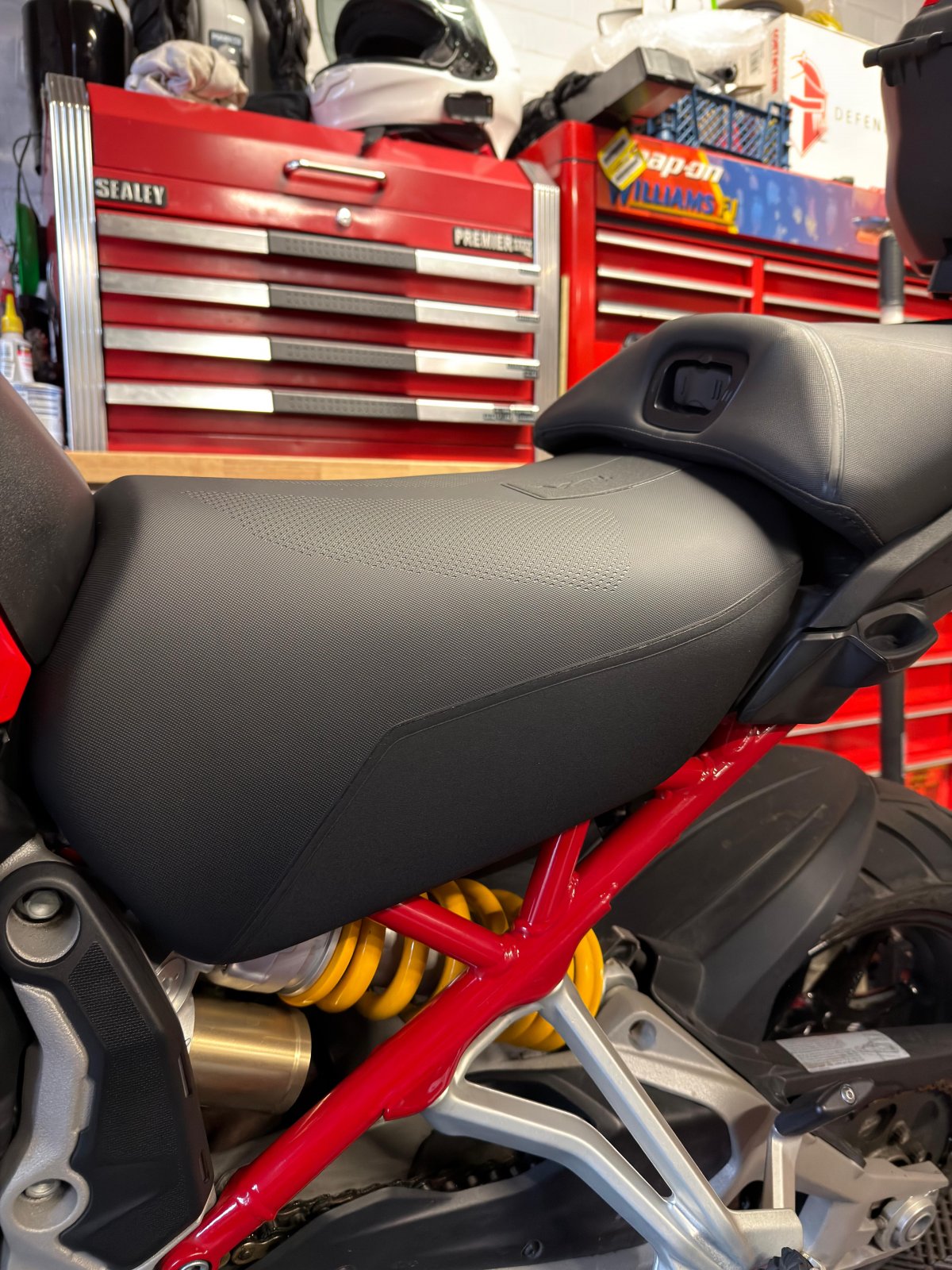

    I've also added a +30mm seat for a bit more padding, but it's pretty firm! Hoping it breaks in.

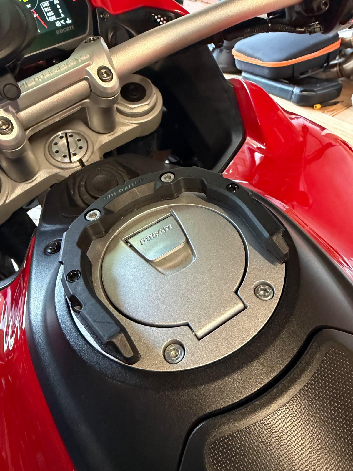

    Also splurged on a "hands free" electronic fuel cap too, the single thing that annoyed me most about the bike.

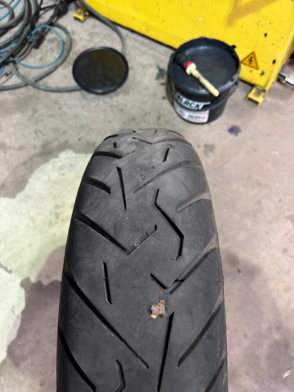

    New pair of Pilot Roads fitted @ 30,760 miles. It's amazing how much less I have to muscle the bike around now haha

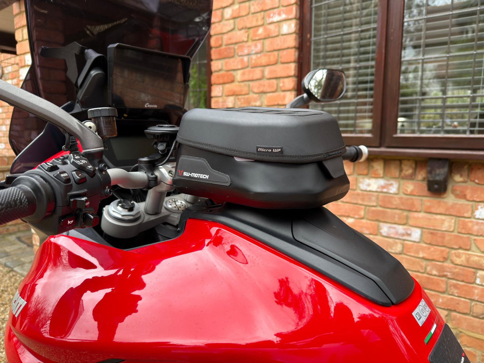

    Last of all, the least ugly of tank bags I could find, ready for the first euro trip.
